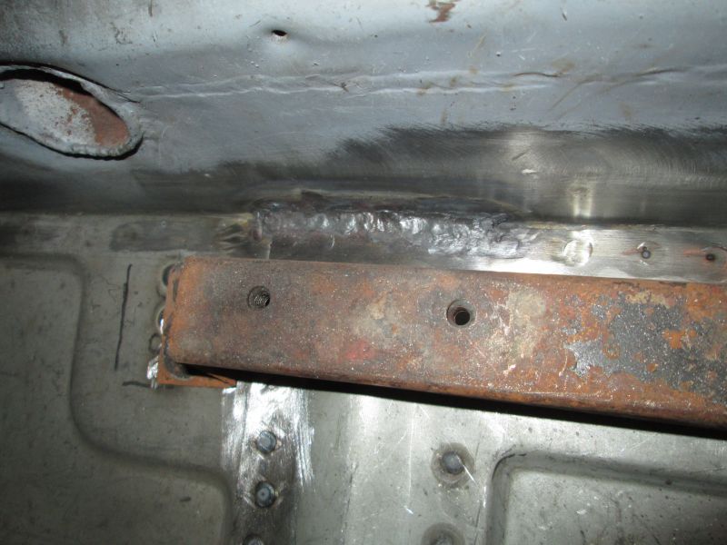

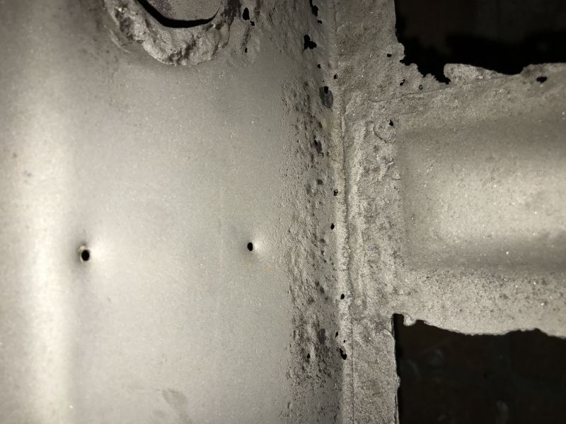

  • Hey Guys,

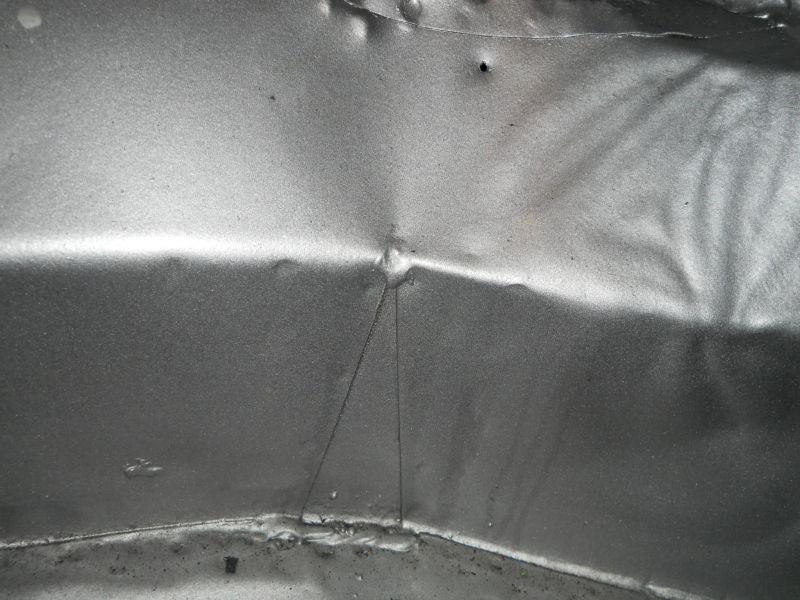

    I ran through all my photo files and these are best ones I could find of my original floor in those areas. I can take better shots of the gas welds across those areas if you still need.

    • Well done to put all that shifter stuff together for testing before setting it in stone (steel?). Be sure that the reverse light switch bracket is stout enough on those late preA & T1 cars. Over time and use, the bracket can be bent slightly over enough that the switch will not operate the light. I have had the pleasure to repair this problem by welding additional material in the tunnel on several running/driving cars. Fun.

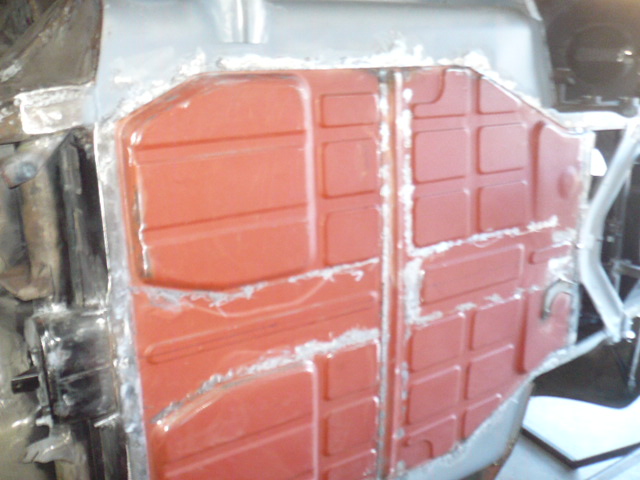

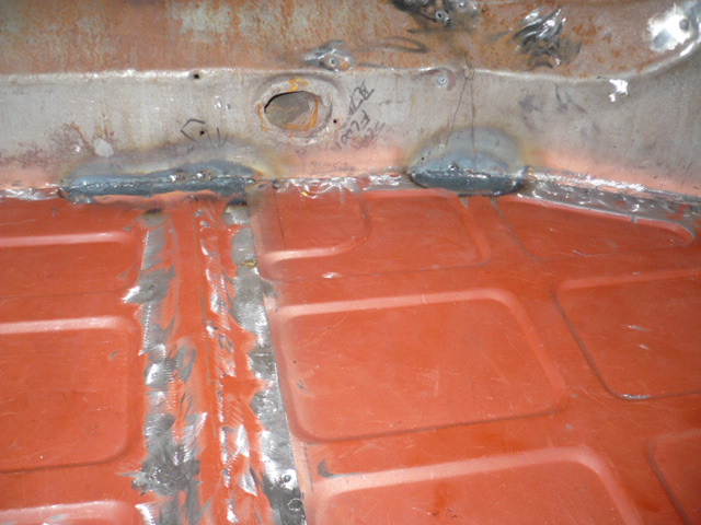

      • Here are the seam welds I replicated on the coupster Steve.
        Runs the length of the delta V
        Runs the length of the overlap on the floor halves.

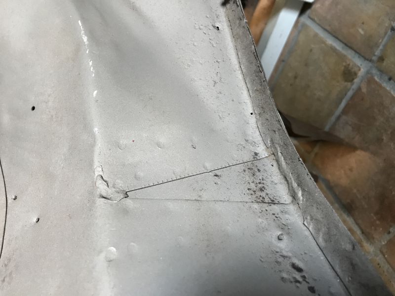

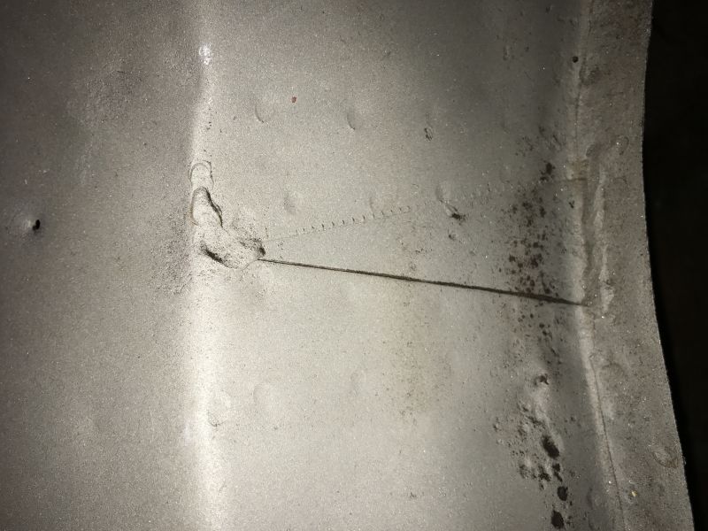

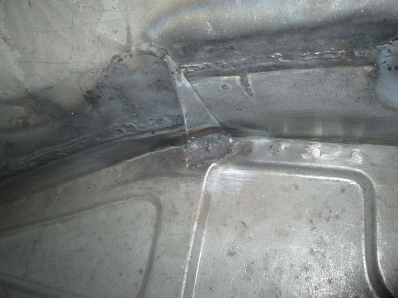

        • From my 57 Coupe, original gas welds.

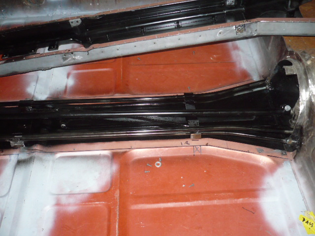

          • Thanks for all the comments on the side welds. That was one of easier tasks once I knew where to go ! My gas welding leaves a lot to be desired so I laid down mig bead and then 'dressed it' with gas. Not ideal - not pretty - but as it's going to have seam seal and paint, my sins with diminish

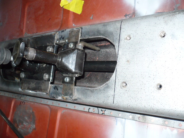

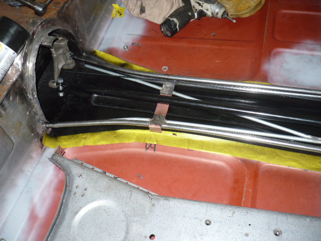

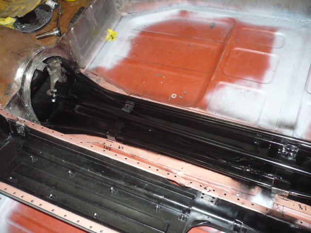

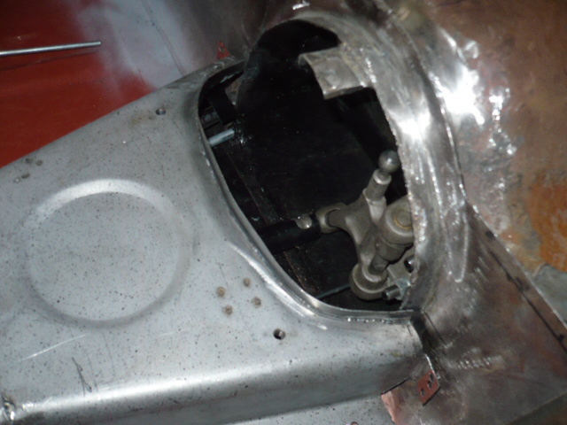

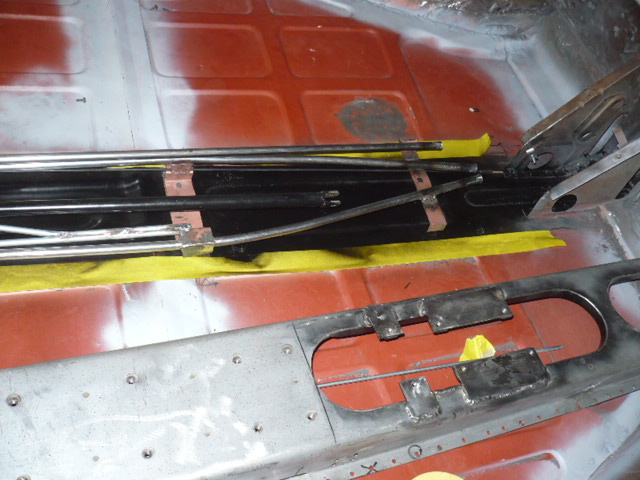

            Then back to the tunnel. I have lost count of the number of times I have put the tunnel on and off again to make sure it's aligning up correctly. This sequence of 'on and off' again is especially important as it's getting close to commitment time !

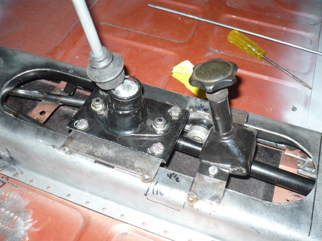

            First step was to tack weld the plates for the gear shift and heat control:

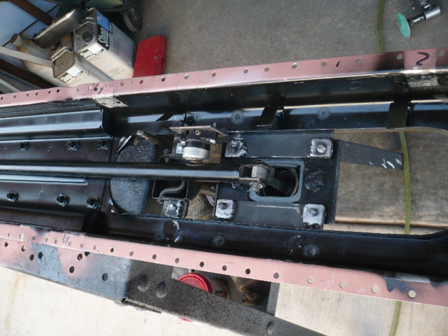

            Then added the gear shift rod and mate it to the monkey motion.
            All looked good - so everything off again and welded the plates down. I took note of the several peoples suggestion to makes sure the reverse light plate was robust. (Thank you)
            Then onto the final layout check; I have the correct accelerator rod linkage and it fitted - ALMOST ! It was rubbing on the driver side brake tube. I realized I had turned the brake tube too soon after leaving the middle mount (the one with the rod U channel). I needed to unpick the welds on that left tube and allow it go straight for maybe 8" and then turn in. All the while "climbing" slightly as it goes, that then allowed the accelerator rod to slide under it with clearance.
            I had taken the clutch tube off as part of the process to allow me to weld the rear end tubes. I recalled it being suggested that one checks the clearance of the tubes - I did - the clutch tube was blocked from a spot weld somehow, too much heat maybe ? I had to rig a 3' drill bit and clear it ! Then back on and welded up - no going back. Black paint where I could, as its not see daylight for a while (I hope) The yellow tape is protecting weld through copper primer.
            Going to leave it for a day or so and think about it - once the tunnel is on I really don't want to find a problem.
            Finally ... I can't see how the gear shift rod can be put in the tunnel after the tunnel is fitted; just too long - so that will be in place when I weld everything up .
            Thanks for all the support.
            Steve
            • Looking good Steve!
              Tunnel rod is installed and removed through this hole.
              • Like the man says; 22Ra, page R51 of the workshop manual.
                One catch though: Removal 3. [with] "(engine and transmission removed from car)"
                Best not to forget, so put 'er in prior.
                • The shift rod for PRE T2 can be removed and replaced WITHOUT engine/trans removal, but just barely. Requires fuel tank removal, and the rod is pulled out in to the front trunk area through the oval hole that accommodates the fuel tap.
                  The shift rod on those early cars was made of really thin wall tubing. Take a very close look at It for signs of rusting out, usually from the INSIDE! Poke at anything that looks even remotely suspect. I have had occasion to remove and repair several over the decades on non rust bucket cars. Trevor assisted me just a month ago on a nice '57 Speedster.
                  • Thanks guys - mea culpa - I should have know better and I must learn to RTFM more often. But will leave it in there, taped up, so as not to rattle too much while I roll the car around !
                    Steve

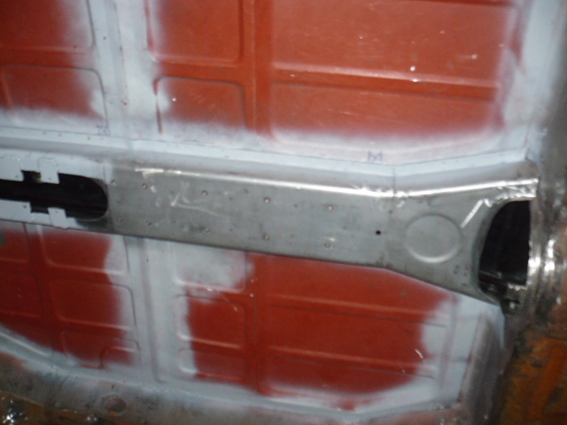

                    • Opps it's been "3 months 1 week" - that's the trouble with this blog, it lets you know you have been slacking .... well maybe and maybe not.
                      The floor was a real push for me to get done and to be honest dressing all those welds, was a royal PITA. The thought of the seat mounts and their critical alignment issues coming up next, kinda put me off

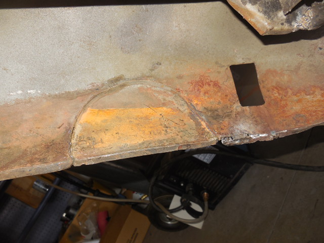

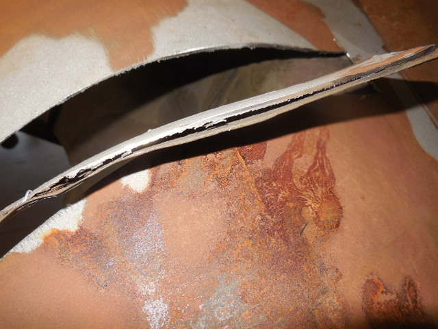

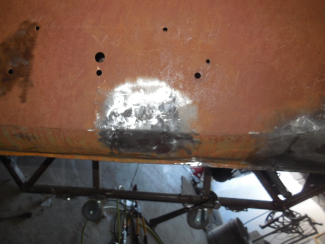

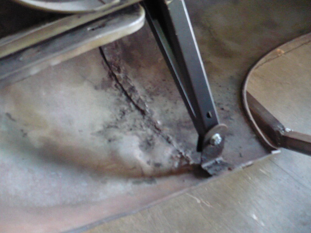

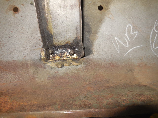

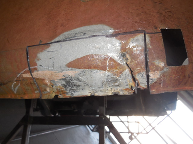

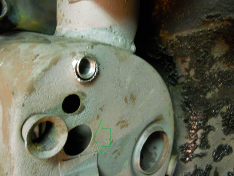

                      • When I brought the car (shell) I had assumed the rear was original and that the lead work was factory. So wrong it seems !
                        It was replacement rear end, from a slightly later model as evidenced by the exhaust cut outs being 'filled in' and use of large washers and assorted metal strips to act as reinforcement for the metal joints, and dripping brass 'solder'
                        Just starting to cut out....
                        other side
                        Center support butchery/screw #12 ? with bronze drips

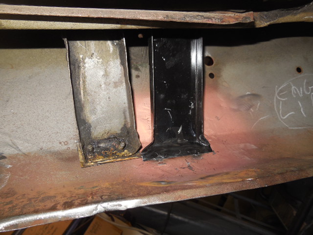

                        So these needed cutting out and replacing with new:
                        old to left - new to right (new fixed in, old just propped in there to show)
                        Steve

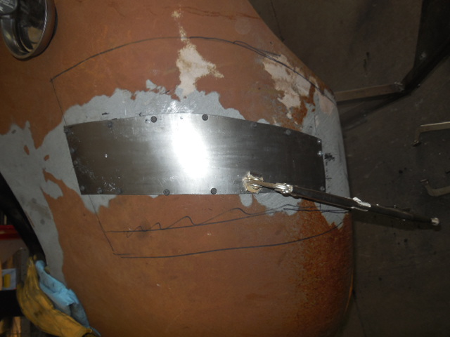

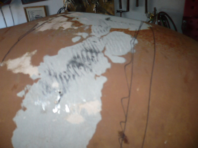

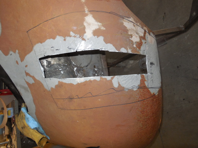

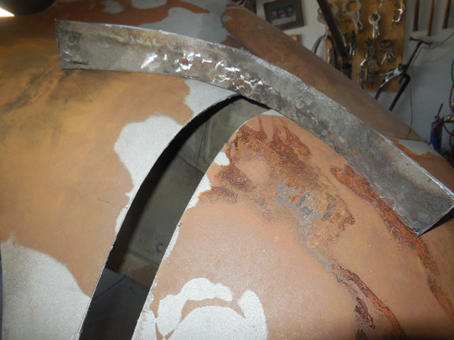

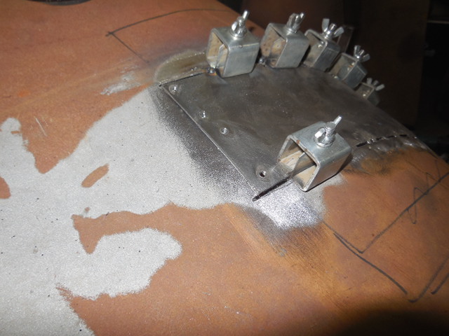

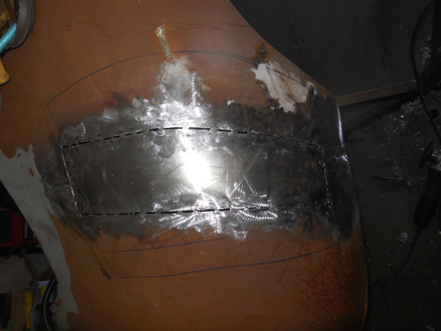

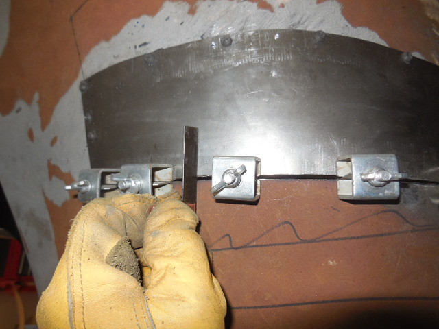

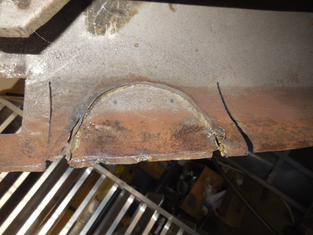

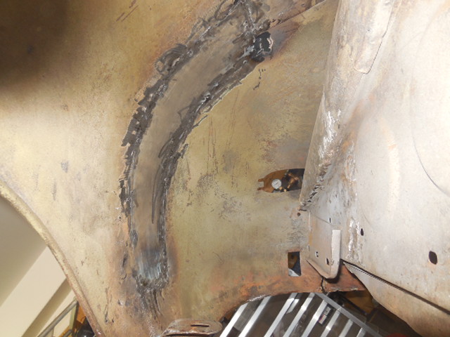

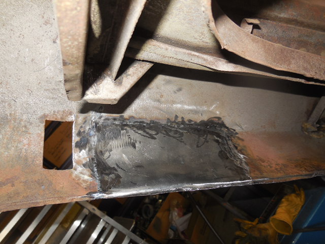

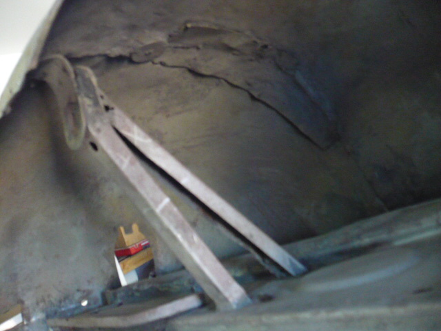

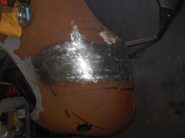

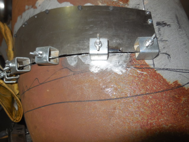

                        • The bigger issues were the fender sides as mentioned...
                          rotted thru the lead.
                          Washer ? Why not !(and the support strut had to go as well of course)
                          Other side ...

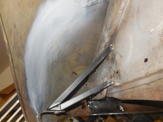

                          Step 1 - cut out
                          screw plate down (after some shaping)
                          cut and clamp
                          check for levels
                          almost there
                          tack and clean up - time for a cup of tea
                          almost there
                          and under....
                          and a primer to seal for time being. And new strut - just gotta love new metal
                          and start over all over again on the other side.
                          and a sense of the lead !!!
                          to be continued...
                          Steve
