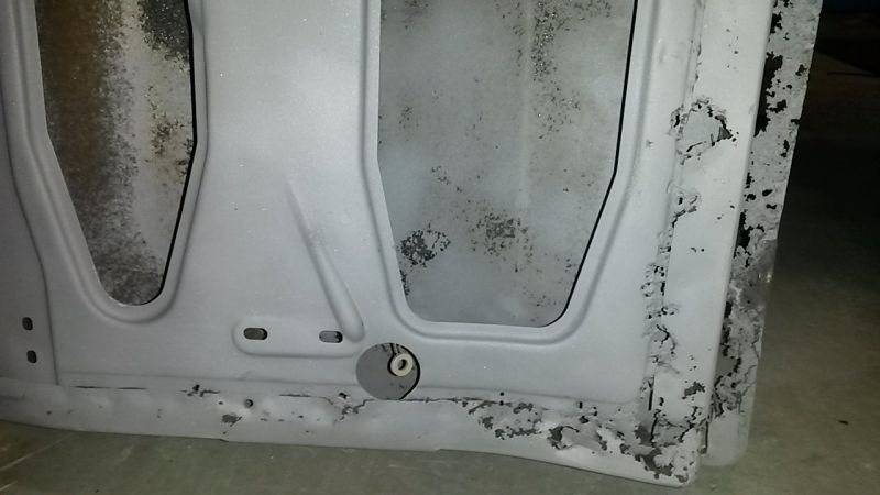

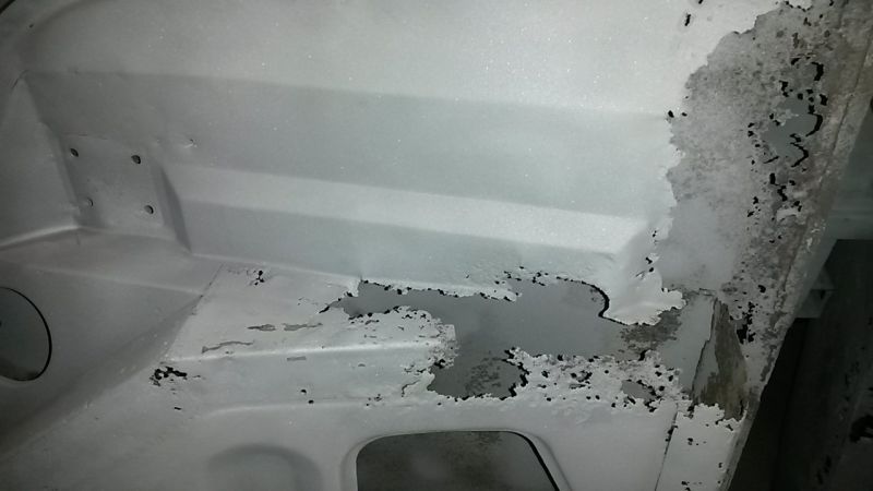

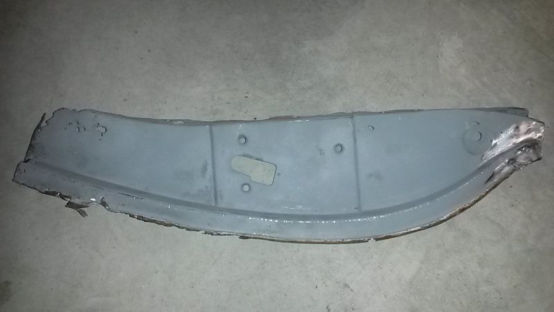

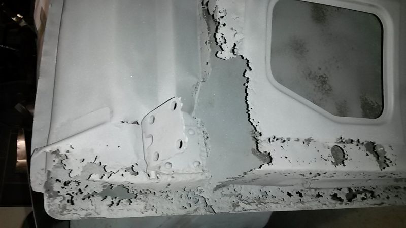

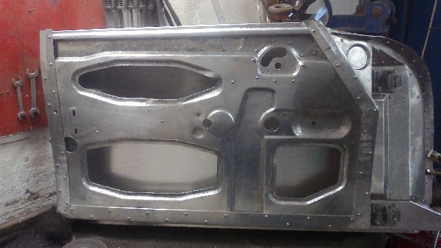

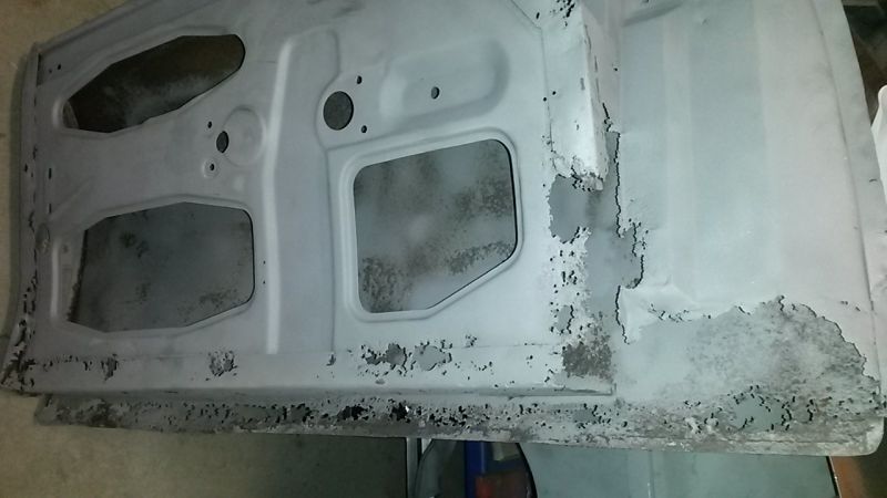

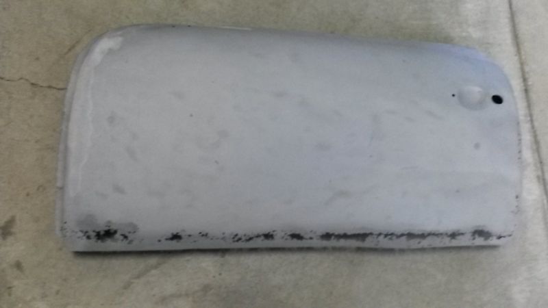

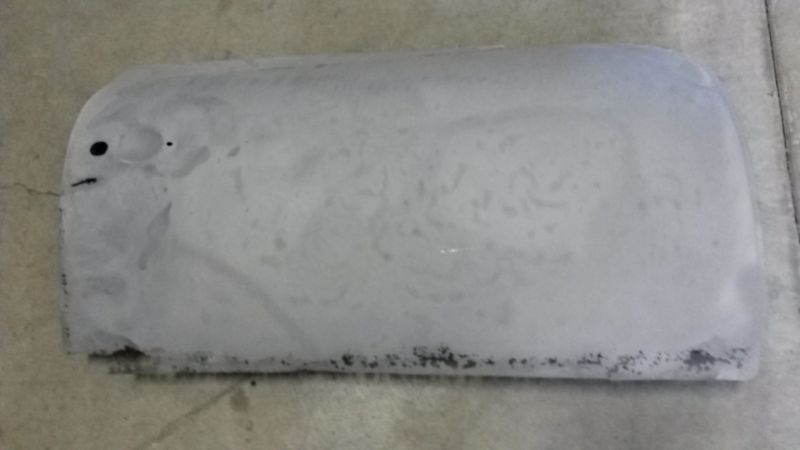

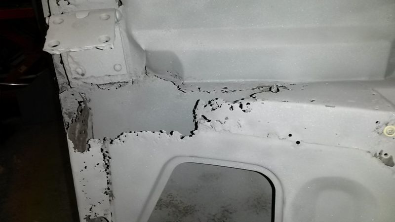

    well as some of you know i am building some aluminium doors for this car, but i need them now to check the opening with the window frame along with the lock post before the longitudinal gets closed up and the floor gets fitted. so i took the original doors to get glass blasted at 'blast and peen' in keysborough Melbourne, so i can repair them as it will be quicker than finishing the alu doors. (what with making a jig to fit the original door into then take templates and so on)
    here's what's left lol...

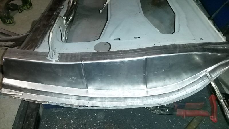

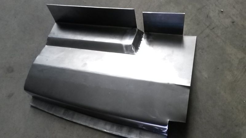

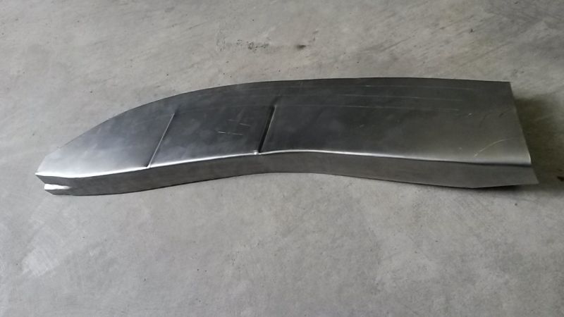

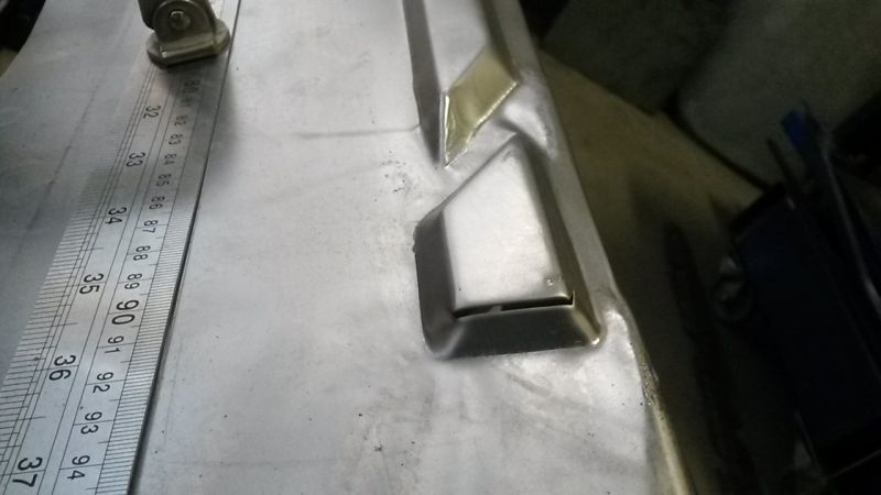

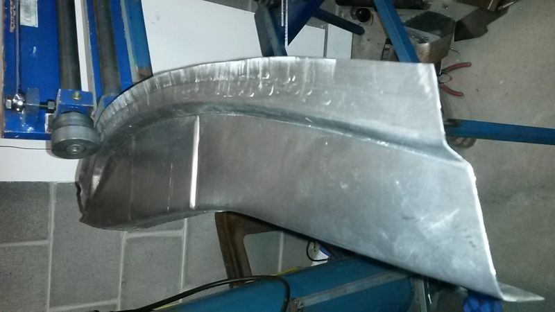

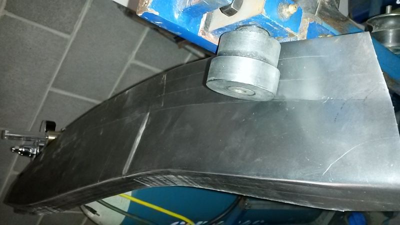

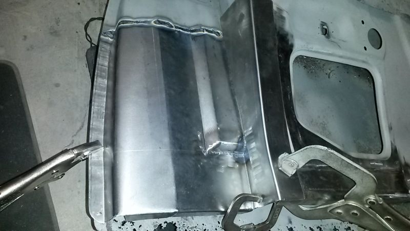

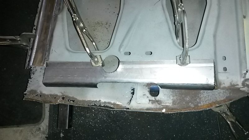

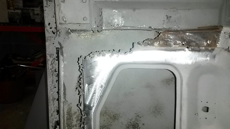

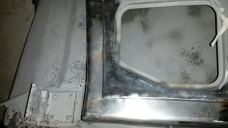

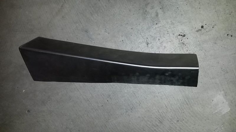

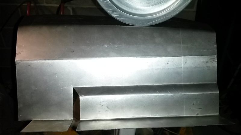

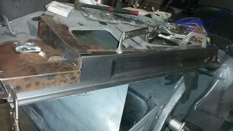

        started to weld them up already but I'll remember to take pictures when I get to the garage, but here Is one repair panel

        • #94
          Wow, aggressively eaten by Metal Termites
          But repair panel looks nice.

          • #95
            Your fabrication skills are simply amazing Neil! The shapes you turn out are impressive to say the least. I'm looking forward to watching some alloy doors being built.

              Thank you guys for the kind words, it is nice to hear, whether amateur or professional panel beater.

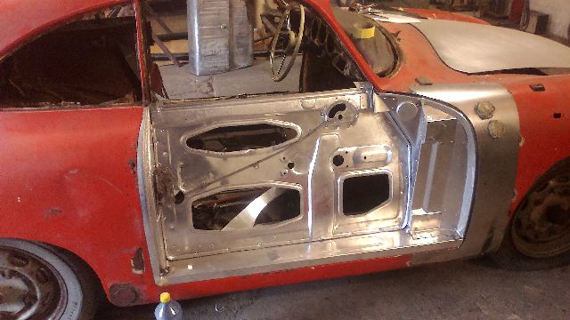

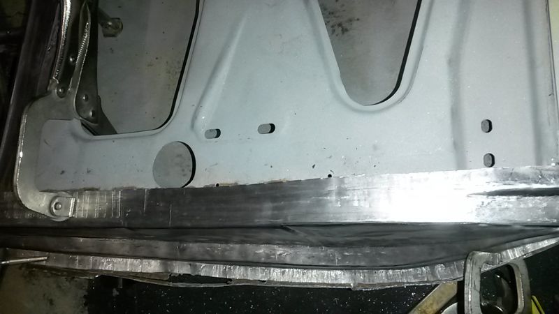

              so as it stands at the moment

              JOP, yes i still have the cheapo english wheel, I too would love one of Peter's wheels but that will be much later on if at all with my hand!
              Justin, I am almost half way through one alu frame!

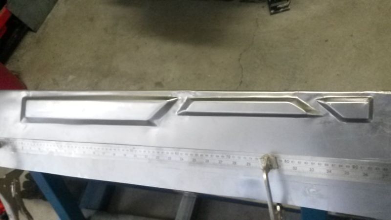

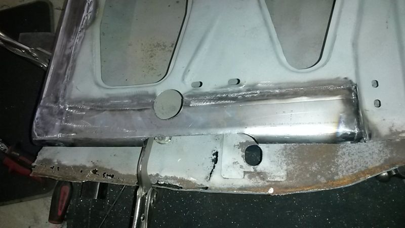

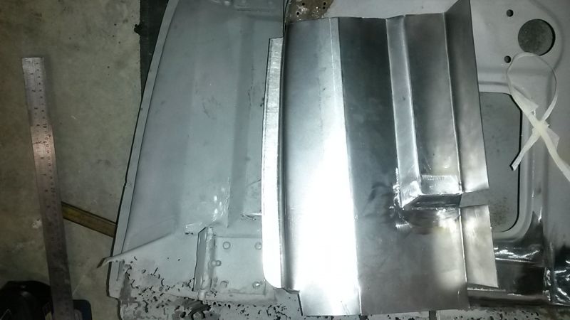

                    bit more done,

                    bit more tweaking then put the holes in, here's the old

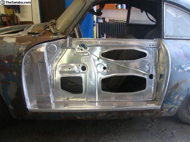

                    • Originally posted by JOP" post=37025
                      Neil,
                      These are old ones I got from a Marek who deals with parts and renovation...
                      sorry for poor quality of photos but thats M fault
                      thanks for sharing your pictures, they seemed somehow familiar, and after looking i realised why, i have a picture of a door the same as those but not on your red coupe

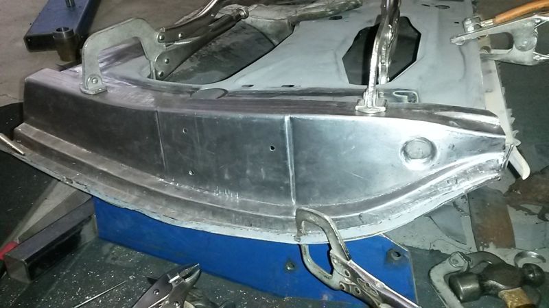

                          little more done

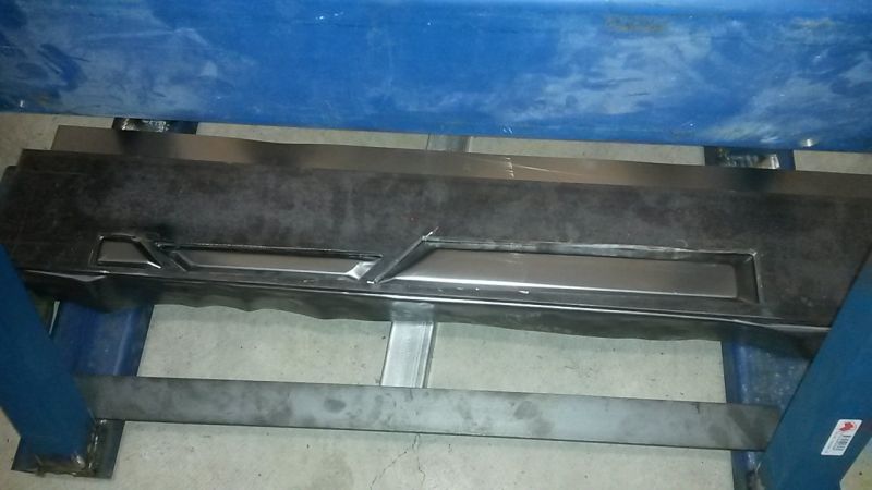

                          on to the next part now, the bottom!

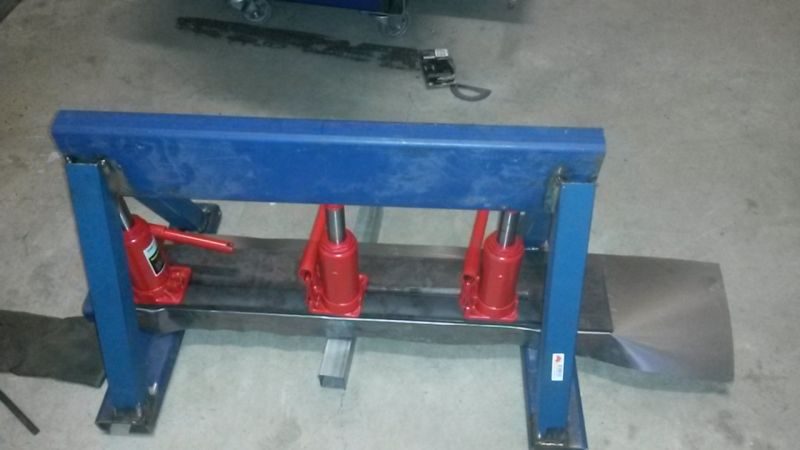

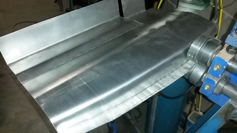

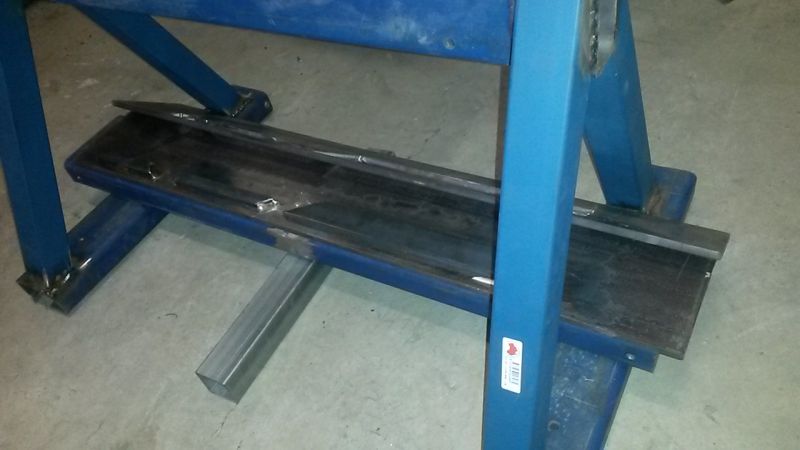

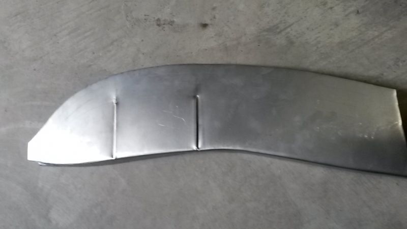

                          • so the bottom piece! you can obviously buy these parts but where would be the fun in that?... so I made a press with some steel RHS I had laying around (like you do). I bought some 150mm X 10mm flat bar to make some dies, the male die had shapes tacked on it and the female had holes milled in it. This is today's result

                            I will have another go tomorrow but I'll pre stretch the panel in the areas with the most shape
                            thanks for following along

                              • thanks per,
                                that's a tempting idea making door parts lol, i made another one and pre stretched the panel, here's the result

                                quite happy with it, i'll do another as a spare and then in aluminium for my other doors.
