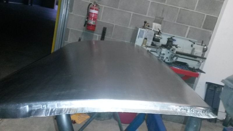

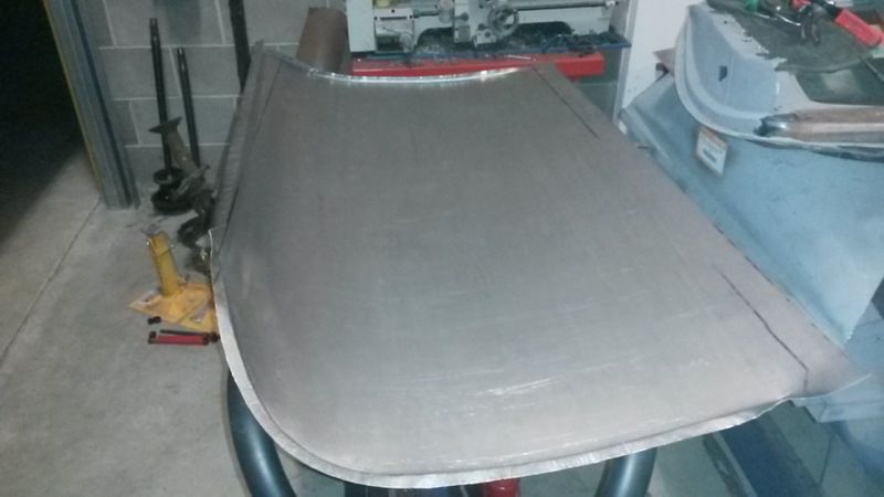

              i did take a couple of pics tonight while i was tipping the edges
              just have to finish the bottom and put the indent and holes for the outside handle
              thanks for the kind words and for following the madness!

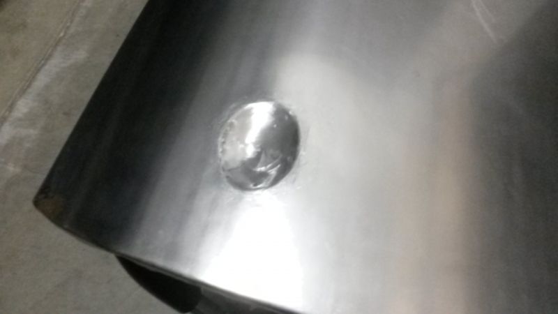

                  • thank you guy's

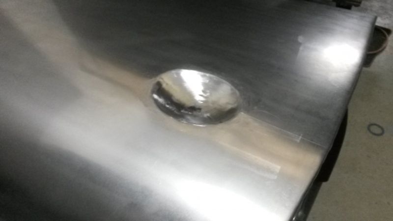

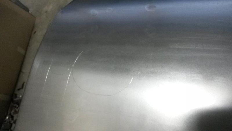

                    I got the indent in today, finished the bottom yesterday just have to put the holes in
                    marked out using a template from the old skin
                    thanks for watching

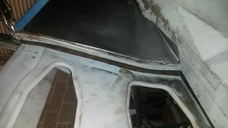

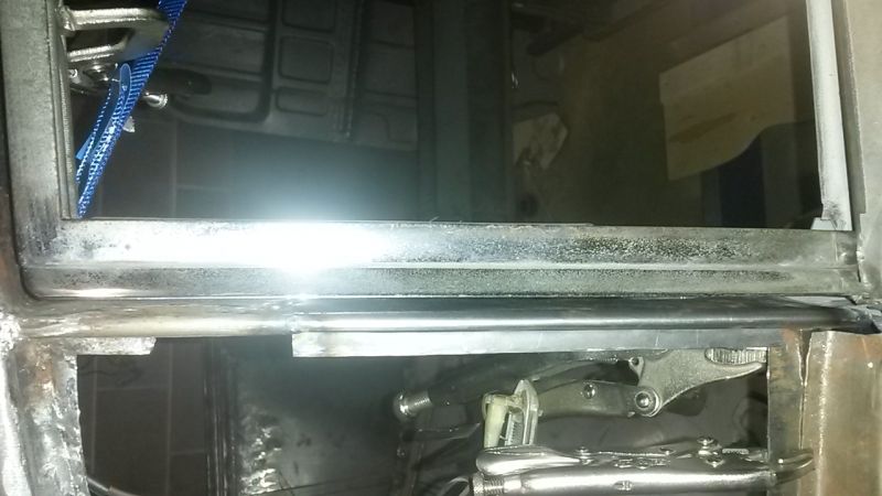

                    • have been getting this door frame sorted, tweaking and setting the hinge brackets, gapping the window frame to the roof opening. I have a nice gap around the inside along with the window frame, the top of the old door skin is at 303mm from the 1/4 window opening, should be 304mm so I'm not far away
                      my lower hinge bracket needs to come out a little,I have 2 spacers in at the moment but needs a bit more.
                      thanks for watching

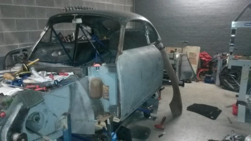

                      • little update, on to the passenger side door so i can finish bracing the door openings to get the longitudinal's on and the floor in.
                        setting the hinges, i've measured the distance between the two
                        looks great to see it back on
                        it's not gap'd up at this point, just the window frame to put in then gap it to the roof opening.
                        thanks for following along
