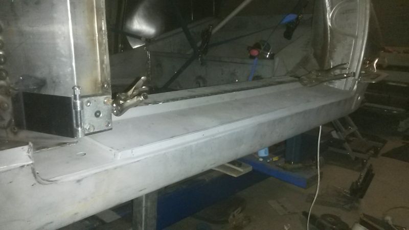

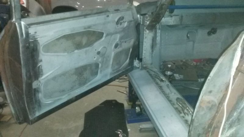

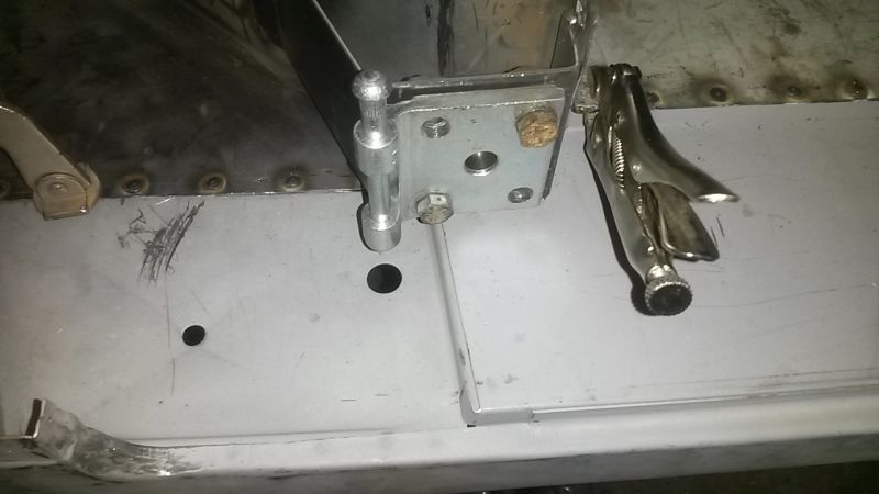

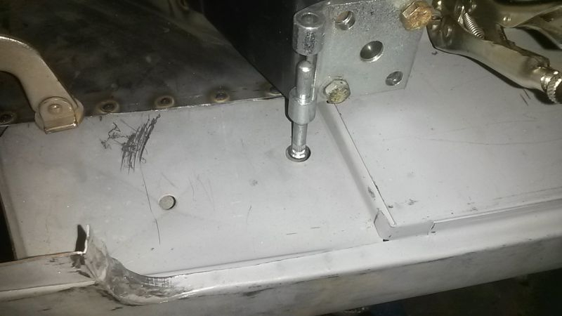

  • well it's been busy! i made a new outer 'a' pillar section where the hinge brackets go, after checking and checking it turned out it was 6mm out, so it was re-made and replaced. hinge brackets re-made and tacked on, door back on and aligned. longitudinal checked
    painted inside and welded on checked with the outer sill...

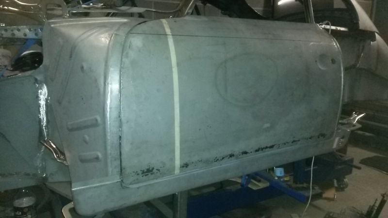

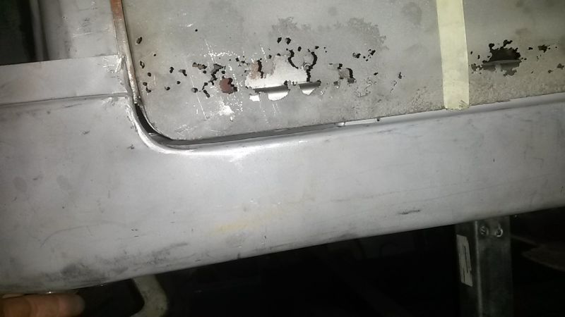

    no idea how this happened.....

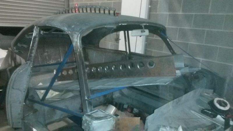

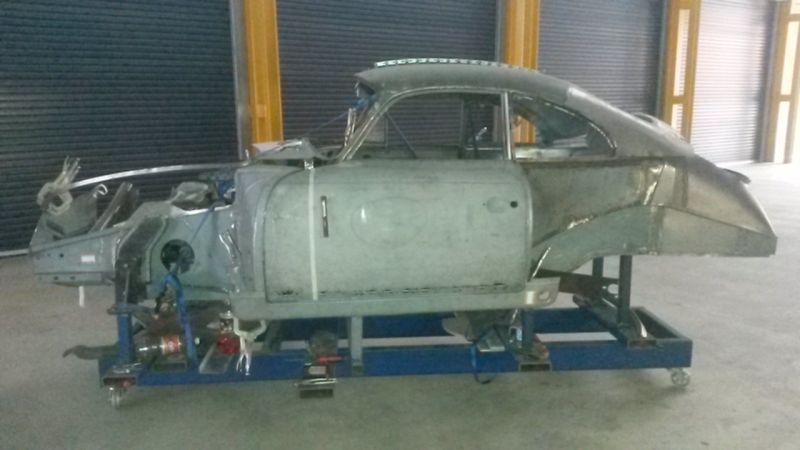

      • i just thought i would share with you guy's a picture i took while turning the car around to weld up the other longitudinal. it struck me as almost having a shape of a car lol
        thanks for watching

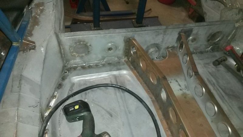

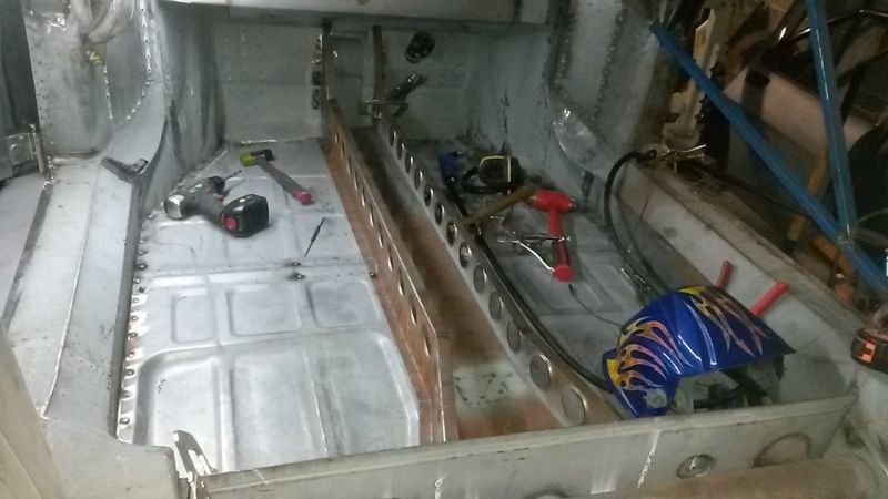

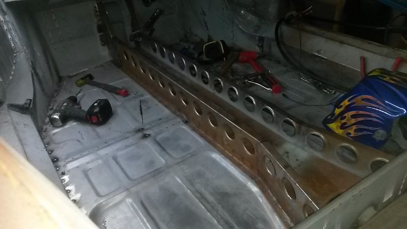

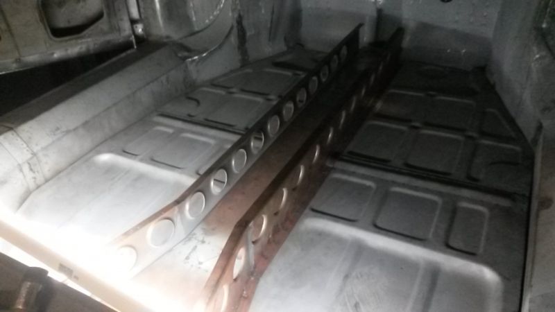

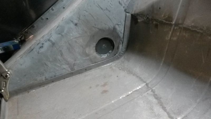

          • it has a floor welded in now
            going in...
            feels nice to have this welded in now
            thanks for watching the show lol

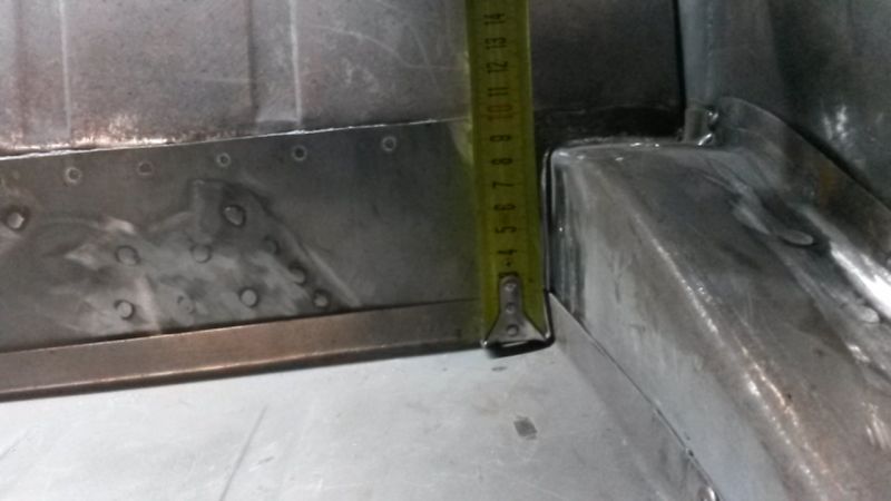

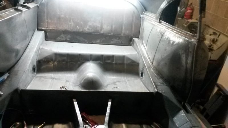

                  • i have been getting the rear seat floor section ready to be welded in, along with the panel below that, the panel above the trans.
                    i put some ties in to replicate the impressions that are in the rear chassis rails. these are 57mm exhaust tube. blanked on one end with 1.6mm sheet. and another 1.6mm sheet sat below the inner level, so to appear to have a depression
                    plug welded to the outer skin and welded to the inner skin. i have another 2 to weld in, 1 on each side

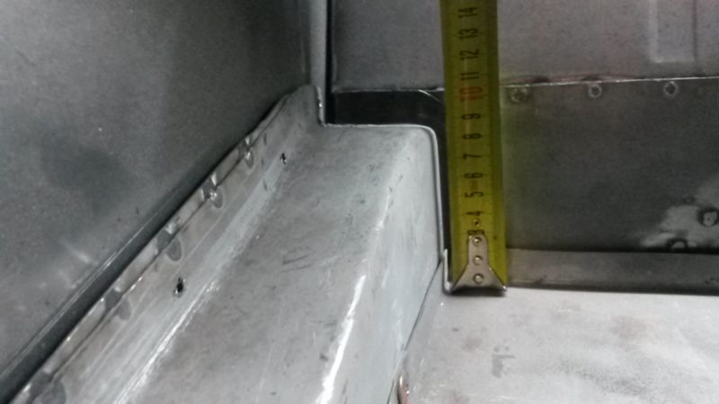

                    just checking the hieght
                    once the edge is tapped down it will be within tolerance
                    thanks for watching

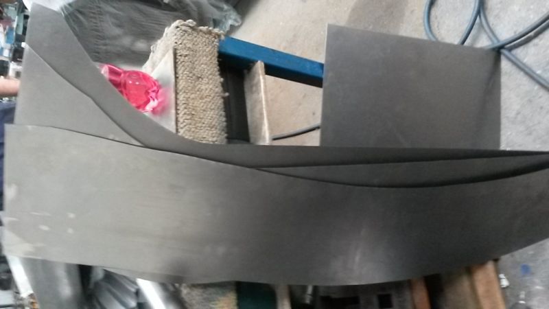

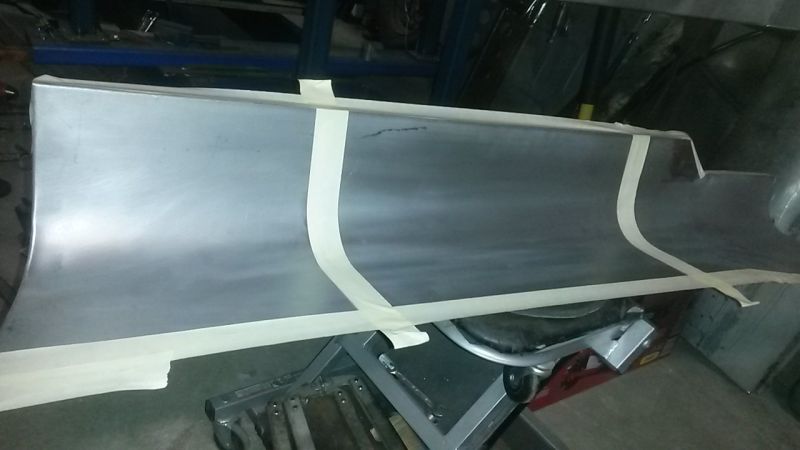

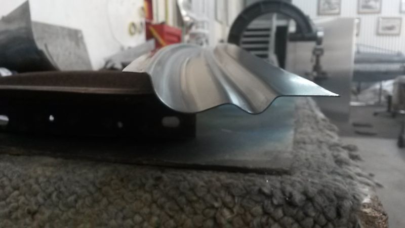

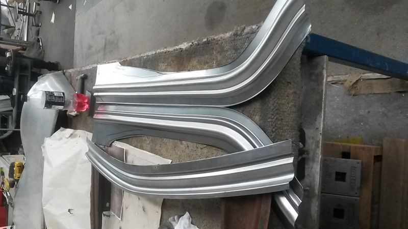

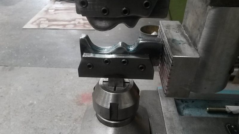

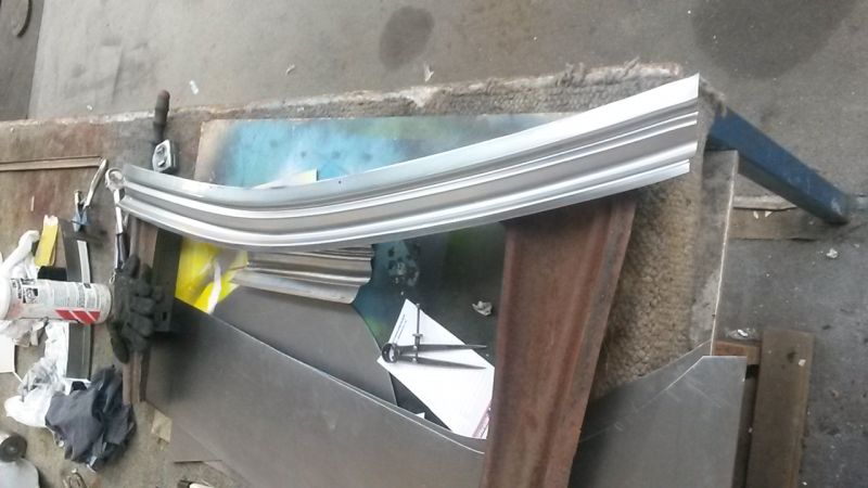

                              so on to the really cool stuff! i called in to see peter and we had some dies made for his pullmax machine so we could make the hood frame...
                              these are the dies
                              and after setting them up for clearance the fun began...

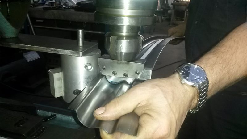

                              the steel to be shaped

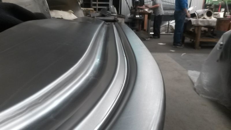

                              all trimmed and ready for the hinge pockets to be blocked in
                              more to follow soon enough
                              thanks neil
