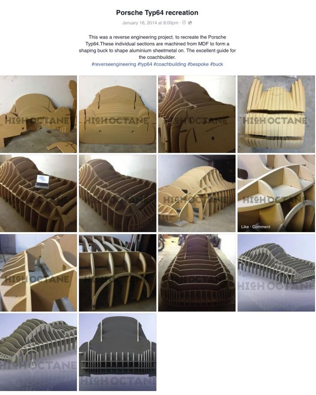

    Roy, i had a guy in the Netherlands scan an original A, i sent him some blueprints over for him to make a start, good job he checked with an original as they were slightly off, he then made a dxf file and emailed it over, he did a great job and a reasonable price. He Is called jeffry works for himself at high octane . nl

      Hi Tin Man,
      I did not know that it was your buddy in NL that had done the copy of Rome-Berlin Porsche as well....because these photos I have seen before
      He seems to be wheeling well
      Cheerio

        yes that's the guy!
        i saw some pictures of the buck for that car and sent him an email. we agreed on a price and he started. it was done over a period of around a year, but then i was in no rush! i got updates on his progress and all went well. i don't know jeffry as such but he has met a good friend of mine from the uk.
        i do like the typ64, i know i would love to build one and I'm sure lots of us would love to own one

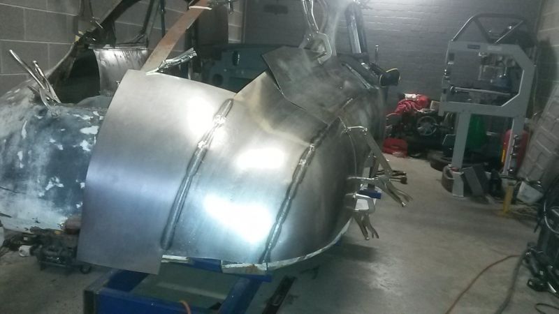

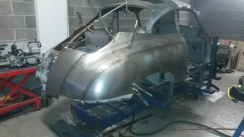

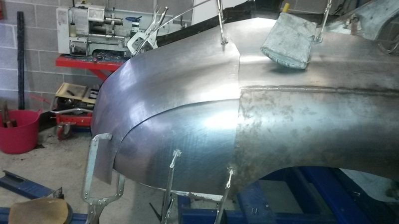

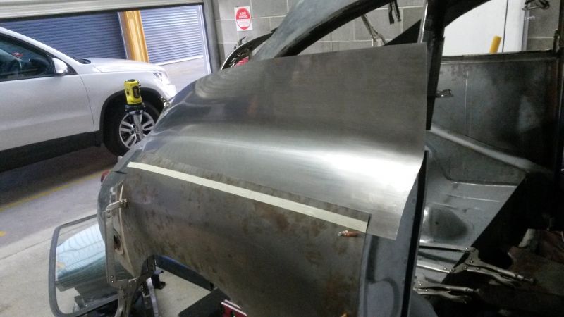

          well i took a little break from climbing the ladder and started on the driver's 1/4 panel (passenger's to guy's in the US)

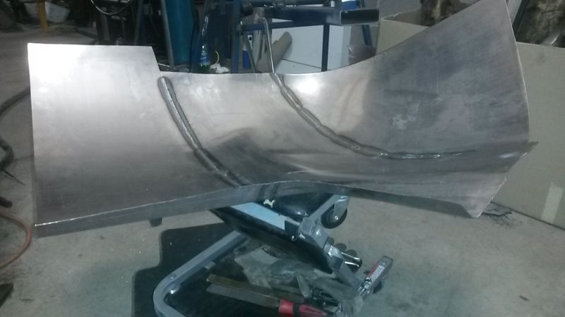

          • #50
            the last part took some doing but its close but more tweaking to do

              Incredible Neil! Its one thing to install someone else's panels like I'm doing but to create and fit them like this is on another level and really mind blowing. I can certainly appreciate all the time you spent just in those last series of photos. Also admiring the glimpses of that fresh chassis/rear seat pan area. Amazing job here, thanks for sharing your work with us all!
              • #52
                Wow!! Really nice. Those seam welds are so clean with no warpage. Did you TIG the pieces on the car or in a jig? Did you have to hammer the welds to maintain the sweeping curves?
                • #53
                  Neil, very impressed w your panel forming. I assume you are using the English wheel? Thx for posting.
                  • #54
                    Justin, john, mark
                    thanks for the kind words.
                    the panels were welded of the car freehand, no jig, with the tig, no rod just fused together. i kept the panels level all along the joint then when i had gone the full length i ran it back through the wheel with light pressure to take the shrink out of the weld
                    thanks again guys!

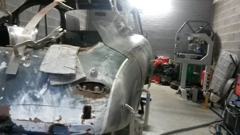

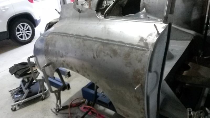

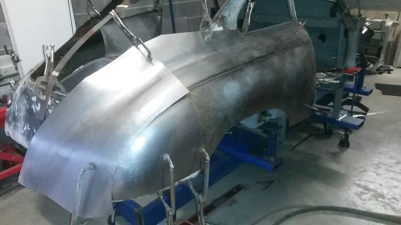

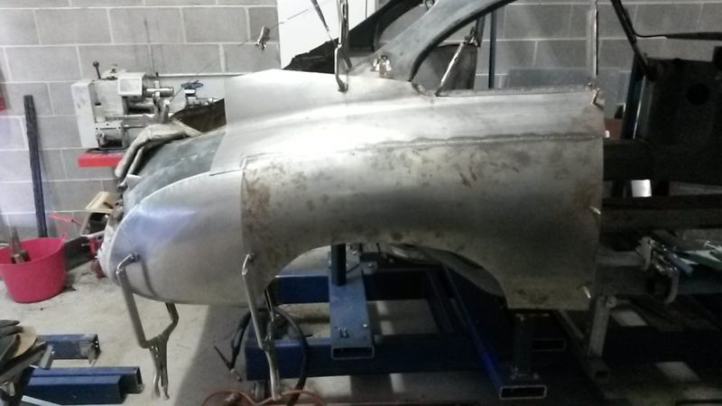

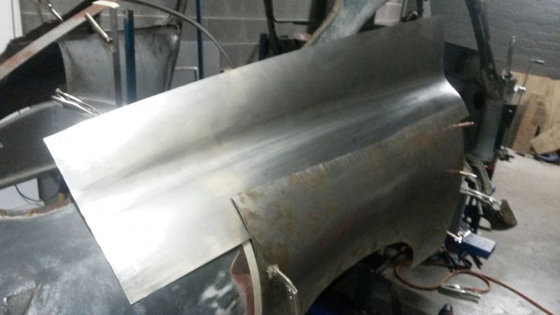

                      just a little update,
                      seems to have been a good week this week...

                      • #56
                        Sorry to say Neil, It looks to good
                        Impressive Wheeling done, Sir
                        • #57
                          Neil,
                          Your work procedure is even hard for me to follow by looking at the photos. Have you wired that wheel well opening before welding the top piece? I presume the old body is underneath so far and the bottom trim around the back will be welded on last?
                          How will you get the left side to look the same and have the the rear lid opening space perfect for the engine lid?
                          Does everything have to correspond to the wooden buck and then you place parts on the car just to check its all going to plan.
                          I can't get over what you are doing, really amazing. As Justin said the fact he has been using formed items and its difficult, you make make them by hand and eye I presume to fit the buck.
                          This is a great thread to follow. Is it the buck that controls everything? When you wheel items do you have to continually get under the buck to see if it all contacts the wooden spars? does one radius push out another one blending to it so you have to back and forwards to get the blend correct?
                          Its beyond me Neil. I would like a video as I reckon all of us would who are confused as me
                          Keep up the excellent work.
                          • #58
                            JOP, thank you sir!
                            Roy, wow! i'll try to answer best i can lol...
                            [quote="roy mawbey" post=32409]Neil,
                            Your work procedure is even hard for me to follow by looking at the photos. Have you wired that wheel well opening before welding the top piece? I presume the old body is underneath so far and the bottom trim around the back will be welded on last?[quote]
                            yes the lower bottom return will get welded on last, the wired wheel arch is not done as this leaves the panel still 'open' to wheel and manipulate if needed.
                            [quote=post=32409]How will you get the left side to look the same and have the the rear lid opening space perfect for the engine lid?[quote]
                            the deck lid opening? i have made a template of an early deck lid, and i still have the deck lid to make yet so that will be easy to create the gaps
                            [quote=post=32409]Does everything have to correspond to the wooden buck and then you place parts on the car just to check its all going to plan.[quote]
                            err i have no wooden buck for the rear... but the idea is to form over the buck then fit to the shell
                            [quote=post=32409]I can't get over what you are doing, really amazing. As Justin said the fact he has been using formed items and its difficult, you make make them by hand and eye I presume to fit the buck.
                            This is a great thread to follow. Is it the buck that controls everything? When you wheel items do you have to continually get under the buck to see if it all contacts the wooden spars? does one radius push out another one blending to it so you have to back and forwards to get the blend correct?[quote]
                            generally yes its good to have contact with all the stations in the buck, but it is still as the eye sees it. meaning if it looks correct then it usually is
                            • #59
