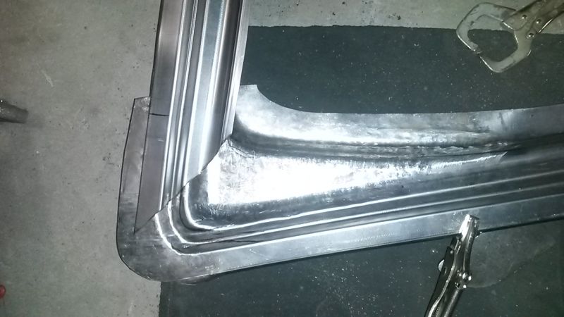

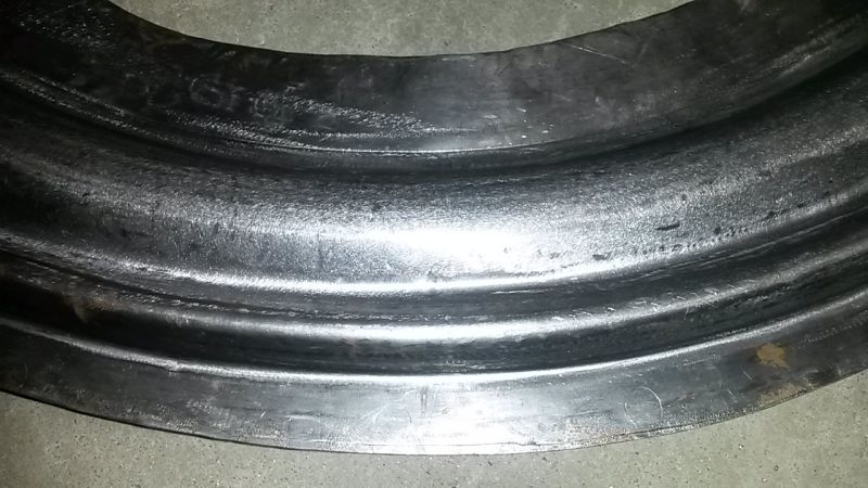

            i've done a little bit of re-shaping hammering in the hinge pockets
            it's always a little daunting hammering on a freshly made panel that looks great but it has to be done!
            thanks for watching and thanks again for the kind words

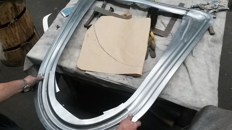

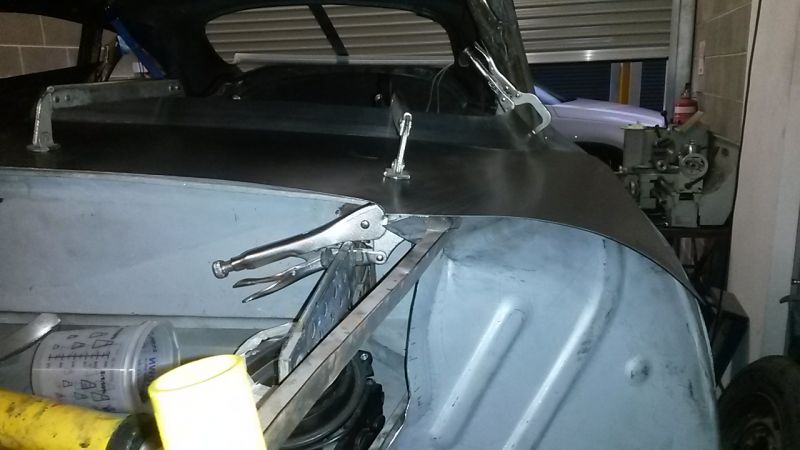

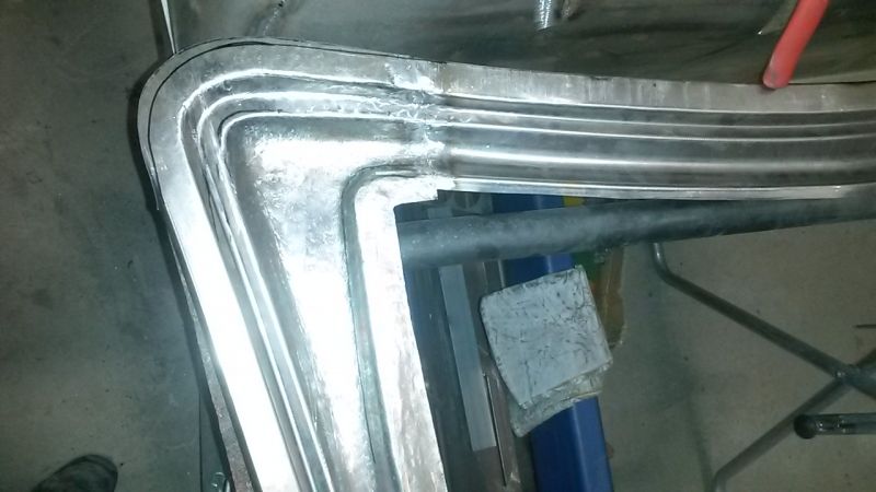

            • last piece made up, just need to tweak it in to final position, hammer the hood lock recess in and weld it up
              thanks for watching
              neil

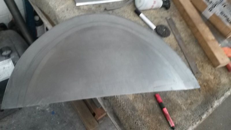

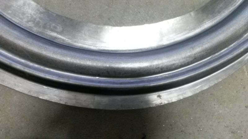

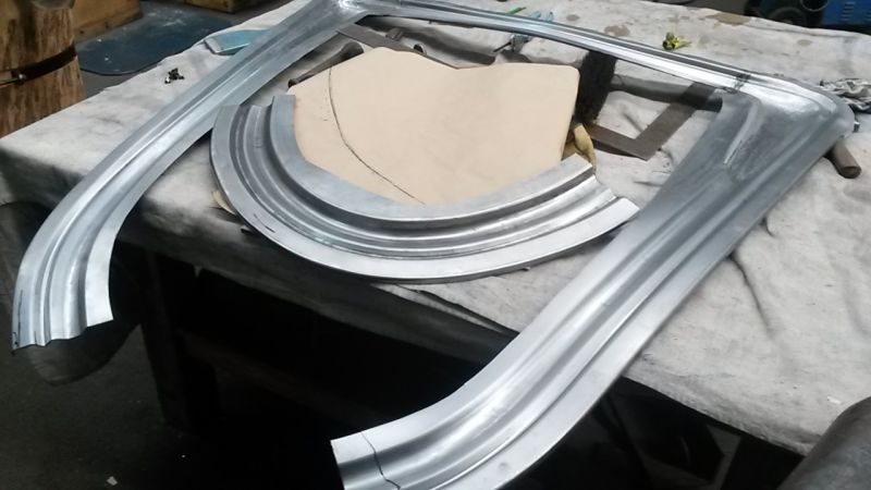

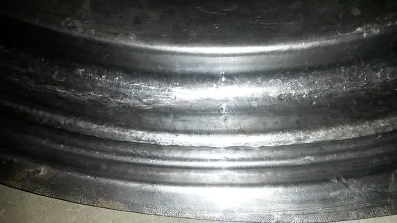

                    i had to make a new front section as it wasn't quite right and i wasn't happy with it. so out with the hammer lol

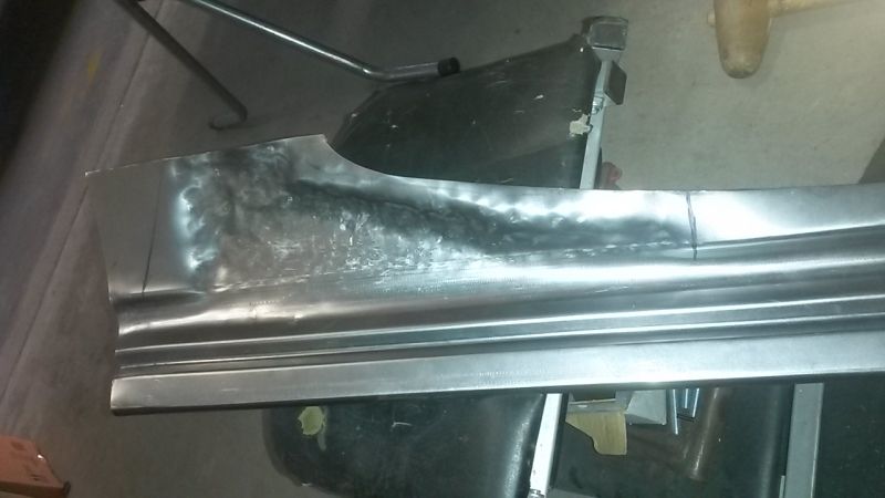

                    it's all welded up now and the hinge brackets are made ready for it to be lined up and spot welded on
                    thanks for watching

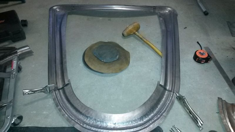

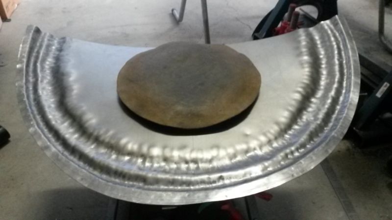

                    • Please show more. Did you use a wood buck? Is that all freehand? How big are your arms? You must be one strong guy. My arthritis hurts just looking. Nice work and post more please. Mark
                      • hey Mark, thank you,
                        my arms are pretty normal really,it was done freehand no wooden buck, all done with simple tools,sandbag wooden bossing mallet, hammer and dolly. I took it up to peters to run it through the dies on the pullmax to clean it up, but it still has hammer marks in it now.
                        I shall post a couple of pics as it its now
                        thanks again

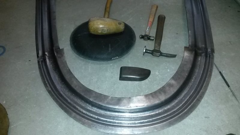

                        • here are some more pic's as promised lol, they are the tools used to make that front piece, obviously I have to hammer in the recess for the bonnet striker but that's easy enough
                          hope that's worked I'm on my mobile lol, the outer had a quick sand and the majority of the hammer marks have gone.
                          I have to add, the small ball pien hammer has had the flat face rounded slightly, and the ball end has had the point removed
                          thanks

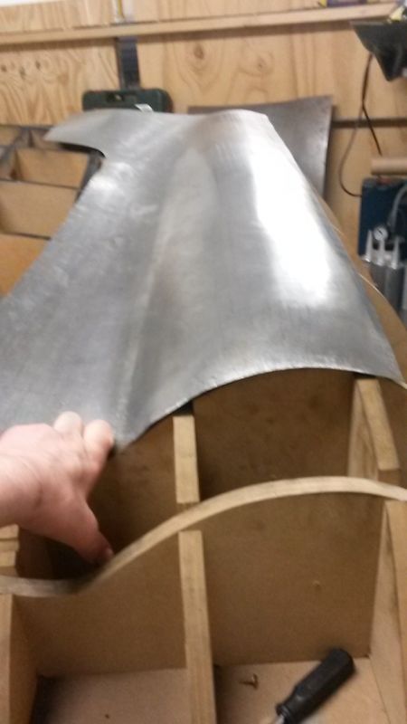

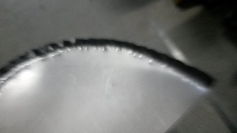

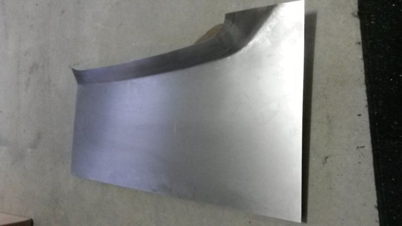

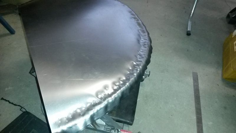

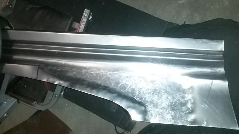

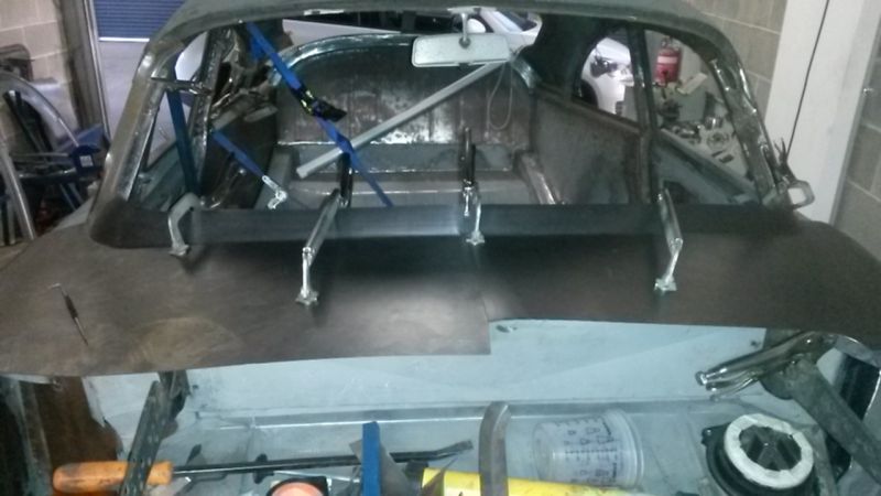

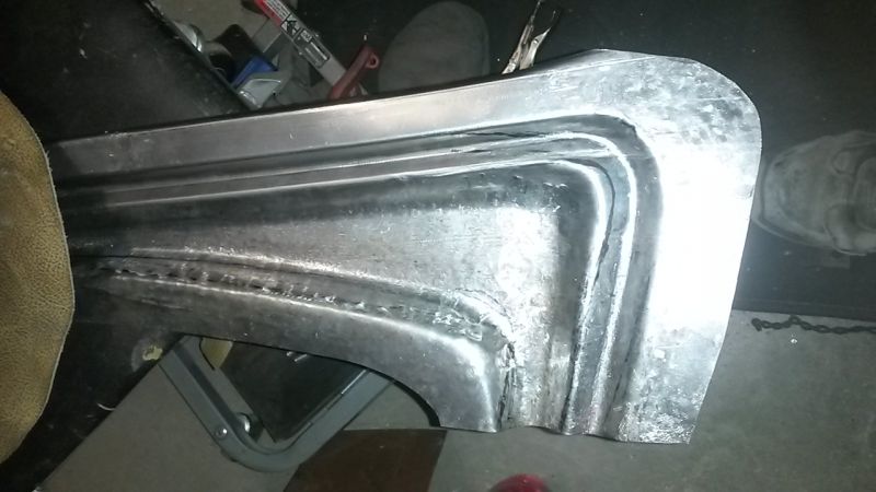

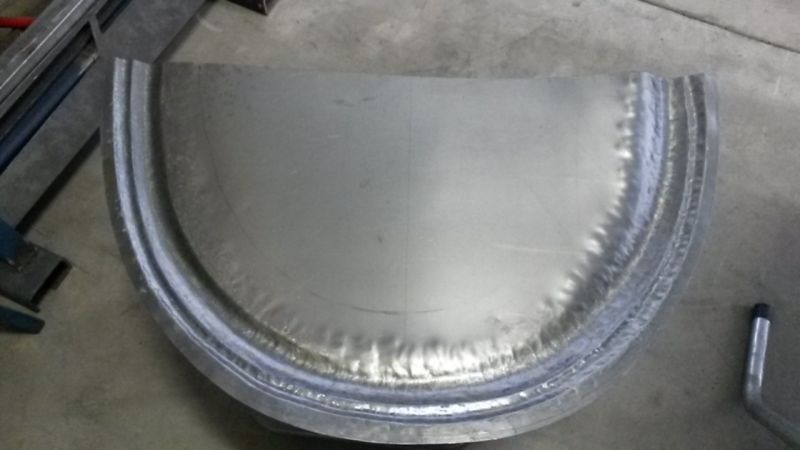

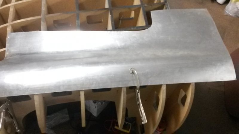

                              • well it's been a while since i last updated this thread, lots of things going on as usual... i've got one door on with the outer skin attached, the other door is almost ready for the skin to be attached, and then mounted back on. i've had to make another windscreen scuttle as i wasn't all that happy with the first, and i've made the l/h front guard/fender/wing in two pieces instead of three like i did the r/h. that was more complicated holding it together to do a 4ft weld lol
                                top of the l/h guard/fender

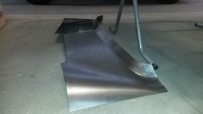

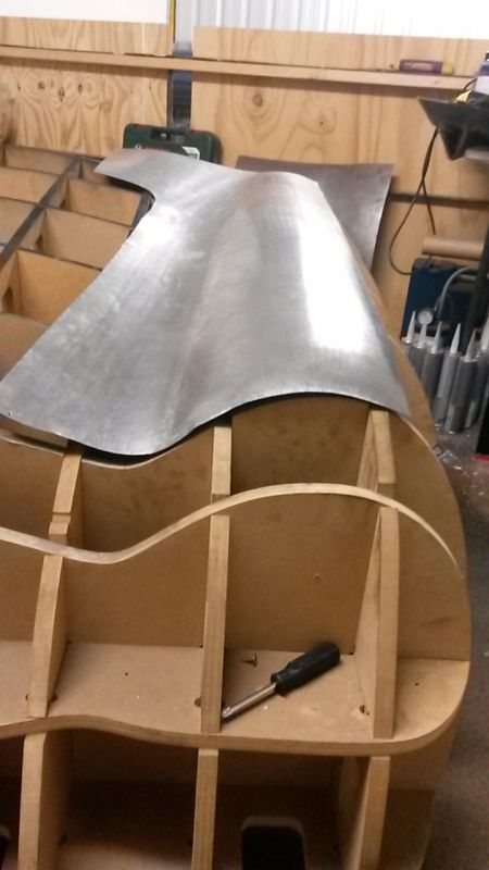

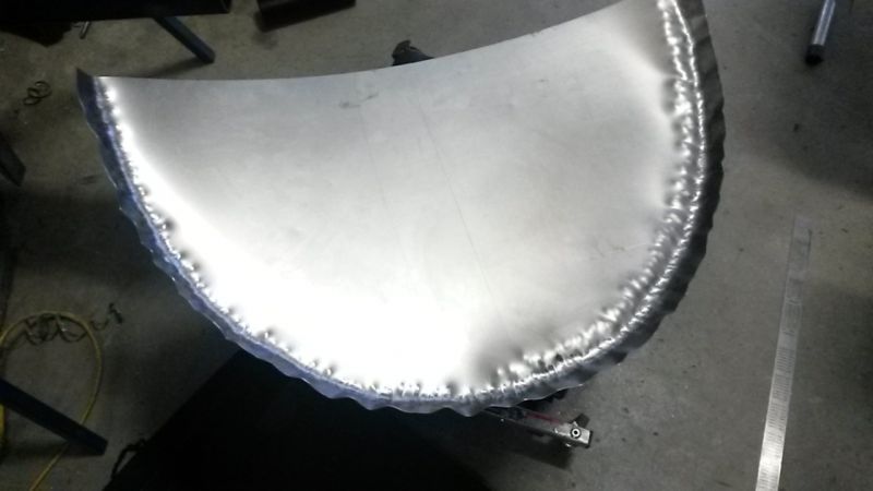

                                closer fit now
