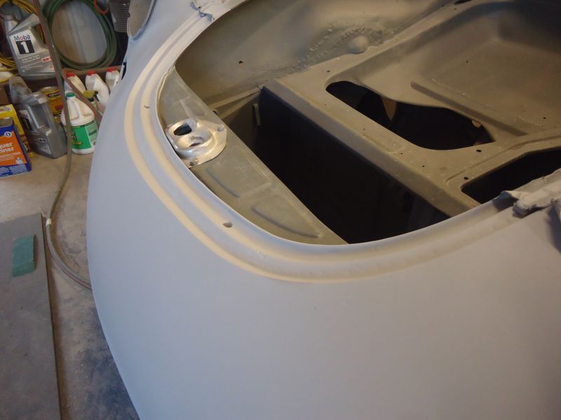

        Hello all, and hope everyone is enjoying a nice Labor Day weekend (for those of us in the USA). Been a very long time since a Swiss Miss update. Not much to report Been primarily working on getting the old '72 911 back together for my friend Carlos. But that doesn't mean I don't enjoy keeping tabs on all the great projects here. You guys make great progress. Wish I were as productive.

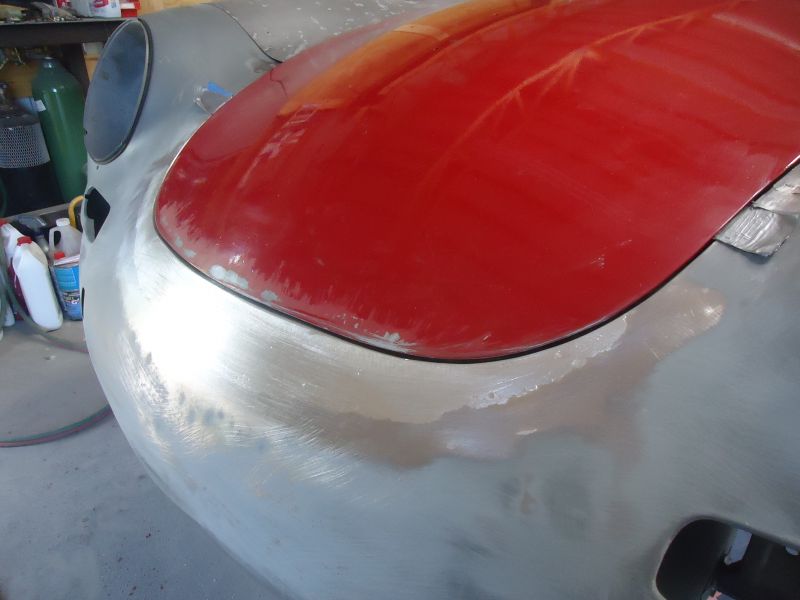

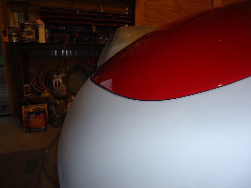

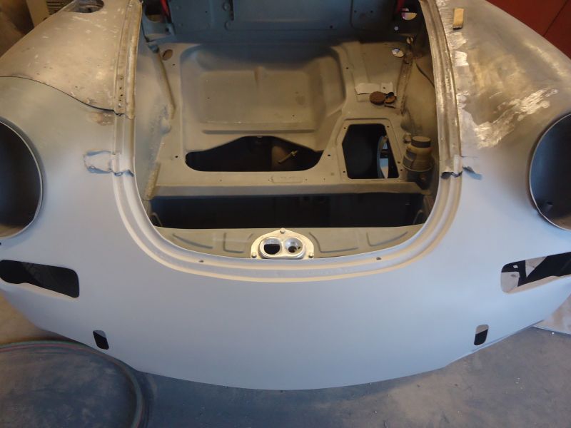

        However, I've snuck in a little Swiss Miss time the past few days, and wanted to share a few pictures. When I left off, I'd just finished replacing the front 12 inches or so of the hood skin and inner frame. Since then I've finished smoothing the hood, primered, and painted it. Just wanted to see what it would look like, and also wanted to see if the Ruby Red paint code I had was a good match.
        Next I fitted it, and leaded the front gap. There was no lead at all on this nose to start with. It now has a little moon shaped smear around the hood, but nothing excessive. I though it came out pretty good.

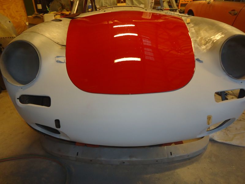

        Filled a few pits and shot a little primer on it.

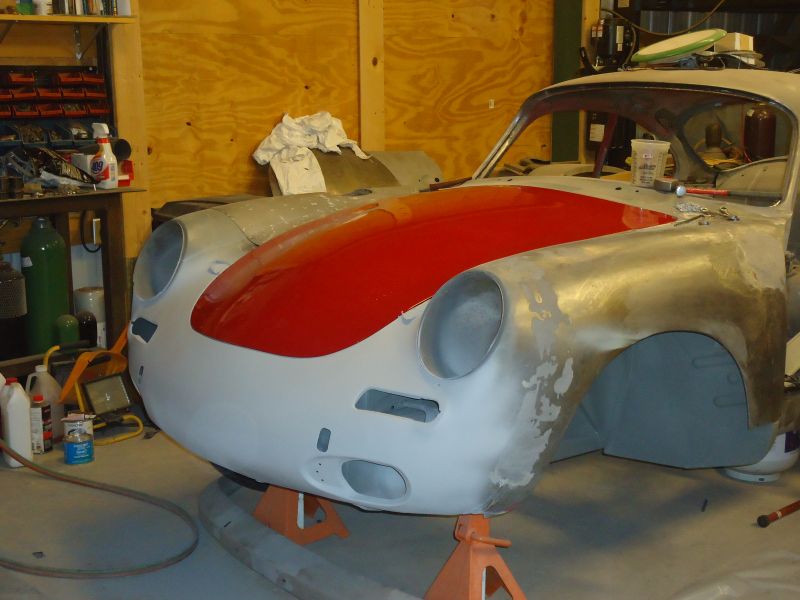

        A little more finish work on the hood, and a little more red paint (it will get sanded down and properly sprayed with the rest of the car when the time comes).
        I'm pleased with the hood and nose. Its come a long ways from when I started.
