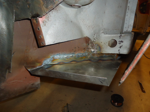

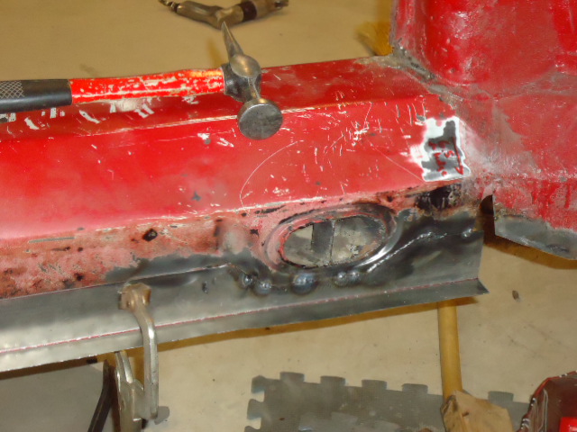

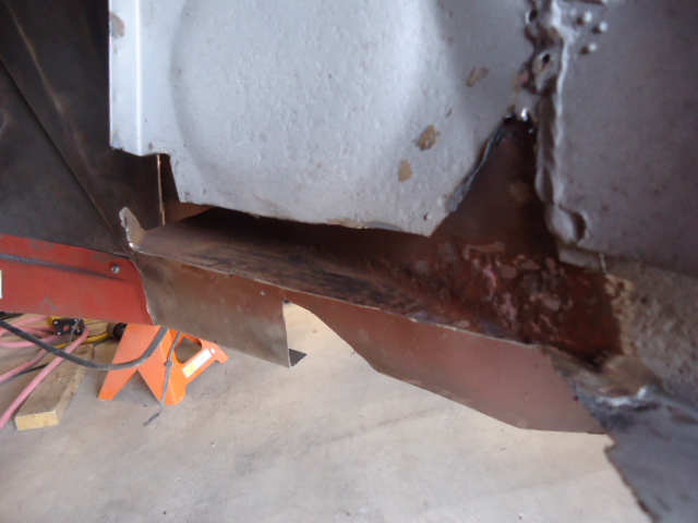

            Well, I wrapped up the repairs to the left rear frame member, and moved on to the longitudinal. The usual repairs to the bottom of the inner longitudinal. And unfortunately there was a small strip of corrosion at the base of the hinge pillar support. Had to address that first.
            The Problem
            The fix

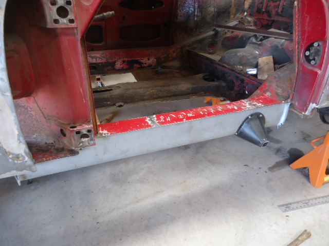

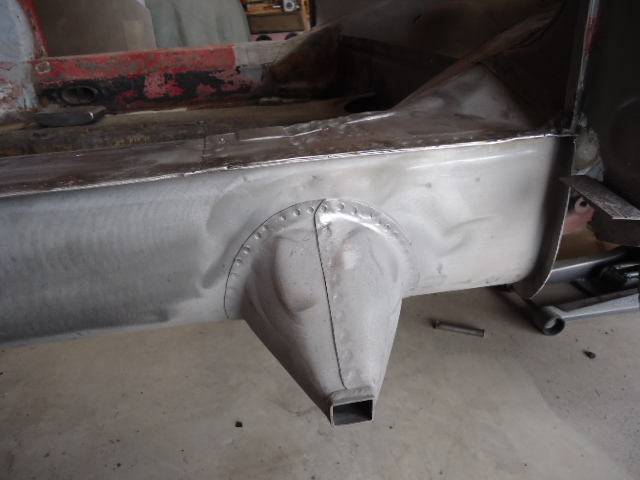

            Test fit of the outer long. Located the jack spur, so I could spot weld it to the longudinal before final assembly.

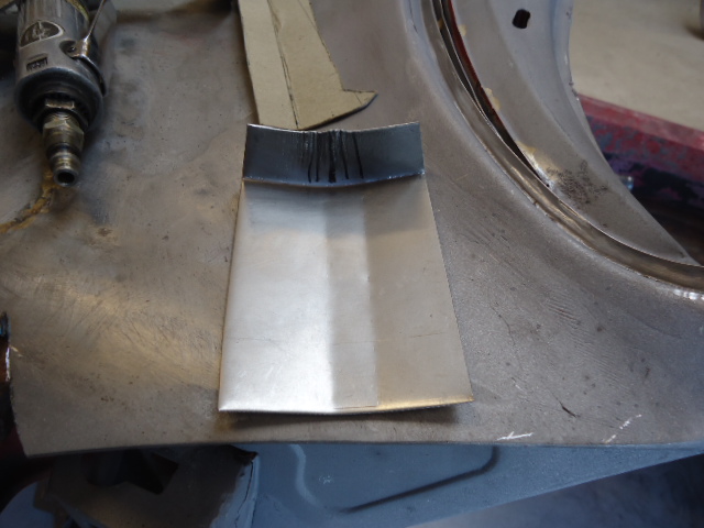

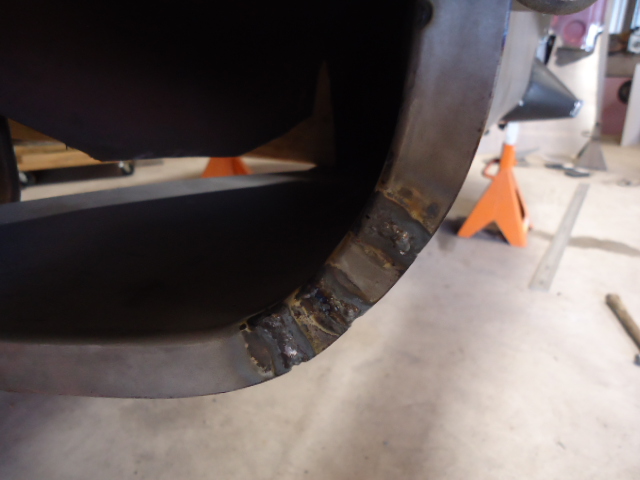

            I've gotten in the habit on my projects of cutting three little slits in the flange at each end when I first fit the outer long. Then I fit it to the car and weld up the slits. This sets the curvature and when I go back and put it in place for good I don't have to force it. Works for me anyway.

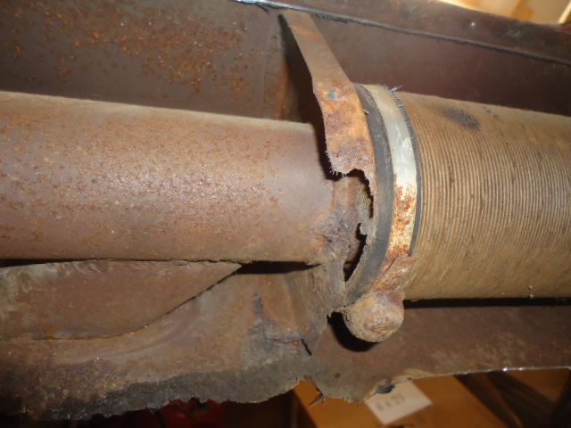

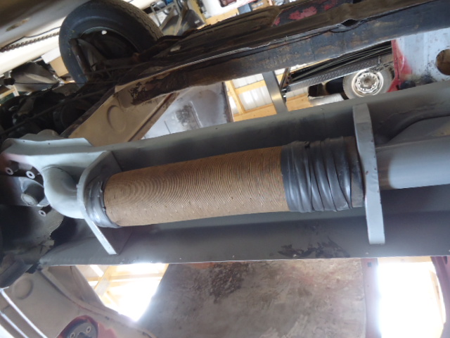

            Heat tube supports and heat tube re-installed. The heat tube was in great shape, except one end was scorched from a previous patch job on the longitudinal. To protect and re-inforce it , I wrapped it with 3M rubber tape. Probably not needed, but it made me feel better.

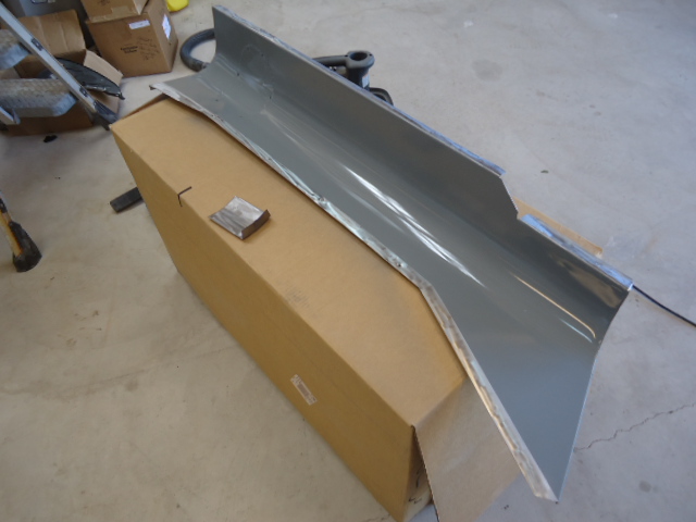

            Outer longitudinal prepped and painted for install

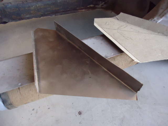

              Jumping around a bit, here is the old longitudinal/heat tube/support. You can see that scorched spot on the heat tube.

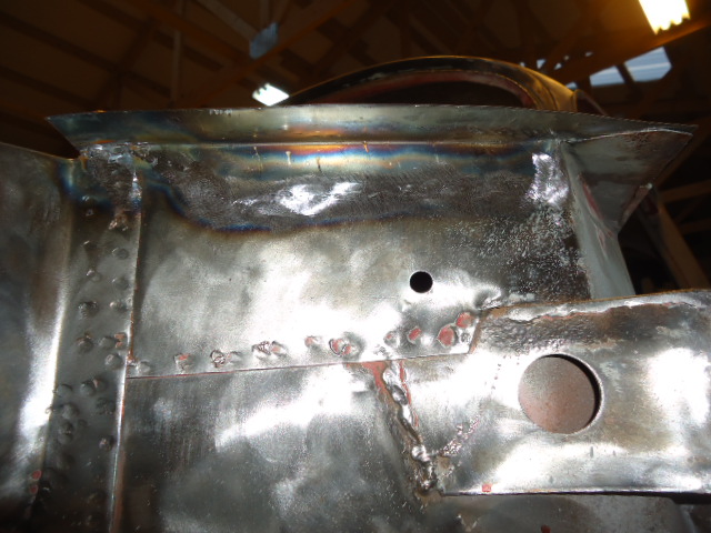

              Stitching in the long ledge repair piece

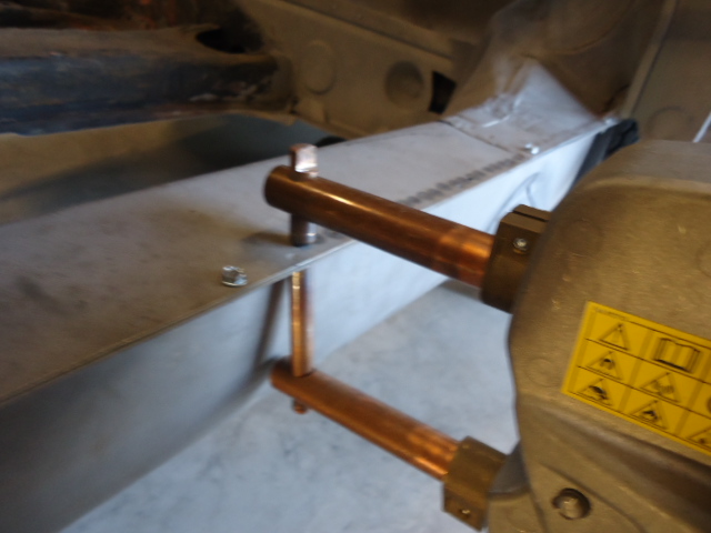

              Attaching the outer long. with the spot welder

              Detail of the spot welded jack spur. Probably stronger than the factory did it!

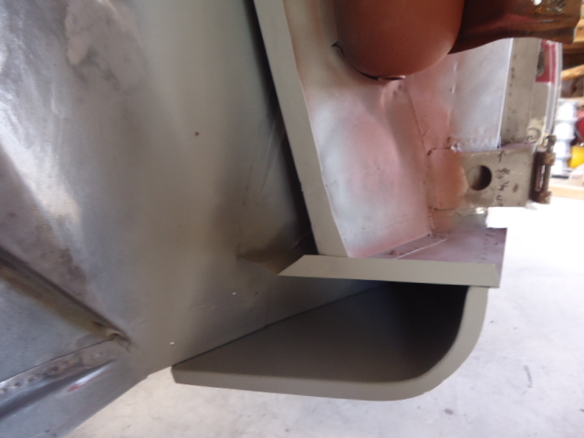

              Prepped for front closing panel. Everything thoroughly painted inside the sections before they get closed up.

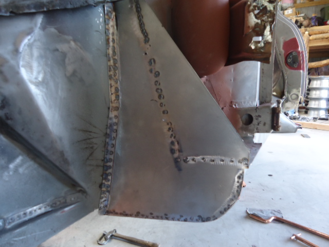

              And the front closing panel fabricated and installed.

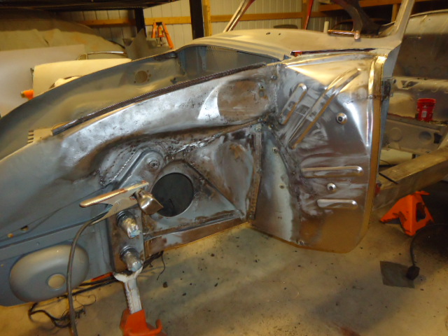

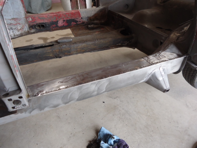

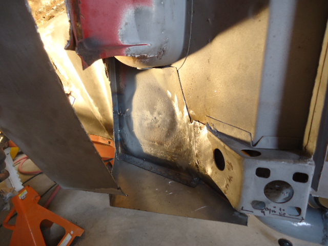

                    Here's some more views of progress

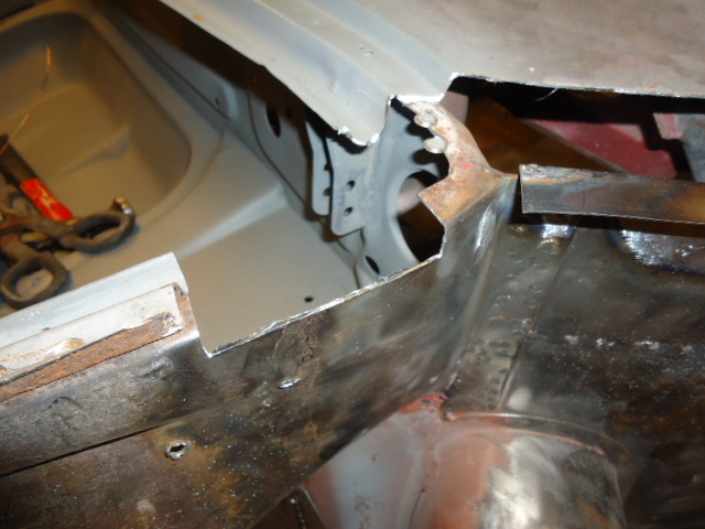

                    Before I could fit the outer closing panel, had to repair a few spots at the top of the hinge pillar/inner fender area. Easy fixes, but like all these little tasks, time consuming.

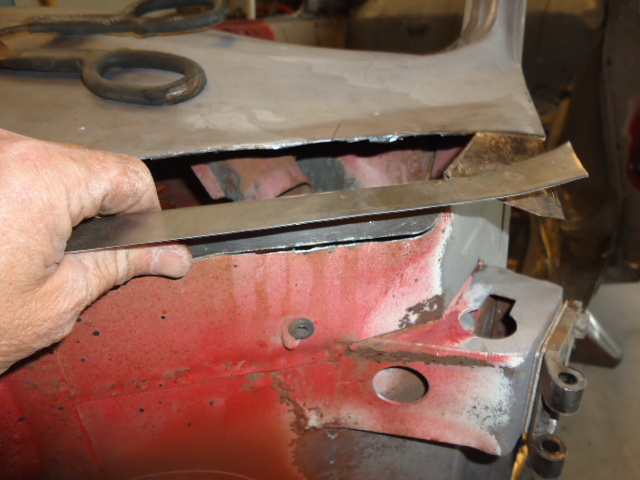

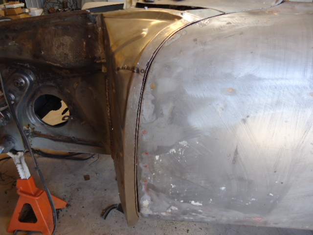

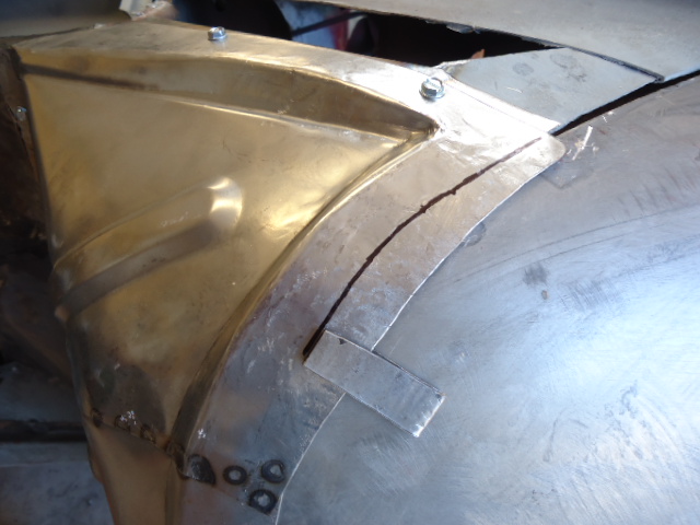

                    Preliminary trimming of the outer closing panel to fit the door curvature. I try to do this in several small steps. It has to be trimmed partially during the fitting, but the final trimming should best be left for after the panel is welded in place.

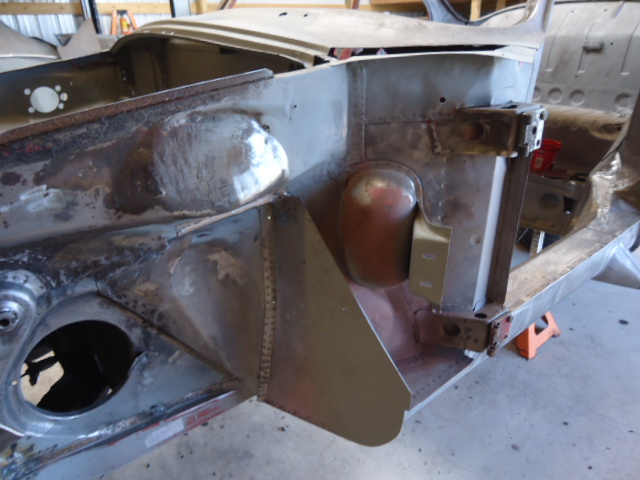

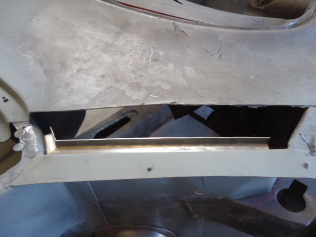

                    Fabricated and installed a new little channel for the weatherseal under the fender/cowl joint.
                    Ready for outer closing panel
                    Outer closing panel installed

                          Question... How did you determine the vertical position of the jack spur without the rocker?

                            To locate the jack spur, I hung the door, temporarily positioned the new rocker panel, then positioned the jack spur. And people wonder why it takes so long to do this work. Take it apart, put it together, take it apart, put it together, take it apart.....
                            This is the first time I'd done the jack spur this way, welding it to the long. while the long. is off the car. Worked perfect and I'll never do it any other way again. So nice to be able to get to the backside with a dolly and really snug up the contours of the jack spur against the long. panel
