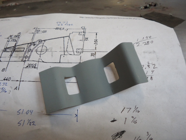

    For better or worse, I jumped headfirst into metal repairs on the C coupe. Re-assembling the battery box today, but I am not certain of the battery bracket location (nothing was present to show me where it used to be). Can anyone tell me the "correct" distance from the rear battery compartment wall to the rear edge of the bracket. Also the minimum distance between the adjustable lateral movement tab and the right side battery compartment wall? I could just plunk a battery in and fit it to that, but maybe there are real dimensions it should have.
    Thanks,
    DG

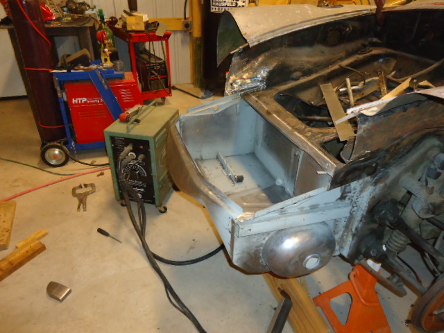

    I got the measurements I needed and finished up the battery box this afternoon. Here are a few photos of the task

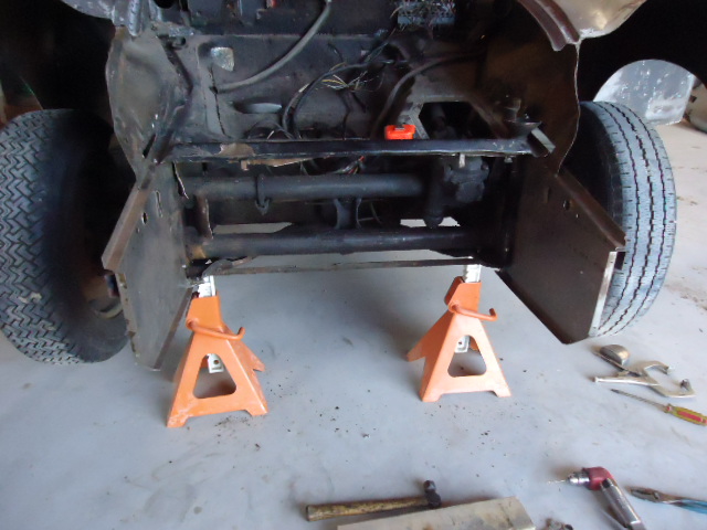

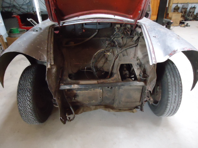

    In the beginning! Somebody long ago cut the nose off this poor old car!
    The rear wall could have been saved, though the bottom couple inches was rotten. But I wanted to replace the sides complete, spot welding them to the front beam, which meant the rear wall had to go.
    At first I was trying to fit the reapir pieces that had come with the car. But they were a little short to fit properly, and were the "flat" types without the gas heater bubble and contour at the top. So I splurged and ordered new sides along with the new rear wall.
    Everything fitted up with screws first. A jillion measurements!

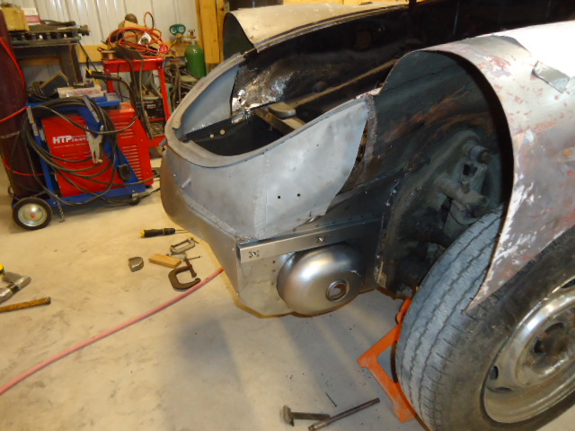

    Test fitted the new nose before pulling it all back apart and firing up the welders.

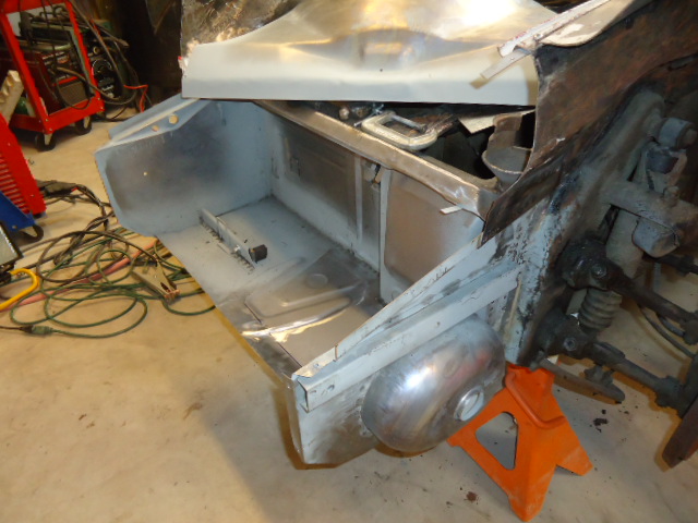

    Side panel spot welded to front beam. This panel gets sandwiched between the beam and the inner fender. Broke the spot welds and folded the inner fender back out of the way for access.
    Then flattened it back and spot welded it to the new battery box side. Made a noticeable difference in the rigidity of the battery box side.
    After doing the other battery box side the same way, the rear wall came next. Oddly, the new sheet metal didn't include this bracket, so I had to harvest it from the old piece.

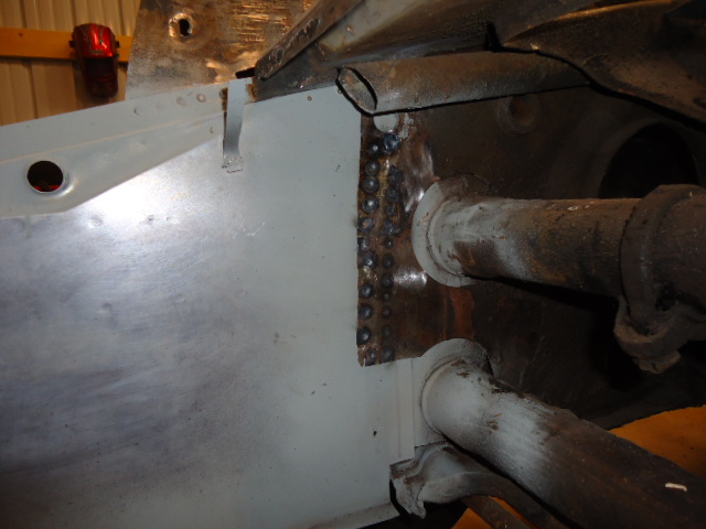

      The rear wall is starting to take shape. This was a surprisingly easy task. The parts fit pretty well, and everything could be reached with the spot welder. Only slightly tedious part was welding the battery cable tube into the new piece. Working access was a little tight and the tube itself had a soft spot at the top. Blew a hole in it and had to dink around a bit to get it filled.
      Here's the battery cable tube coming through. Got a really nice smooth weld around it, but it took a while. Lying on my back welding above my head gets old.
      Here's the second part of the rear wall. Stopped taking pictures for a while I guess, and didn't take this until after the floor was in.
      Floor going in, along with the subject of my first post today. Wasn't sure where the battery bracket set, but got it figured out OK.
      Close up of the bracket. I use weld through primer between pieces I'm spot welding, so its all over everything by now. I think it actually makes the welds a little better. Not true for gas or TIG though, which get very sputtery with the zinc.

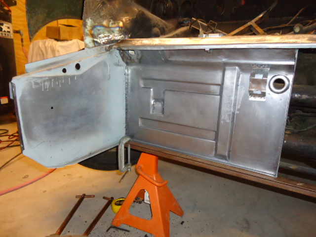

      Finished it all up with the front wall. Another easy piece to install.

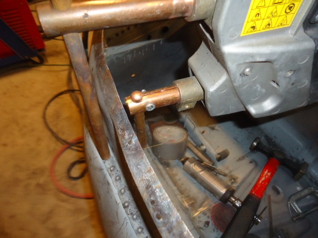

      The pinch spot welder arms would only reach to the bottom of the front wall. To finish the seam between the front of the floor and the front wall, I used the Lencospot. Don't know what would have been original, but I left a little over an inch of overlap between the panels, and made a double row of spot welds here, one from the top, the other from the bottom. Can't hurt.
      The finished product. Next I'll reinstall the upper front trunk wall and get the nose back on this baby!
      Take care,
      DG

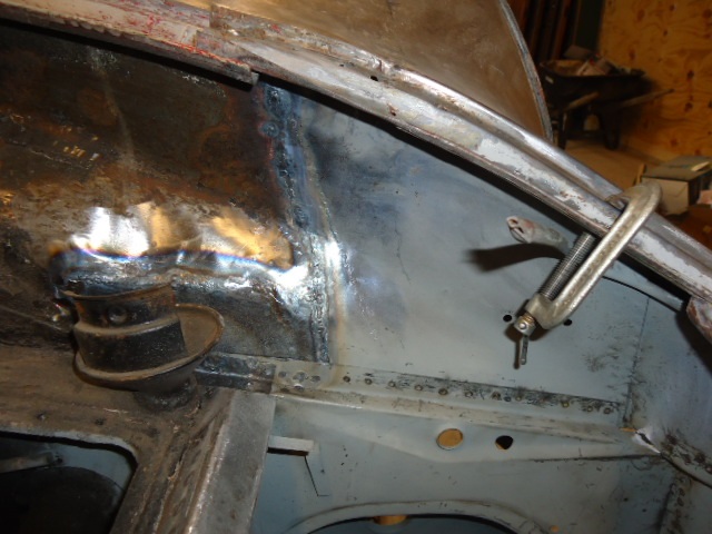

                  A little update on the '64 C project. Continuing to make progress. After the last post, I rebuilt the upper trunk walls. These were salvaged from a parts car.
                  Spot welding the upper front trunk wall in place.
                  New portion of the right upper trunk wall
                  New portion of the left upper trunk wall. Spot welded to battery box side and front wall, butt welded to existing trunk wall

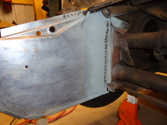

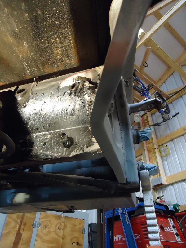

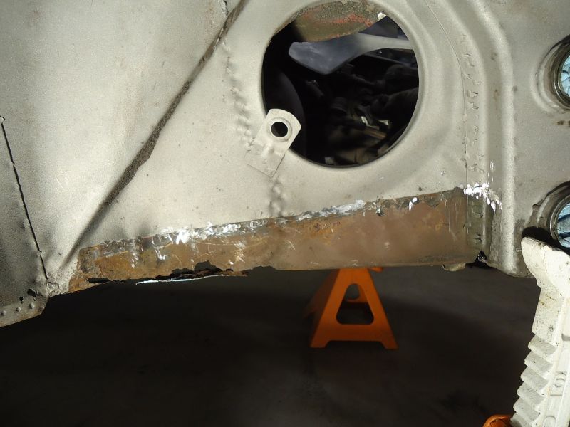

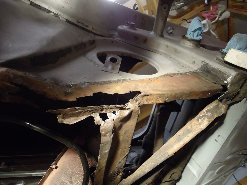

                  After finishing the front trunk wall I started looking at the floor perimeter. More problems than I first thought. The Right side front box section was shot. Here it is after removing the "strut"
                  And from below. Uh oh!

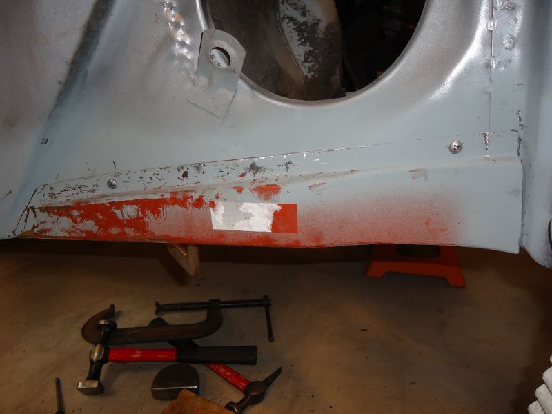

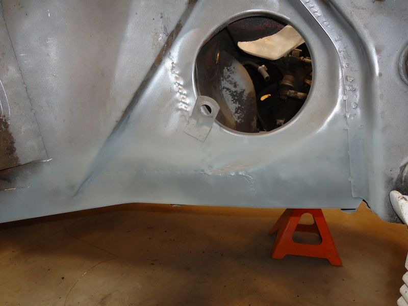

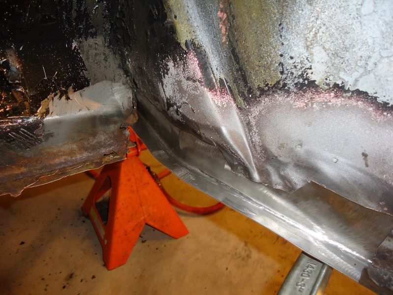

                  Here is the repair piece I made for this area. Normally I'd have used 18 ga, but found I was out, so made do with a piece 16 ga. I don't think a little extra strength is a bad thing here.
                  From the inside. Bend in the flanged patch panel made with a stretcher

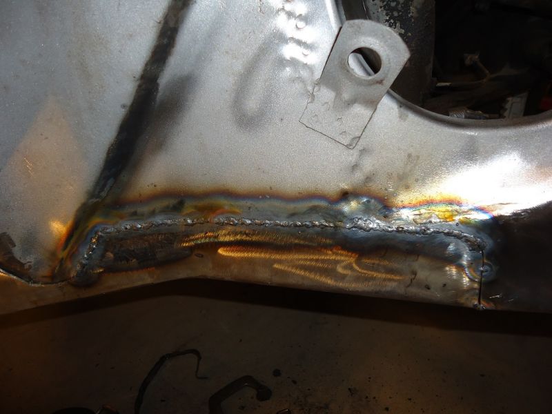

                  Welding the patch.
                    The new piece of "ledge" looking up from underneath
                    After welding, sprayed with weld-thru primer prior to installing the "strut"
                    The "strut" fitted and screwed in place, ready for welding

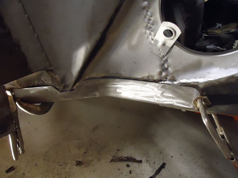

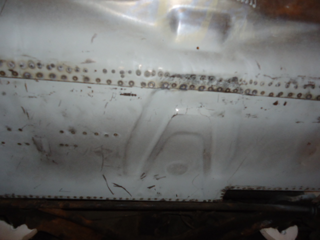

                    And the "strut" after attacking with the spot welder, and the TIG for the front seam.

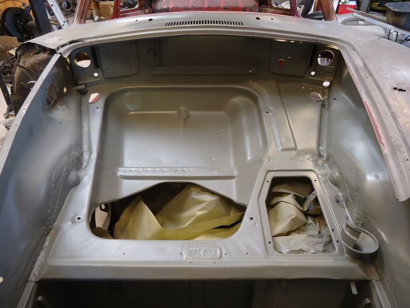

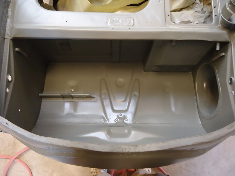

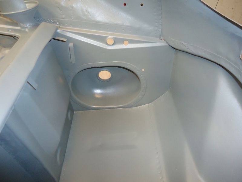

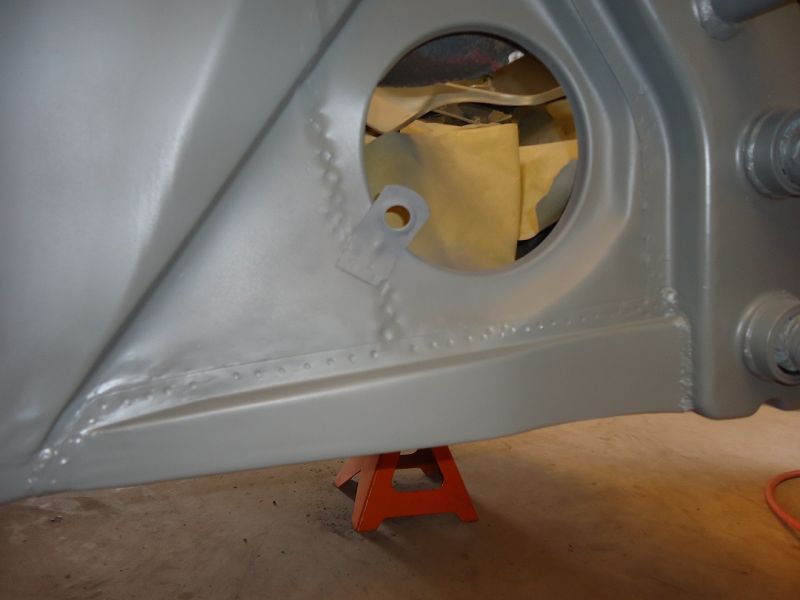

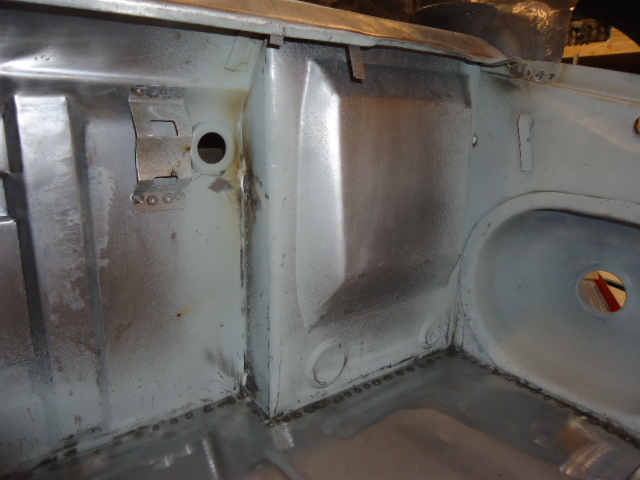

                      Cleaned, brushed, and blasted the front compartment and right side fender well over the past week. Today I sprayed everything with DP40. Nice to see things looking a little more finished. A big change from a car with no nose. I guess the C coupe is here to stay. Originally I was just going to put the nose back together and put it up for sale. But its kind of growing on me now.
                      Started as this
                      Now this
                      A few more views. Pleased with how it is turning out so far.

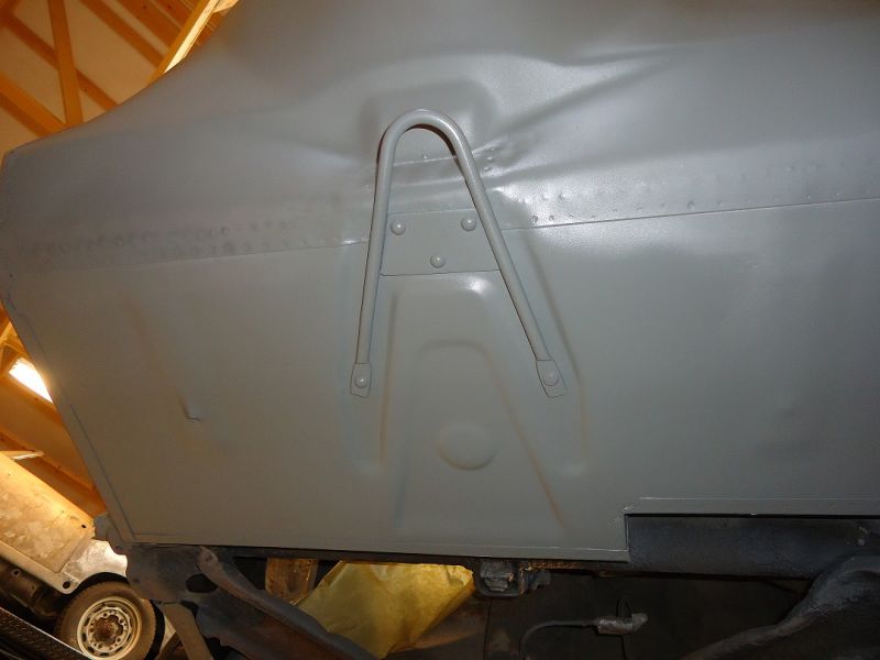

                      Next is to tackle the left side "strut", repair the lower edge of the front bulkhead, and also to finally and permanently attach the nose.

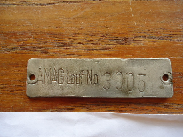

                          The AMAG tag, which attaches to the rear engine tin.
