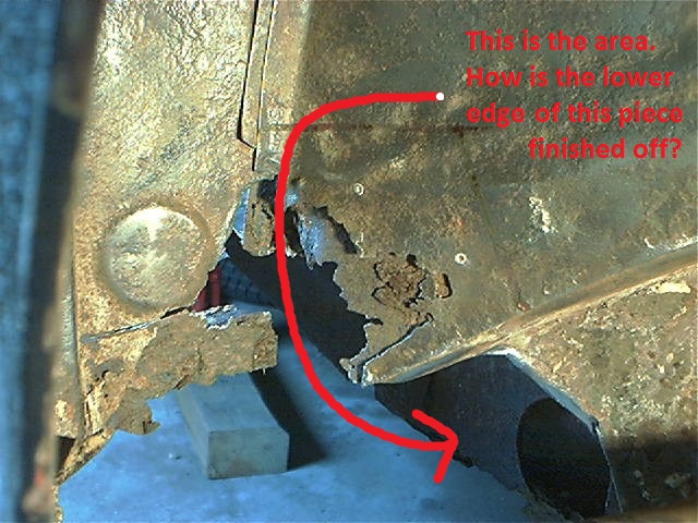

                  Phil and Tom, Thanks for your replies. Yes, this is exactly the area I am interested in. Any additional photos would be a big help.
                  Specifically I am wondering how to finish off the bottom edge of this piece (the lower 1.5" of mine is just completely rusted away). Should there be a lip on the bottom? Possibly overlapping/welded to the ledge on the interior piece, which clearly has (had) the ledge for the floor to rest on?

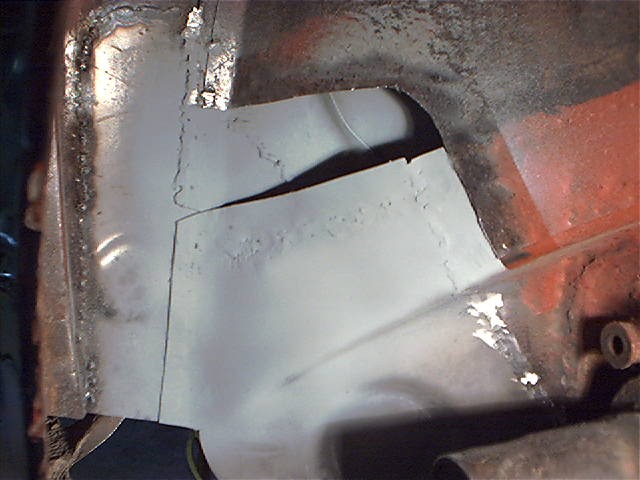

                    I did this repair a long time ago so memory a little foggy on sequence. If you have the exploded parts for that area that will help. You need a good lock pillar. I had to replace the lower section on mine. Not too hard to make yourself. Next I think the closing panel at the rear of the longitudinal goes on. Then another piece on top of that that I show below. My repro closing panels from Stoddard needed some "adjustments" to fit Foamcar. I may have more pictures, but this is a start.

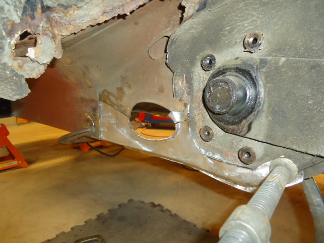

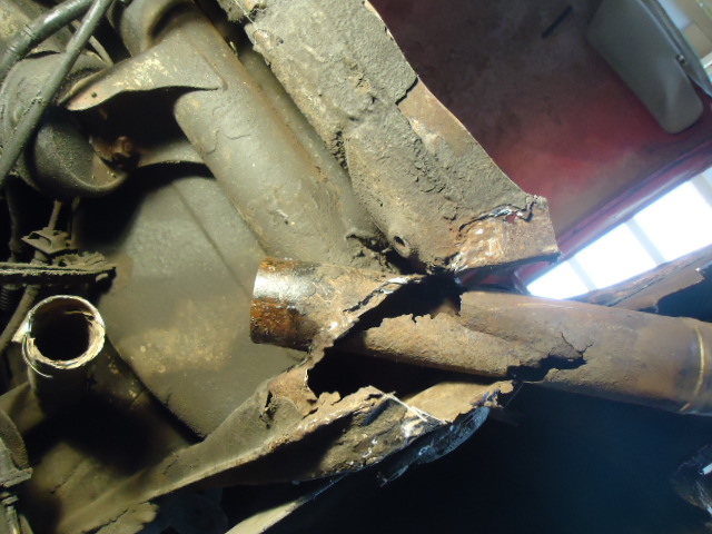

                        Maybe this will help. I made the repair piece as at the time none were available that I was aware of. I think they are now available.
                          Phil,
                          Perfect! These are exactly the photos I needed to understand how it is all is supposed to be in this corner. And now I also understand the repair panels vendors sell for this area. I'd considered buying them, but really only need a small portion at the bottom of the outer frame member, and just to repair the "ledge/fin" on the inner. I will fabricate very close to the same piece as you did.
                          Much Thanks,
                          DG

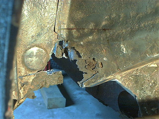

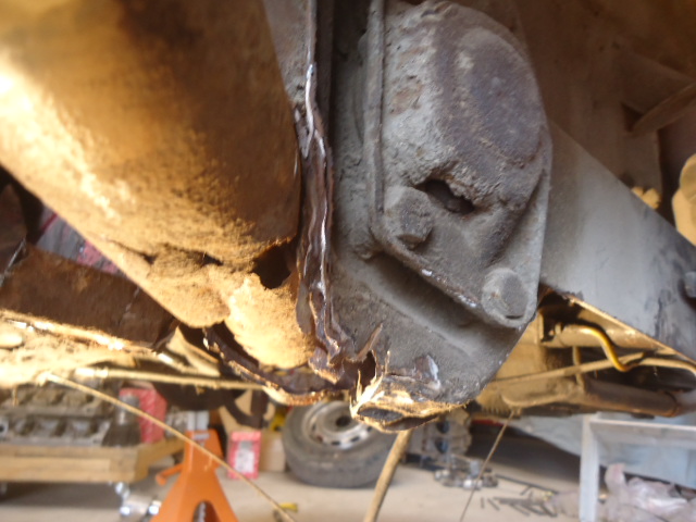

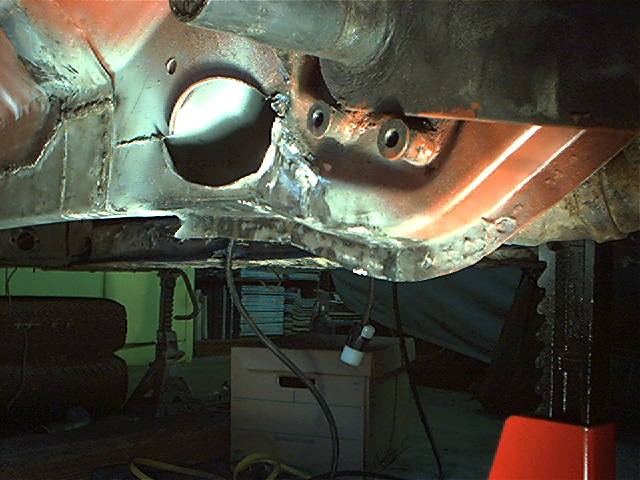

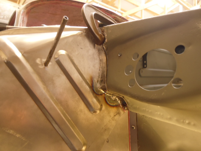

                            A little update. Have progressed with the right side closing panel area, and the left rear frame member repair. Thanks to Phil's photo I have a better understanding of how the frame member should be. Very interesting, and a little disheartening once I got in there. It didn't look so bad at first, but quite a bit of it was rotten. Someone long ago had brazed a couple small patches in the area, then had carefully sculpted the shape under the torsion bar bushings out of bondo! But it will be OK. Nothing that can't be fixed.
                            Here is the area, looking up from below.
                            And again. Some of this is bondo. Wound up cutting quite a bit away.

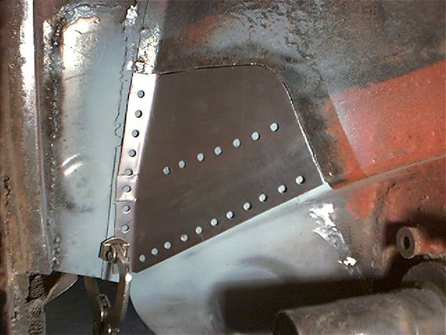

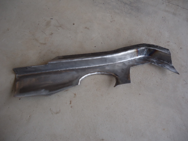

                            Repair piece fabricated, very similar to what Phil made for his car.
                            Fitting, not welded yet. Need to fabricate the inner piece next.
                            DG

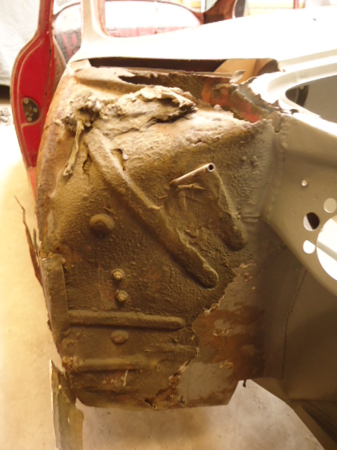

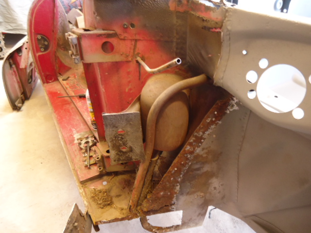

                              Took a break from the left side and jumped over to the right side closing panel. It also had old brazed patches. Total replacement was desirable. And the inner trunk wall corner needed repair too.
                              Ay yi yi! Why do these cars always have to be like this?
                              Closing panel removed, and then I went after the inner one. Oddly, behind the closing panels the metal is pretty good. Just a slight soft spot under the lower door hinge, but will require just a very small repair.

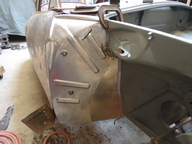

                              New inner closing panel being fabricated. Very easy panel to make. Template made from old, and only a very slight bend at the flange.

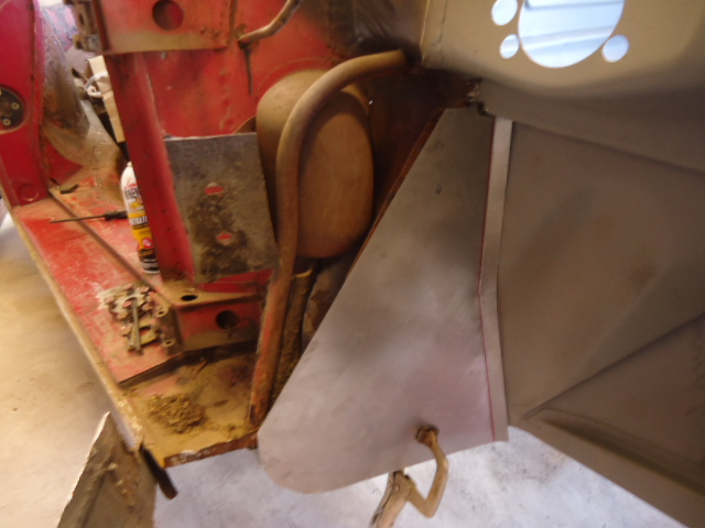

                              Outer closing panel being fitted. Lots of test/cut/fit stuff where it goes against the upper trunk wall. For some reason the vendors never have this area formed right. This is the third car I've done this on, and the third different supplier of closing panels, and all of them required the same fitting.
                              Here's the finished product. Screwed in place. Have some other repairs to make first, before I come back and weld. But its all in the right place and everything fits well.
                              DG
