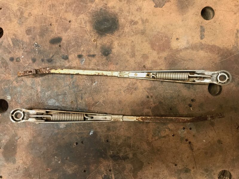

  • I've been working on restoring....derusting.....a lot of the small parts.

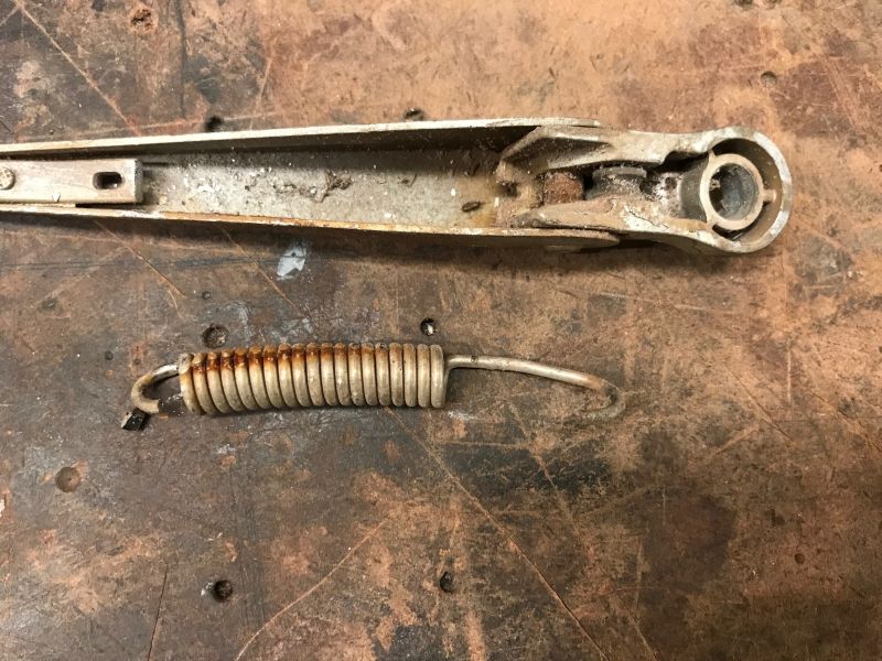

    Wiper arms after sitting outside for 55 years.
    Pretty nasty.

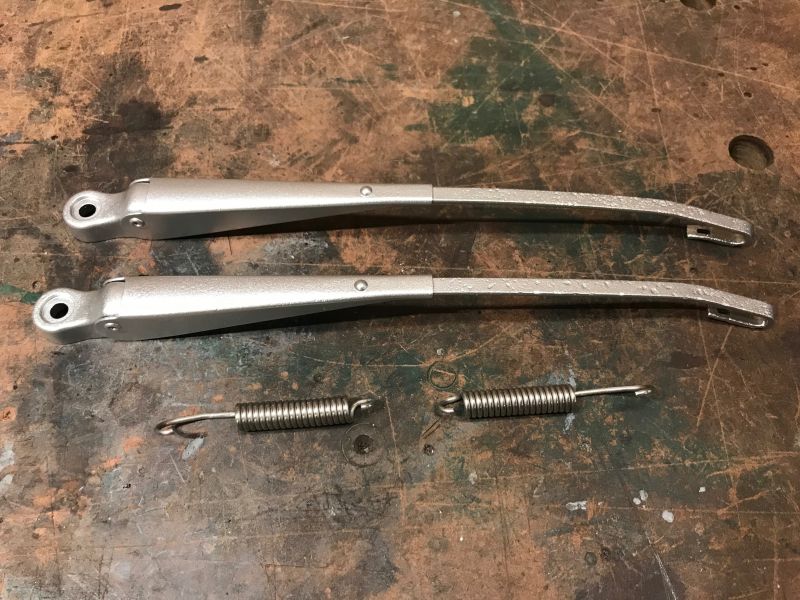

    Media blast and prime/paint for the arms and Evaporust for the springs makes a big difference. I might go back and media blast then reprime and sand between several coats to fill in the pits a bit better. While Stoddard sells wiper arms they are not correct for the T6's.

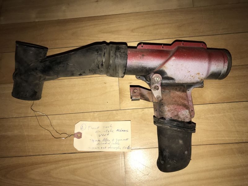

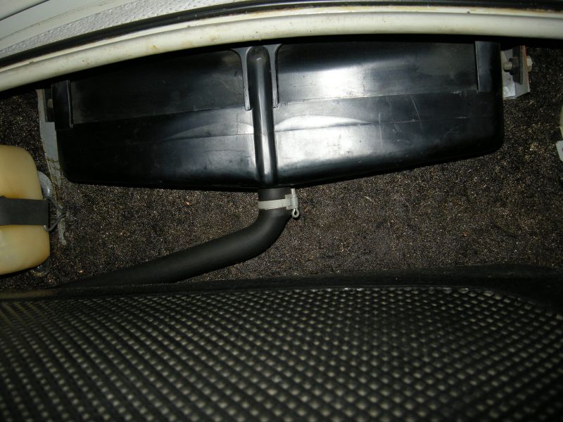

      The early vent boxes had an angled water drain, while the later ones had an elbow. My car was build in August of 1962 so it's an early design. A lot of my car is interesting as it also has some T-5 parts.
      Later design with elbow drain.

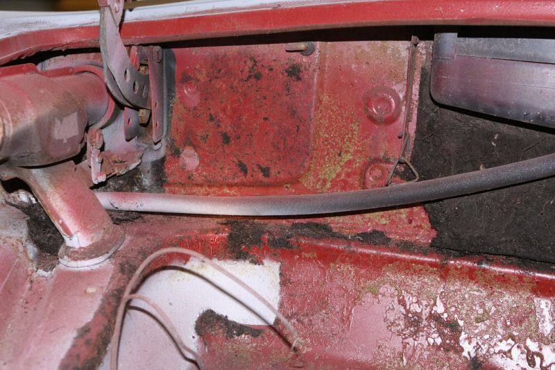

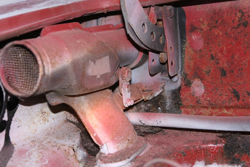

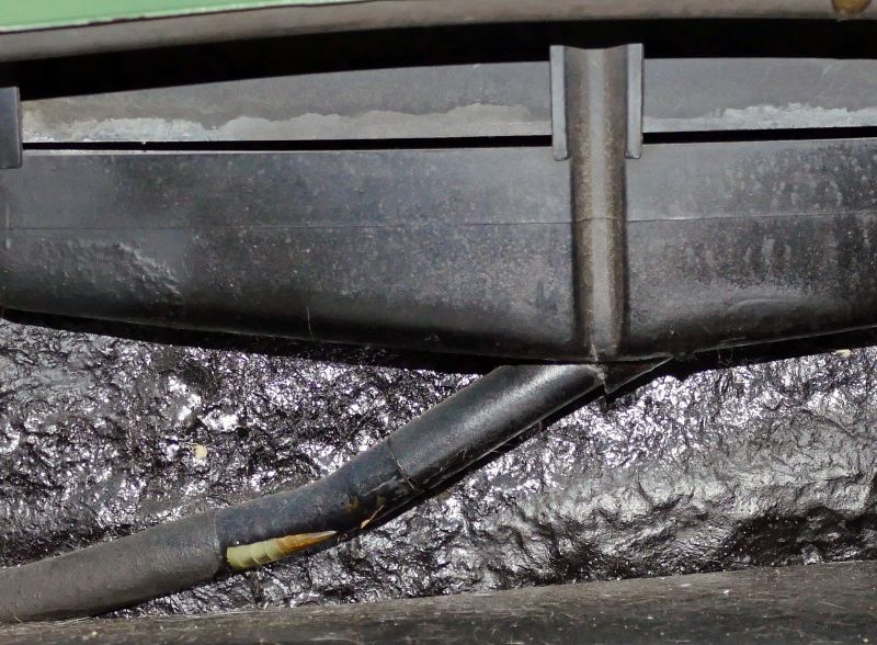

      The rubber water drain from the vent box connects to a metal pipe in the trunk side wall that extends through the passenger door well then drips down below the car. As you can see Bubba was handy with his paint gun!!

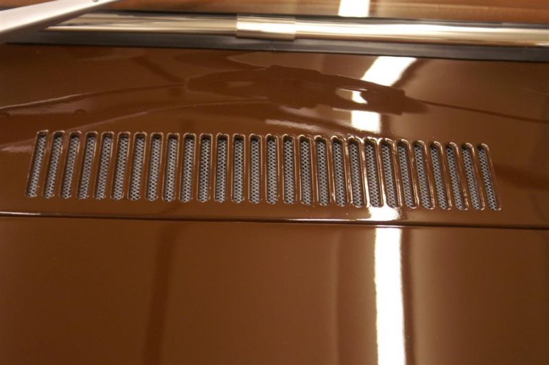

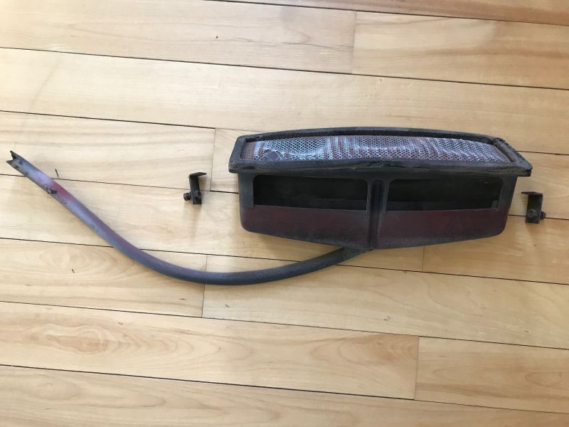

      This is the whole vent box assembly. There are two brackets that hold it in place under the cowl. The T-6 cars have a vented cowl to allow fresh air into the trunk.
      Cowl vents when installed in a nice car

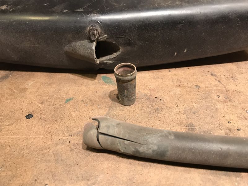

      Rubber drain hose and brass insert to hold it to the vent box.

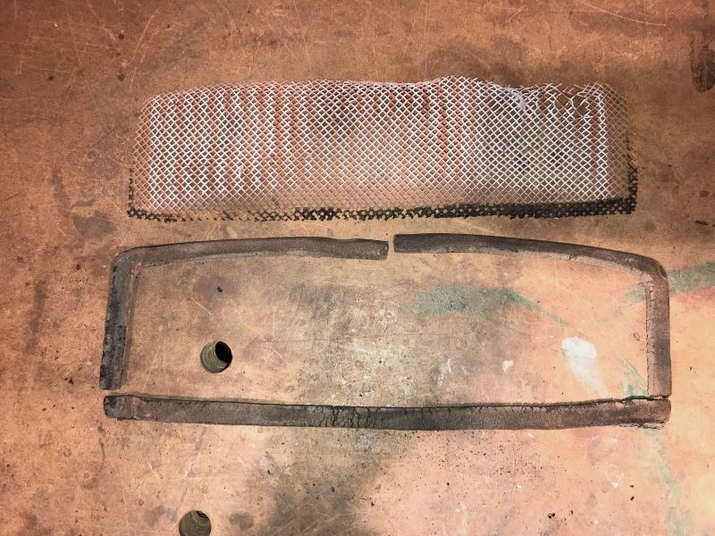

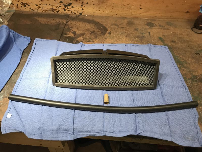

      A woven mesh is on the top to keep debris out. A foam gasket seals the vent box to the cowl.

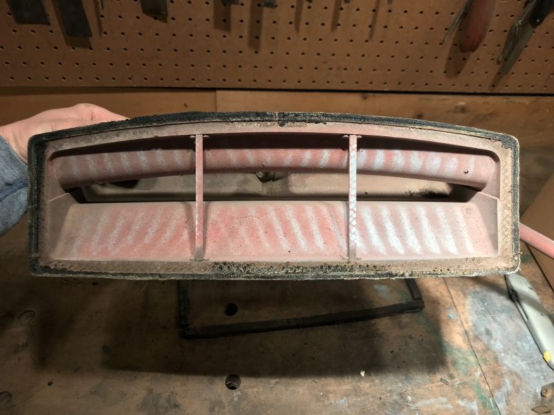

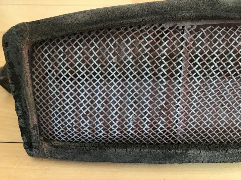

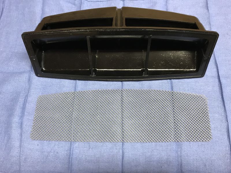

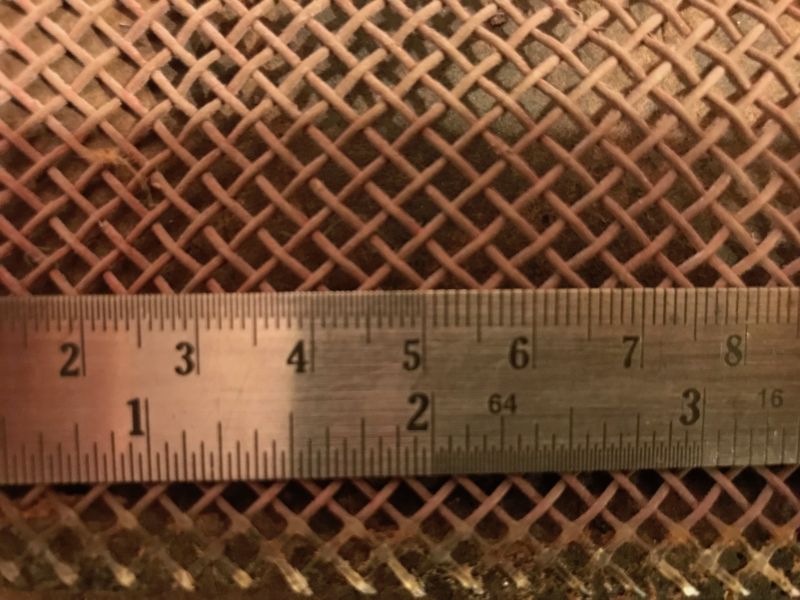

      The mesh was also changed during production. The mesh over the air box in the early B T-6 is woven nylon/vinyl and in later B T-6 thru C is a wire mesh. Both are light grey (off-white) like the C fan shroud.
      Lots of overspray even inside the box.
      The woven mesh is NLA.
ID:	101748Click image for larger version

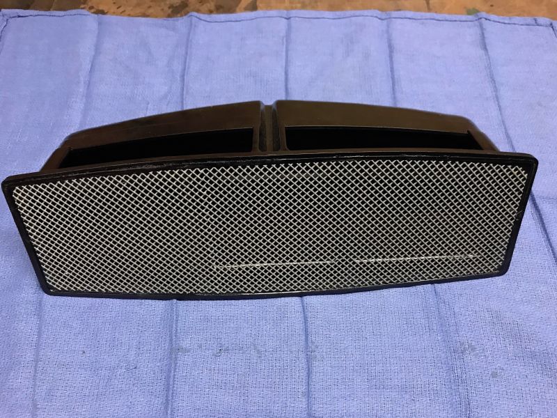

      Industrial Netting will supply a sample piece of netting, which can be cut to size. A small section needs to be glued together to cover the whole area. The box has been stripped of the paint overspray and the netting has been painted the correct color.
      The new mesh glued in place.

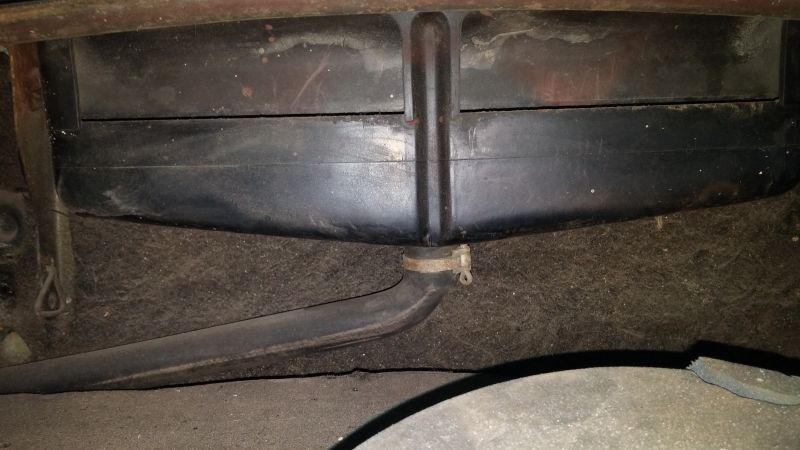

            Heres my tube on Foam car, I believe 1963:

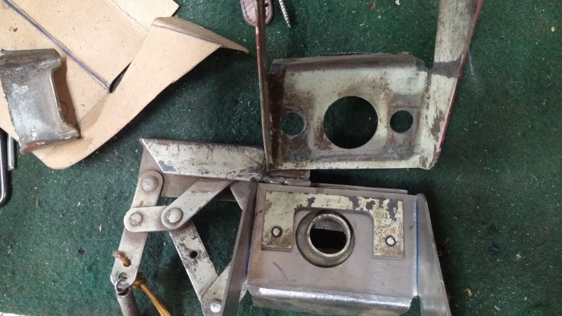

            For more trivia, the bottom of my trunk latch and original bracket have light green paint. Im sure Bruce knows the code

            • My car was built at the Karmann karosserie so they may have had more parts in stock and left over if they weren't building the cars as fast as Reutter. My heater tubes that go through the longitudinal were definitely the T5 style.
              Green primer on your parts?

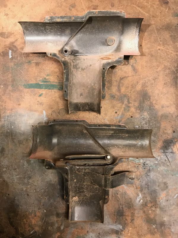

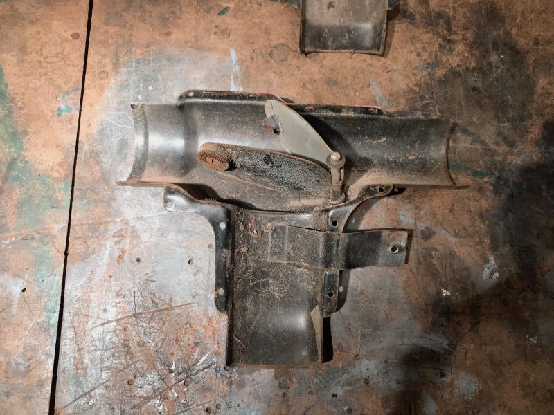

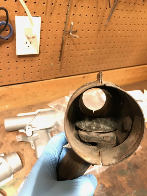

                • Part of the T6 fresh air system is the side vents, which control where the air is vented into the car.

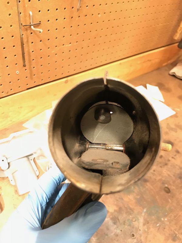

                  The side vents are tucked into the rear side portion of the trunk. A cable from the dash controls their function. Just a bit of overspray on these.
                  Air is vented to the dash and foot well through rubber connectors. These are now reproduced, but are very expensive, so try to refurbish the old ones.

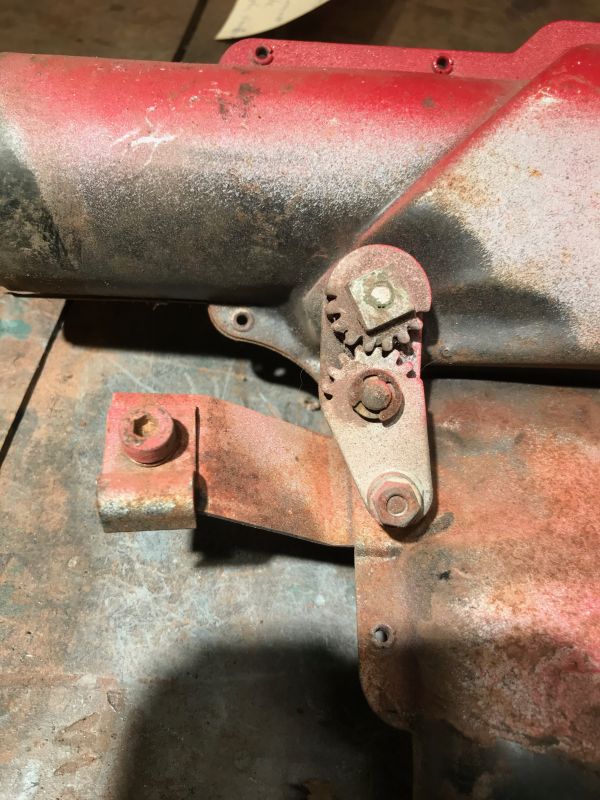

                  The dash cable connects to these cogs to control the internal flaps.

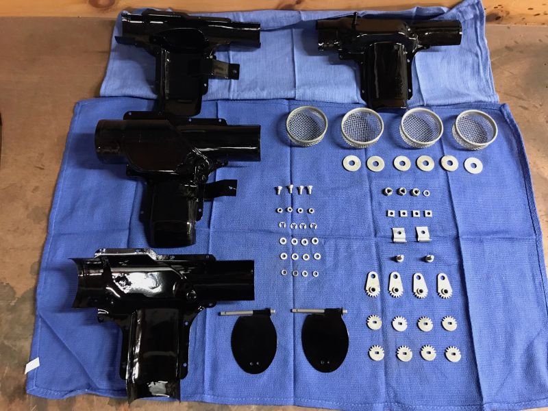

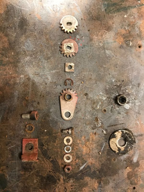

                  Just a few parts to refurbish.

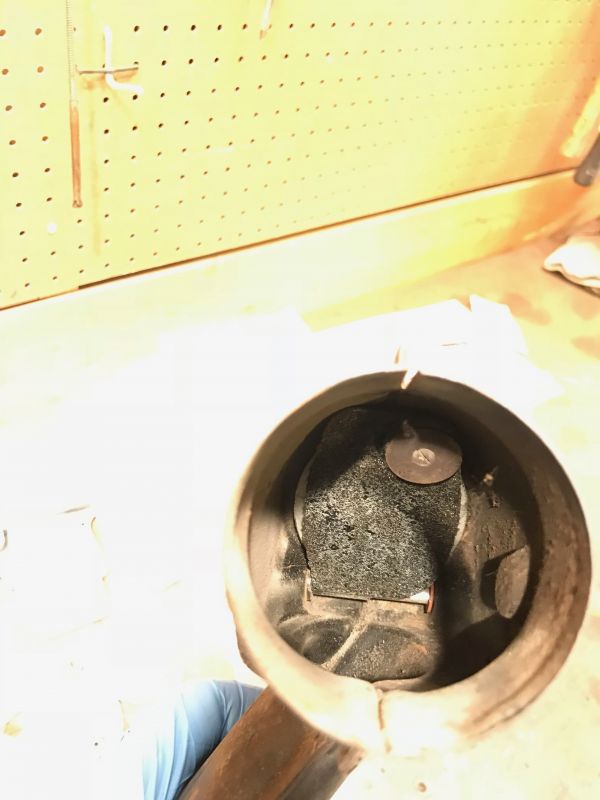

                  The two halves were riveted together, which can be drilled out.

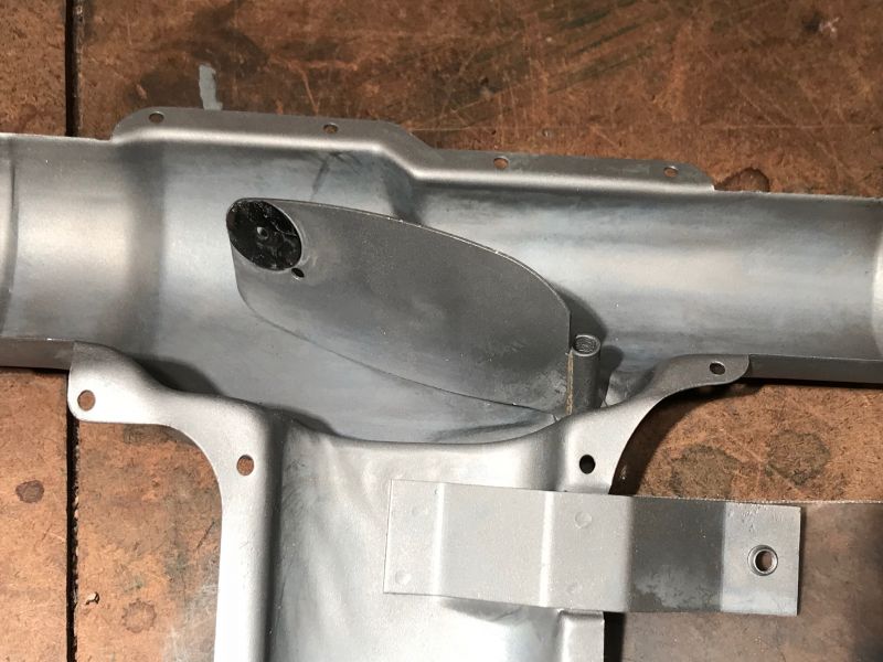

                  Two flapper valves control the air flow and each is held in place with magnets. Foam insulation was originally attached to the flap faces to make a tight seal.

                  Much cleaner after media blasting. The round black area is where the magnet was.

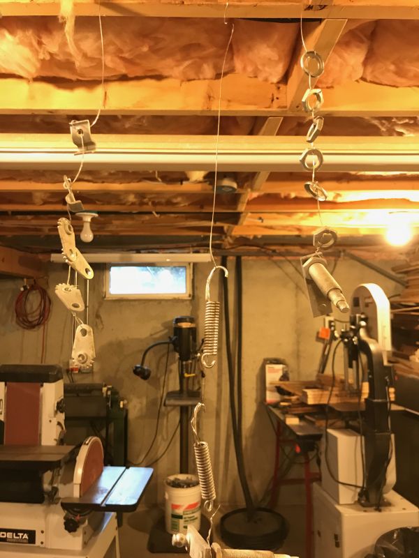

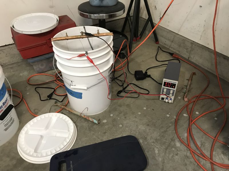

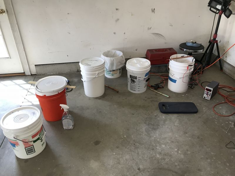

                  Time to replate all the parts. The Porsche parts manual lists what type of plating is required. I bought the Caswell plating system, which is easy to use. The buckets contain a degreaser, distilled water rinse, muriatic acid, sodium bicarbonate, and the plating solution. The degreaser and plating solution need to be heated to 190 F and 110 F respectively.

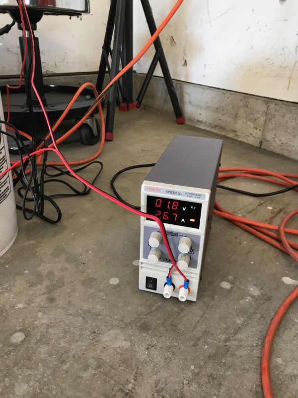

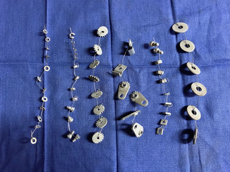

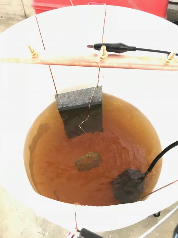

                  Plating occurs with constant current. Formulae can be used to figure out how much current to use, but it's easier to watch how much bubbling occurs during the plating and modify it. This is not rocket science
                  The parts are hung with copper wire on a copper bar. They are degreased, rinsed, acid etched, rinsed, neutralized in sodium bicarb, rinsed, then plated and rinsed again.
                  The parts are placed into the plating bath and connected to the transformer for about 20'.
                  I am zinc plating so there are two zinc plates on either side of the piece to be plated. Later on I bought 2 more zinc plates to give a nice full 360 coverage.
                  After and before picture. The Caswell name for the process is called Copy-CAD. It's easy to do and turns out well, especially for small batches. I like to plate the parts that I'm currently working on instead of getting a whole batch to send to a plater, which then may lose these small parts.
                  Blow dry the parts to prevent streaks and then let them hang overnight.

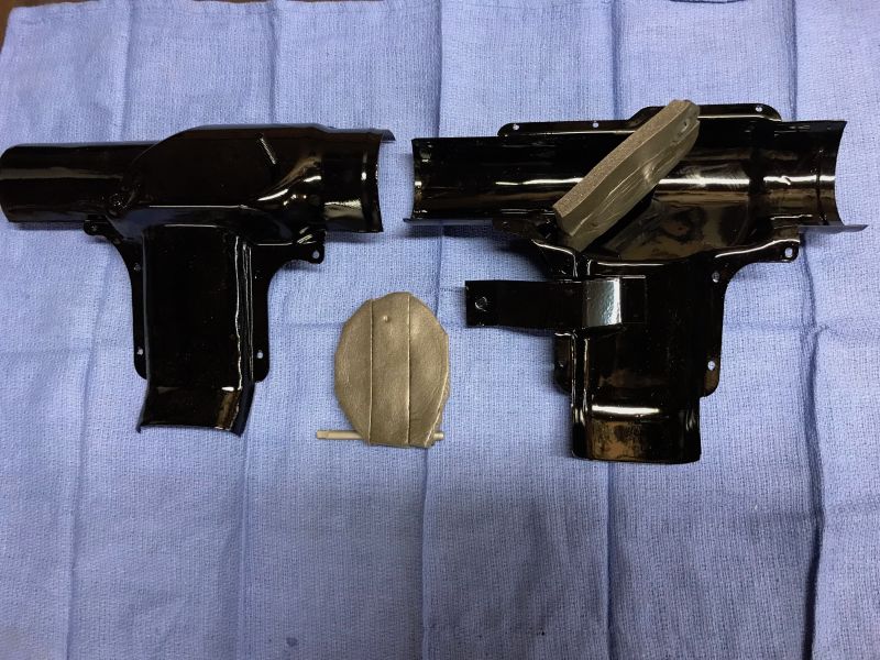

                  This is how they look when complete. Nicely zinc coated. You can control how shiny you want the pieces by adding a brightener to the zinc solution.

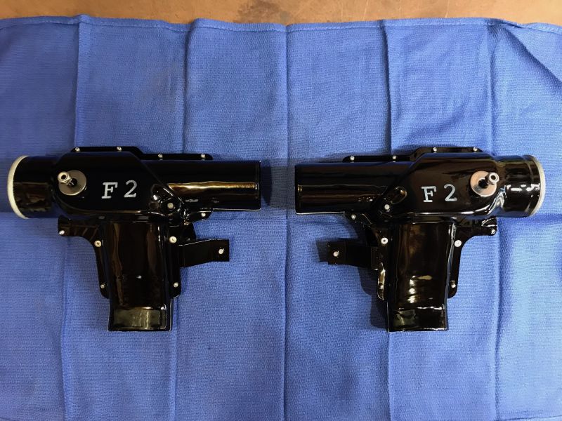

                  The vent bodies were epoxy primed and painted. Now for reassembly.

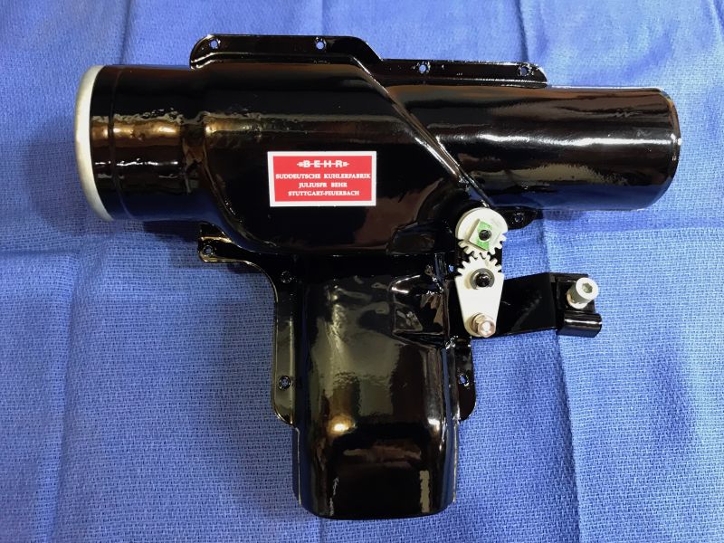

                  I added new foam insulation to the flap controllers to prevent air leaks and whistling.

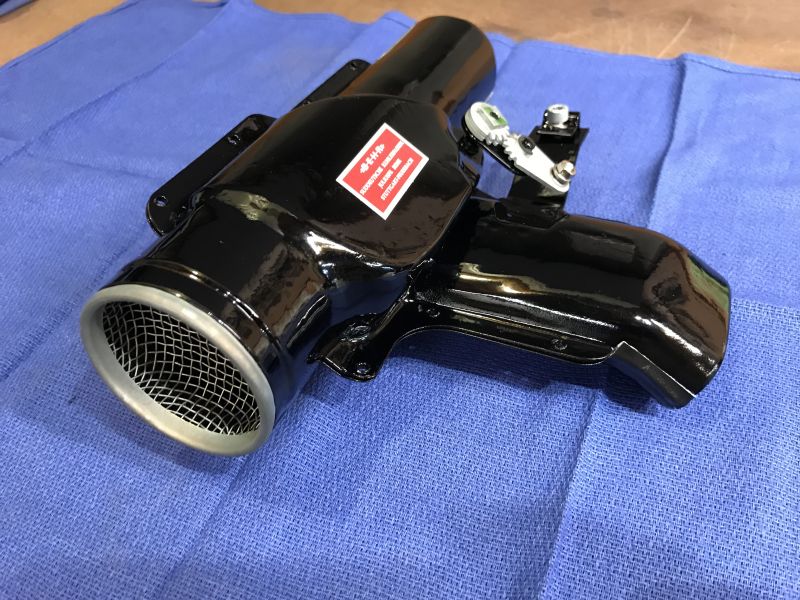

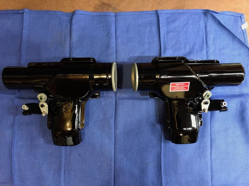

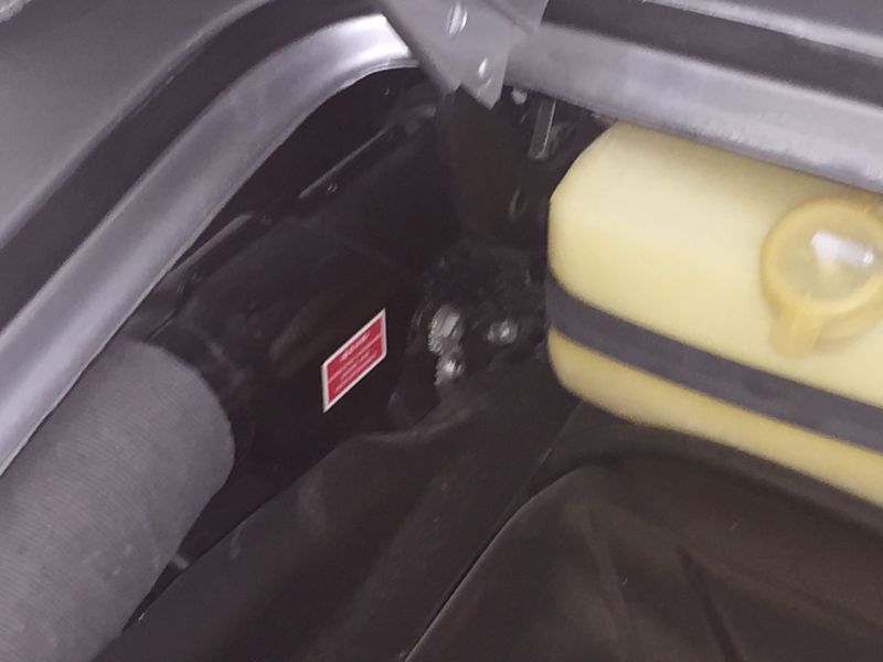

                  Completed with a new Behr sticker, which is only on the passenger side air vent. A green marking was originally placed on the cog assembly nut to indicate that it was tightened and checked.
                  New OEM marking were placed on the rear of the bodies with white paint and foam letters/numbers.
                  Passenger side vent.
                  The zinc plating turned out nicely. Like OEM, tape was placed around the edges where the two vent halves meet and are inserted into the rubber pieces.
                  Thanks for following.

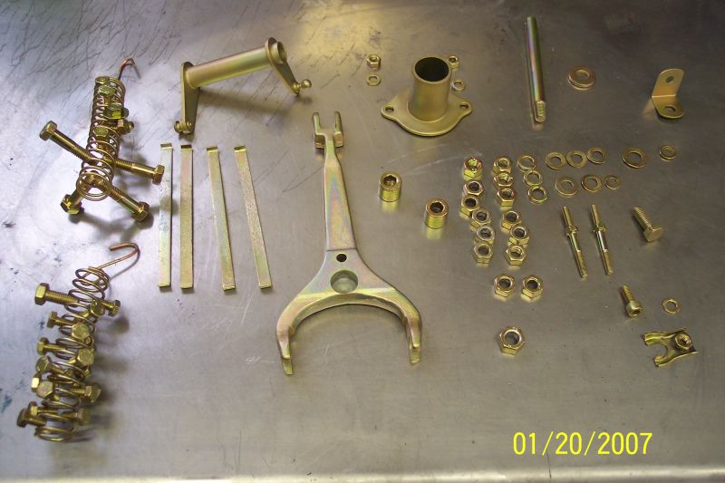

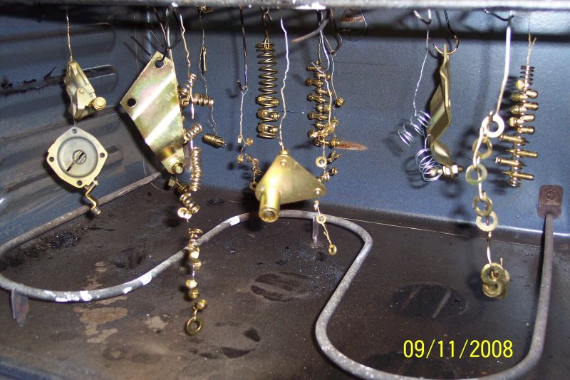

                          • Hi John,
                            I also use Caswell's plating system with five gallon jugs.

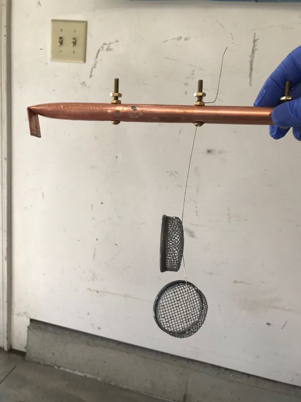

                            One trick that makes both bright zinc sparkle and the yellow "cad", even though it is not cad is too dip the parts for 45 seconds in Blue Chromate just prior to the cad. Check out the bright zinc springs. This provides this kind of an end finish for me in Cad. The Caswell site speaks about this. An Aussie brought it to my attention.
                            Your parts look very professional.

                              Don't buy the transformer from Caswell....way too expensive. The one below works very well for the size of pieces we normally need to plate and it's $85 with Amazon Prime:
                              https://www.amazon.com/gp/product/B073TW8H2S/ref=oh_aui_detailpage_o04_s00?ie=UTF8&psc=1

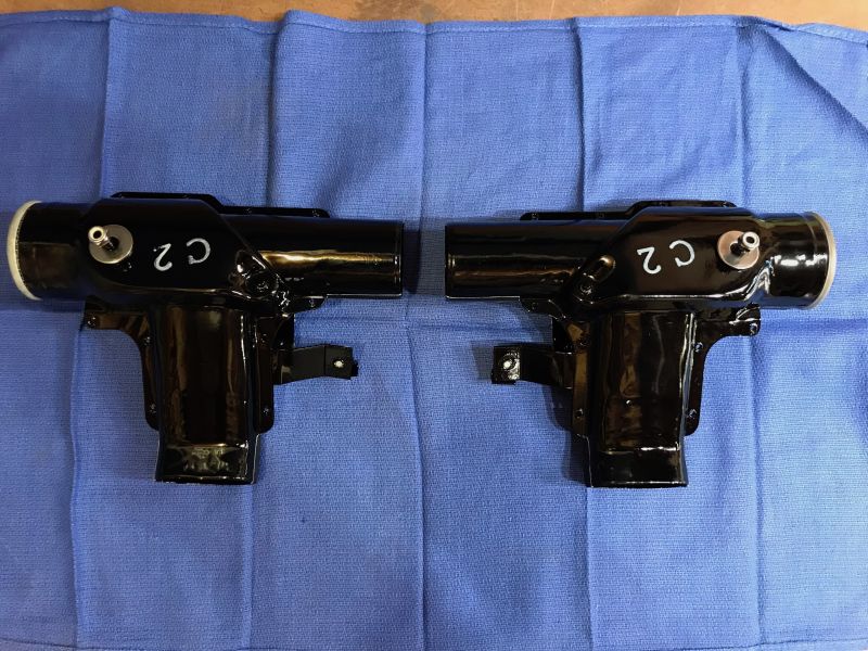

                              Everything on the side vent was put back as OEM.....white paint on the "C2" lettering. I restored a second set of side valves with an "F2" on the back side so don't think the C2 was for Carrera, but it sounds good.
                              JP

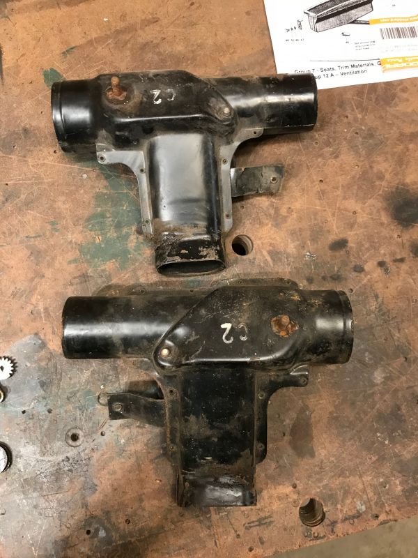

                              • These are most certainly "C 2"
                                But these would most likely be the "F('d up")2" versions
