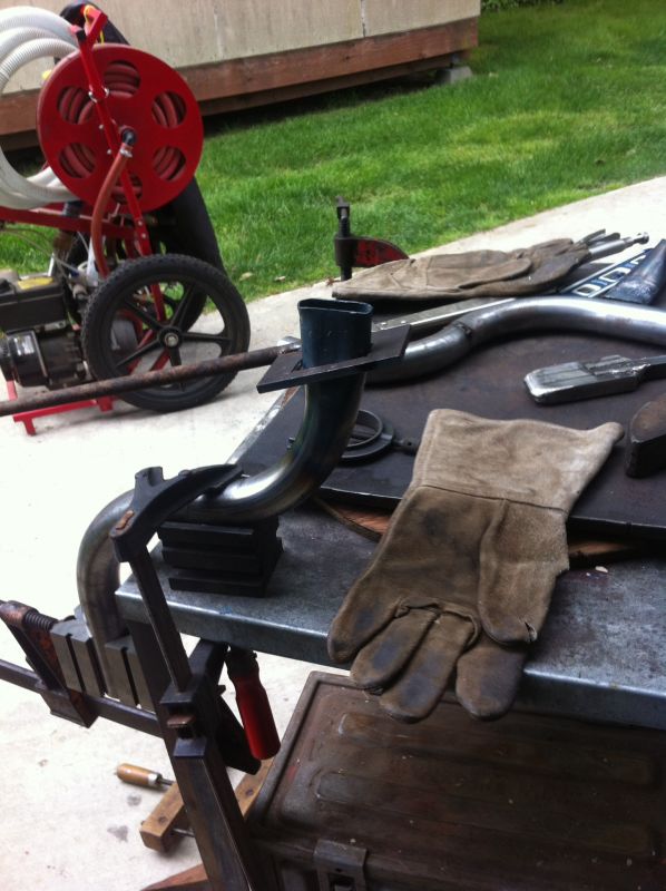

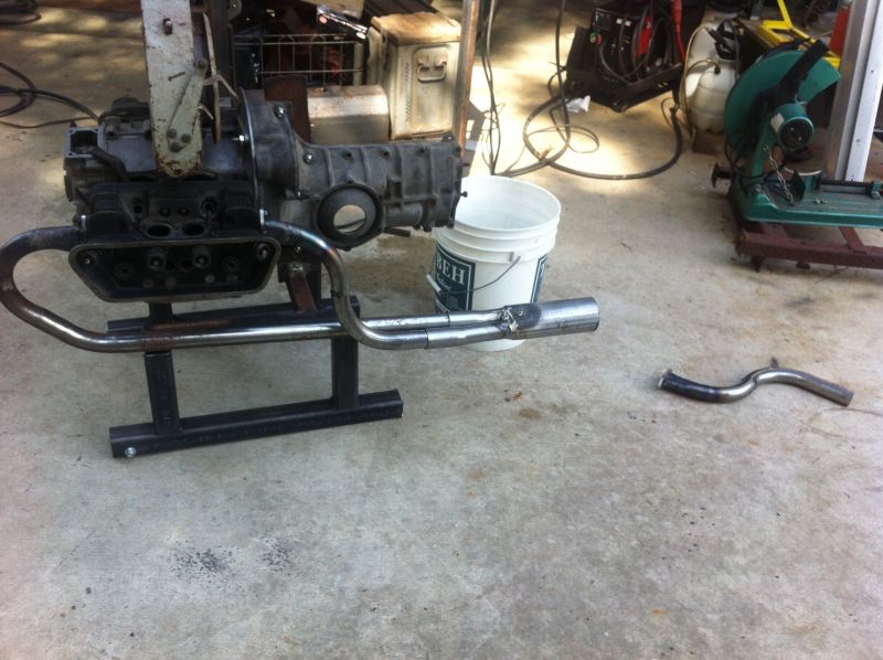

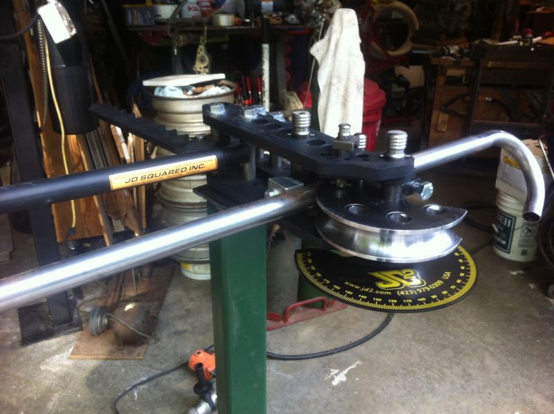

      • Making a set of headers for a engine bench. Here is the tubing bender, it works just great. I have just started, but it was not too expensive. It is capable of 2" 1/4 wall steel pipe. You have to match the dies to the tubing, but it's a good investment. Roll cages and ralley bars should be easy.
        Does the 37.5 X 1.5 mm exhaust tube with one hand. Well made and simple so far.

        • Nice looking bender!

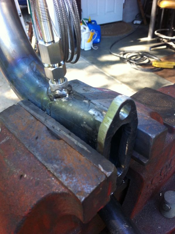

          • This bender is really built well, and it works... I built the first section of exhaust pipe today, all four in four hours. One thing I did learn, the flange transitions. Do the rectangle to round transition first, then bend the tube. Trying to heat the end and form it when it's bent is doable, but is a pain.
            Trying to insure it is flat and the right angle to match the other pipes takes some prior thinking.

            I think for roll bars and other add on things, it's is fine tool, it's accurate, repeatable and easy to use.

              JB, is that bender lagged into the floor? I had inherited an old Hossfeld that was similar but mounted on a heavy vertical metal cabinet with shelves. Empty, it could be 'walked around.' The collection of dies stored in that cabinet really added weight for stability, but the best addition was a hydraulic ram with a two-way foot pedal for in/out.
              That made the phasing easy(er) when bending alone. I no longer do roll bars or cages as old Porsches are rarely raced anymore. I needed the floorspace so my old stuff for that is residing at a friends bigger shop....... but your pictures made me miss that kind of fabrication and appreciate your figgerin' out of what you are doing with that exhaust.
              Good work, good pictures, thanks. Oh, and thanks for bringing up good memories for me of the 'fun stuff.'
              • Bruce
                Yes is attached to the floor with a 4x4 square tube. Un bolts and stands in the corner.

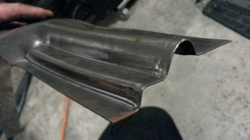

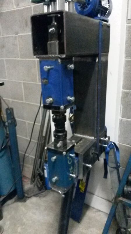

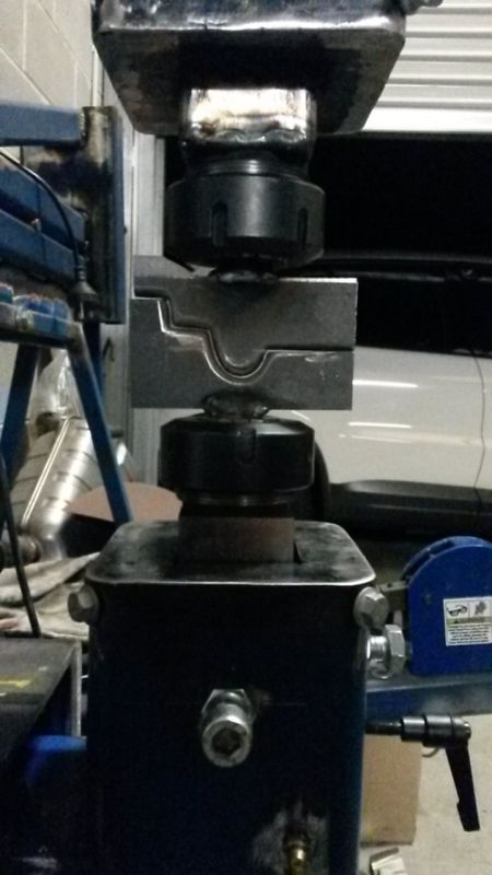

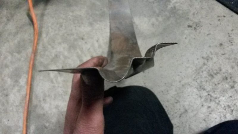

                  • thought i would share a simple machine i built (not completely my idea) that will help if you are into making panels. i tried to do this with no machining and it is possible quite easily

                    • JOP
                      • yes pal, built by me downunder lol, not the same dies we used at peter's, this machine uses 20mm round post dies not the 19mm square pullmax uses. it works great, and is very usefull
                        • "i tried to do this with no machining"
                          Nice machine, but for the above quote..... did you hand cut and shape the dies with a file?
                          • Originally posted by bbspdstr" post=43220
                            I did just that!... well cut with a grinder and cutting wheel but finished with a file
                            • Fantastic job on that machine! Bravo...and I want one.
                              • "I did just that!... well cut with a grinder and cutting wheel but finished with a file"
                                Now I'm really impressed...no, make that jealous.
                                Like Tom.......I want one. No, I actually have access to a Pullmax.
                                I am already trying to think about a possible plan on how I will maybe divest myself of the equipment I already have. "Retirement" is my wife's idea....at least so far. However, are you selling plans for your machine....just in case I don't "retire"?
