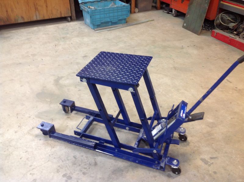

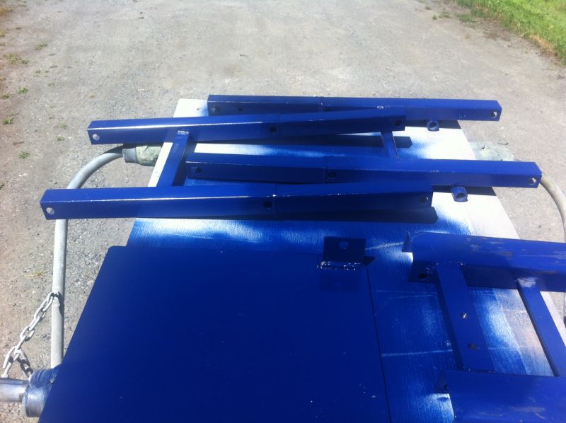

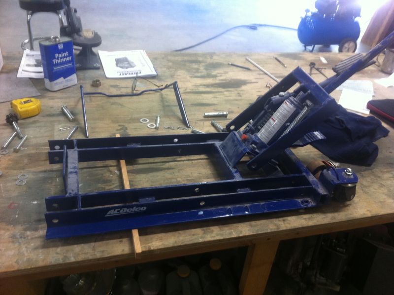

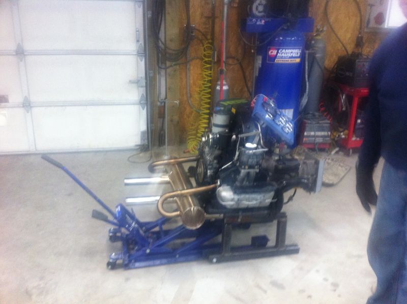

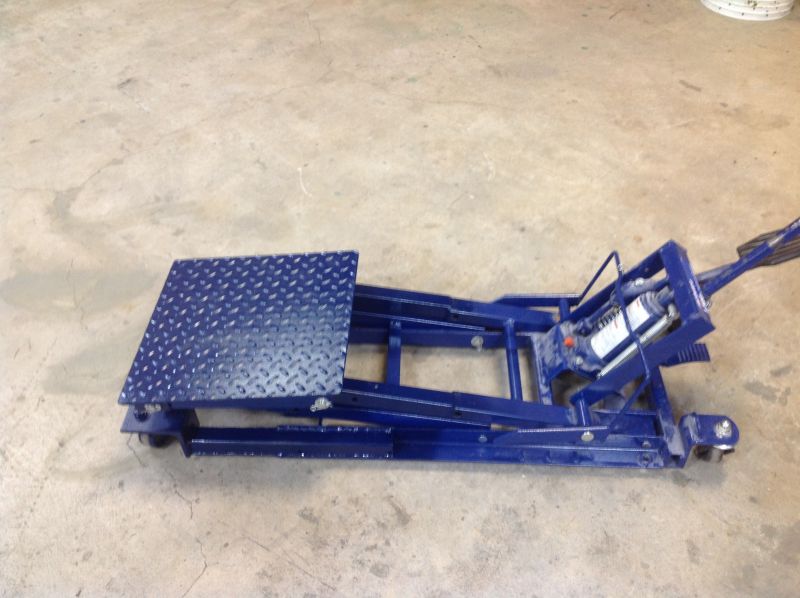

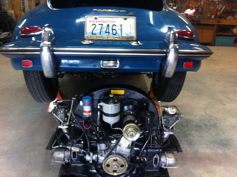

          • 24" JACK Mod. Cheap motor cycle Jack into a 356 engine installer..
            Bob took a Motorcycle Jack and extended it 9 inches and made a larger pad with tilt adjust to remove aircooled engines.. My good old 2 ton floor Jack always worked but, I always wanted more lift. It has a wider stance and foot pump so I can look at the main shaft and clutch as I lift. So new welder needs some run time and presto Jack mod.
            Extended the base and arms by 9" for the lift, Larger engine pad that tilts to match the transmission.

            24" lift. Foot pump, 4 swivel casters and very stable. Hazard and fraud sells a similar Jack, easy mod and works very well, go get one

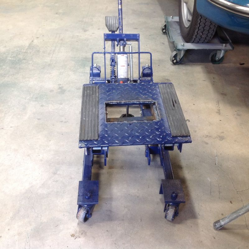

            9/8/18 design update..... Extend the Jack by 13" not the 9 as we did. It works great for in and out of the car. But does not raise quite high enough to plug into the engine stand. 2 more inches would be fine but 4" more is probably better . Also we cut out the table center a little bigger than the oil sump cover, so the engine sits on the table flat and the sump extends through the hole.
            And fits the run in bench
            Will raise the engine into the car with it as high as the Jack stands will raise the car. We have 5" of clearence under the body to slide the fan. The tilt table allows you to pitch down to clear the heater tube and generator nut. The four swivel casters allow the engine make it easy to center. We installed this one with the carbs on. Had to remove the muffler because of the #3&4 header pipe clearence with the body. But the engine went in easier than it came out.
            You can pump with your foot, hold onto the shroud and pitch the table with out moving. It's sits flat in the table so no rocking. The up/down valve is also foot operated. And the hight locks with the direction valve lever full down. So you can press all the way down on the up/down lever and it hold the hight, let you foot up a little and it creeps down very slowly. Same with lifting, you can press on the pump pedal and raise it slowly and push in engine in and it comes up. You can stop adjust the table angle to match the trans and the engine slides back in. This was the easiest install I have done in 40 years. The engine was tuned up on the test stand, it went back in adjusted and ready to run.

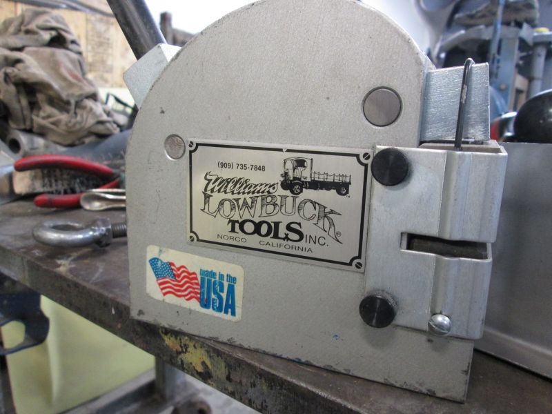

                • Everyone's familiar with these stretcher/shrinker jaws I'm sure.

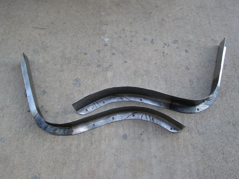

                  Me included, but a buddy loaned me his to make some compound shaped flanges for my Toyota build. I never used them before but man I can't see being without them now.

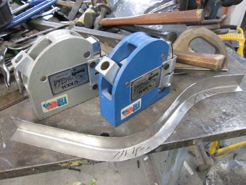

                  They work like magic!
                  Clear shot of the manufacture for anyone interested.

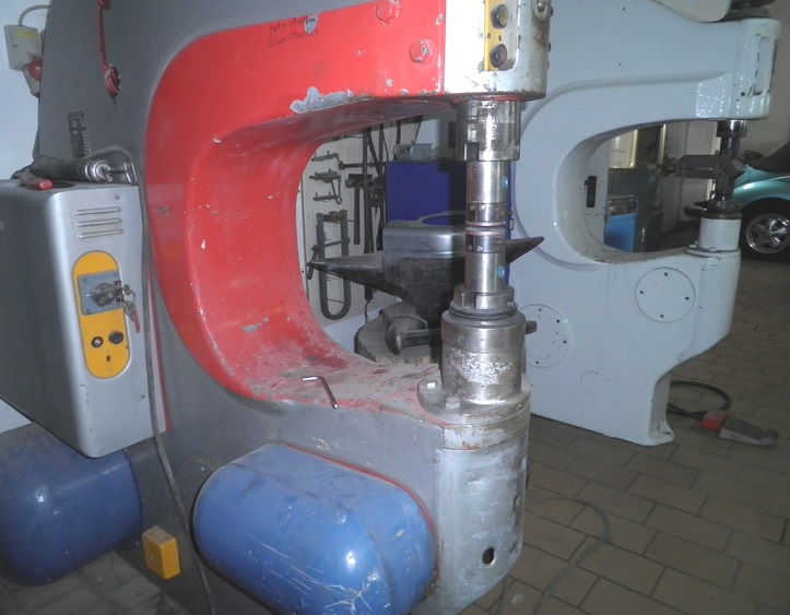

                        • Wow Gerd,
                          That are two BIG boys you got there to form metal!
                          You need the space to have the Eckolds.... I just have the Pullmax.
                          You sure have a nice stach of werkzueg
                          I muss drop by your place IF I ever drive by your location
                          Thx
                          • Hi JOP,
                            thanks!
                            Well, those "Boys" help a lot, indeed.
                            Shrinking and stretching up to 6mm...
                            And very universal with the different tools.
                            I was very lucky to find them.
                            But the pullmax is also a very strong machine!
                            I think you use it very often, right?
                            You're always welcome for a visit!
                            Gerd
                            www.breuer.shop

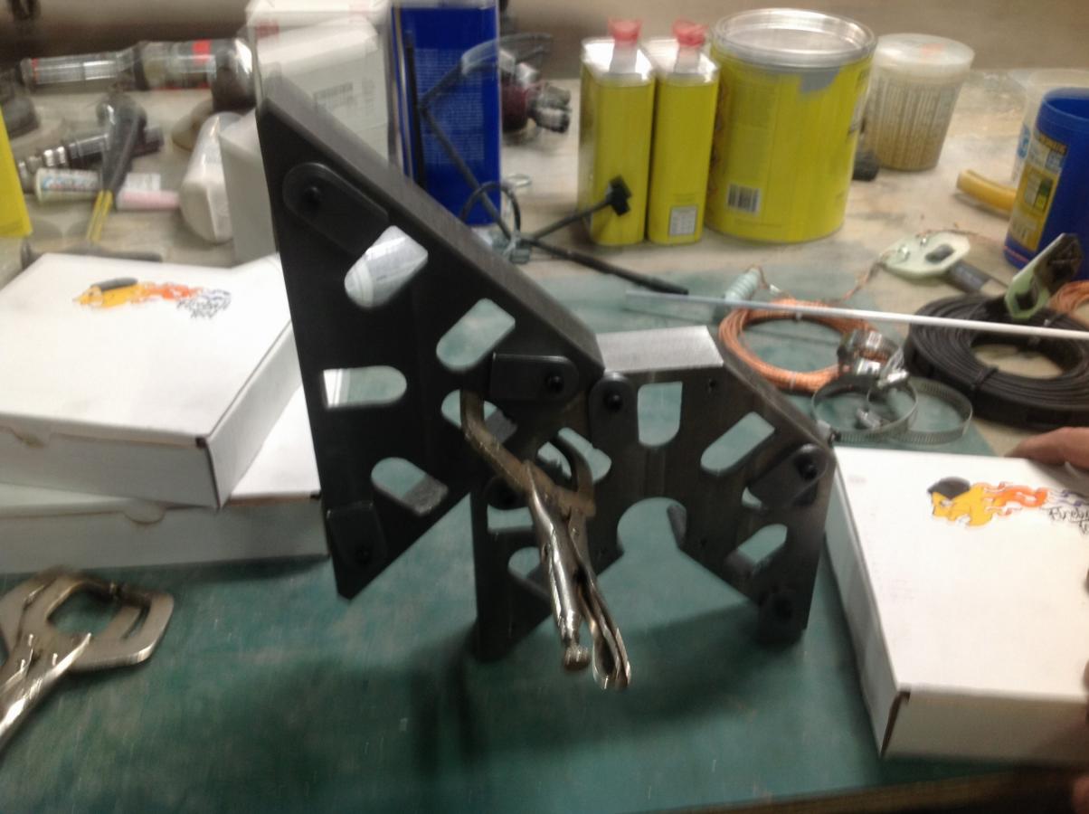

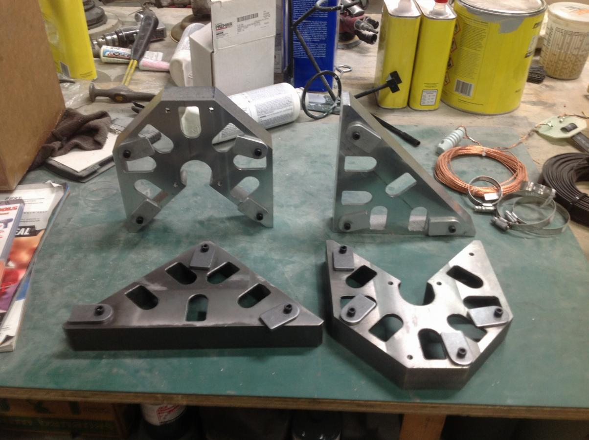

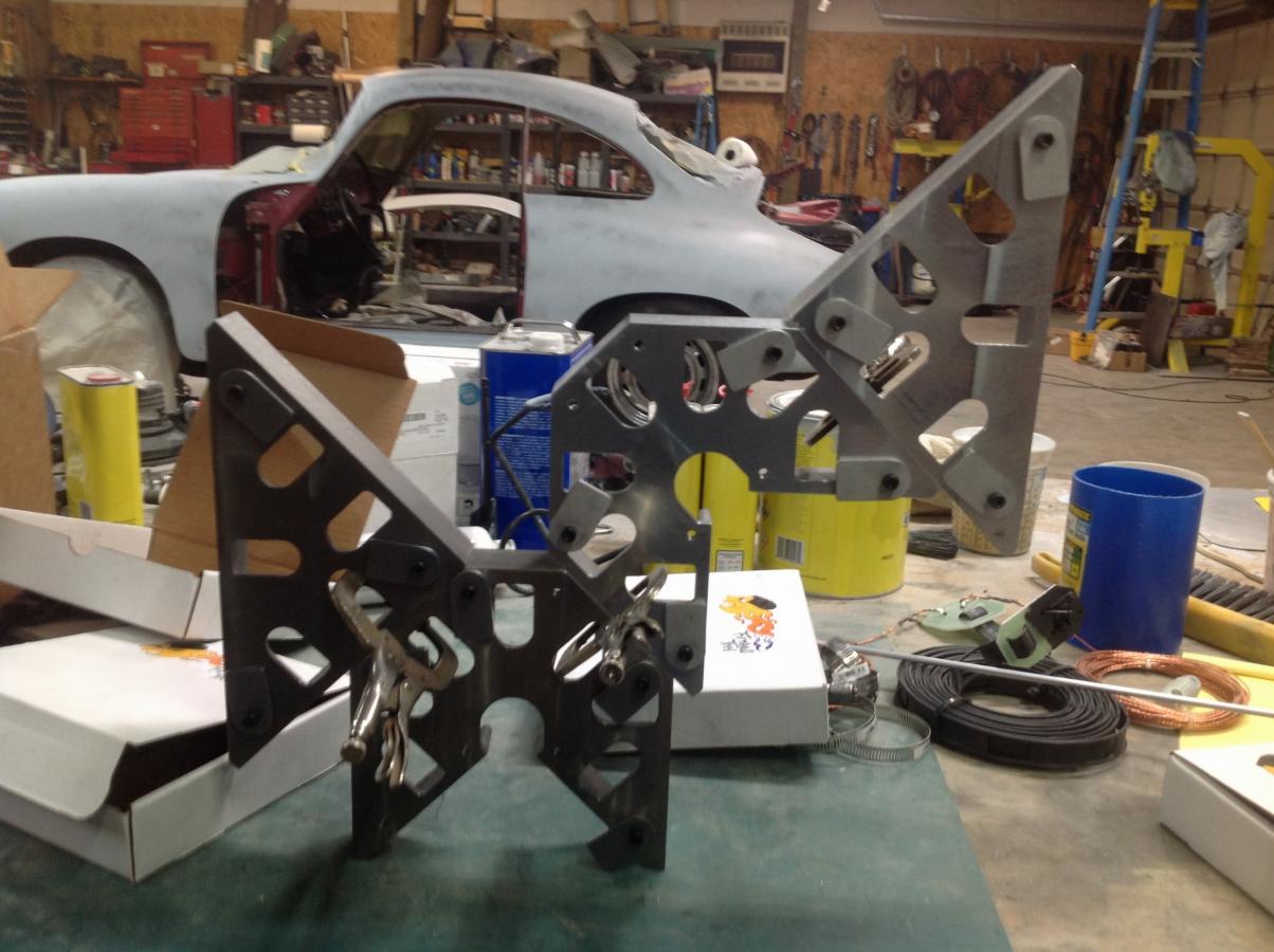

                            • Repost the fireball squares.
Name:
ID:	103798 Aluminum or cast iron.
Name:
ID:	103799 They are really cool, the tabs allow you to hold things in two planes at once. The corner are open so you can weld, vise grips go through the slots.
Name:
ID:	103800 Very well made and accurately in 8" & 12".
