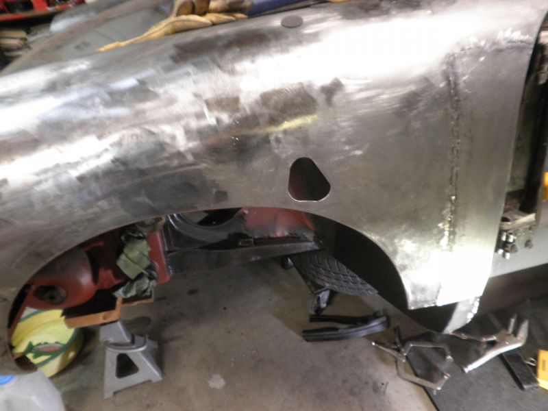

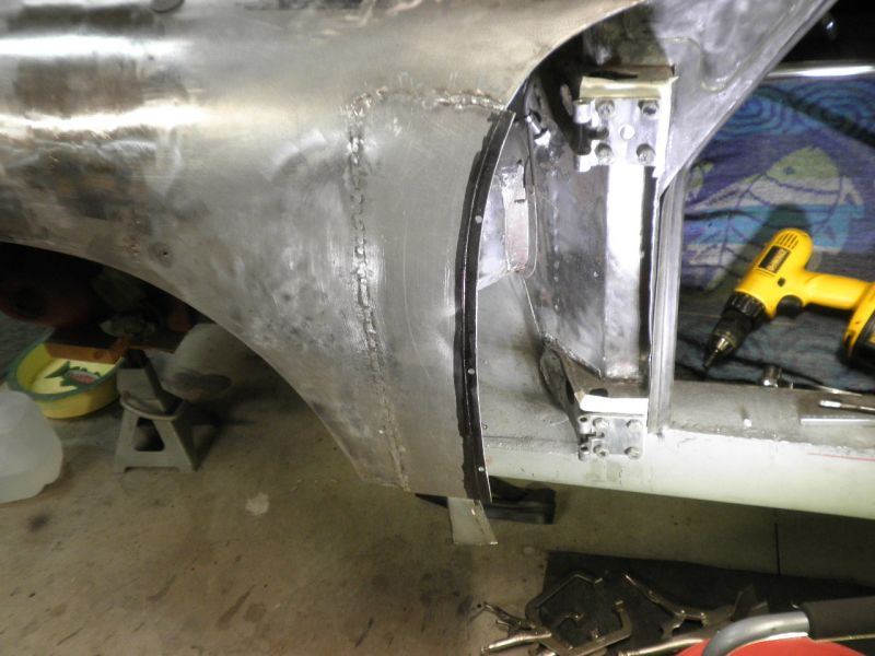

        Nice looking weld joint Phil! Looks like it will only require a razor thin swatch of filler to be perfect; The best any of us can hope for.
        Fantastic job! Justin
        • #79
          Really nice welding Phil. Enjoying your thread.
          • #80

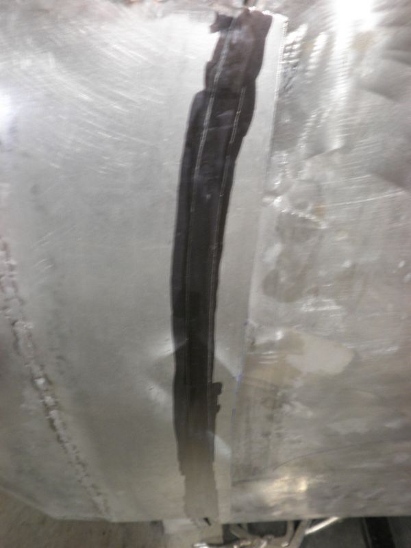

            Really nice Phil. I finished this area on my car and will add some pics too. Very difficult area if you ask me. Door gap, fender elevation, hemmed edge over a curved path, whew. I need to read Roland's chapter on this again. I ended up cheating on the upper hemmed area.
            Just saw your welding post, and this happens on long welds for sure where the gap goes to interference at the ends.
            I do a little bit of gap adjustment, but try to keep the removal to a minimum. Best to stretch the weld to relax the panel to fit close to the way you trimmed it. If too much is removed on the ends than the contour changes. I smack the welded area backed with a heavy dolly and make it ring 5 times with fairly hard hits.
            I don't necessarily start welding in the middle either, instead I pick the spots that line up the best and move around from there. Alternating hammer on dolly and welding as I go.
            Keep up the good work!

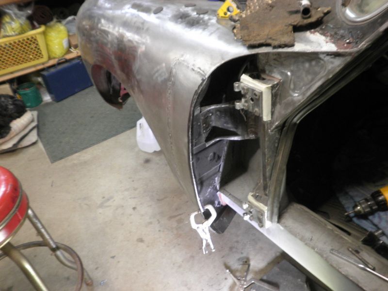

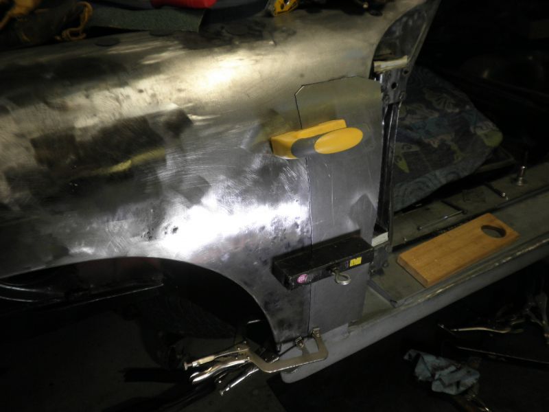

              Today was the moment of truth as I hemmed the fender flange to the outer closing panel. First I scribed the lines for the bend and trimming the flange.
              Ron Roland said to make the flange 1/2", however the old remaining flange was .40" so I trimmed another .10" off of the flange. He also recommends 3 holes to plug weld so I punched those out.

              Time to start bending the flange. Here I am about half way down with the first iteration of the bend:
              Here the bend is about 75% done, using a hammer with a dolly flush to the bend line on the back side:

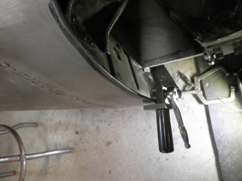

              I bought a hemming tool to use on the doors way back when, so I dug that out and used it to start getting the total hem thickness down to 4mm, which is what I measured on my unmolested 55 coupe:

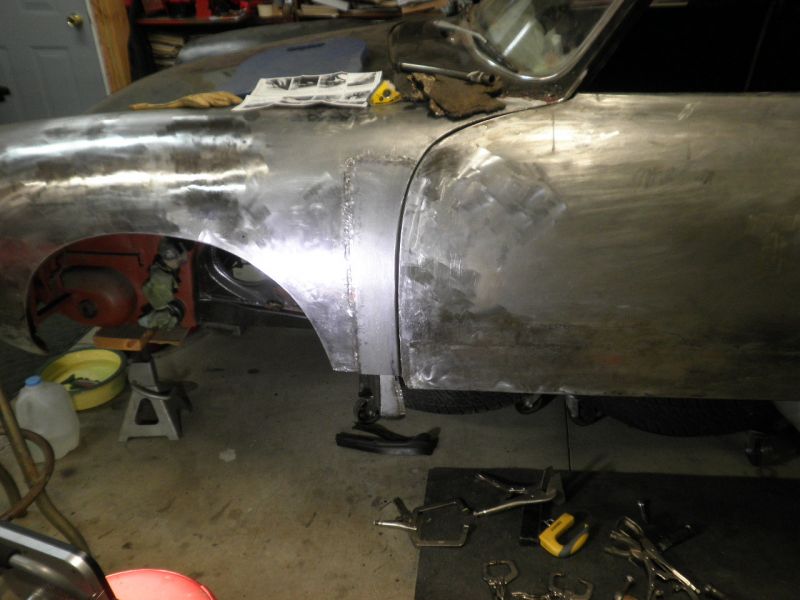

              Time to fit the door to see how the gap looks:
              Gap is pretty good, with about an 8" section a little wider. Checked the hem thickness and this area measured 5mm so ran the tool over to get it down to 4mm which should even up the gap.

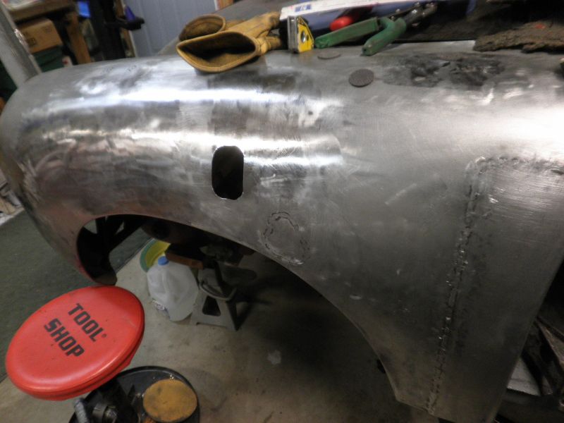

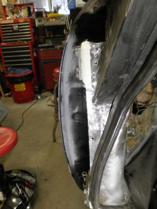

              Here are some shots of the hemmed flange all finished:

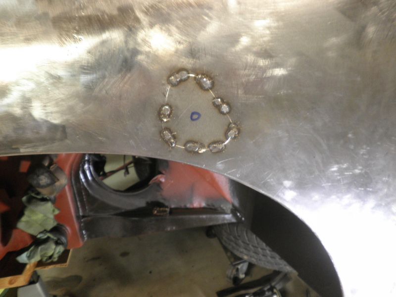

                                Next big task will be removing the lead on the lock post as Justin did and probably welding in a new front of quarter panel, as there are several rust holes up near the top. Dreading starting this, I decided to repair to rusty areas on the front fender. There were 6 or 7 small holes in two spots. Don't understand how a fender can rust out here unless the undercoating failed and water got trapped. Anyway, cut out the first bad spot:
                                I tried a no gap fit and beveled the edges to hopefully get good penetration. Started tacking in:
                                Finished up the tack/planish/grind process. Then used a file on this convex surface to get the weld pretty smooth. Cut out the second area and fit and scribed a patch:
