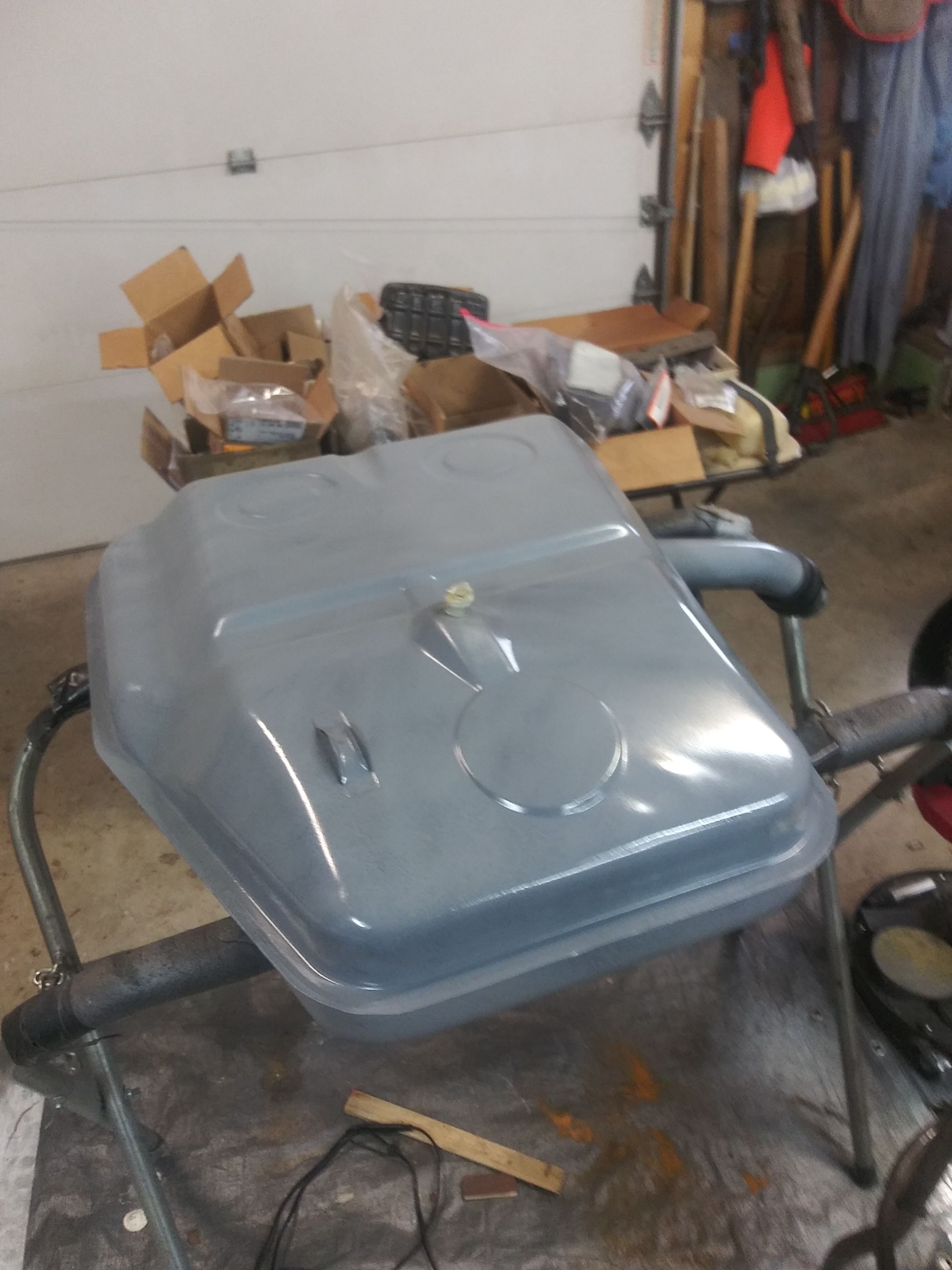

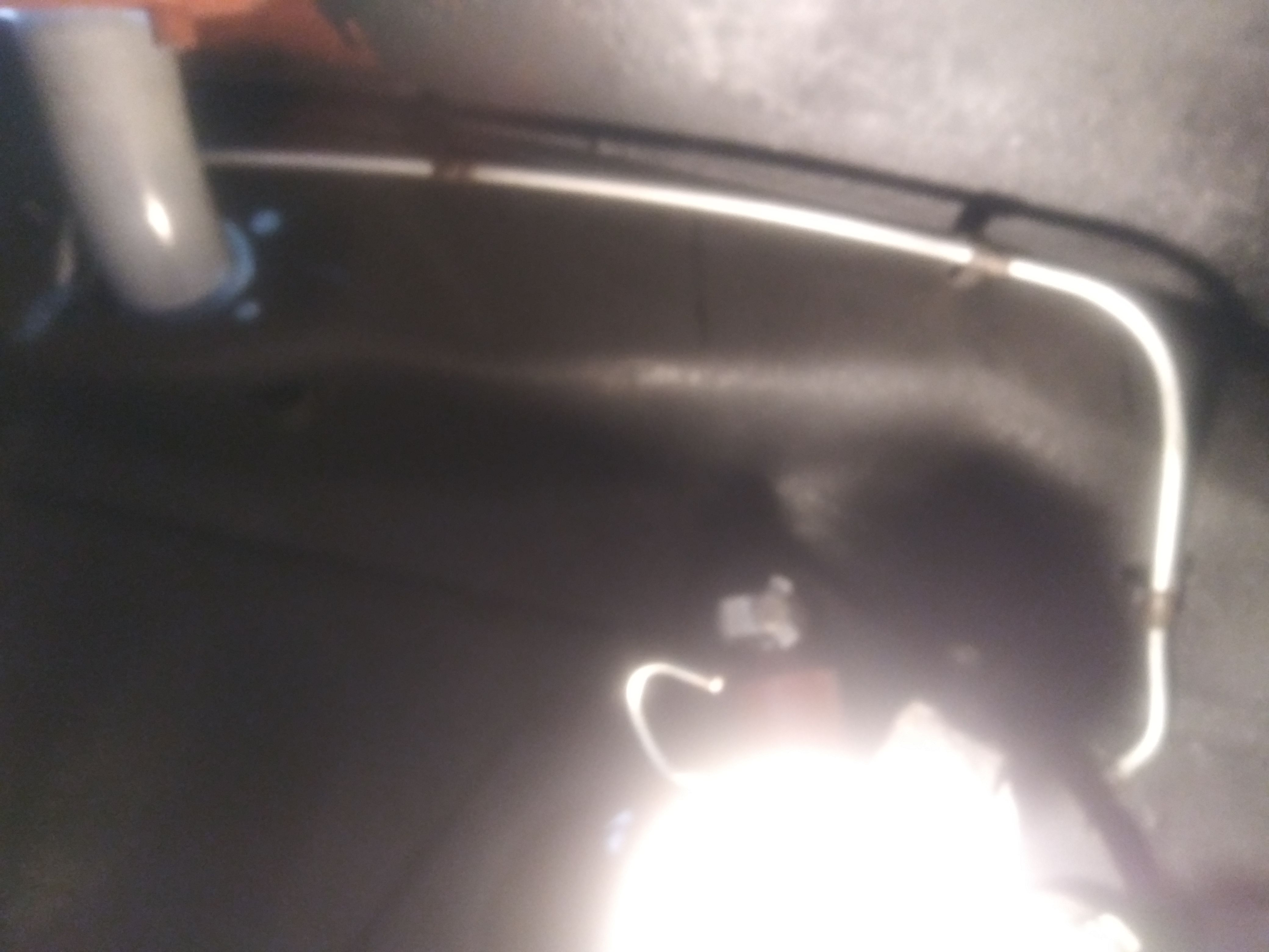

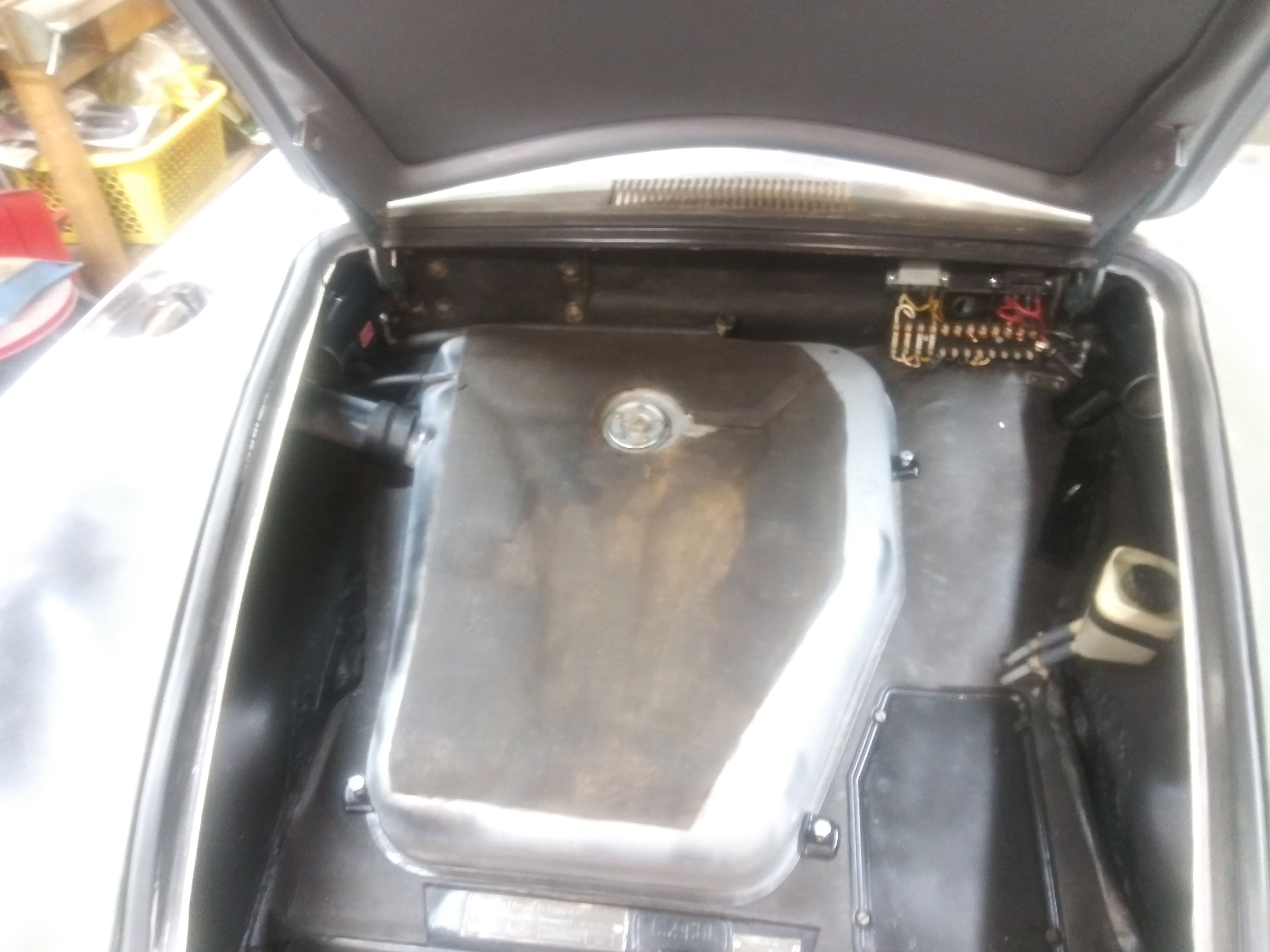

ID:	111547 I have been out of commision since last post with apparent severe rheumatoid arthritis in both hands and wrists. So no work on Foam Car at all. My son came up last weekend and temporarily installed gas tank. Glad we did as learned clearances are pretty tight. The filler neck is touching the air control box and not well centered in top fender hole. Will try to move air control rearward when tank removed gor final paint and insulation. Was able to get vent tube painted with Eastwoods fake silver cad and rough installed. Will finally see a rheumatoid doc in 2 weeks to hopefully restore use of hands.

          Its taking shape very nicely under there Phil.
      • Sorry to hear about the hands and wrists Phil, do hope the doctor can help on that for you. Frustrating not to be able to finish that fitment it will look good when finished.
        • Geez this must be tough. So sorry to hear. Fingers crossed it can all be resolved and you can move ahead with the project.

            • Finally saw rheumatoid doc a few weeks ago and hands starting to get better. Pulled gas tank to paint top half and reinstalled with plates and rubber gasket installed. Attached video shows starting up in foam car for first time in 21 years.

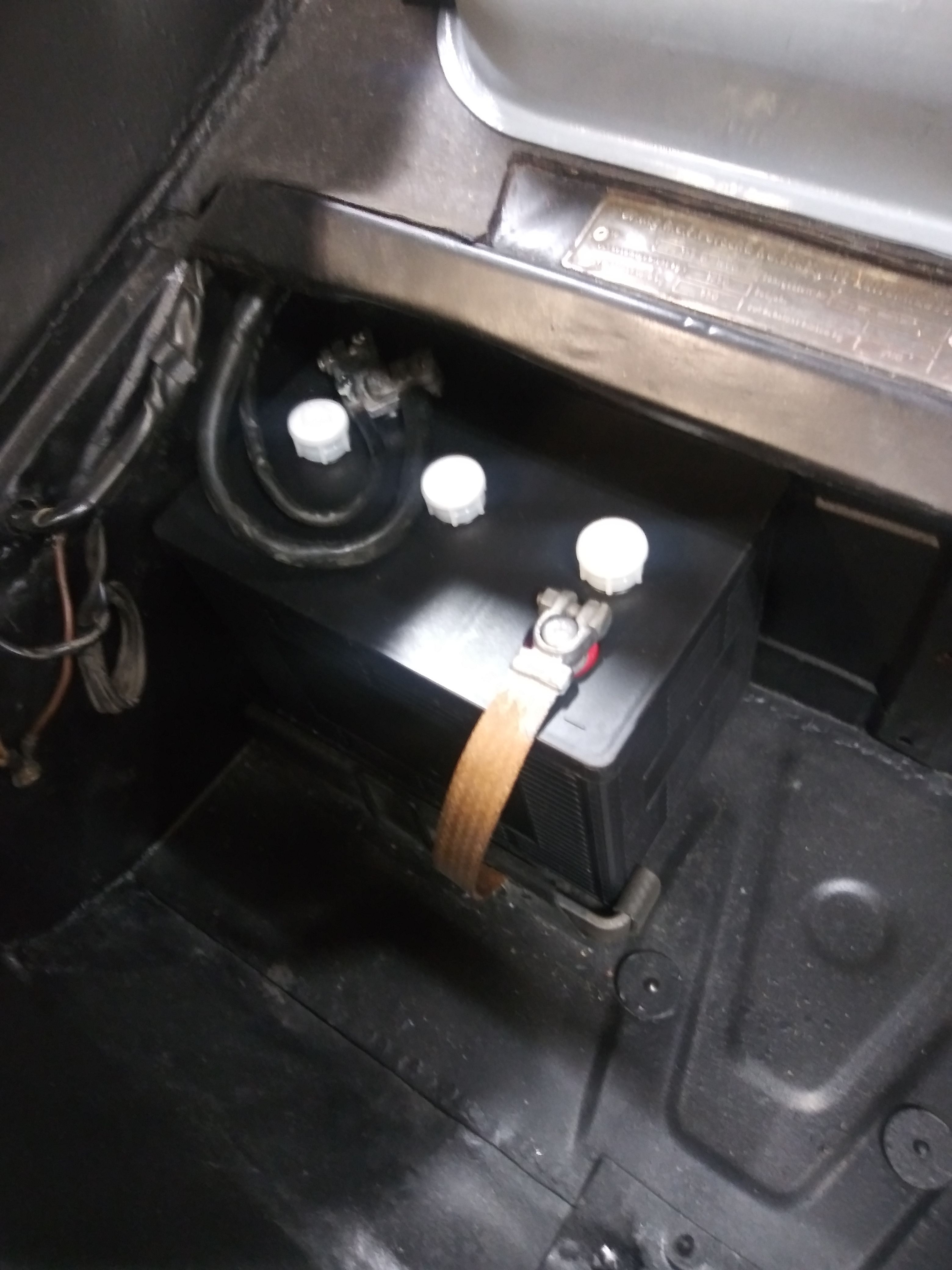

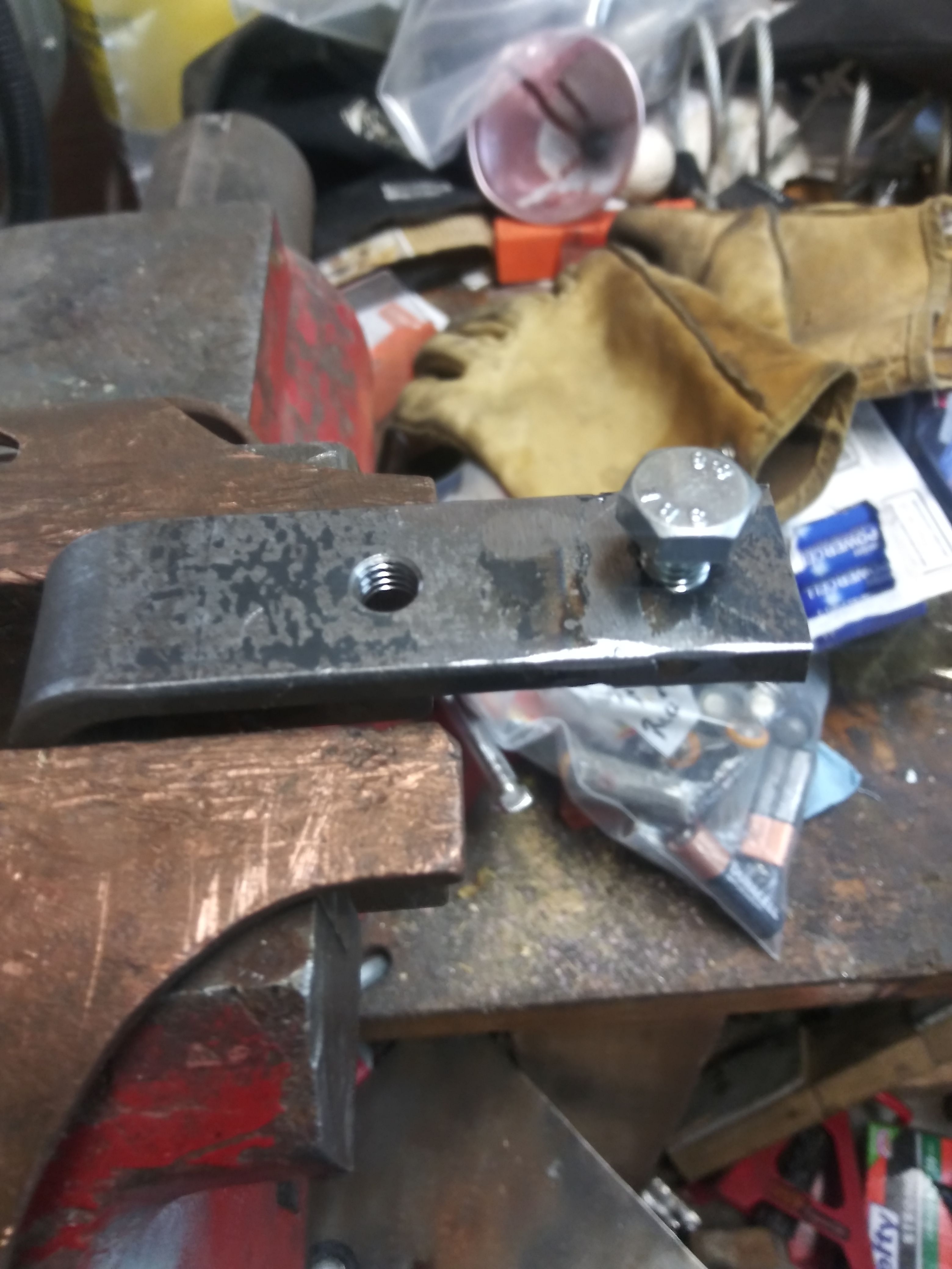

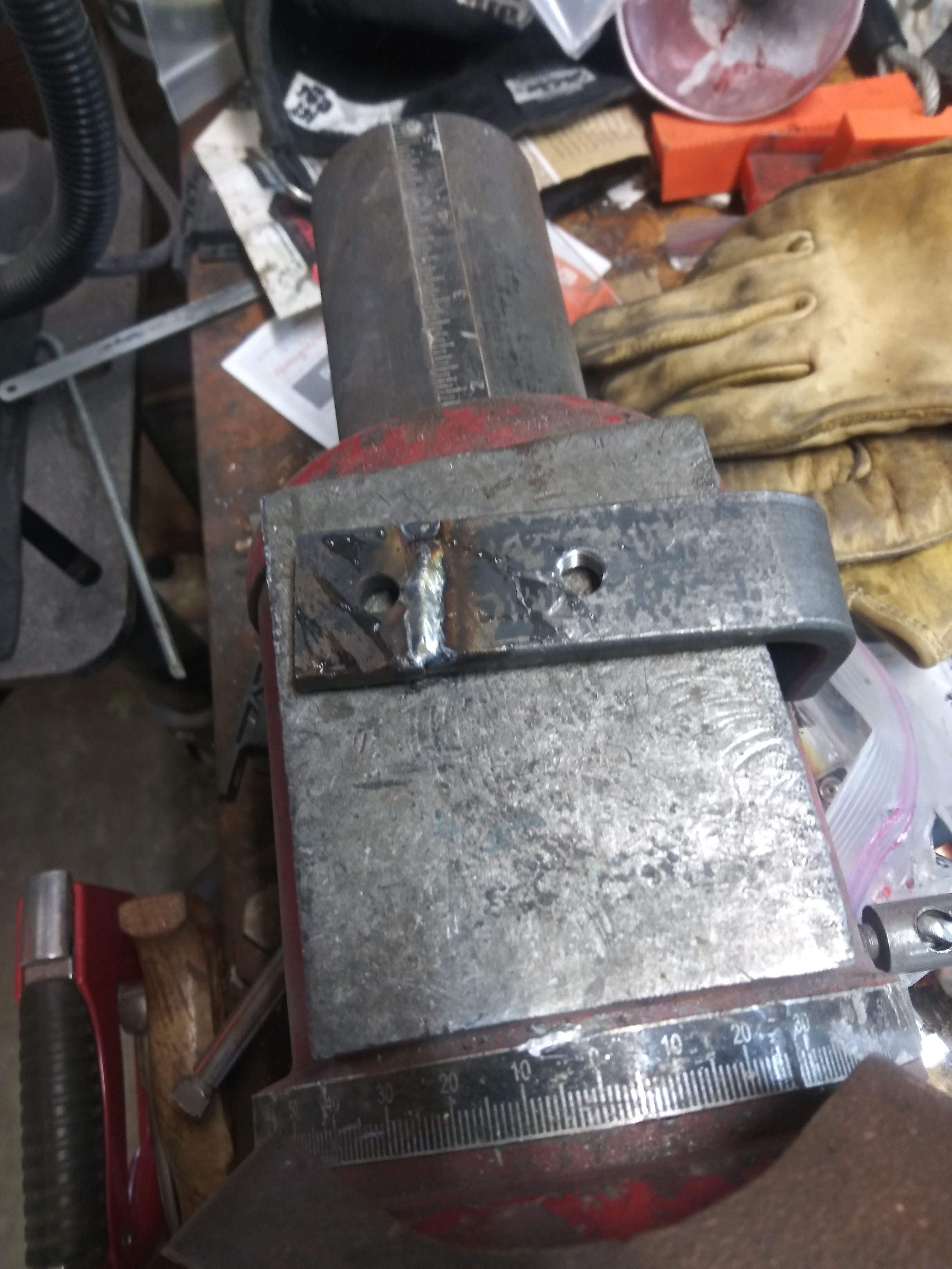

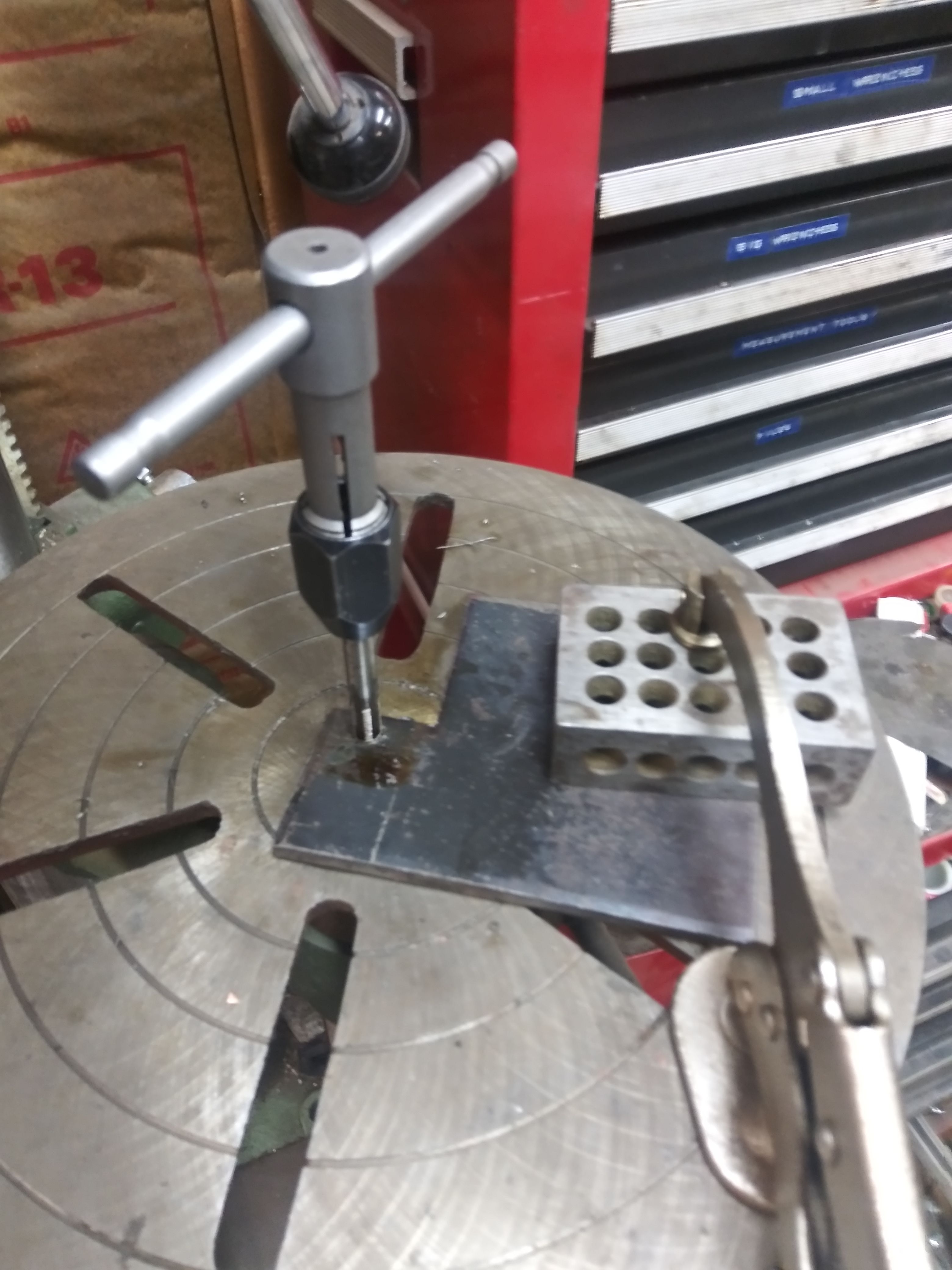

              • I am using a 6v Optima so bought the cloaking device to help locate and hold down without drilling extra holes. The combo ground bracket/lateral stop has to be extended as the fake bsttery is longer than original
                I had some left over steel plate from my welding class years ago that was the same thickness. First I drilled and tapped s hole for the m8x1.2 bolt:
                Next I cut it to size and welded it to the beacket:
                • Ground and filed weld smooth and test fit bolt:
                  Installed with ground strap:
                    Nice and clean modification Phil.

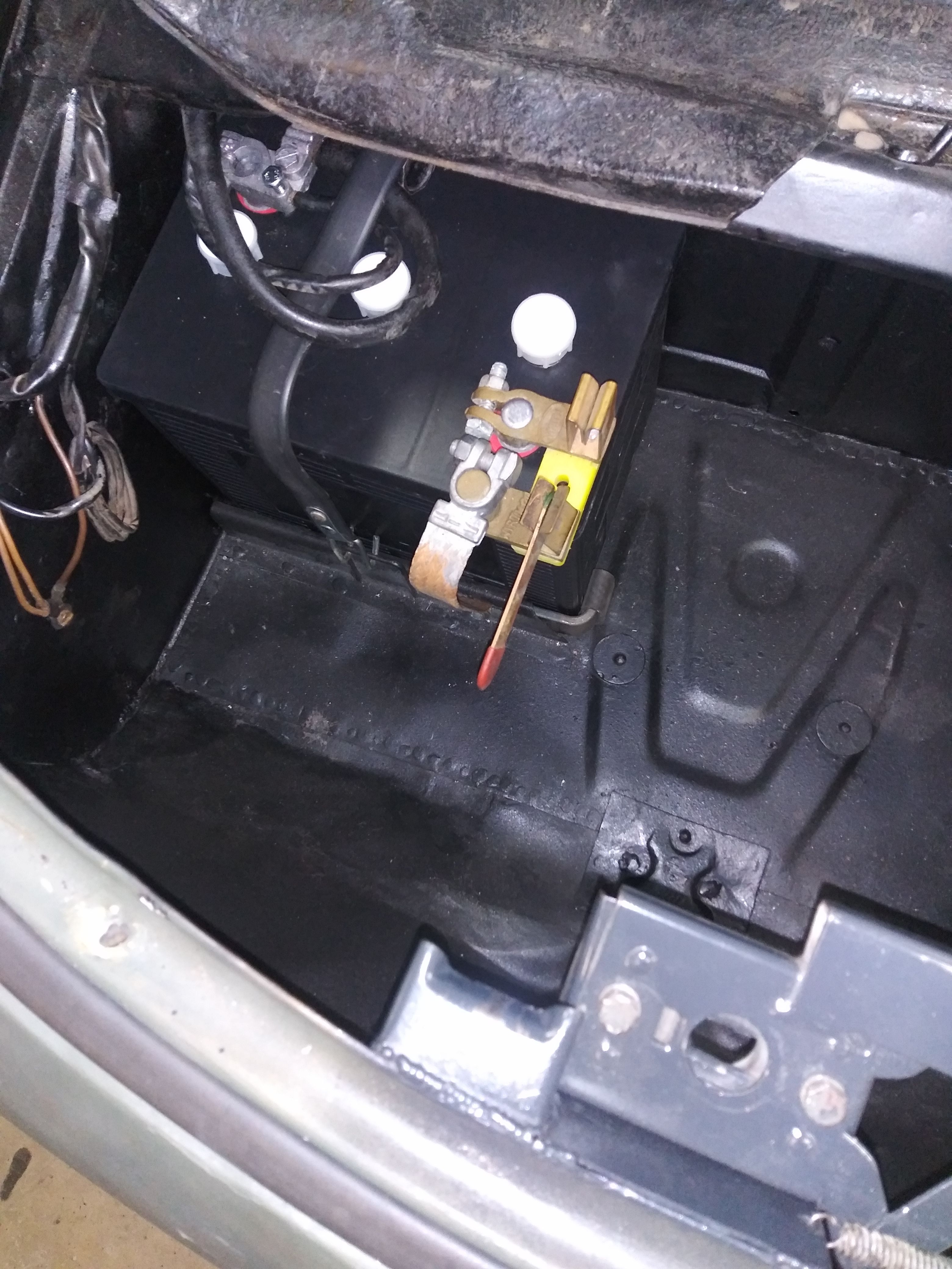

                • As I am a ways off from driving Foam Car on public roads and will be doing a lot of wiring work I installed a cutoff switch on the ground. Installed battery hold down strap. Also cleaned up original plastic trunk liner and installed. Unfortunately the drivers side doesnt fit flush due to my brake fluid reservoiur. I checked this when installing reservoiur but gas tank was not installed. It seemed to clear okay but with tank in it doesnt. Not a big issue. Started engine and adjusted clutch pedal stop. Went for about a 2 mile drive around the subdivision(private roads) without lights or license plate to warm up oil and bed in brake shoes. All went well. Oil now about finished dripping from drain pan.
                  Click image for larger version  Name:	20210801_110117.jpg Views:	0 Size:	1.33 MB ID:	111714
                    Sounds like you're well on the way of working out the kinks. Like the battery throw switch.

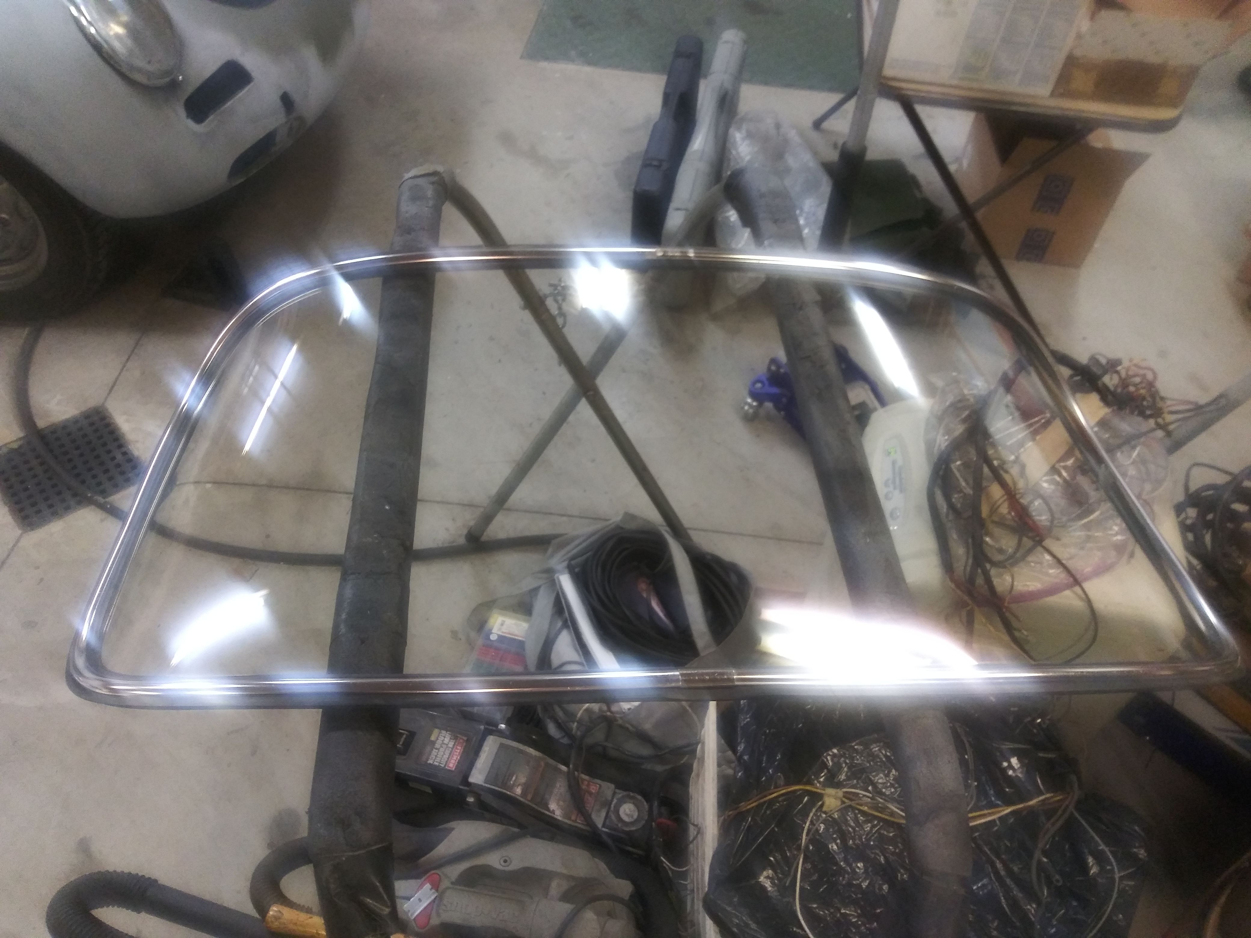

                • Got the new rubber and trim moldings on back window
