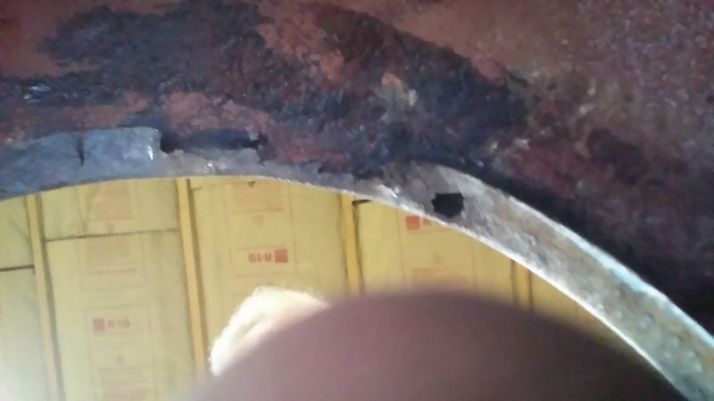

    • Slower progress, as putting new shocks on front the 912 is taking some time. Did get this rusty piece at top of fender bucket opening cut out:

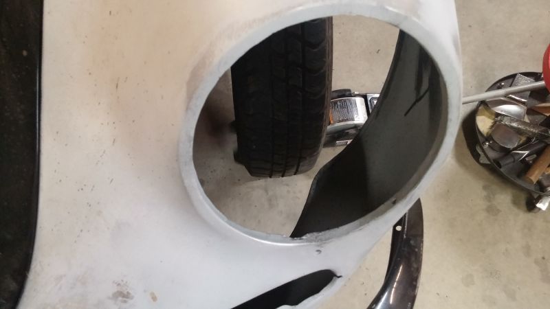

          Got flange repaired near top of bucket opening:

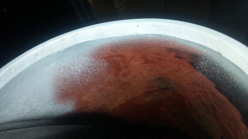

          About time to reinstall buckets. Need to see what else needs access through these holes first. Btw that red orange paint is Eastwoods version of a rust encapsulater. Put it on 18 years ago. I have been slowly removing it but it is pretty tough stuff and hard to remove.

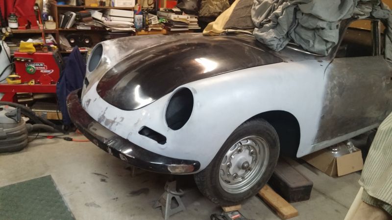

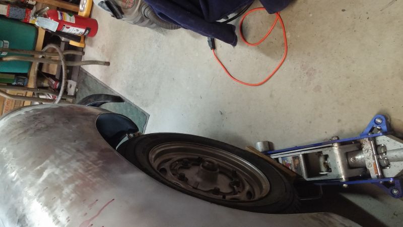

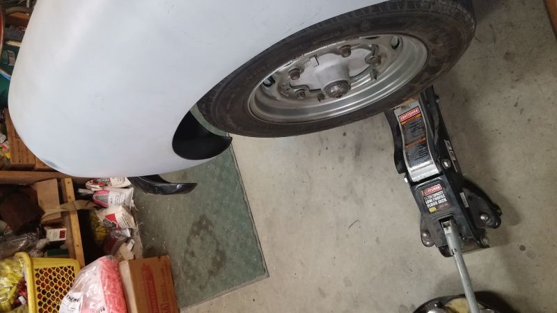

          • I have the passenger fender brace clamped in place to weld to the fender. With 1/2" fender opening variation side to side I decided to put the wheels on, lift them off the jack stands, install the bumper for a visual check. I cannot see much if any visible difference other than possibly my front ride heigth being too high. I did set torsion bar angles to the spec. Maybe with a tank of gas and some settleing in of the suspension it will look more normal

            As Jack warned me earlier, once I weld in that center nose piece there is not going to be much movement option.
            • I think it looks great, Jack. Remember that these cars were built by hand and there is a lot of variation from side to side. Be careful welding the brace in first before situating the light bucket to make sure things line up, which I bet you've already considered.
              JP
              • Thanks John
                The passenger brace has been welded to the body already, and at that time everything lined up with the bucket. I have removed the conduit, as am making new ones that go all the way through the bucket so no weld slag inside at the bucket. I figured it was easier to see, clamp and weld the brace to the fender with the bucket out. I have coated all the inner welds, so after the braces I hope to try to install the buckets. I have also coated all the weld joints with waterproof filler per Bruces email recommendation years ago before ABCGT existed. As there were still some unrepairable surface imperfections in theat center nose section I also put a skim coat there. BTW, those tires, I bought for the 2 months I drove Foam Car until my foot really went through the floor in Nov. 2000. After I relocated to northern MI I put them on the PreA and drove all over the country with them. Then they went on the 912, as though old, not as old as the undersized tires that were on it when I bought it. I just put a set of Vredesteins on the 912 so these are now back on Foam Car, and this is the first time since about 2003 when I moved Foam Car to our new home that the front has sat on tires.

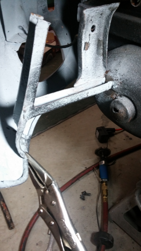

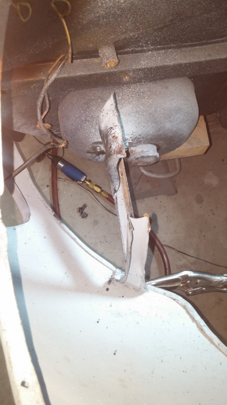

                    • Got both brackets welded to the fenders. Easier to do with headlight buckets out. Drivers side bracket had been removed to facilitate fender repair, even though I had already installed it once. Took about and hour to get it to line up correctly. Here it is tek screwed and clamped in place ready to weld in:
                      With this finally done, I will coat all uncoated welds and should be ready to begin headlight bucket install.

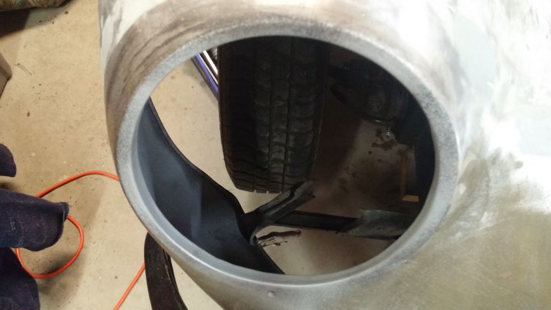

                      • Got all the underside coated and 1 bucket in, but not welded. Swear I made a sketch of the gap at the bucket rim before removing, but cannot find it in my log. Is there a "typical" gap or do I mock up with rubber gasket and masking tape for paint thickness?
                        Bucket got harder to move at around 2" protrusion so had to resort to my old Healy knock off brass hammer. A 2x6 worked well against the flat at the back of the bucket, which is parallel to the rim.

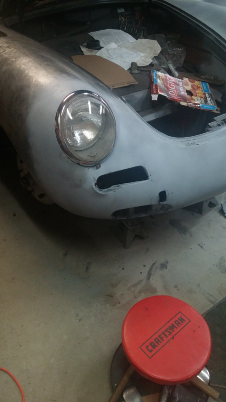

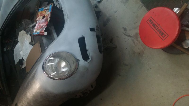

                            Frustrating that I think I documented before disassembly but can't find it. I should have new "standard" rubber gaskets, will look. Got the driver's side bucket in. Went in much easier, probably because it came out that same opening, although I was a little concerned that my flange repairs may not been at the correct angel, but lucked out. The good news is on this side I have drilled out spot weld holes to line up, so will put some tek screws in, masking tape, and test fit with "standard" gasket. On the passenger side, the original bucket had to "adapt" to a NOS opening. Took a little more effort. Nice to see the nose coming together finally.
