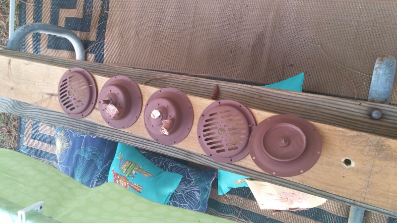

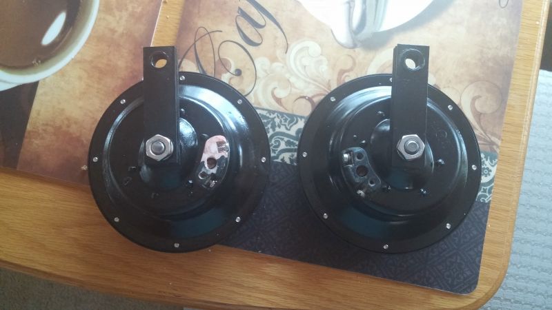

          • I have been slowly getting the horns cleaned up. Harder to do without my blast cabinet but finally ready for top coat.

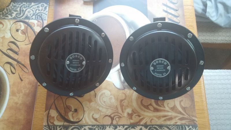

            • Horns painted and assembled with new SIC hardware. Had to do an epoxy repair to one of the bakelite connectors and need to finish coat that. Not having the car, I hope I have the brackets at correct orientation. Do wire terminals face out or in?

              Also, which horn gets which tag, for the puritsts?

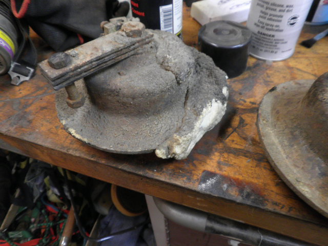

              Here is one horn before, complete with foam:

              • Turned out really nice Phill! Wire terminals face inward and slightly up. I'm sure Bruce or Jack will have the answer on the ID Tags.
                • In my notes, I have 6/3 is the low tone horn and on the right side. 6/4, high tone, left side. BTW, the grill screws were painted black.

                    I got a lead on a horn expert in Naples, FL Julian Hardy. Here is his comments:
                    "The data tags need to be switched. The 6/4 goes on the smaller cup(tags behind the grill) the 6/3 goes on the larger cup. The correct tags are 6/15 and 6/16. The cost is $20 each plus shipping."
                    I figured those screws might be painted after looking at a few pictures. Seems odd that Bosch would paint after assembling all but the tag. Since I have to remove the tags I can shoot some paint on the screw heads.
                    • Back home in the shop after getting the yard, house, etc. cleaned up and wild turkey in the freezer. I had not tried to see if the horns worked during the cosmetic restoration so tried them in the shop and neither worked. Took them both apart and cleaned and filed the point contacts and readjusted. Both horns now work. Some tips: do not disassemble the contacts, as re-assembly is very difficult. Just loosen the top screw holding about 6 parts together and pivot the contacts out where you can file them smooth. Reinstalling capacitors is very, very hard, so leave them in if possible. They apparently seldom are bad. Also, careful when reassembling, as you can bend the upper contact plate if you are off 90 degrees. You would think that the 2 rectangular magnetic plates would be aligned, but they need to be 90 degrees off for the points to adjust and work properly. So I would not lose the horns I just installed them on their brackets until I need to get in that area for more body work. Need to paint the outer screws black also.

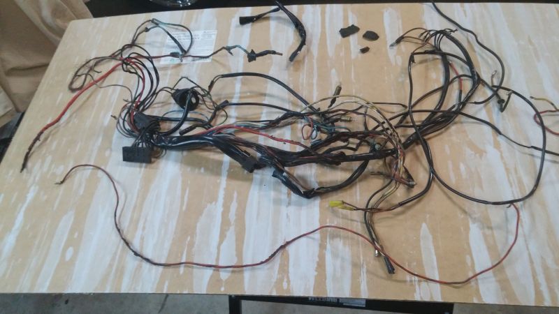

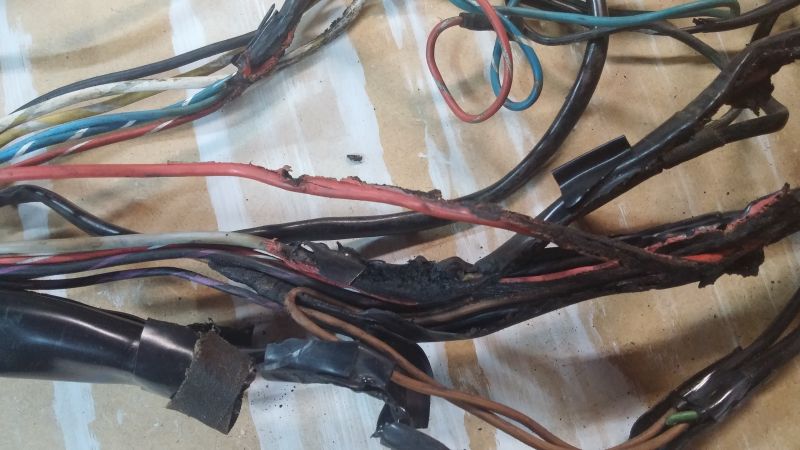

                      Now back to the under dash wire harness. I left my data sheet with measurement for the plastic wrap in FL, so hopefully can proceed without it or get a neighbor to retrieve it and fax to me. Got the harness laid out on a work surface and will have at it in earnest soon.

                      • I've been wondering what to do with my loom/harness, so I'm looking forward to your approach mate.

                        • Glad to see you back at it Phil. Not going with a new harness? I think Bruce would advise on a new one as that's what he recommended for my project. Like Jonesy however, I'll be interested in watching you save this one.

                            • Thanks guys for the tips/encouragement. DG(Dave), if you have the underdash harness "handy", I could use the length of the large red wire that goes from the fuse box to the headlight switch. There are 2 red wires coming from the fuse block. The other one(smaller gauge I think and longer) goes to the lighter/clock. I think the C went to slip on connectors instead of the bullet, but lengths should be the same. I also need length of the internal harness red wire from headlight switch to ignition switch. Hard to measure unless harness is taken apart as it is all hidden in the plastic wrap. Those are the 2 main wires needing replacing. I'm hoping Bruce still has his wire "stash" as I could use a few of the bi-colored wires also. I have been measuring those two wire diameters, and studying Greg Bryans good articles along with the Leoni wiring books. I think I can get the red wires "locally" in the proper gauge. I ordered 10 new bullet connectors from Stoddard to solder on. Need to get on Mcmaster Carr site to see what kind of shrink wrap sizes they have. Could not find what I need at Harbor Freight.
                              • Phil, the smaller red wire to the clock/lighter is from the fused side of the 30 circuit ( at the bottom of the fuse box when mounted. BTW, Schematics often show the fuse box inverted. When mounted "hot is top". On T6 LHD, the #1 fuse is the one closest to the hood hinge). The large red wire to the headlight switch would be better placed to the ignition switch first, then linked to the headlight switch to avoid voltage drop to the starter (the greatest amp draw). Interesting that a similar fault correction by factory bulletin for the 1966 VW beetle was given.
                                Another concern is that when mounting the fuse box to the firewall, do not allow the bundle of wires to become pinched behind the box. Tight clearances there, and disasters can prevail.
                                Oh, you did solder all the connections on the riveted bridges on the back side of the fuse box? Good. I knew you wouldn't let that small issue get by! Nice to see you back at it from a well deserved rest.
