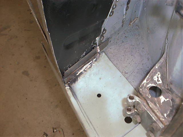

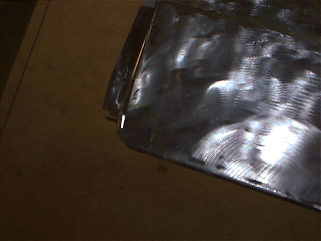

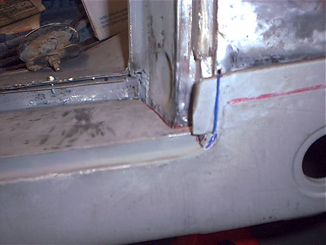

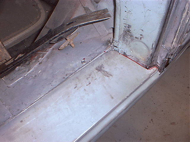

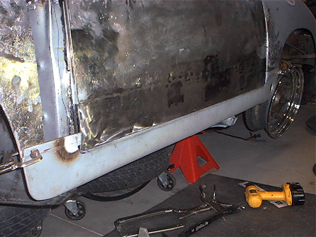

      Today I finished the rough installation of the rocker panel by making a new front flange and finally getting the back to fit up pretty good.

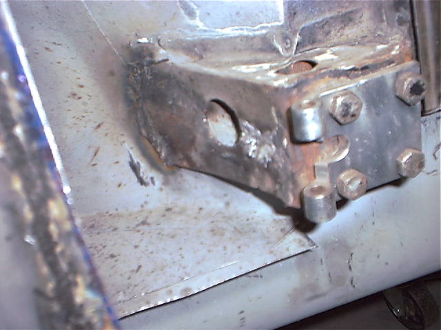

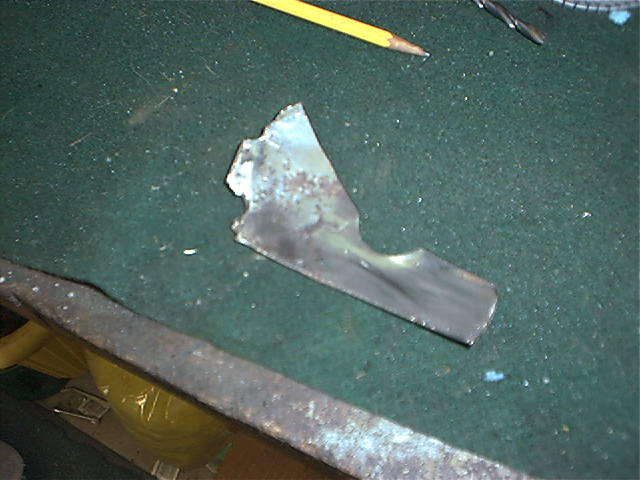

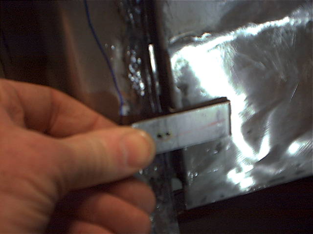

      Next I decided I better weld back in a piece of the lower hinge box that I removed in 2002. Can't believe I did not loose it. Had to remove 2 layers of sheet metal and the inboard edge where it was welded to the body at the factory. Got it cleaned up and welded back in place. This was removed to gain access to the rusty metal under the hinge box and repair it.

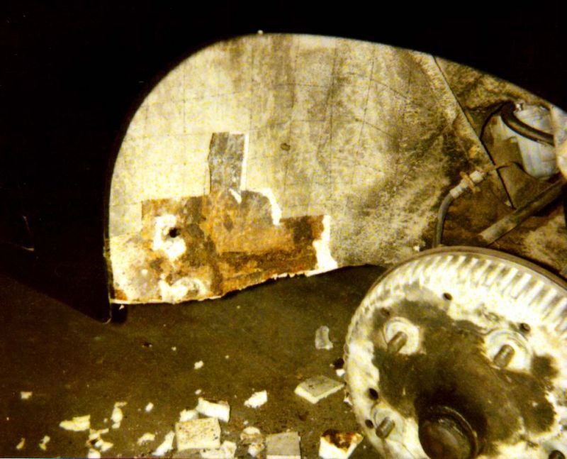

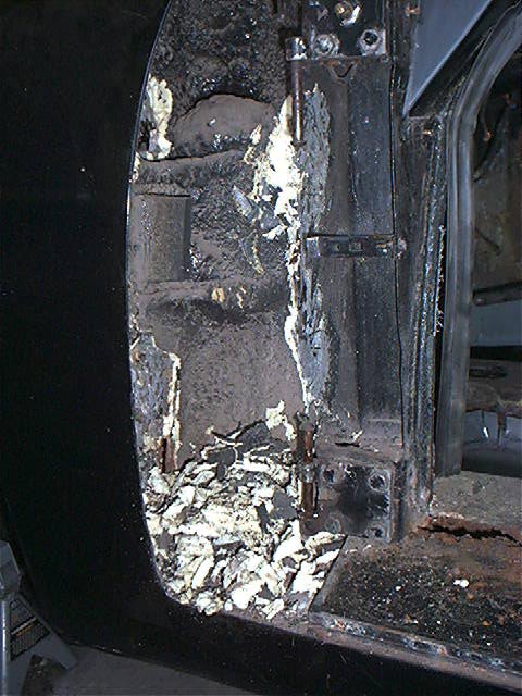

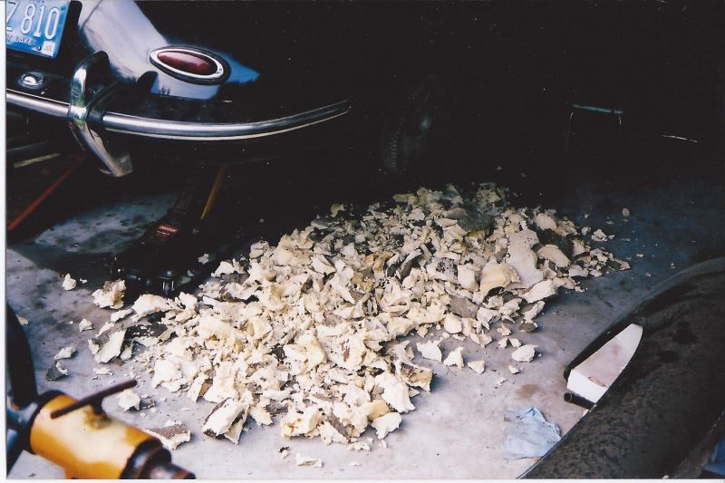

      While filing the above pictures, I found some taken in 2002 when I started the repair in this area. This is some of the foam removed:

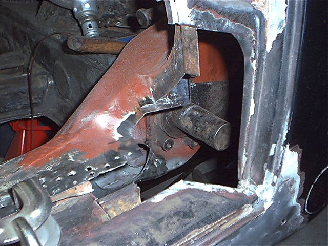

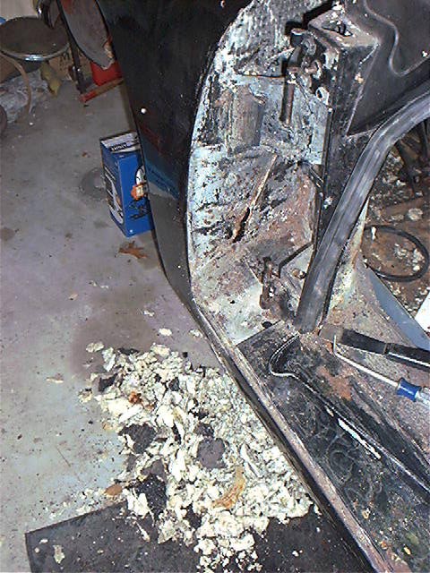

          Justin - One develops techniques for foam removal. Not a big job market for this though. I started at the front of Faomcar and worked my way around clockwise, repairing rusted inner structure as I went. So by the time I got to this area I was getting pretty good at it. This picture shows the "cut the wedding cake technique".

            Phil, looks like that foam was storing a lot of moisture
            between metal and foam. How thick was the foam?
            Gordon
            • #36
              Gordon
              Actually, I think the foam helped preserve a lot of metal. It was sprayed right over the rust and good metal. I saw no signs of deterioration on a lot of the metal above the "rust line" that most of these cars developed. Thickness varied from 1/2" - 2".

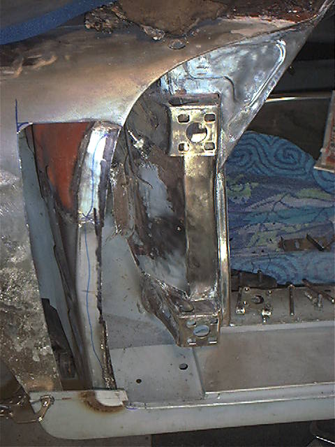

                Spent 2 hours today(up to 1242) finally getting the rocker and door on the car at one time. First fitting showed the expected interference at lower front:
                I marked where the new contour needed to be:

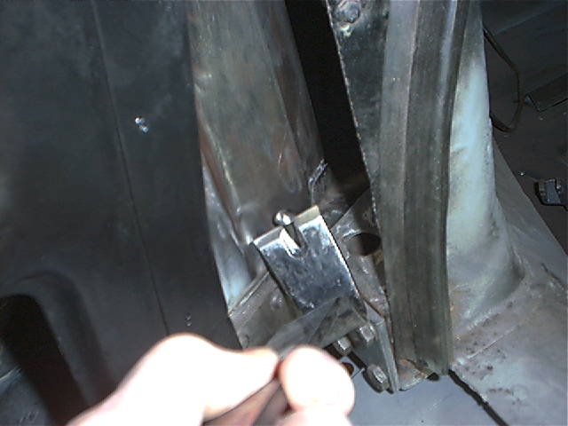

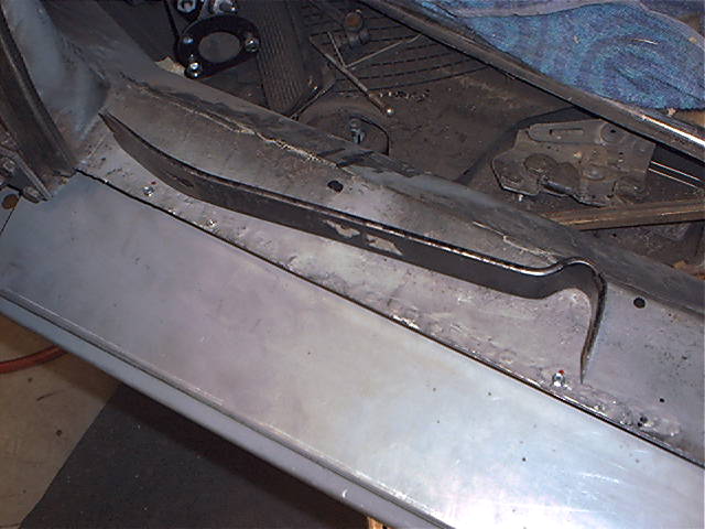

                Here is my door and foam removal tool:
                I have used this a zillion times to remove the door on the passenger side. Will be up to 2 zillion by the time I get the drivers side finished. Here is the tool in action:

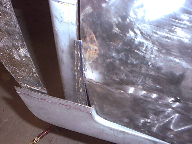

                Could not close the door all the way after trimming the closing panel edge due to required rework at the rear:
                Reshaped the rear bottom and could now close the door. Got a rough lower gap:
                Next step is to reinstall weatherstrip and add some layers of masking tape to simulate the door trim. Then some final tweaking of the door shims, as the lower rear needs to move inboard.
                My rocker fit problem with the longitudinal bulkheads was not a problem, after crawling under to inspect. I had not ground down the welds at the front upper portion of the outer longitudinal under the lower door hinge. Did that and fit(upper rocker flange going flush with upper longitudinal flange.

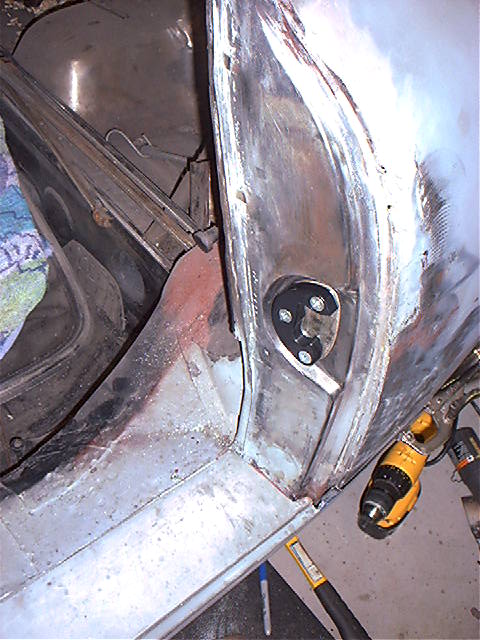

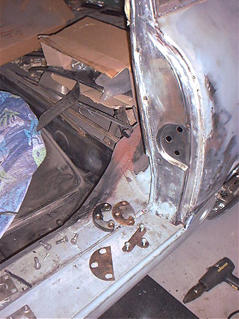

                    I bought my rockers from Stoddard years ago when I was overly optimistic about how long this project would take. I believe theirs have improved since then. Don't know who their supplier was at the time. Restoration Design had different owners back then. I am at hour 1248. Have taken a time out as I needed to remove the remaining paint from the hinge and lock pillar. Also cleaned up the cruddy looking door latch and installed it. Did not like the overlap with the striker on the hinge pillar(not enough) although I think it is what it was before starting this project looking at the wear marks. So today, along with removing the paint, I removed the striker and cleaned up all of the parts. Installed new bolts in the bracket and of course cannot find the new strikers. Anyway, a little more rework required on the rear of the rocker to get it further inboard(did not make a bend on the mark I made). Tomorrow I will do that rework and look for my strikers(I did order them didn't I?).
                    this is what this area looked like a few years back:

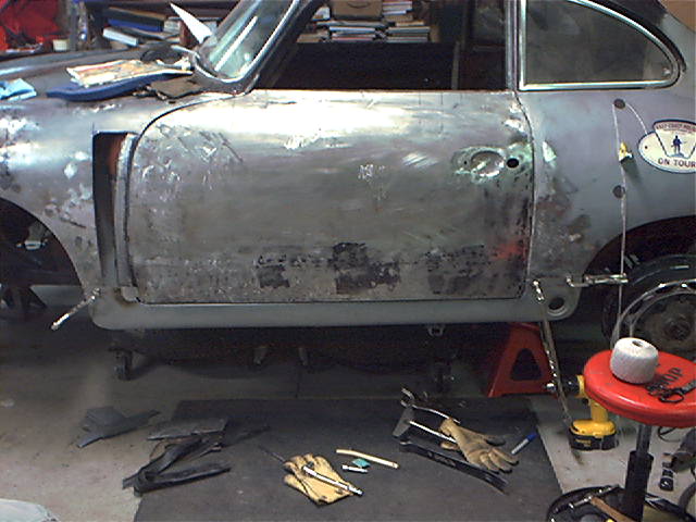

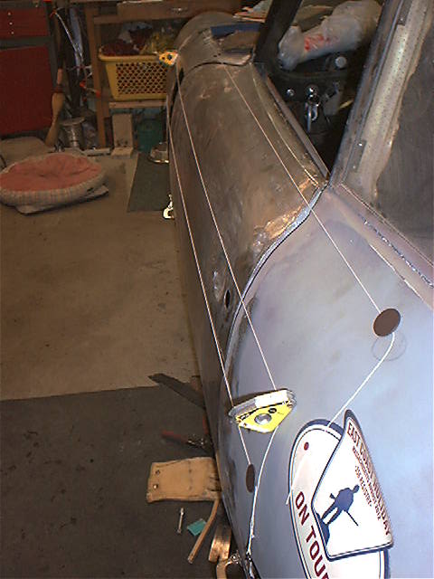

                        Reinstalled rocker after moving the lower rear pillar flange forward and grinding off remains of old flange still on pillar. Added one thick shim to top hinge and reinstalled door. Put some strings along body to check alignment.

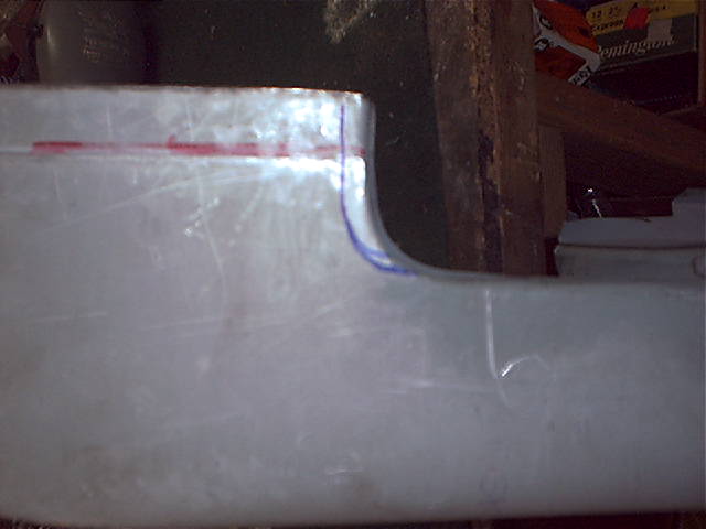

                        You can see the top rear is too far out. May need to add a shim at bottom. Removed door to modify front lower corner from square(why did I leave it that way?) to round 1 1/4" radius.

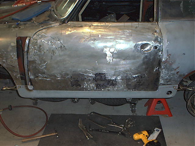

                        Reinstalled door and adjusted rocker for pretty even bottom gap.
