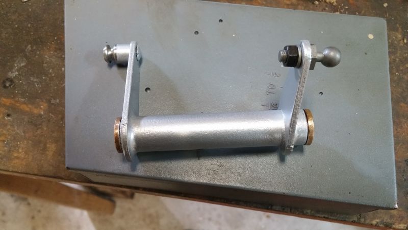

    Will see how it lines up with the chassis hole. Hopefully with good lube the Stoddard replacement will last a while. I have only brazed a few things. Not enough to attempt the repairs you have done. But sounds like a permanent solution.
    • Phil, I don't like to use typical lube there, as under the car dirt and grit can collect. Perhaps graphite powder?
      • If you guys are referring to the tight curve that wears thin on the accelerator pull rod, I braze those as well. Or flux with siver-solder. It may be fine as done and cleaned or need some small file touch-up, but it does last longer than the steel-on-steel.
        As for the offset of the one arm of the bellcrank, yes, they have been all over the place. Made by Hand becomes Made to Fit.

          • The Stoddard part peened over quite well, without deforming the working end. I looked in "Neil's Book" at this part on an A and it has an offset lever for alignment to the hole. If you look at the pic above, there are 3 washers(shims?). Maybe by 1963 this is how the factory adjusted rather than bending the lever.

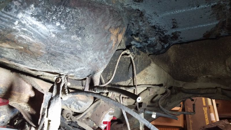

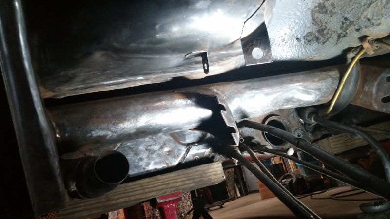

            • Got 2/3 of the rear tar paper removed today, along with a thin foam coating. Not the best pic but did not feel like crawling back under:

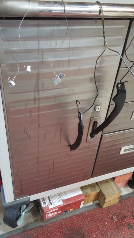

              Got out the coat hook and someone had brazed it(Bruce, Jack?):

              Got the bell crank painted and assembled:

              Had to file down the bushing flanges as way too thick(.100"). Here is situation before filing:

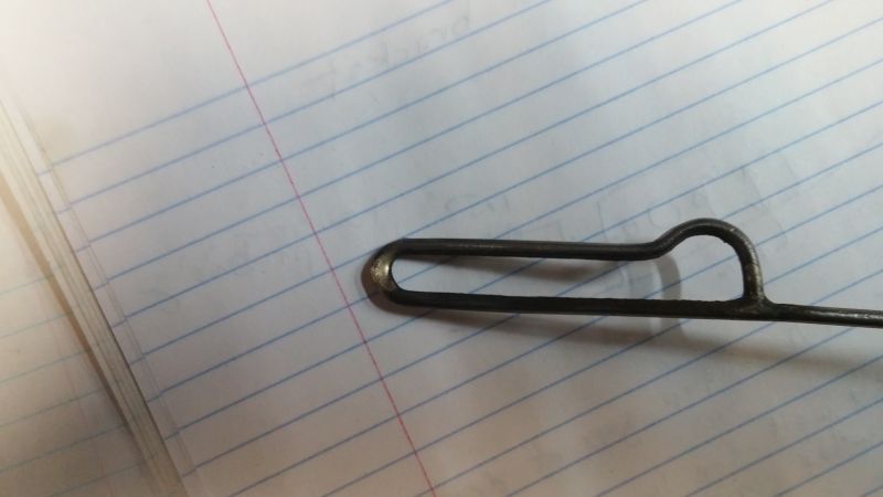

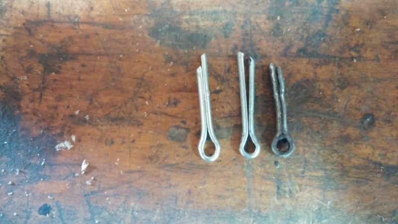

              Tried to reproduce cotter pin shape as the one removed(original?).
              The eye is circular and the ends are at an angle instead of offset:

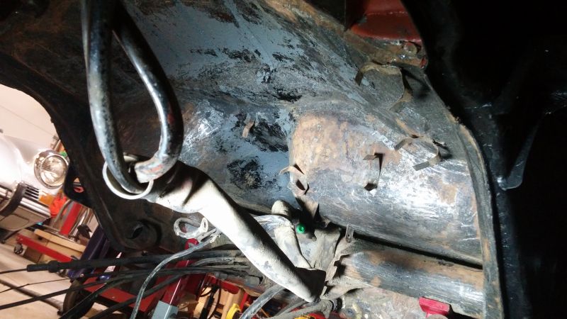

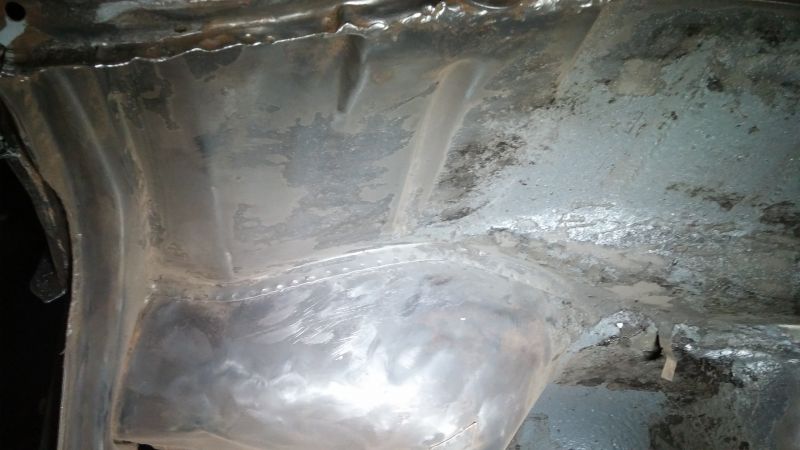

              • Got all of the tar paper off and most of the undercoating except a nice clean area covered by slate gray. May leave it as metal is clean around the edge. Took about 3 hours with the heat gun and a putty knife to get this far:
                Forgot to take pictures of my planned new undercoating. I have a can of the solvent based undercoat that Bruce referred(Shutz?) and a can of bedliner coating. I plan to use the bedliner on the front closing panels in the area where road debris is thrown, as on my PreA the undercoat wore off in this area.

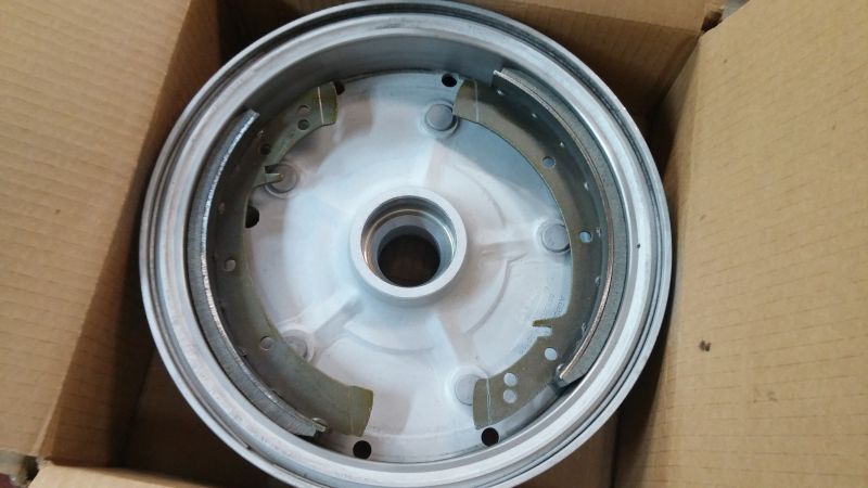

                Got my front drums relined by Martin Willis and the shoes relined by an outfit in Ft. Wayne, IN. Will take all the drums and shoes to Vic Skirmants for arcing of the shoes, along with trueing up the rear drums, as he also has a drum lathe.

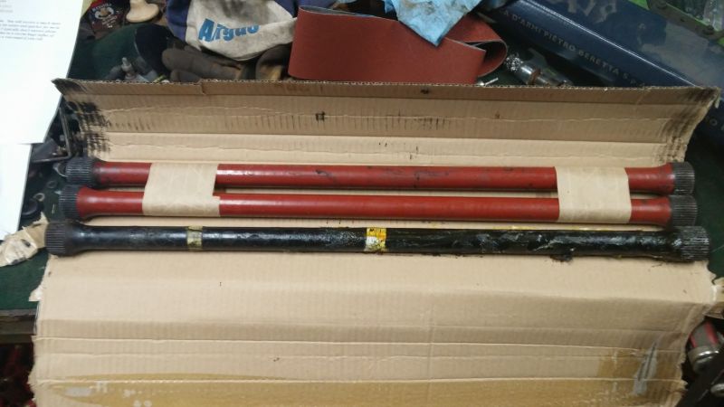

                Ordered 24mm rear torsion bars from EASY, as no new ones are available that I could find. Talked to Automotion and they referred me to a salvage yard. These will replace the 23mm bars and camber compensator.

                • I just found a shoe-arcing machine in storage above a local machine shop, cheap. "No call for that anymore" said the owner.
                  My concern is floor space vs need. I have a business neighbor who lets me use his old drum lathe if they can be trued and they are still within spec and don't reveal "hot spots" of bi-metal corrosion.
                  I can then see how close relined shoes are and better that using the belt-sander. After that, I apply sticky 80 grit sandpaper from a roll on the drum liner and just sand the shoe in place until the friction material is concentric with the drum lining, off only the thickness of the sandpaper.
                  Just had another unusable 'A' set of drums and shoes relined and arced by Don Booker at J&G, under $3k and looking like new upon their return. (Good) cores are getting scarce, so we are lucky to have established companies providing these specialty services in regard to safety.

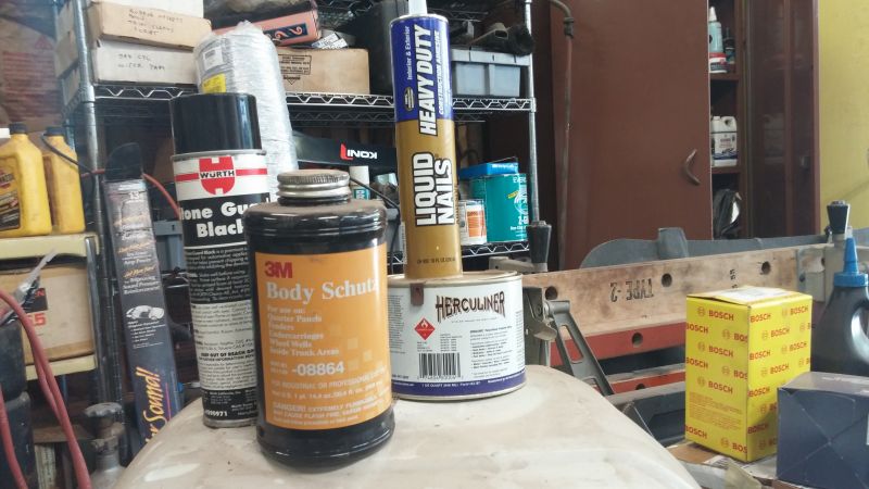

                      • Here are some of my coating products. Bruce recommended the liquid nails for the sound padding as I recall. The other stuff I have had for years, being an optimist that I would have used it up a long time ago:

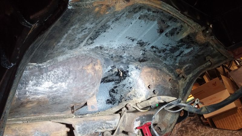

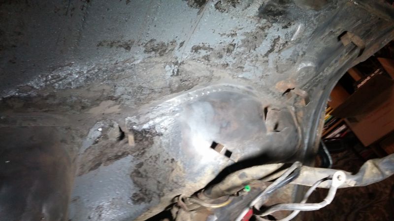

                        I used the wire cup brush on a lightweight angle grinder for about an hour and got as much of the surface rust and undercoat off as it would reach. Wore a mask, face shield, ear muffs and thick leather gloves. Lots of fun. Are you hiring Bruce? Those gloves have protected me from getting cut by the metal tabs Justin. Will have to resort to other tools to reach the rest of it:

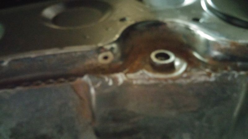

                        Assume these holes are Reutter unigue:

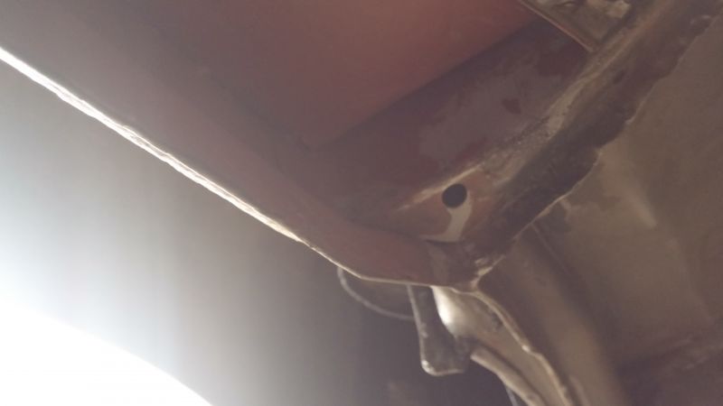

                        Here is a plastic plug in another of the holes. Anything available to replace these?

                        • Phil, I might be tempted to leave those holes open so they'll "drain" if any water happens to find its way back in there.
                          • I agree with Justin. I do not remember those holes specifically in those places, especially with the plugs. Any chance those were access holes for more of the Foam-man's work?
                            I have always theorized that almost-drain holes in later Karmann and Reutter bodies were never routed to increase longevity, but plugged by decree of the accountants at Porsche.
                            Those people already knew that the 900-series cars would be a hard sell if the 356s didn't rust away sooner than later. Of course, those like me in the mid-'60s didn't think the 900-series models would EVER catch on......or think we'd be still enamored of the 356s 50 years later, either.

                            • Thanks for the hole feedback. I am assuming then that these were for some form of rustproofing, as they appear around the enclosed frame area.

                                24mm torsion bars arrived from EASY today:
