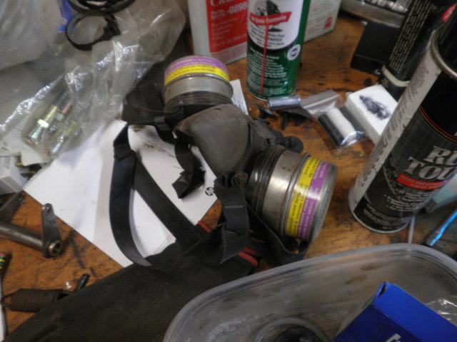

                  • Good discussion and reminder to us all about being careful during our restoration fun. I have used this since I started way back. Note to self: time for some new canisters:

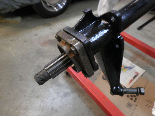

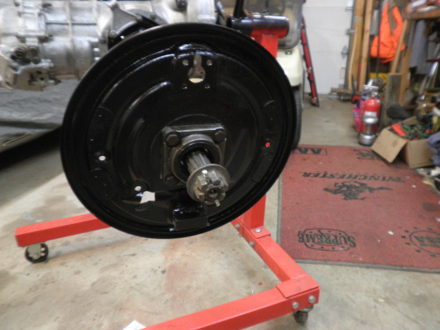

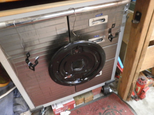

                    Finally got the back plates and brackets primed and top coated:
                    Unfortunately I should have measured the back plates before masking off the clamping area. Measure gap on one side at .172". When plates dry I will peel off the tape and measure. I installed new SKF wheel bearings.

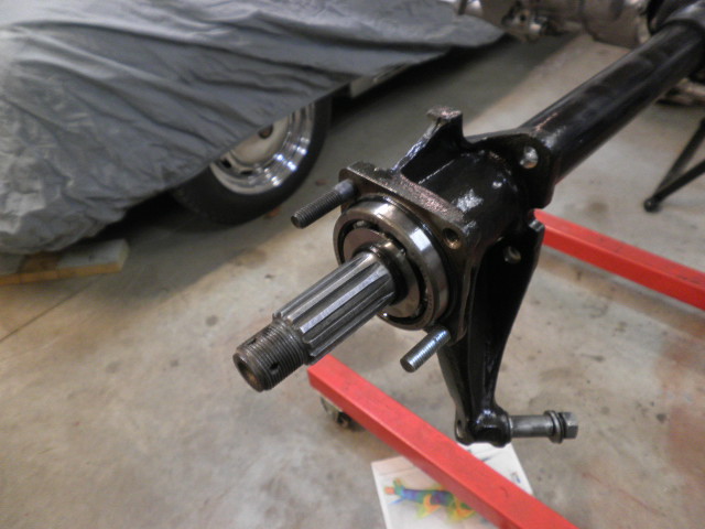

                        • To speed up the project(after all it's been over 15 years) I decided to just spray some Krylon clear coat on the bearing retainers. Got the back plates installed using a tip Al Zim posted on the Registry back in the email only days. Put two studs in to help locate the back plate over the large o-ring:
                          With those 2 studs in place you can hold the back plate tight and install the bearing cover with two regular bolts. Snug those down and then remove the studs and put the other two bolts in.

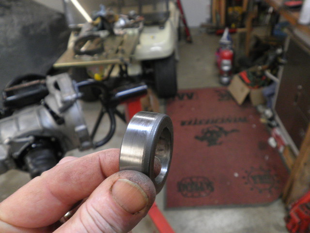

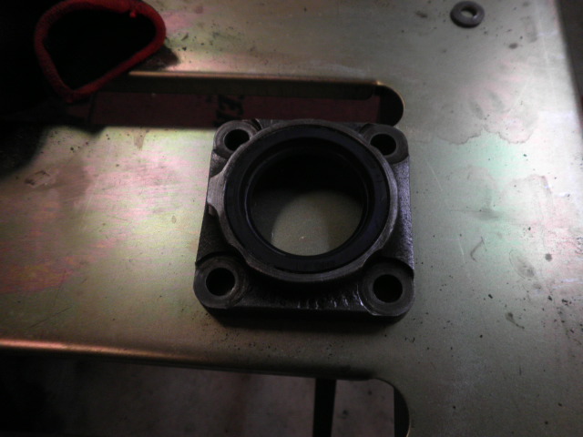

                          Unfortunately one spacer had some deformations right in the area of the seal lip, so need to either turn it down or buy a new spacer. Need to get the diameter spec.

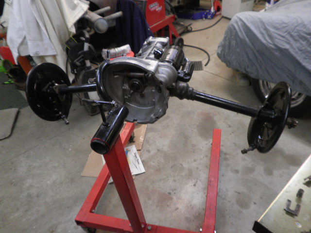

                          With both back plates installed, time to move on to the rear brakes.

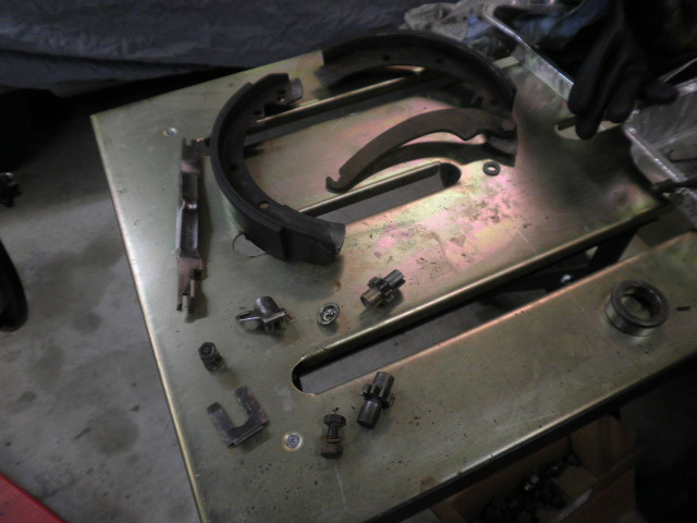

                          Oh the joy of cleaning up all the small parts:
                          The linings don't show a lot of wear, but think I will replace anyway as they may be grease saturated. Will see how they fit the drum.

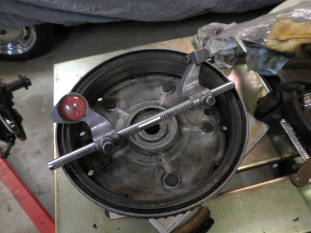

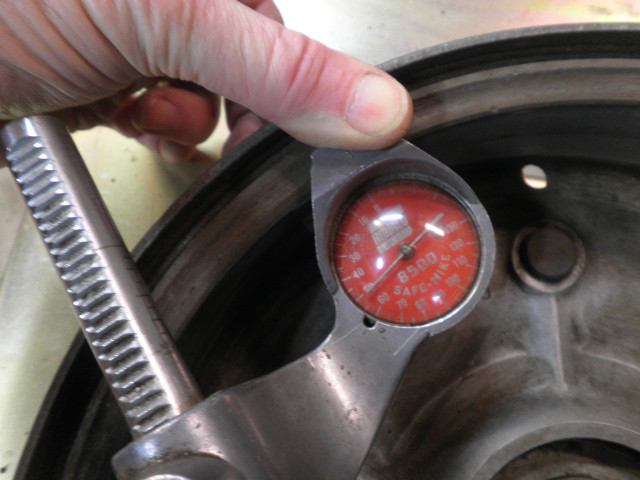

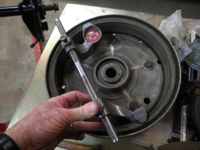

                          • Got both drums measured today with a tool someone gave me years ago. Fortunately both are well within spec. One should be trued a little as is slightly out of round:

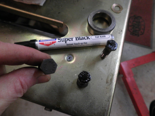

                            How far do we go with a restoration. Looks like back plate bolts were black oxide so used a gun barrel marker to give them a fake black oxide appearance. Used new wavy washers as old one had some rust:
                            This stuff goes on shiny but dries a nice flat black.

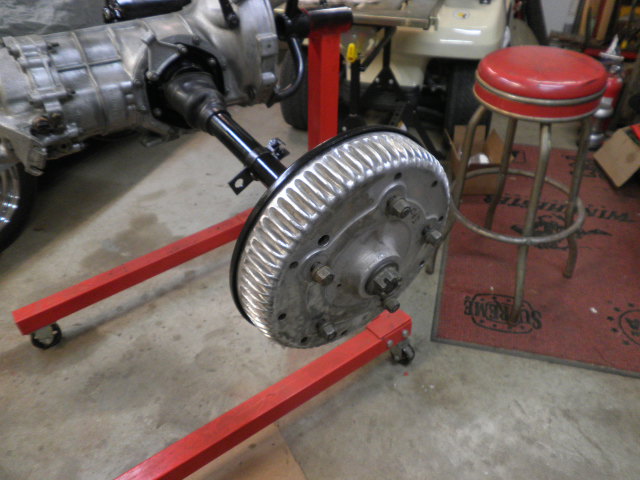

                            Spent the rest of shop time degreasing second brake drum and then starting to clean up the exterior aluminum. Mounted drum on axle to use as a fixture to clean out the bottom of the fins:

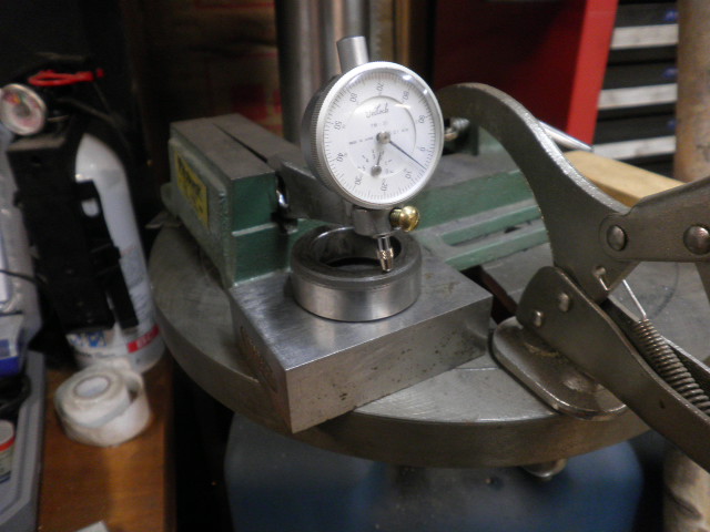

                            I did measure the flatness of the spacer that has a rough diameter area in one spot. It is off by up to .002" so rather than take it to a machine shop to fix two problems, will order a new one:
