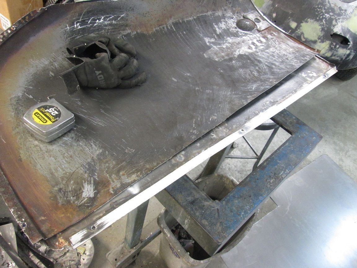

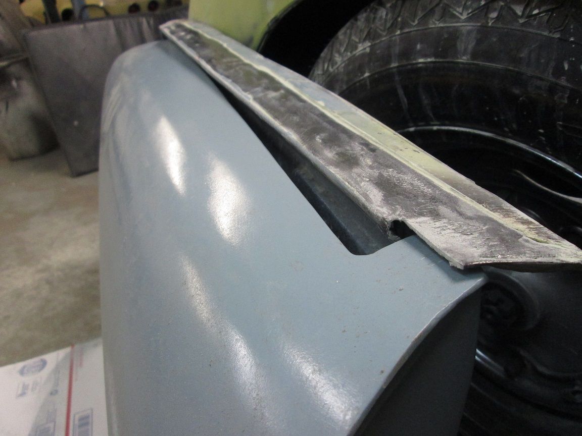

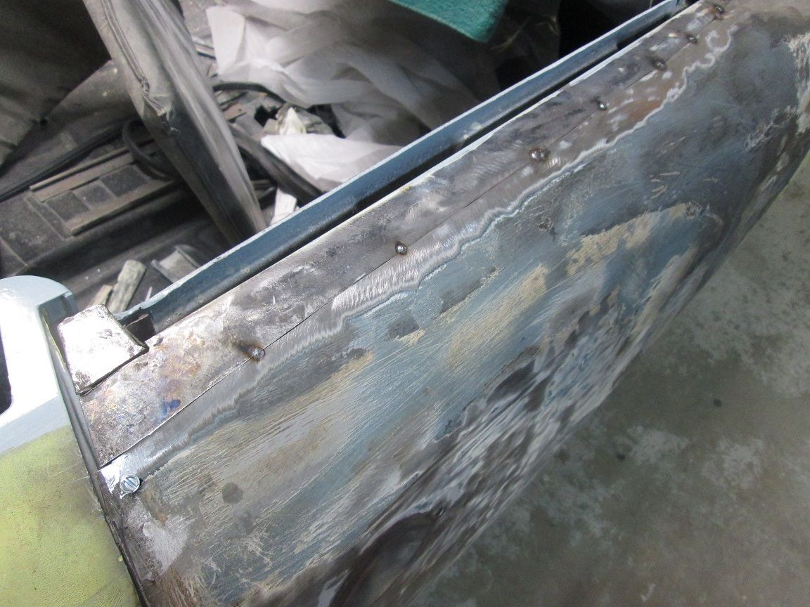

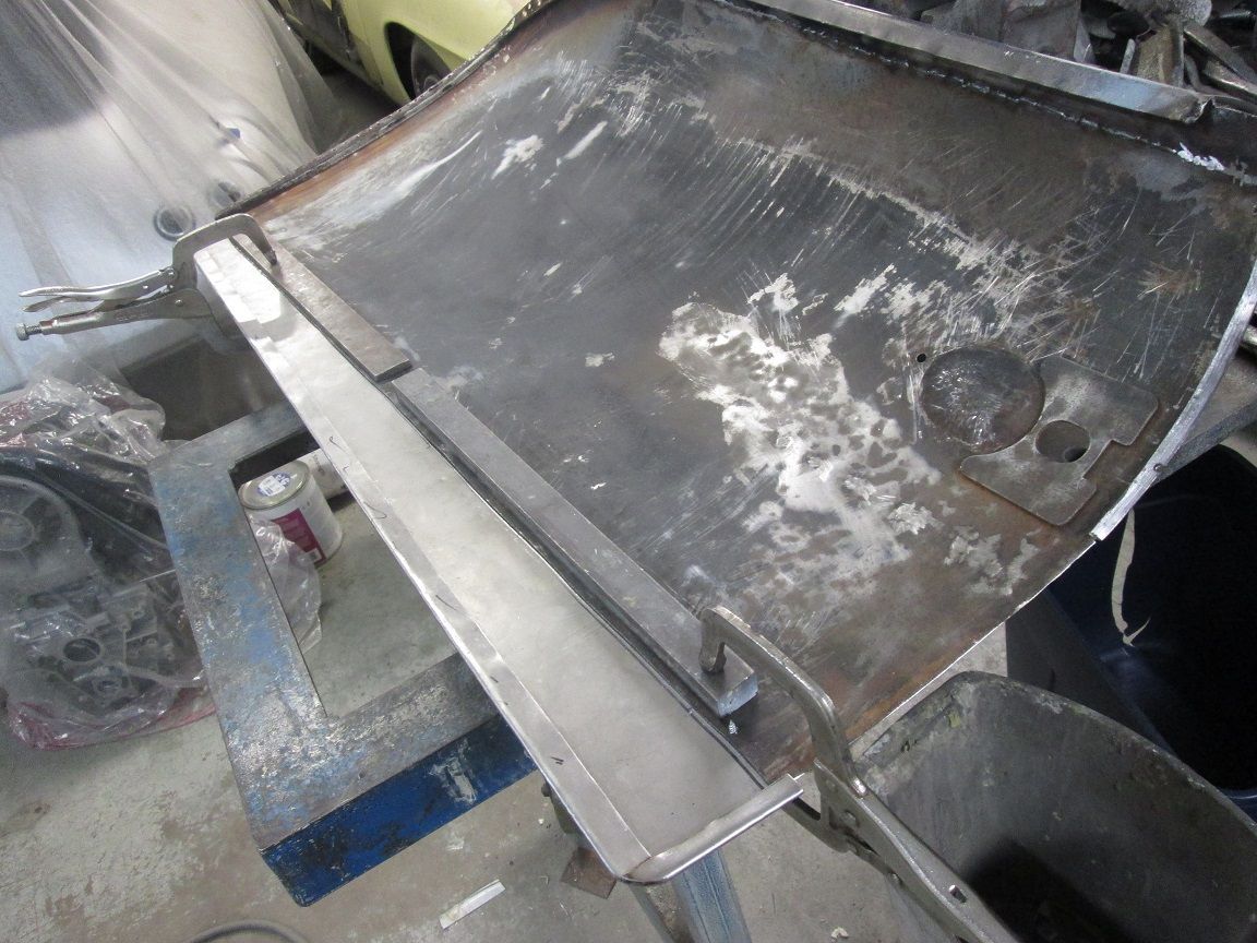

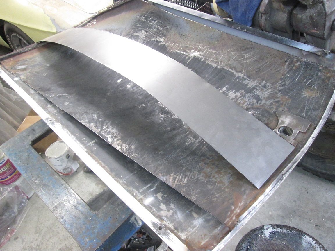

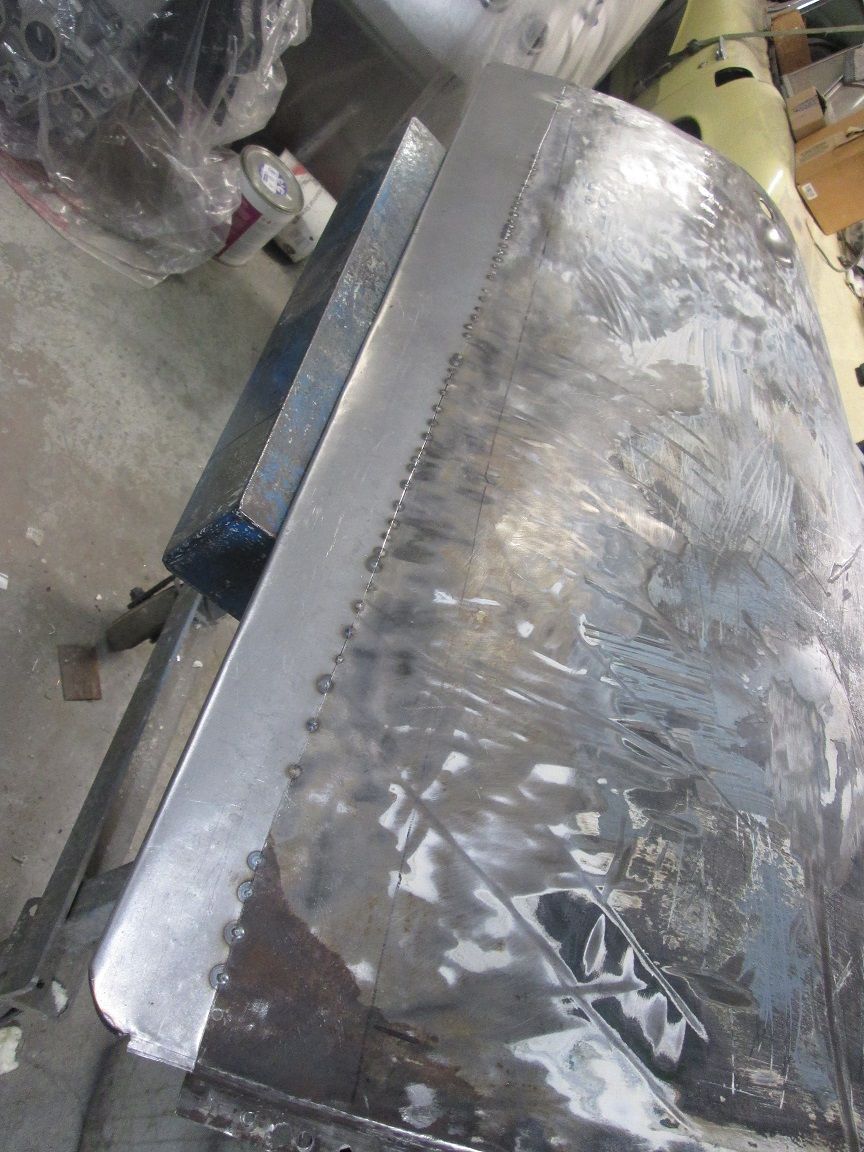

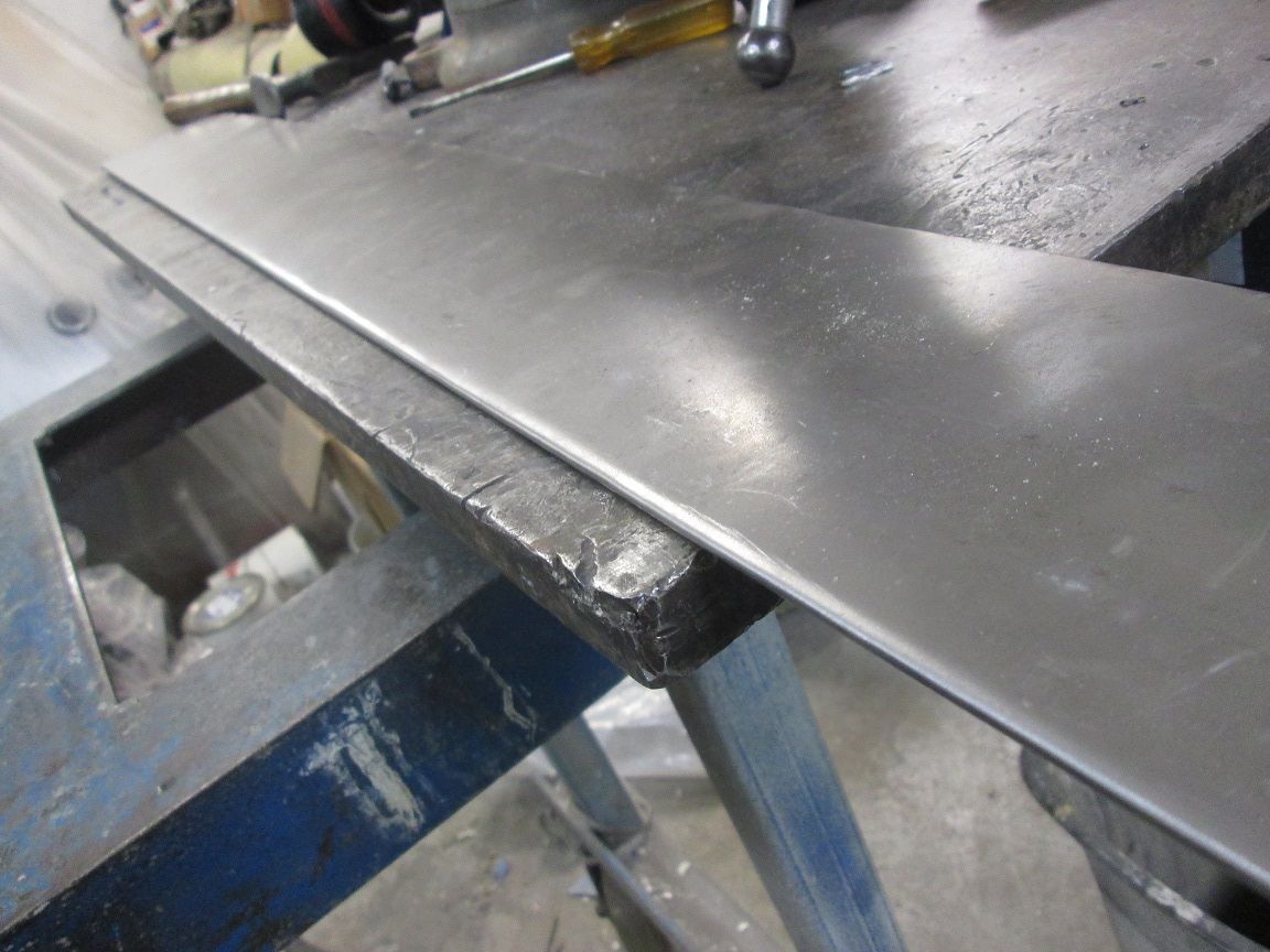

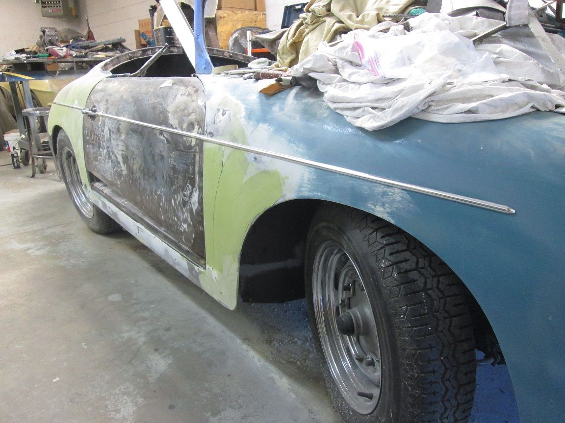

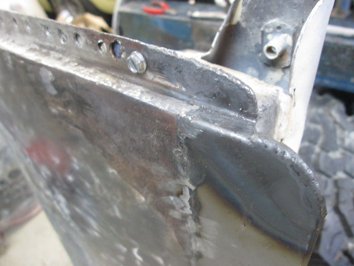

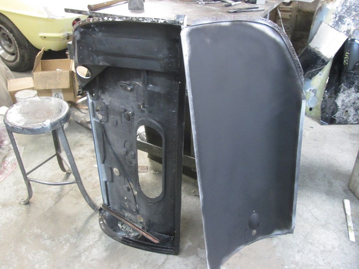

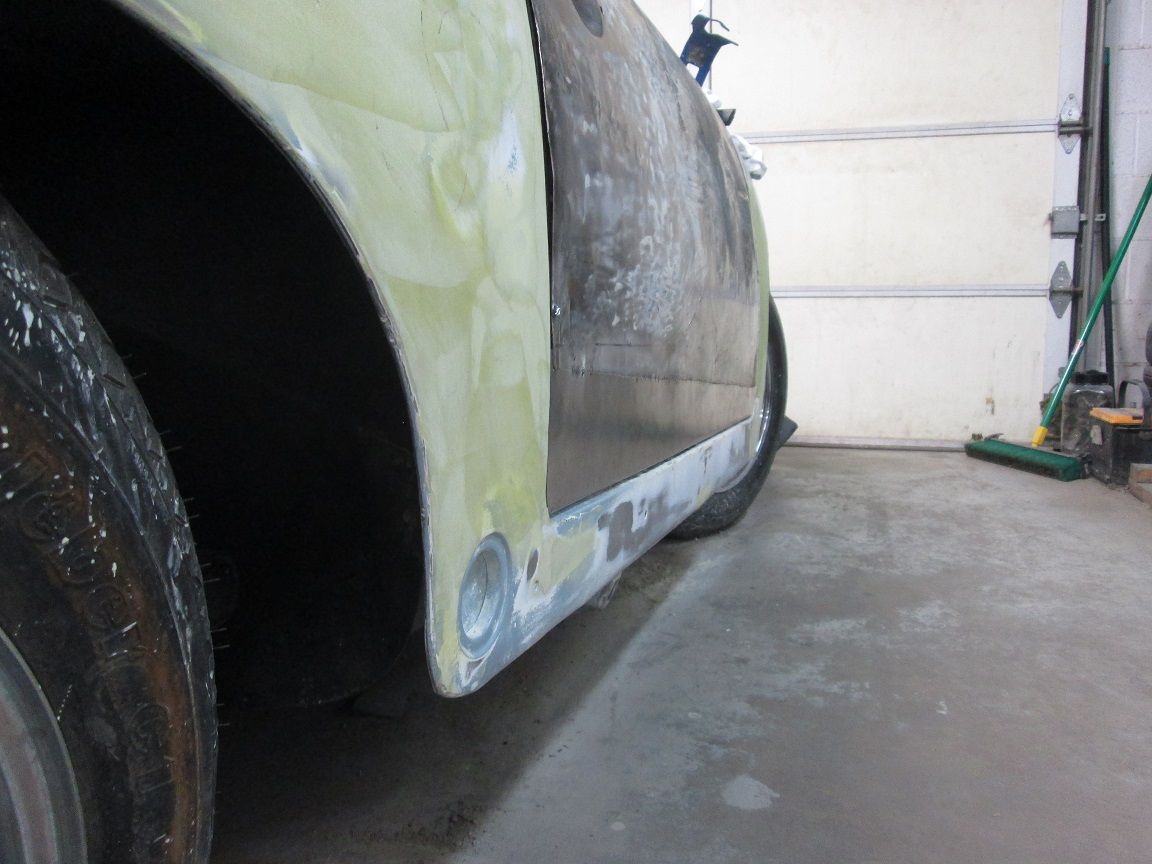

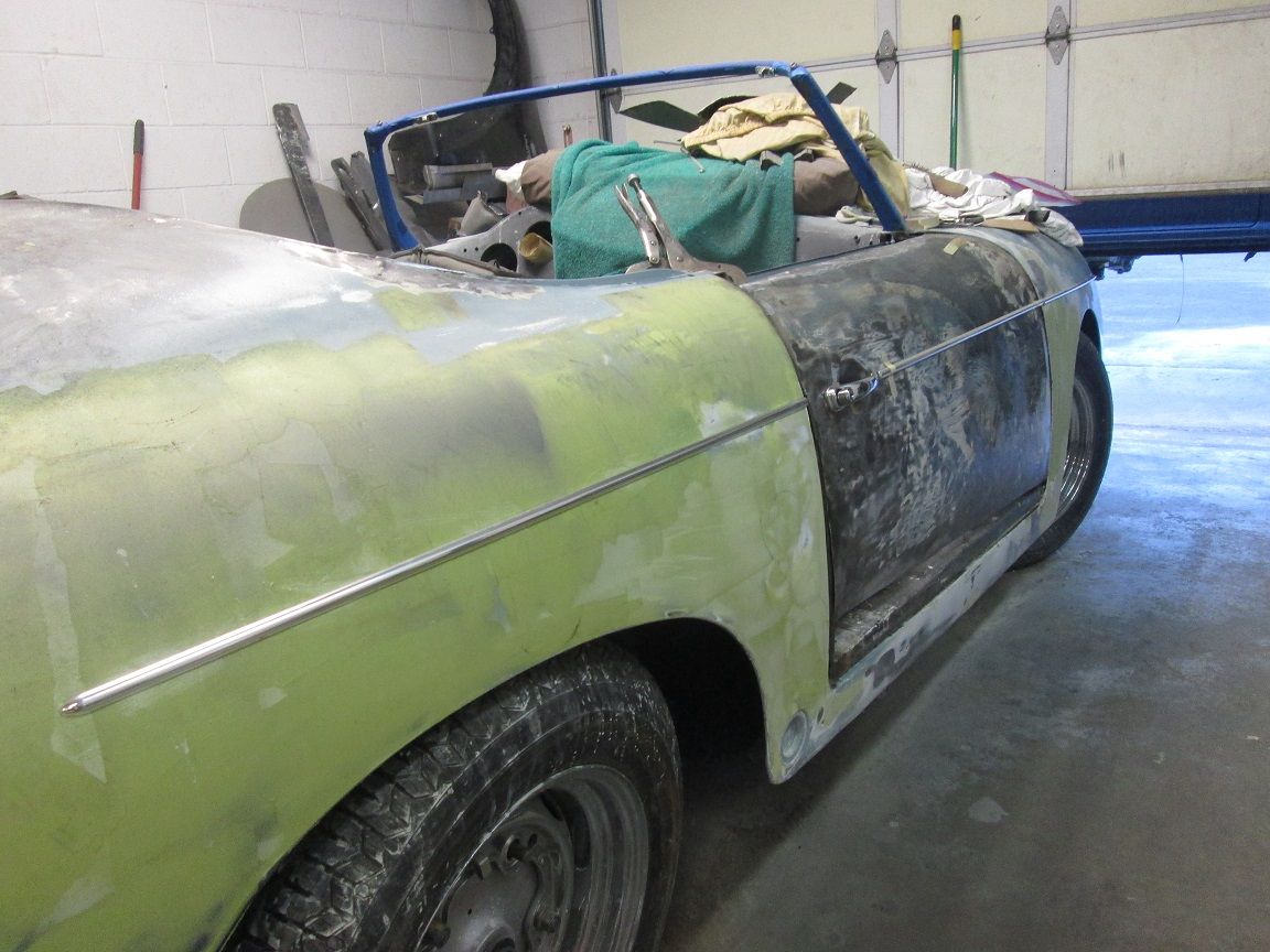

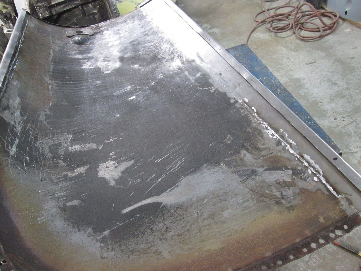

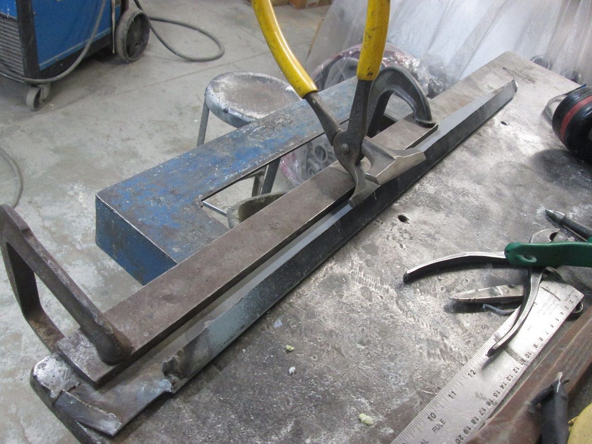

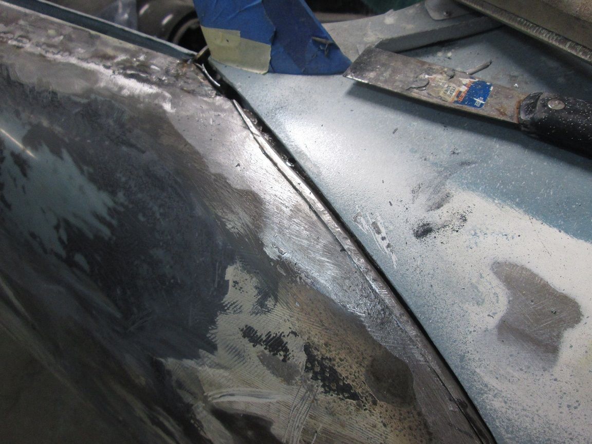

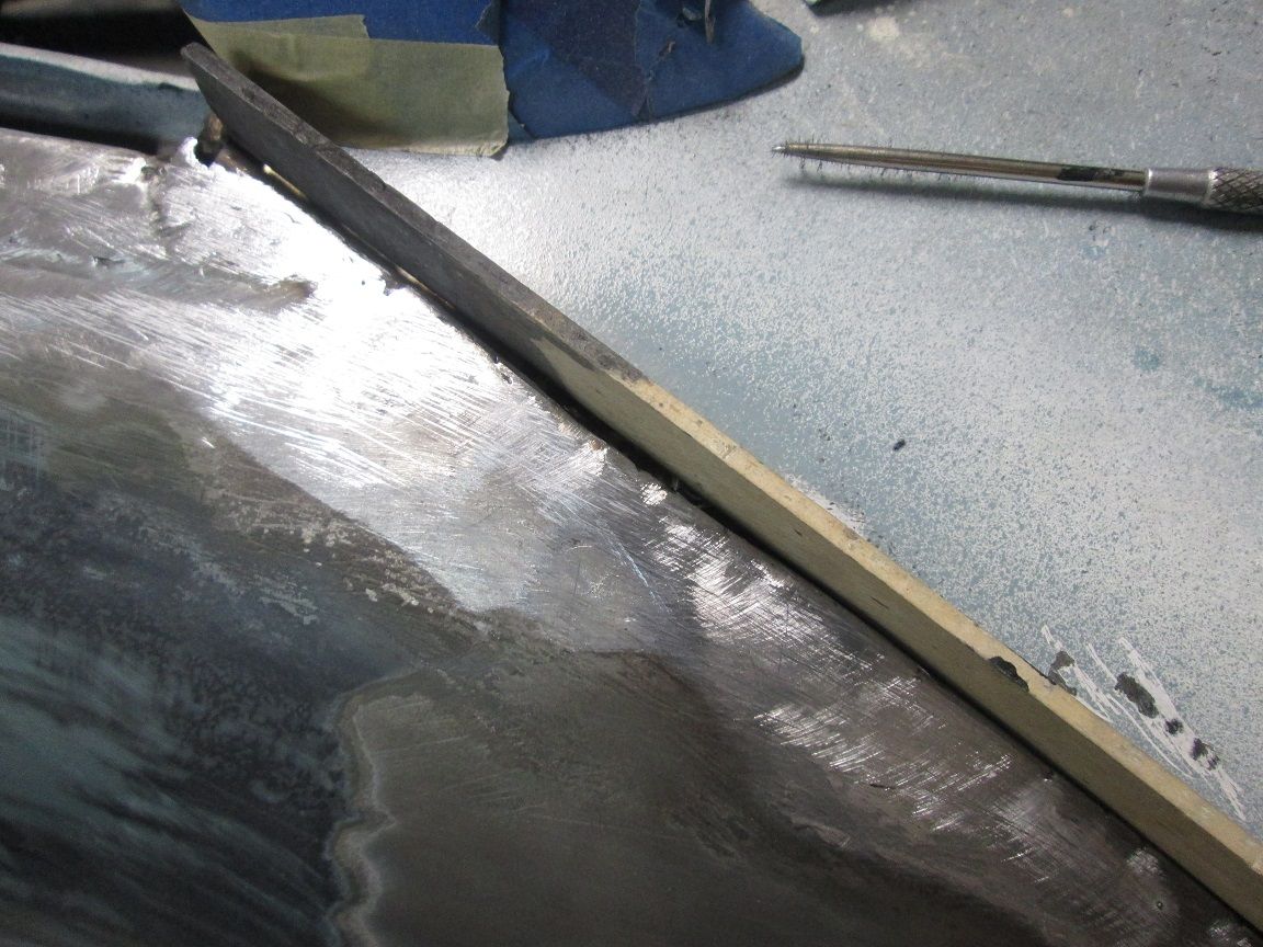

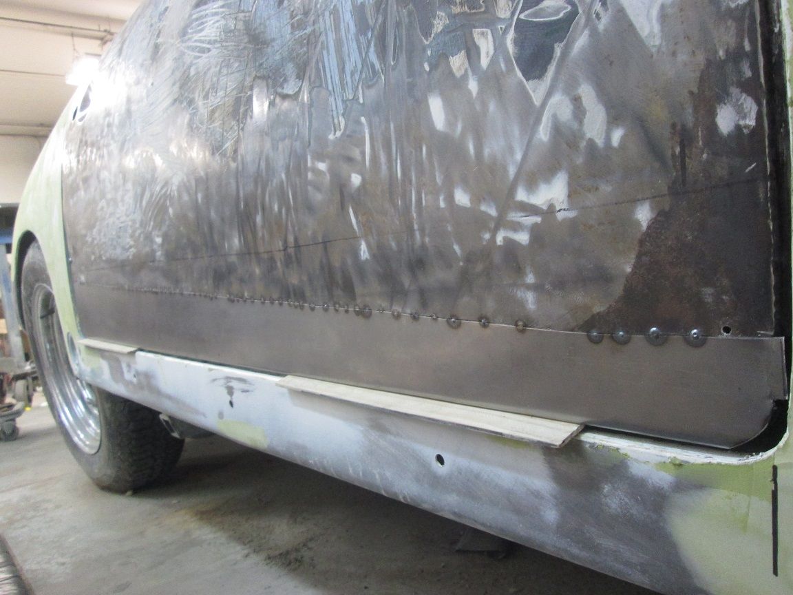

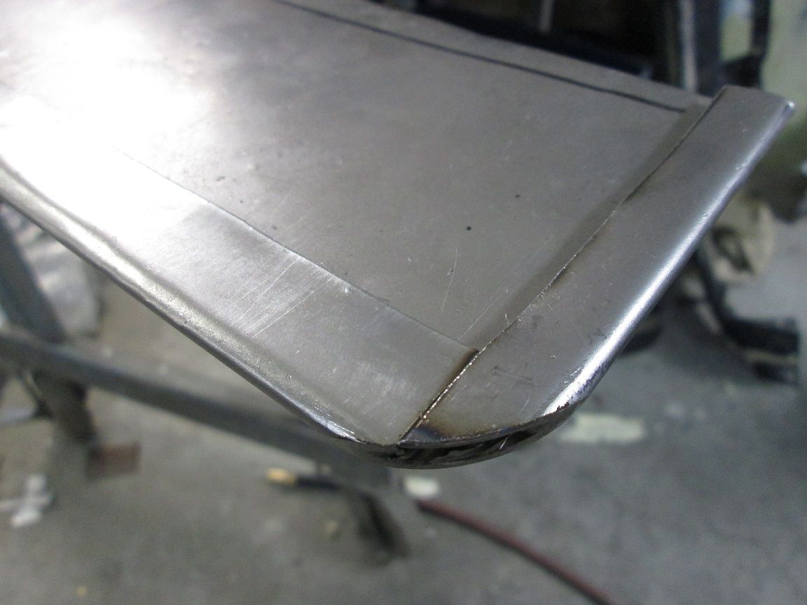

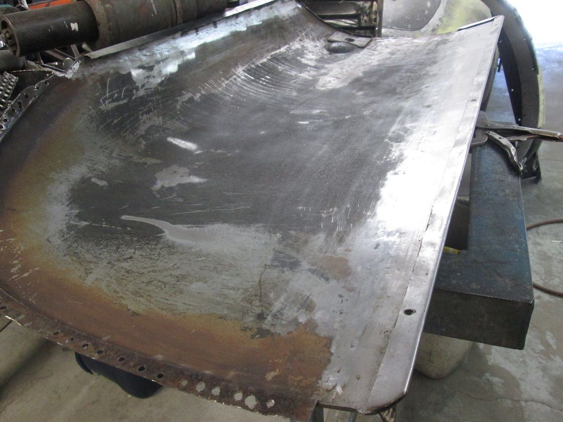

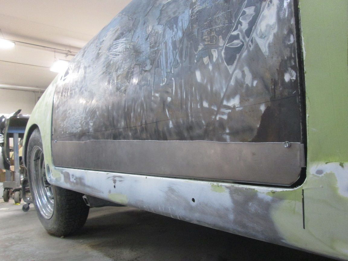

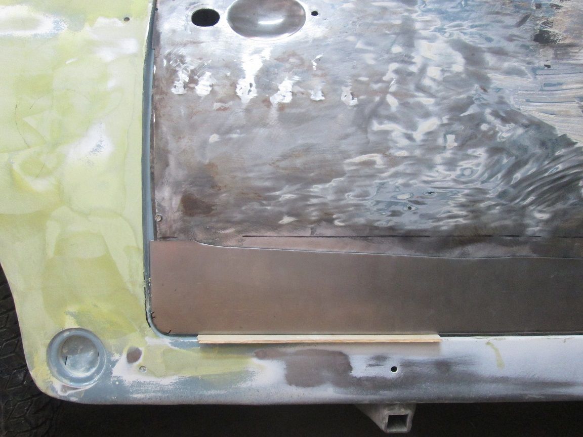

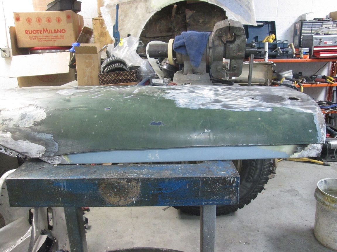

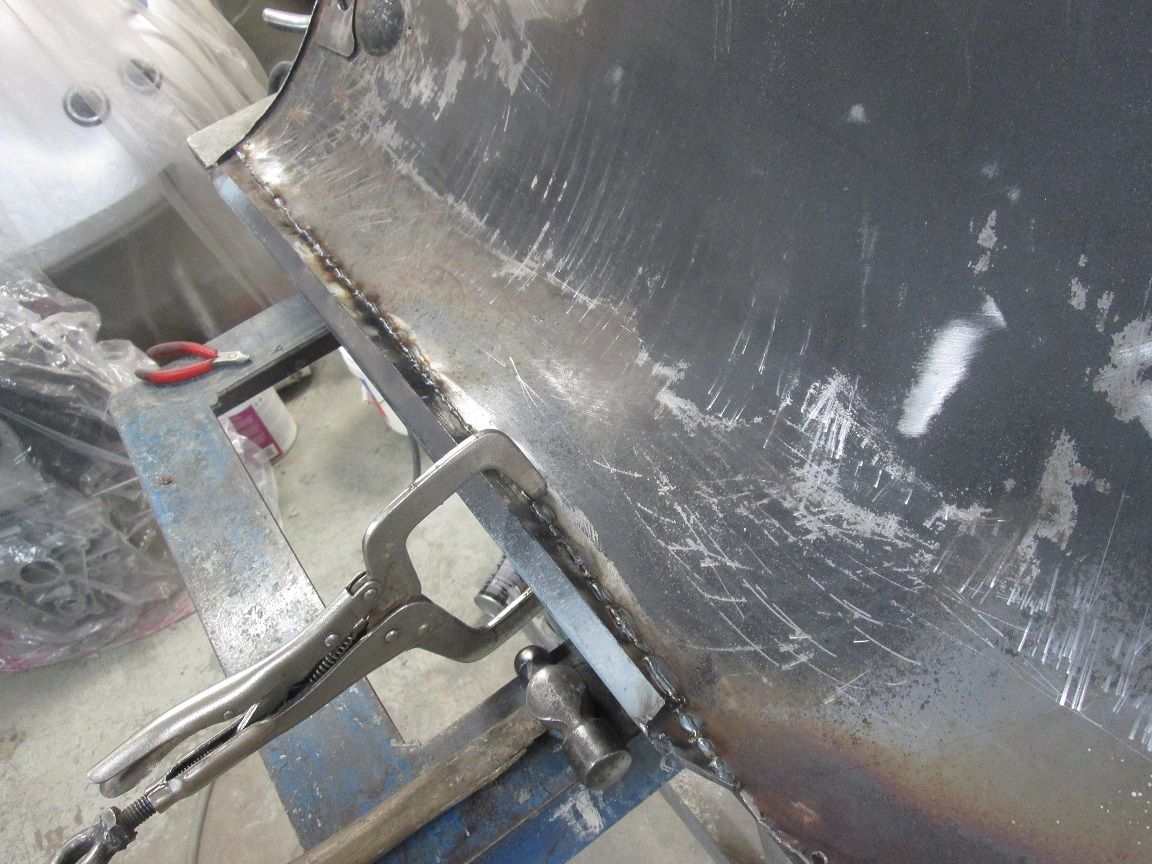

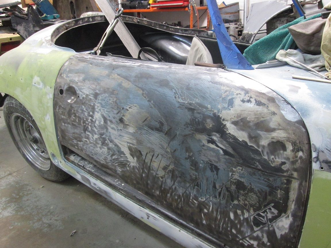

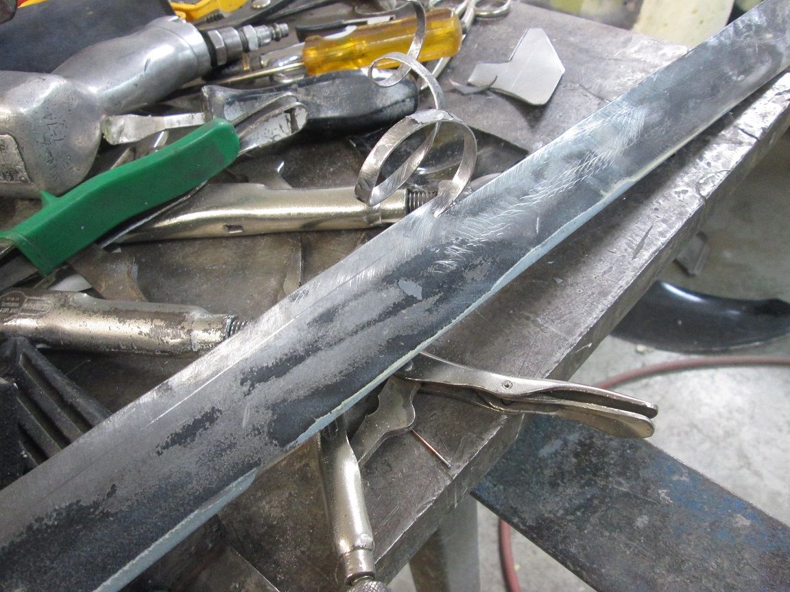

  • Click image for larger version  Name:	IMG_5229.JPG Views:	0 Size:	178.7 KB ID:	108212 For coupe to Roadster skin transition all I'll need is about the last 2 inch strip of it. The crown curvature of the repro skin was always a problem in through here as it was very flat and almost just folded over in this area.; it didn't match the body contour at all. On a positive note this feature will now be the factory contour.

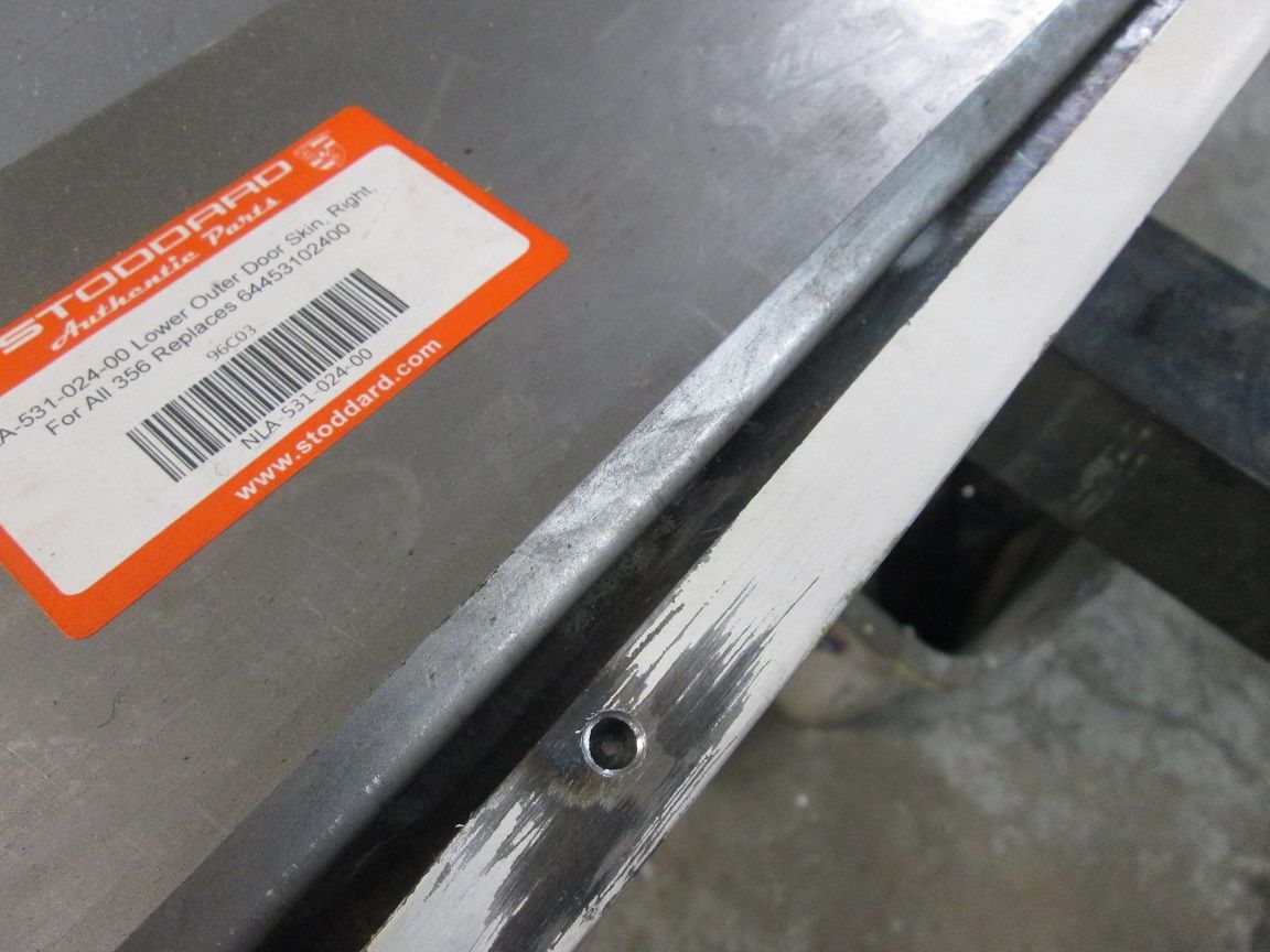

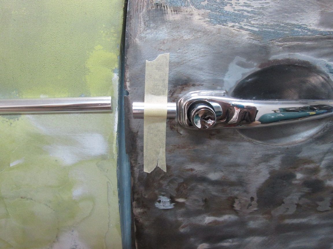

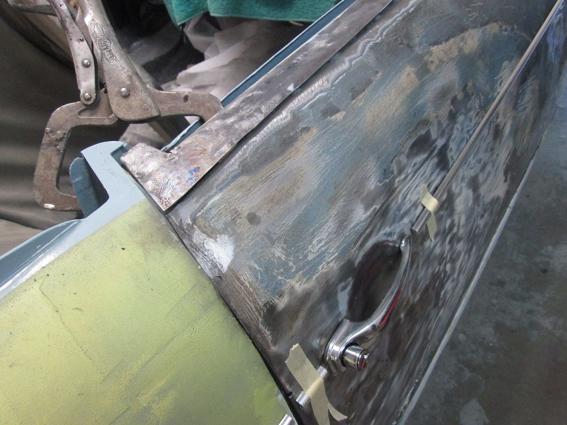

    Click image for larger version  Name:	IMG_5233.JPG Views:	0 Size:	174.7 KB ID:	108213 To preserve as much of the old skin as I could I decided on an angled cut which elmintated the higher rot and more of the old damage that was soldered over at the back.

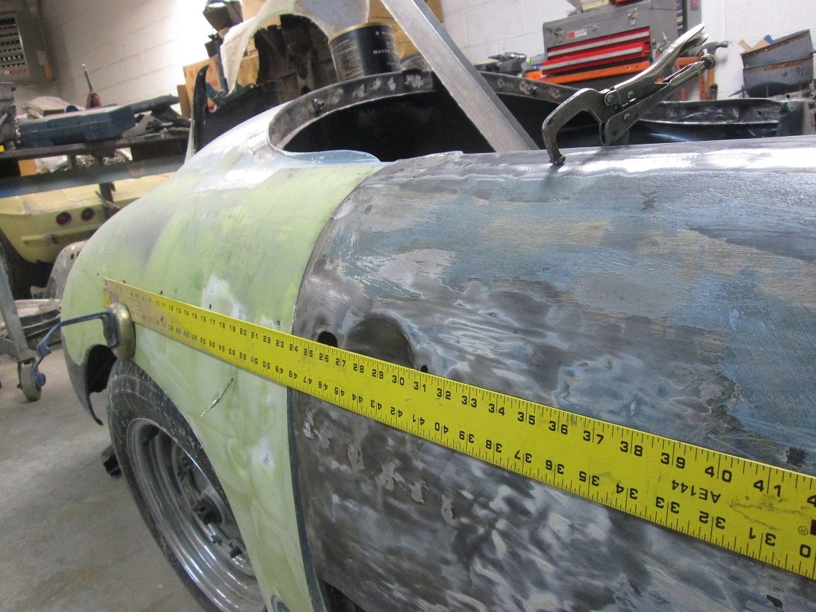

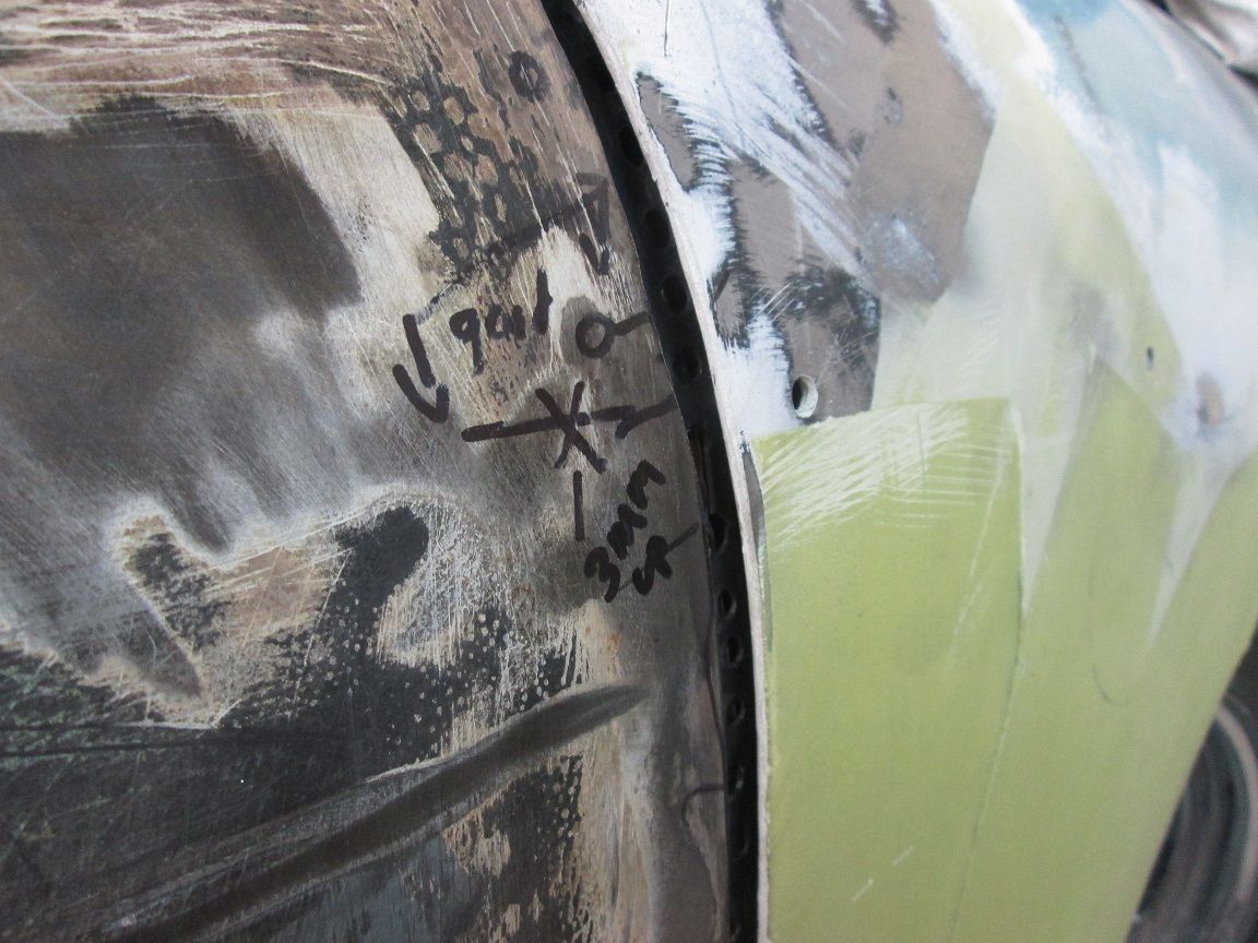

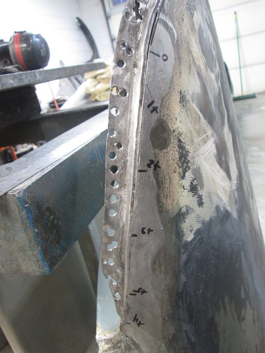

    Click image for larger version  Name:	IMG_5234.JPG Views:	0 Size:	165.9 KB ID:	108214 Going to fold in a quick flange and make my own lower repair section.

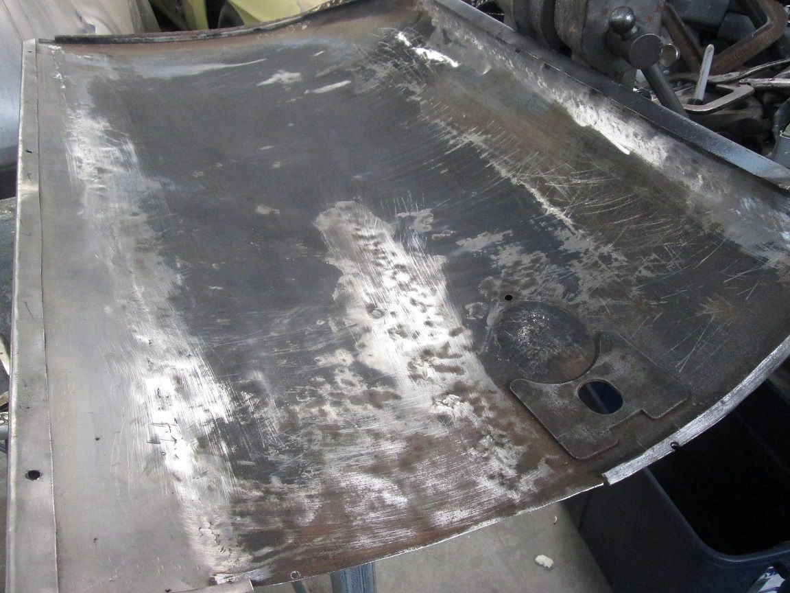

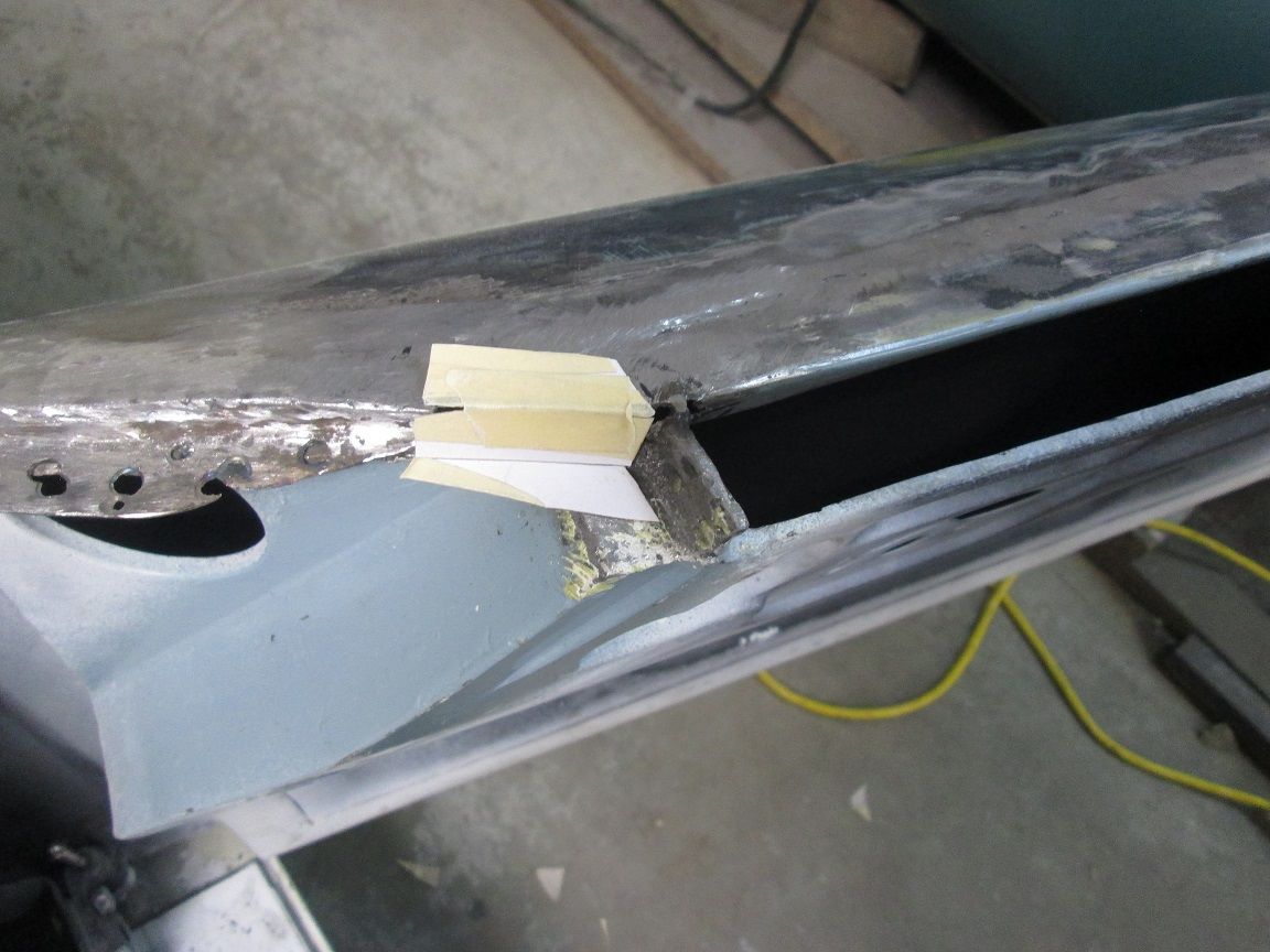

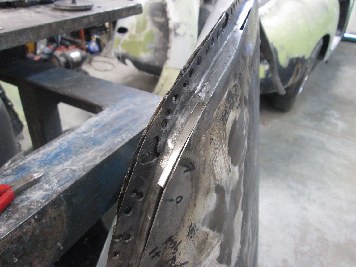

    Click image for larger version  Name:	IMG_5232.JPG Views:	0 Size:	128.7 KB ID:	108215 I do have a new one from Stodard but the flange is too narrow compared to how it was originally done so I'll replicate the factory width as I did before.

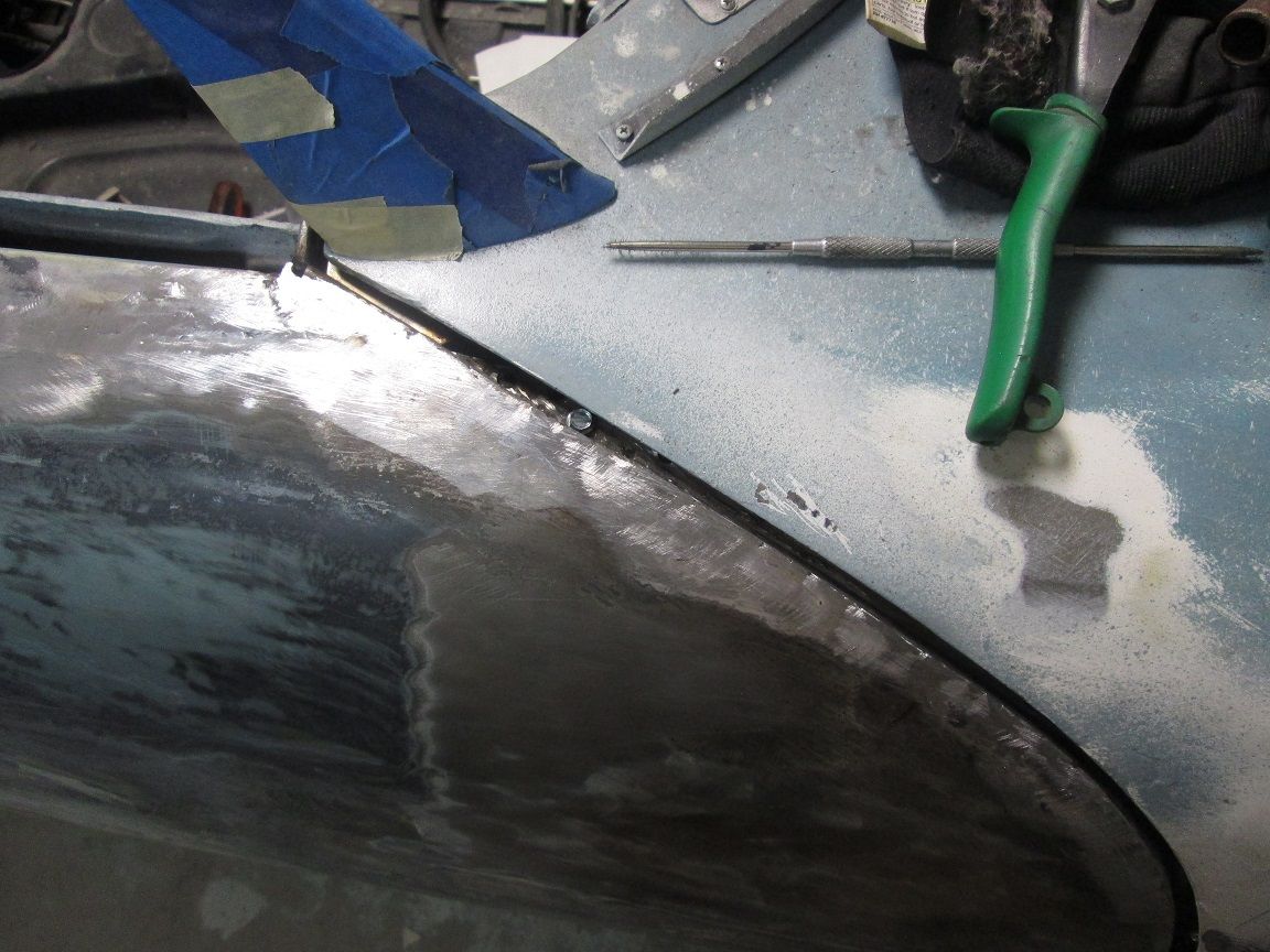

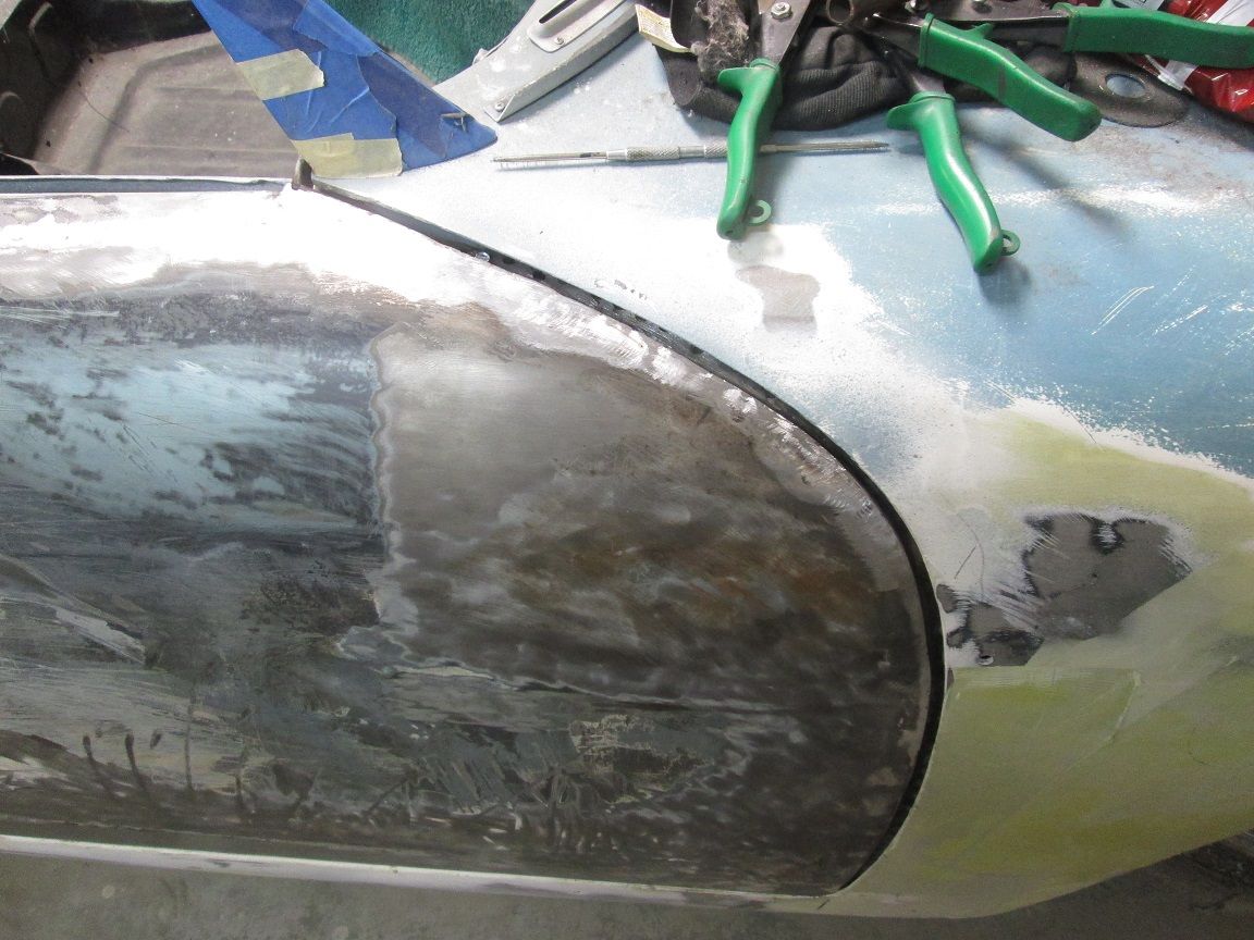

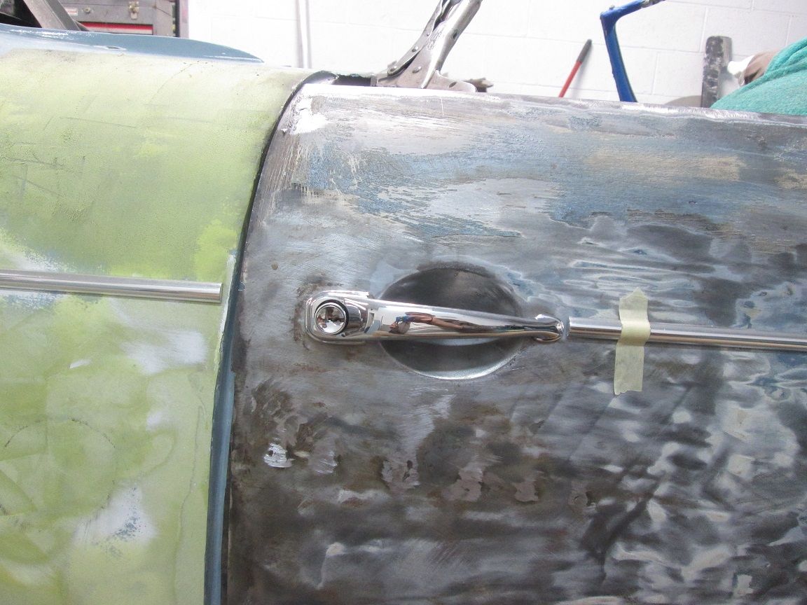

    Click image for larger version  Name:	IMG_5236.JPG Views:	0 Size:	176.4 KB ID:	108216 Bottom flange folded in an clampaed on for a quick mock up. A long way from making the final trim line as the rest of the skin has to mounted on the frame then to the car to locate its best adjusted position then I have dial in the 3mm gap with this new flange all simulatinously. A lot to do...

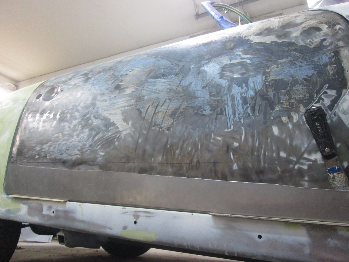

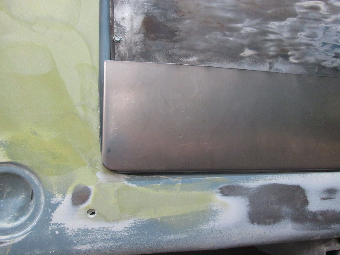

    • Skin trial fitment:
ID:	108222 Initial skin fitment to the frame then onto the car.
ID:	108223 Just a jumping off point. Lots of fine tuning and adjustment to go.

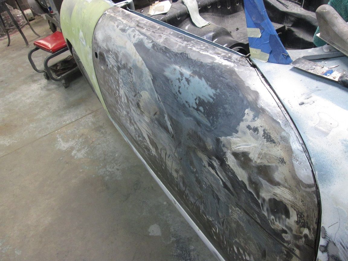

ID:	108224 This upper corner has to be lifted out into alignment so there is some needed changes to the flange.

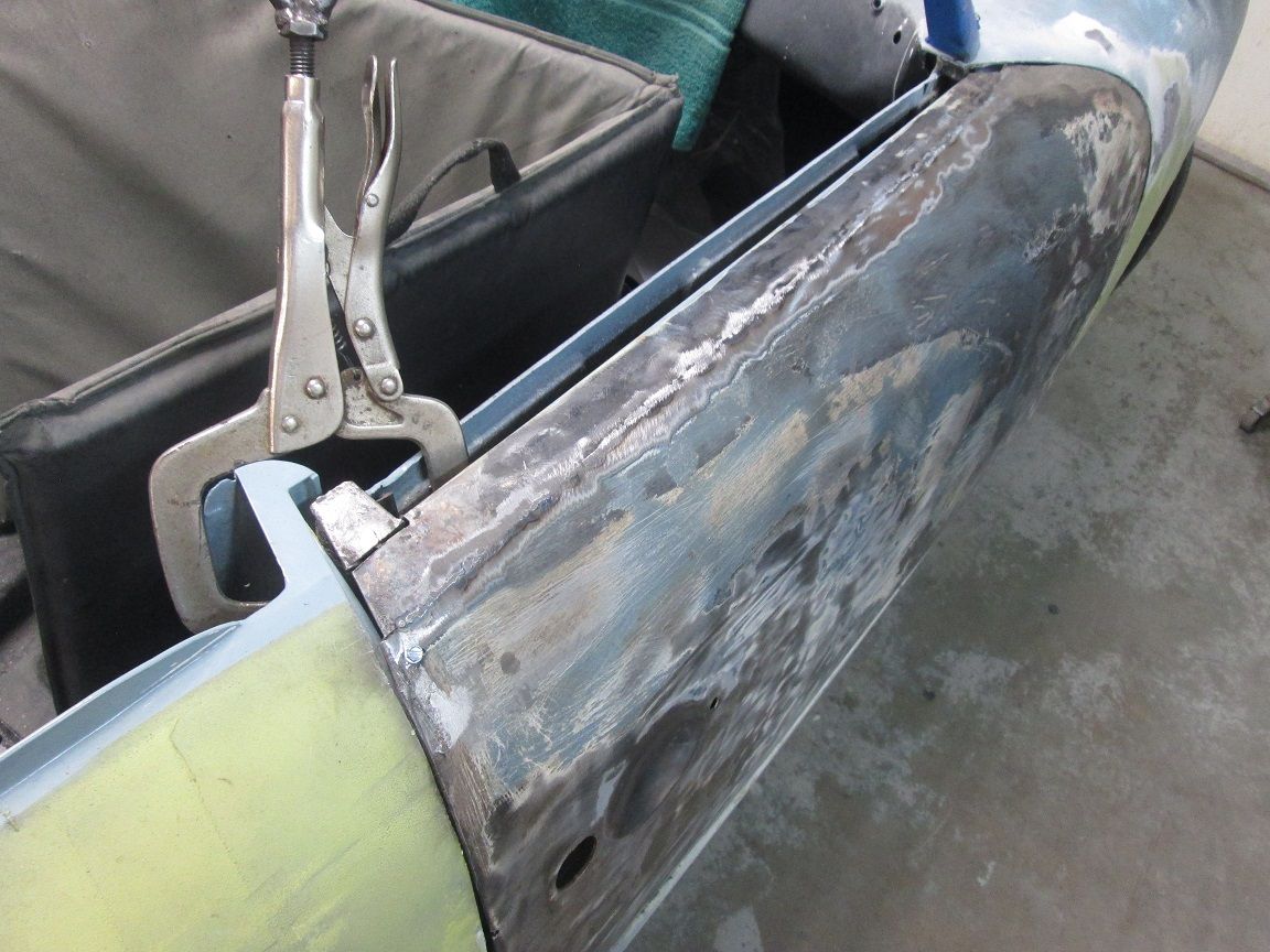

      • Skin cap:
        Click image for larger version  Name:	IMG_5266.JPG Views:	0 Size:	159.0 KB ID:	108229 Cap cut free from the old skin and dialing it in with the new skin.
        Click image for larger version  Name:	IMG_5287.JPG Views:	0 Size:	115.3 KB ID:	108230 The profile of the original has a nice sweeping profile where as the repop was basically flat in profile shape. You can see the filler I was having to use to try and achieve some of this profile after the fact. On a positive note that old factory skin will now be supplying this profile that was lacking.
        Click image for larger version  Name:	IMG_5288.JPG Views:	0 Size:	182.2 KB ID:	108231 Section clamped to my table to gradually bring in a little more of that needed profile shape.
        Click image for larger version  Name:	IMG_5303.JPG Views:	0 Size:	155.5 KB ID:	108232 Much better profile shape that carries on with this factory line. Cap is mocked up here with the door glass channels to ensure clearance and am just about ready to commit to the final cut line so I can tack these two together but I had to confirm one more thing before I made this leap.
        Click image for larger version  Name:	IMG_5291.JPG Views:	37 Size:	172.5 KB ID:	108234 The existing side spear holes are making the final adjustment with the skin on its new door frame all the more critical once again. Door handle hole has to come out centered with them so I had to make sure the skin was in its absolute best adjusted and final position before I could make my final cut line on that upper cap.

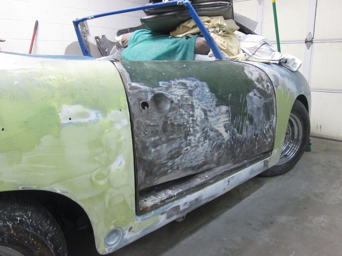

        • Side spear mock up:
          Click image for larger version  Name:	IMG_5295.JPG Views:	0 Size:	161.4 KB ID:	108248 My straight edge wasn't giving me an accurate enough picture of where the door handle actually was in relation to the spears so a full mock was needed.
          Click image for larger version  Name:	IMG_5294.JPG Views:	0 Size:	139.5 KB ID:	108249 Sure glad I did it because once the door handle went on it was clearly too low.
          Click image for larger version  Name:	IMG_5296.JPG Views:	0 Size:	151.7 KB ID:	108250 I could almost cheat it at the front but there was no faking it at the back.
          Click image for larger version  Name:	IMG_5297.JPG Views:	0 Size:	157.0 KB ID:	108251
          The skin had to come about 4MM's to center everything out.
          Click image for larger version  Name:	IMG_5298.JPG Views:	0 Size:	177.4 KB ID:	108252 Skin moved upward with handle now centered with the existing spear location. Now I'm ready to make my final cut line so I can begin tacking this cap on.

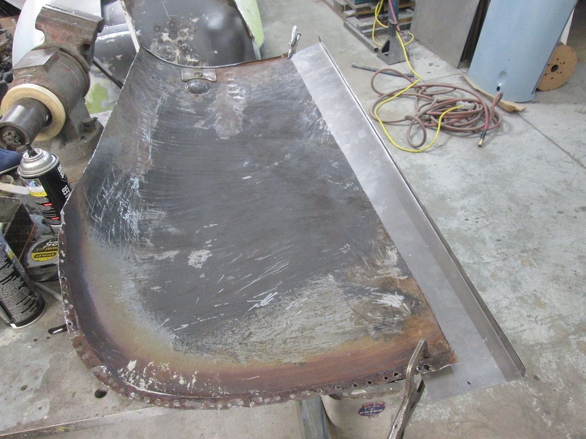

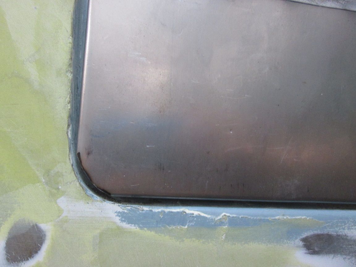

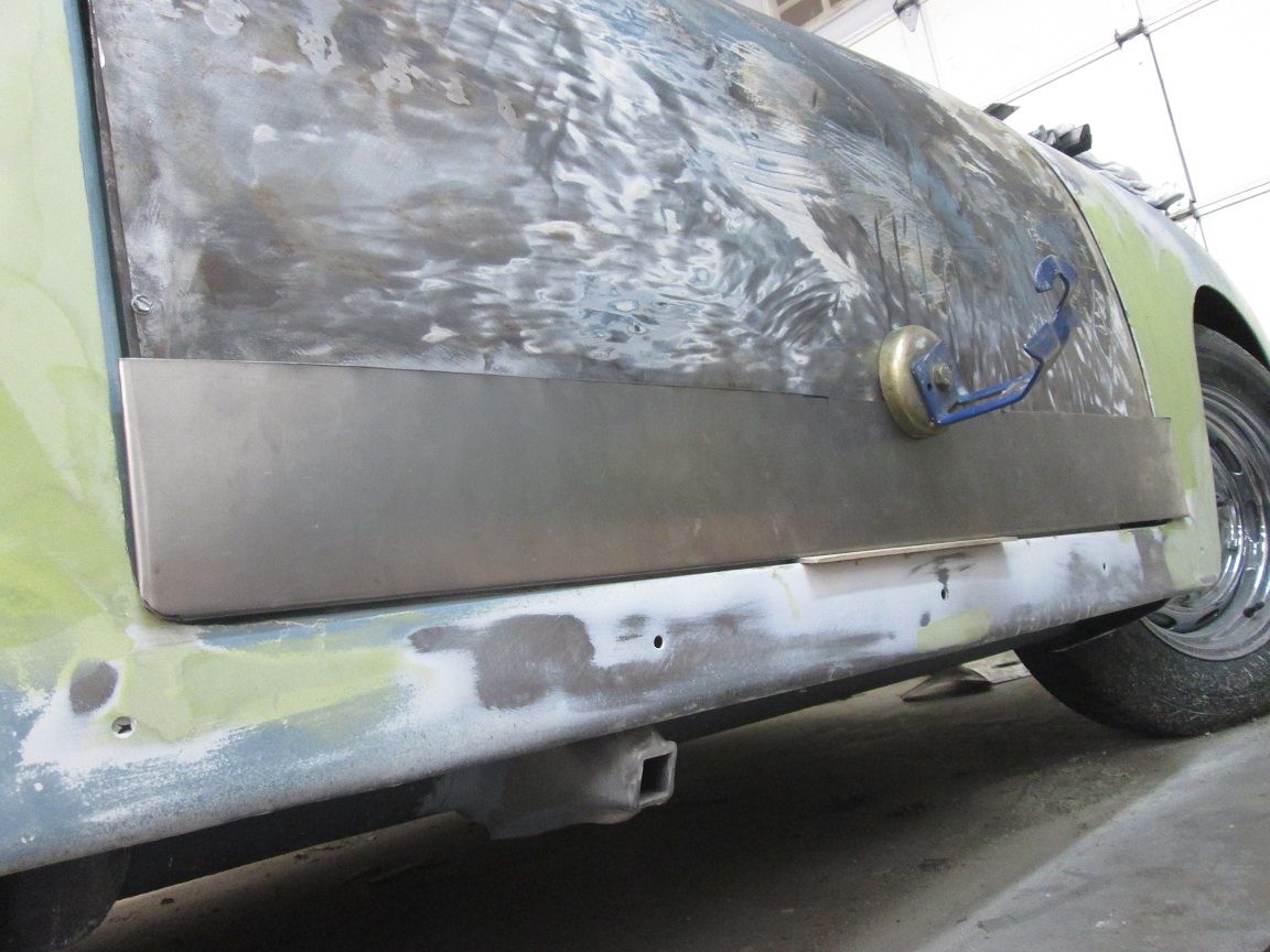

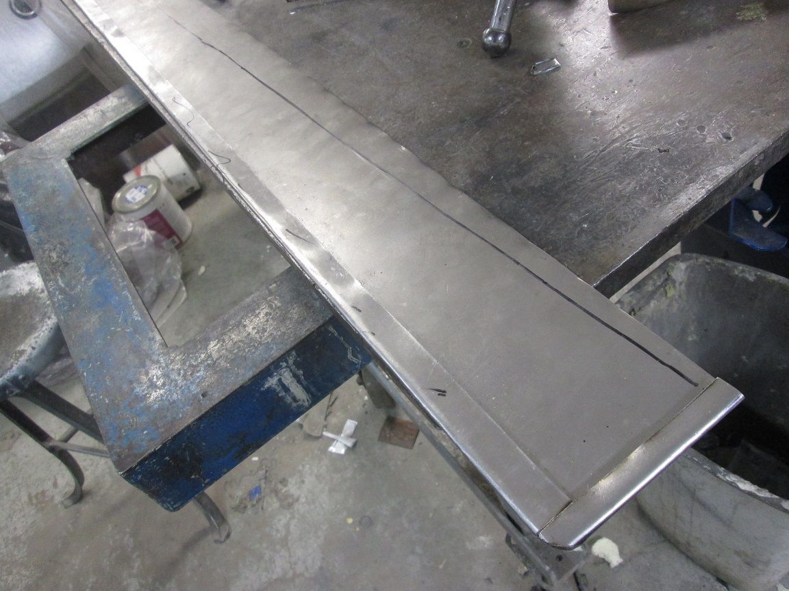

            • Lower repair section:
ID:	108264 Added the vertical flange and closed both of them up just enough to allow the frame to slide in for trial fitments.
ID:	108265 Always a crap shoot as to whether I'll get a clean edge line on a span this long without a proper bending brake but the gods where smiling on me this time around.
ID:	108266 Trial fitments to begin dialing it in for a 3mm gap.
ID:	108267 Profile shaping the corner to the body for a uniform gap all the while allowing it to slide back enough to get the vertical gap close.
ID:	108268 Getting close but the panel still needs to come back a touch more.
              • Click image for larger version  Name:	IMG_5333.JPG Views:	0 Size:	100.4 KB ID:	108270 Once its mounted to the frame for the final time I'll run a bead over this opening.
                Click image for larger version  Name:	IMG_5347.JPG Views:	0 Size:	128.2 KB ID:	108271 Gaps and corner profile all set here with everything mocked up once again to finalize my trim line. As you can see I still need to rebuild the edge of skin above this section but it will be one of my last repairs once the door is reassembled for the final time.
                Click image for larger version  Name:	IMG_5348.JPG Views:	0 Size:	138.8 KB ID:	108272 Have my paints sticks in position for that 3mm gap and am now ready to lock in this position with some set screws.
                Click image for larger version  Name:	IMG_5349.JPG Views:	0 Size:	122.5 KB ID:	108273 Set screwed into final position.
                Click image for larger version  Name:	IMG_5350.JPG Views:	0 Size:	138.1 KB ID:	108274 Door will be disassembled again so I can etch my cut line from behind so the excess can be removed from the repair section side. This next... Thanks for looking!

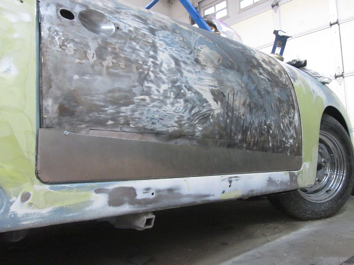

                • Lower repair section installed:
                  Click image for larger version  Name:	IMG_5351.JPG Views:	0 Size:	171.5 KB ID:	108286 ready to etch in my final cut line...commitment time once again.
                  Click image for larger version  Name:	IMG_5354.JPG Views:	0 Size:	156.0 KB ID:	108287 Final trim complete. Skin and lower section clamped to the table and tack welding from the center outward.
                  Click image for larger version  Name:	IMG_5355.JPG Views:	0 Size:	168.5 KB ID:	108288
                  Entire run tacked but not ready to fully weld it up yet. I'm going to reassemble the door (again) and make doubly sure nothing changed on me like the lower gap.
                  Click image for larger version  Name:	IMG_5359.JPG Views:	0 Size:	129.4 KB ID:	108289 Door reassembled (again) and test fitted to the car. So far so good, the lower gap runs a touch wider than 3mm's at the moment but once I squeeze that lower flange tight at the end its going to get a little longer which should come out just about right. Again, so much tougher and trickier building a closing panel to fit the car versus building the car around a finished closing panel.
                  Click image for larger version  Name:	IMG_5361.JPG Views:	0 Size:	111.7 KB ID:	108290 General contour and shape shows lots of promise with the rest of the car. We'll see what happens after all the welding is done. Door coming off and back apart (again) to finish welding up this looong joint.

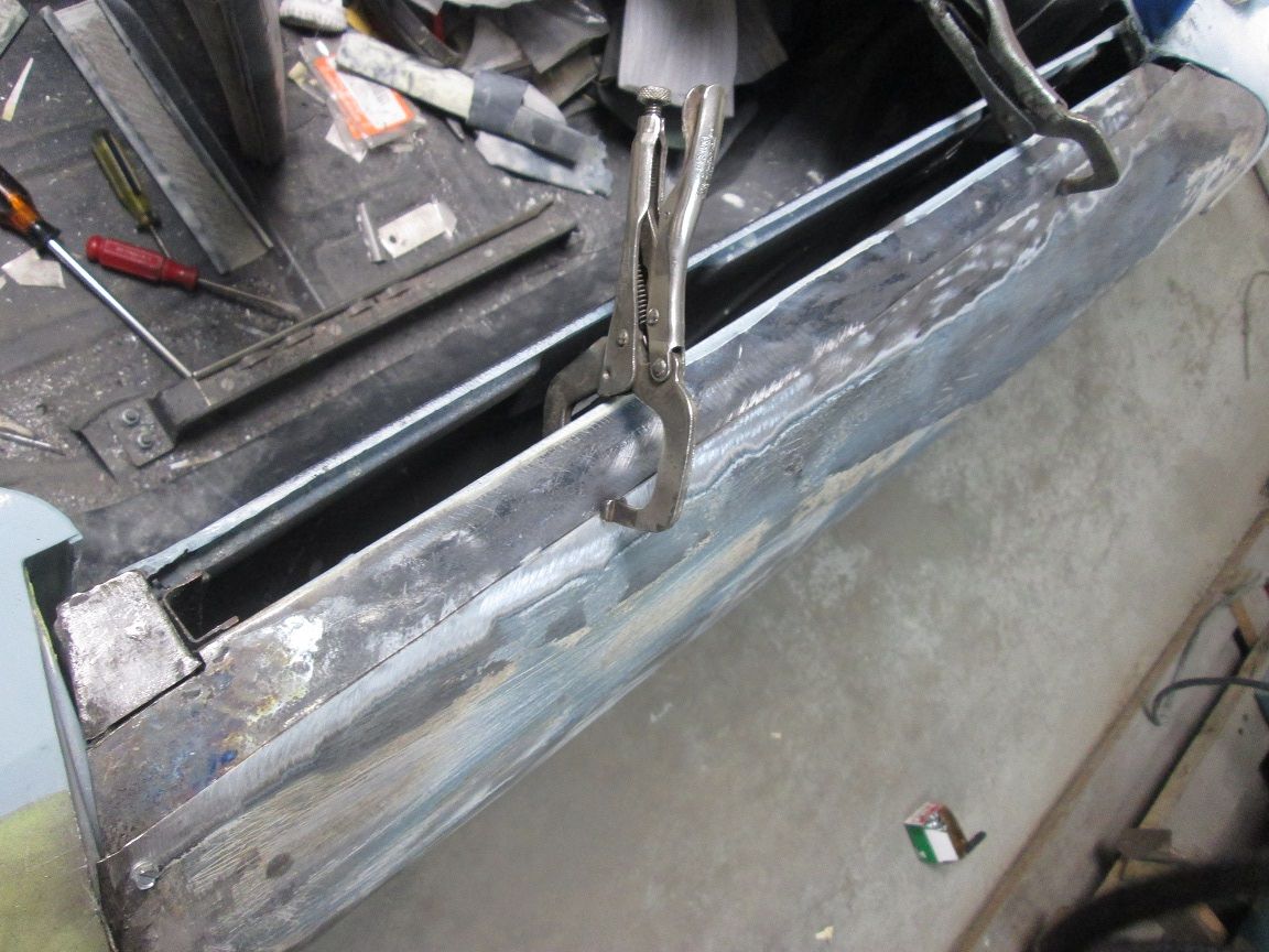

                  • Right door final assembly.
                    Click image for larger version  Name:	IMG_5366.JPG Views:	0 Size:	178.5 KB ID:	108295 Lower weld run complete and am just about done finish grinding the joint.
                    Click image for larger version  Name:	IMG_5368.JPG Views:	0 Size:	176.6 KB ID:	108296 Both upper and lower joints fully finished
                    Click image for larger version  Name:	IMG_5369.JPG Views:	0 Size:	150.5 KB ID:	108297 Very long runs to both weld and dress; glad to have these behind me. Now onto cleaning up the remaining surface rust for some epoxy sealer and a top coat of black.
                    Click image for larger version  Name:	IMG_5370.JPG Views:	0 Size:	142.2 KB ID:	108298 Both inner surfaces prepped and now behind a top coat. At long last this door is finally ready to go back together for the last time.
                    Click image for larger version  Name:	IMG_5371.JPG Views:	0 Size:	118.8 KB ID:	108299
                    Quick look inside of what this newly assembled door will look like. No obvious weld joint is what I was after. Onto rebuilding the front and rear edges now.

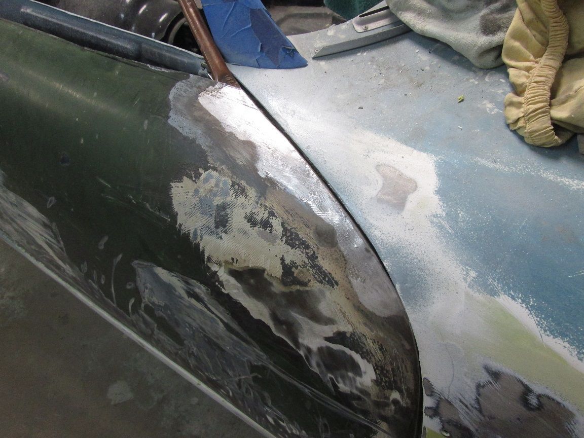

                    • Front leading edge work:
                      Click image for larger version  Name:	IMG_5375.JPG Views:	0 Size:	165.6 KB ID:	108310 Cut the upper leading edge free allowing me to move it back to create a gap. Have a little more material yet to remove.
                      Click image for larger version  Name:	IMG_5376.JPG Views:	0 Size:	171.8 KB ID:	108311 Fortunately I don't have to adjust the entire leading edge. Only have to go just past the turn there.
                      Click image for larger version  Name:	IMG_5384.JPG Views:	0 Size:	148.8 KB ID:	108312
                      Charted out in MM's as to where and how far back it needed to go to achieve a nice raw gap that will only need minimal amounts of solder for a final gap.
                      Click image for larger version  Name:	IMG_5385.JPG Views:	0 Size:	154.7 KB ID:	108313 Wasn't just dealing with the gap width but also some height discrepancies right at the side spears. I tried a shim but it threw the rest of the door out before this area got even close. Not only do I want to keep the fillers here thin but I have to as the forward mounting clip won't reach deep enough to engage if the solder is too thick.
                      Click image for larger version  Name:	IMG_5403.JPG Views:	0 Size:	131.9 KB ID:	108314 Adding in my filler strips to raise that center profile and also locking in my final gap position on this leading edge.

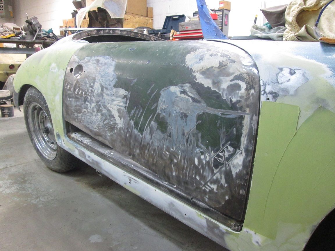

                      • Front leading edge reshape complete:
ID:	108333 Paper template to backfill the big holes.
ID:	108334 New section welded in along with the rest of the run giving my raw gap that is now ready for some solder to take it the rest of the way.
ID:	108335 Here is about all the solder that's going to be required to create a 3mm gap.
ID:	108336 Entire forward edge is now set. Dismounting the door next so I can begin final welding along its inner flange.
ID:	108337 Started at the bottom. Welded up the corner to create the final shape that will be steel.
