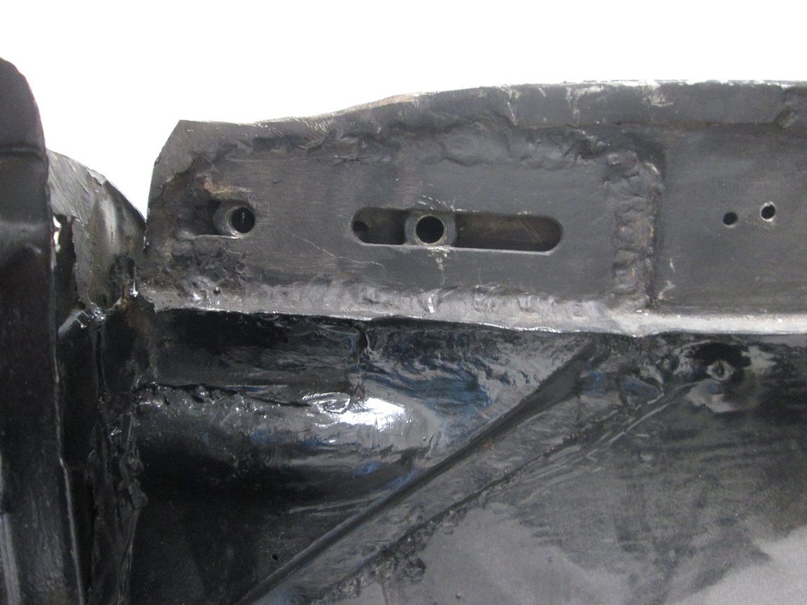

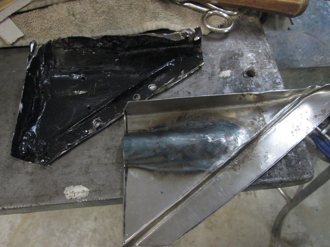

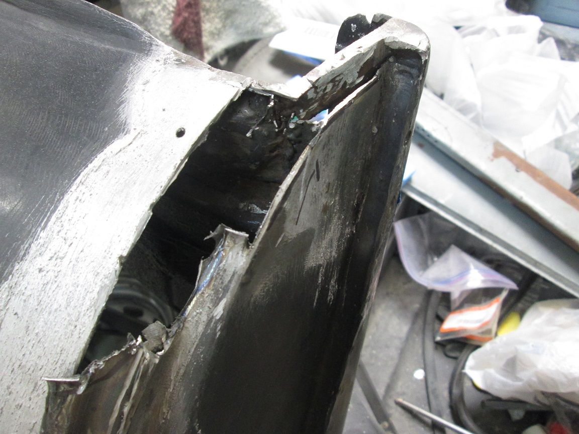

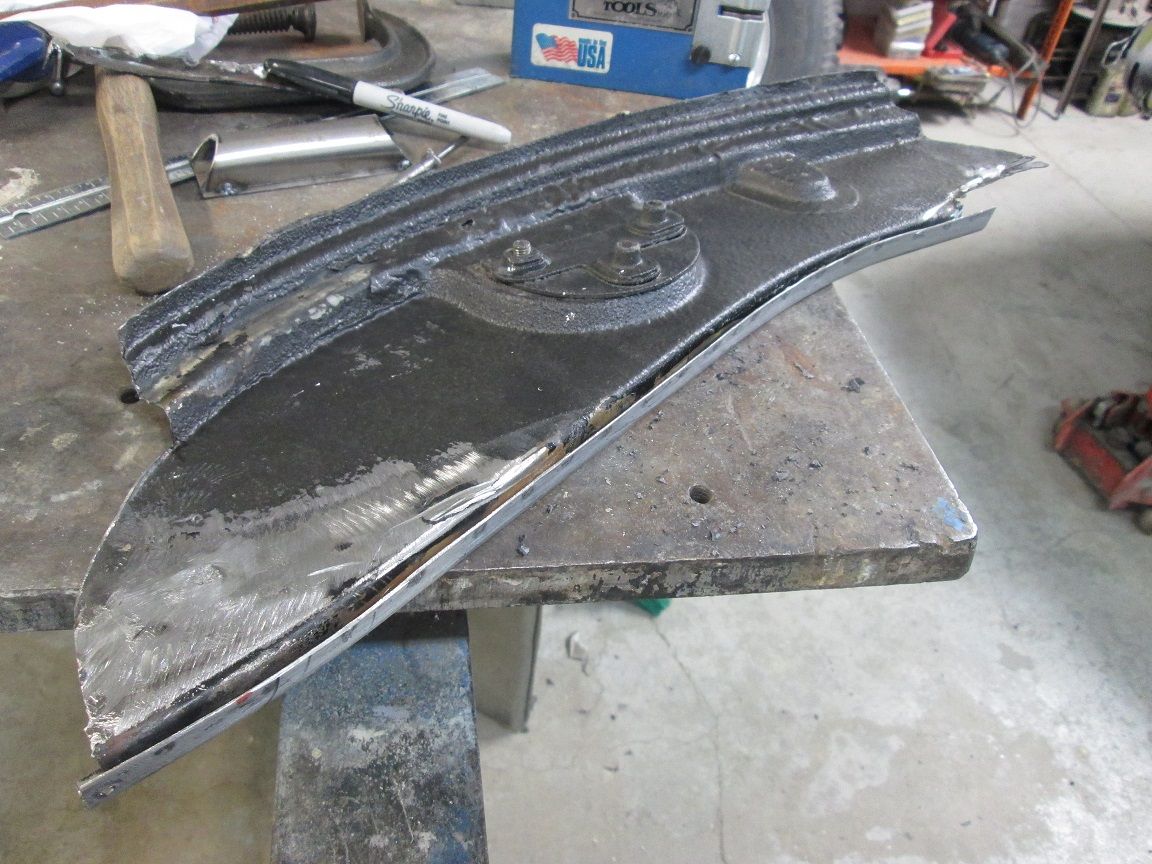

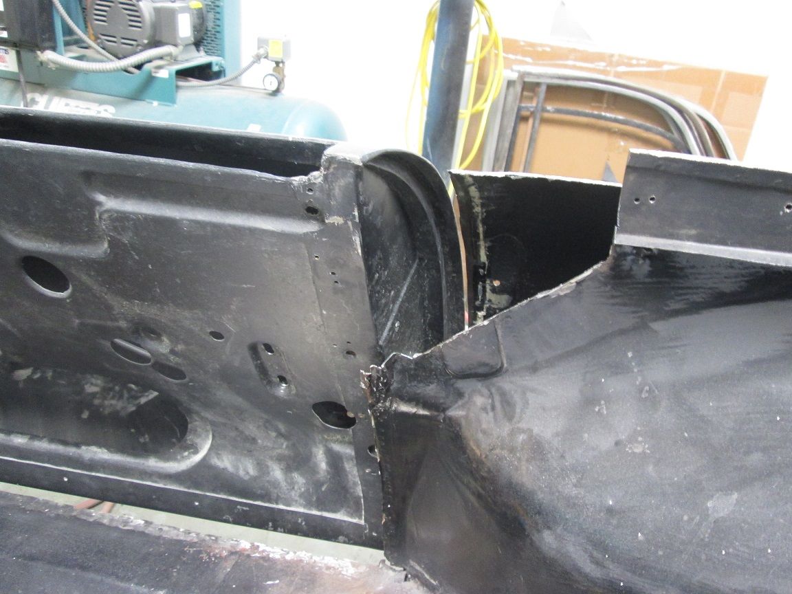

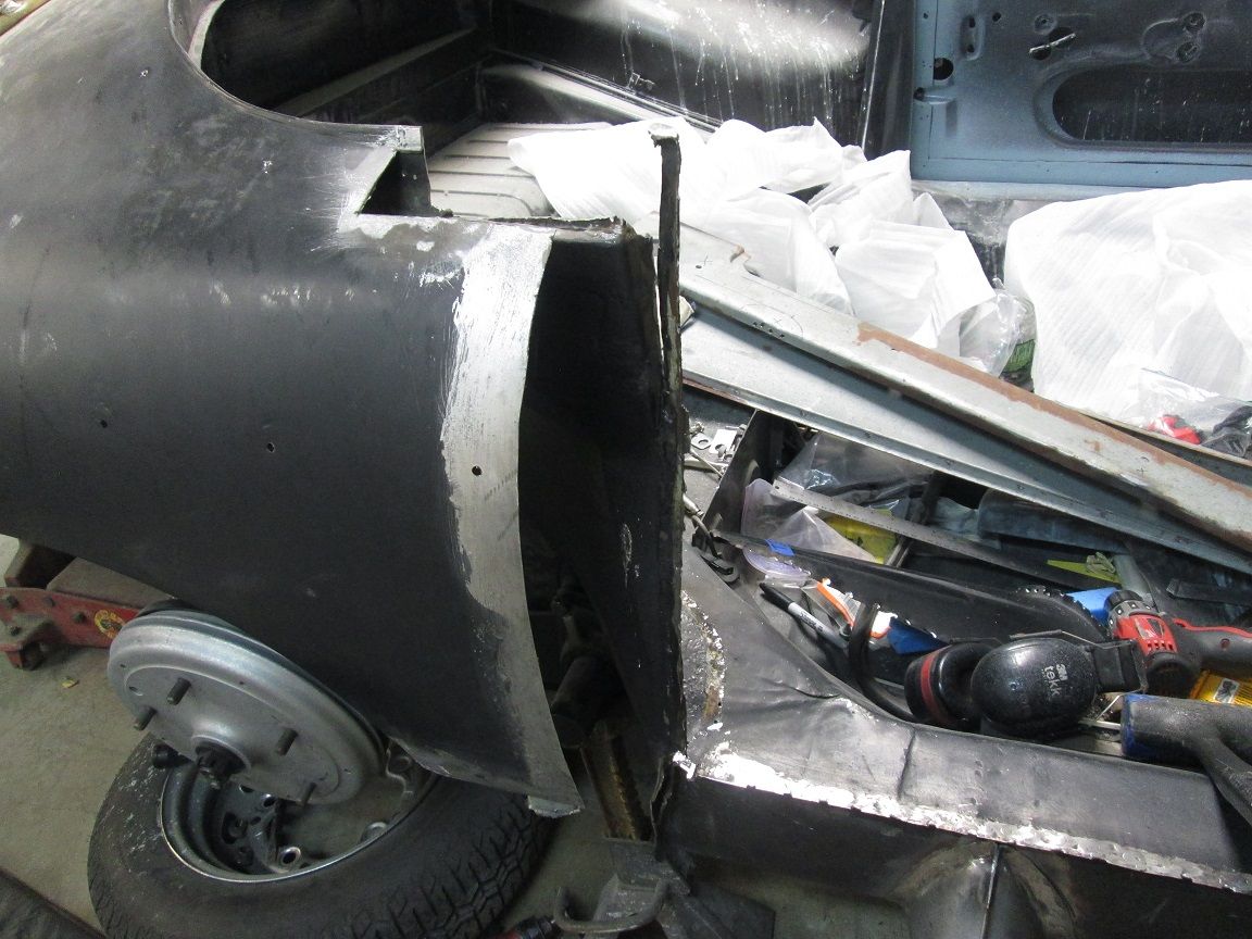

  • My new can of worms:

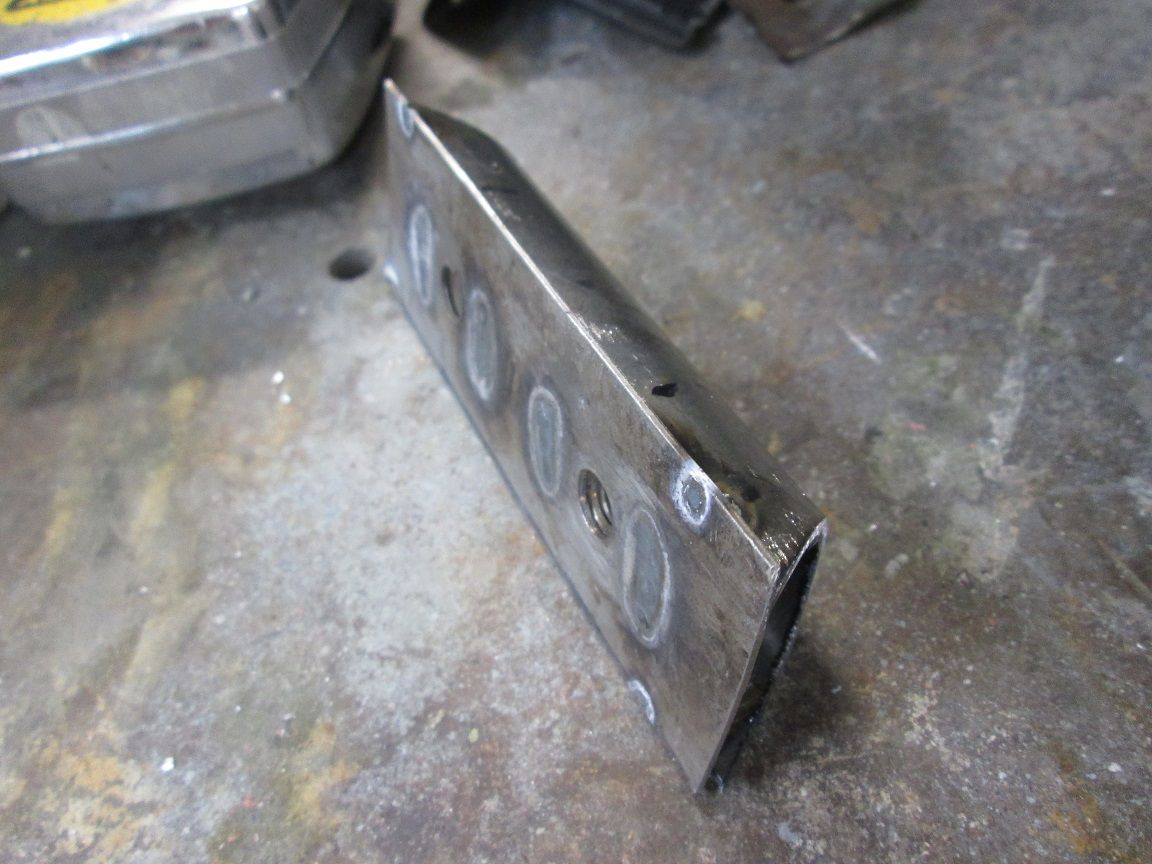

    Click image for larger version  Name:	IMG_4194.JPG Views:	0 Size:	141.4 KB ID:	107359 New profile relief shape coming.

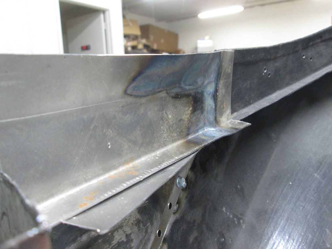

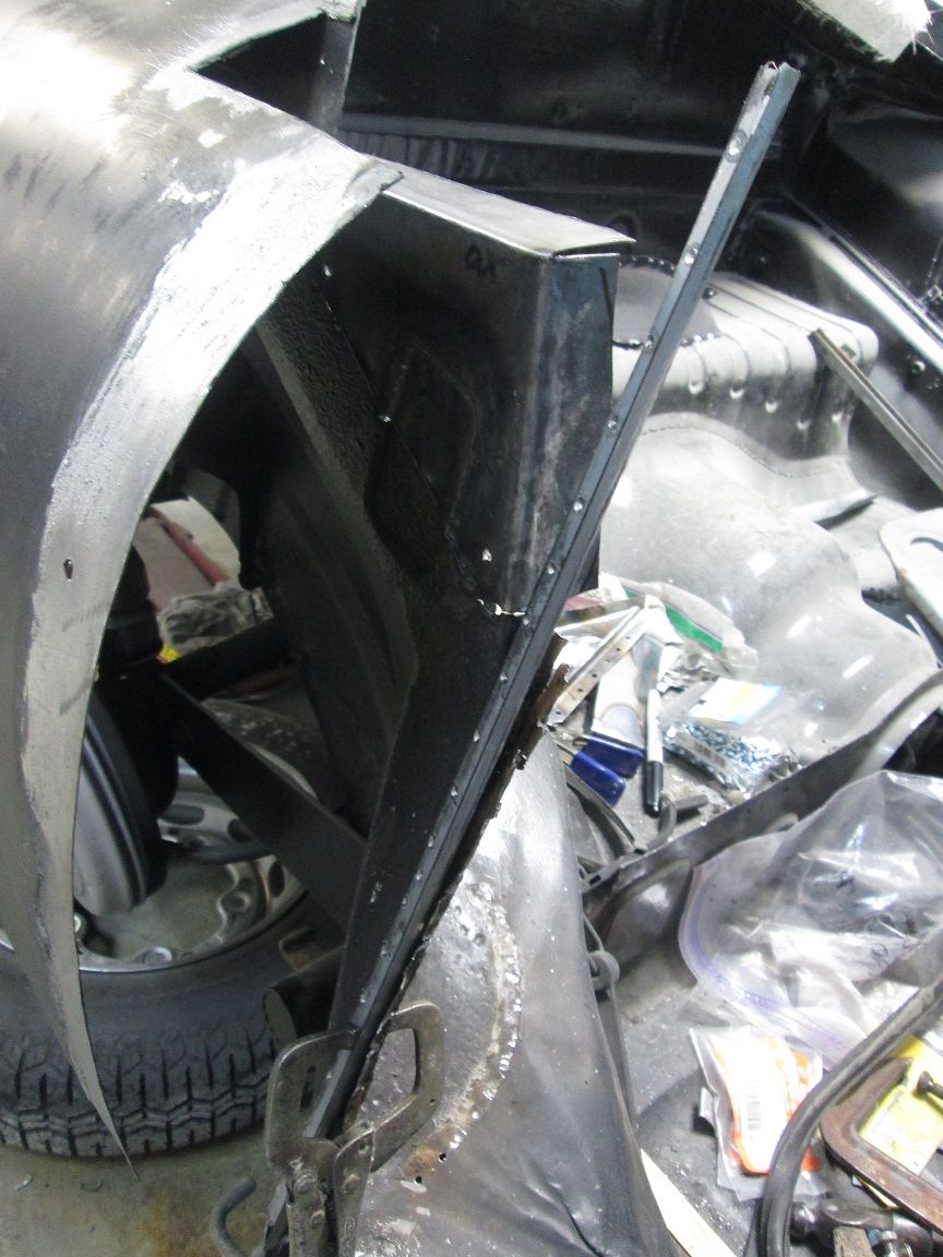

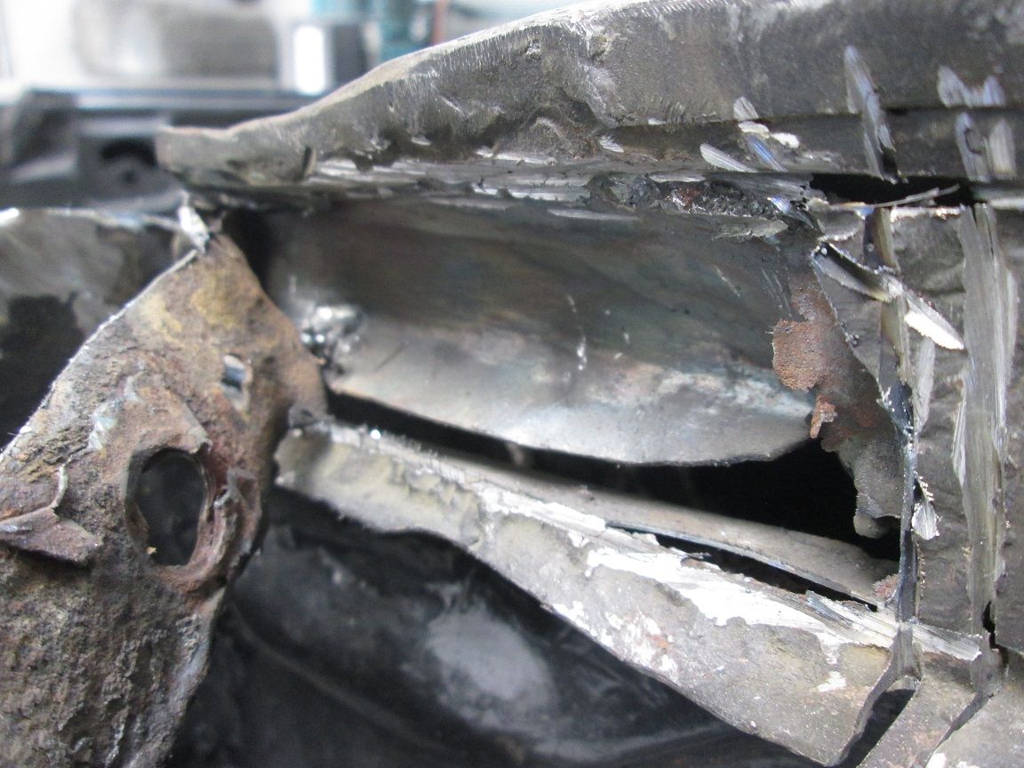

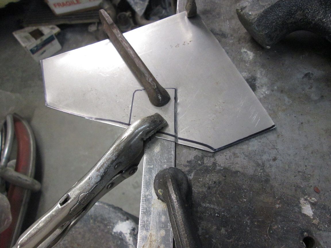

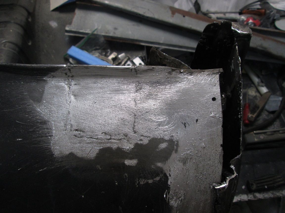

    Click image for larger version  Name:	IMG_4196.JPG Views:	0 Size:	144.3 KB ID:	107360 As the fitting continued I had to cut a window in the body skin to allow me more room to work. Same as with the left side.

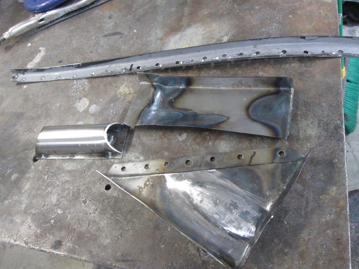

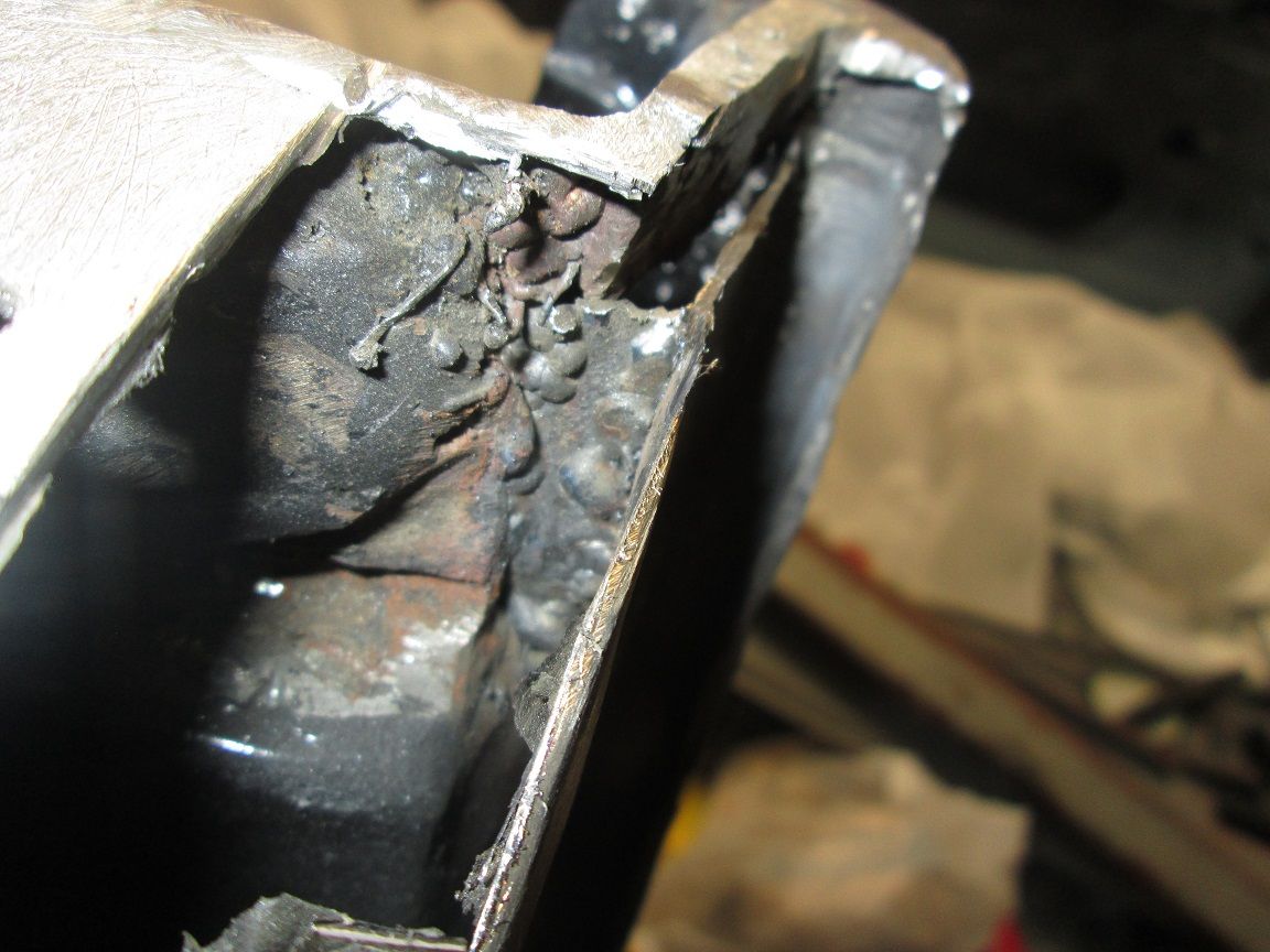

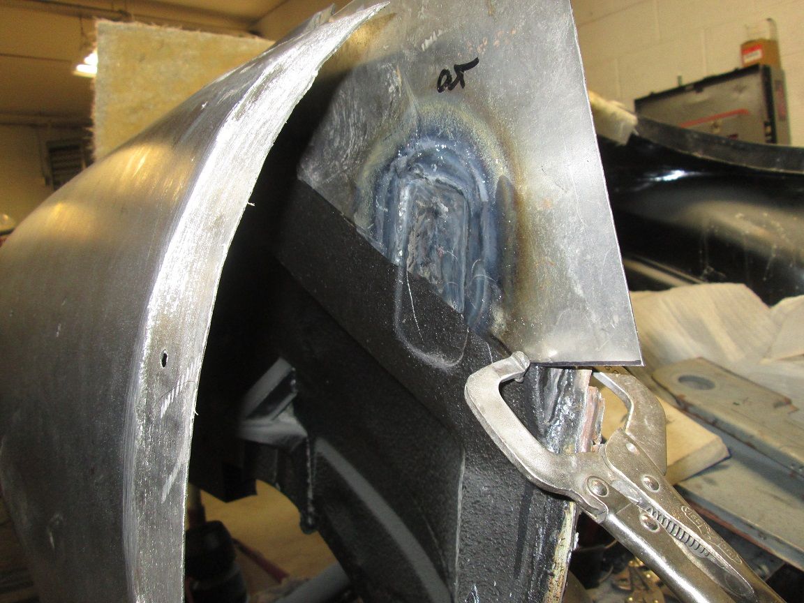

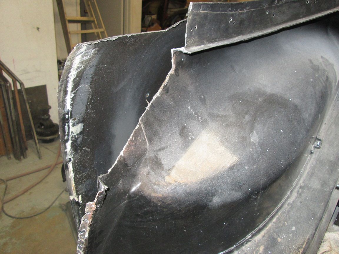

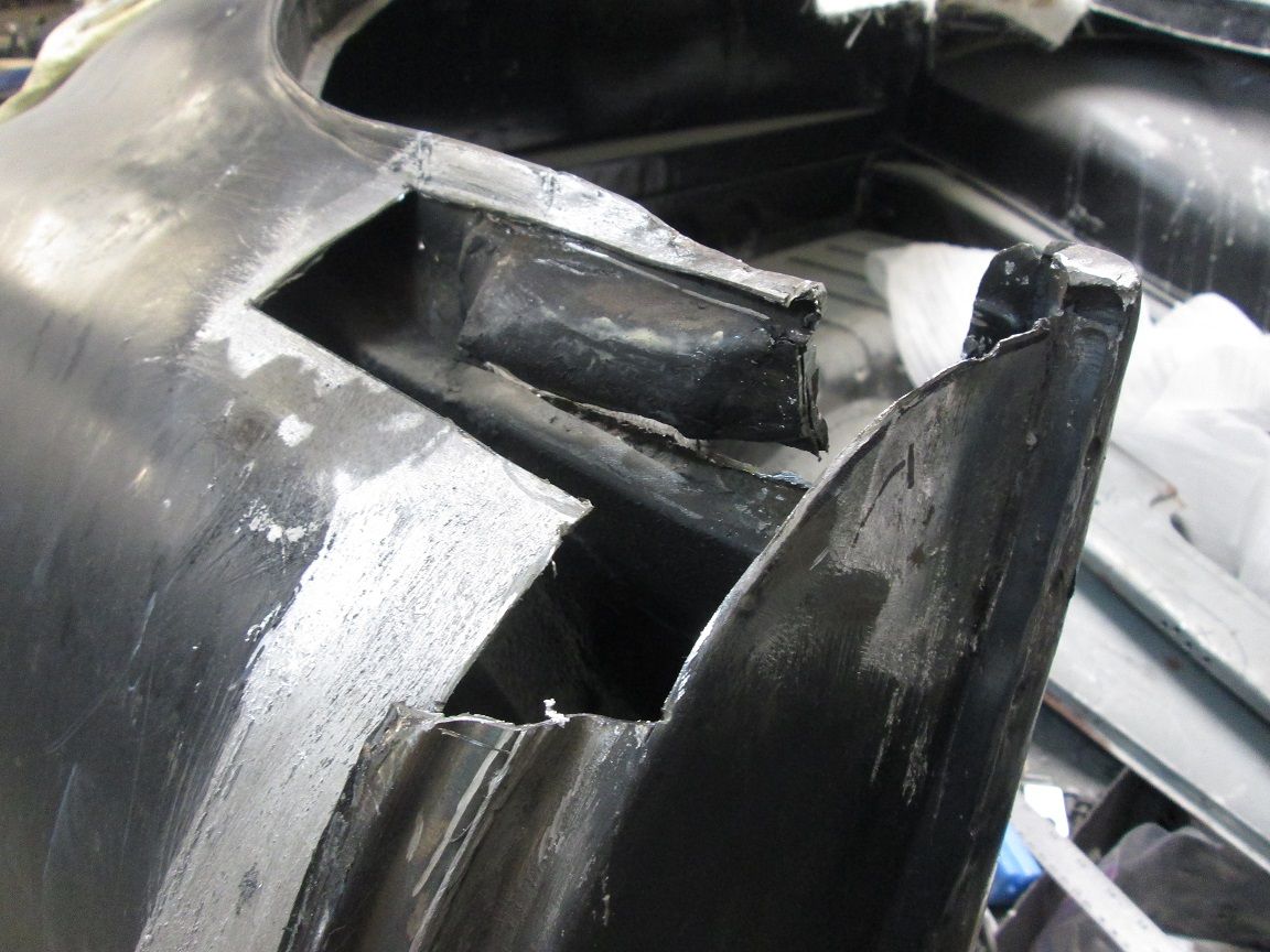

    Click image for larger version  Name:	IMG_4193.JPG Views:	0 Size:	143.0 KB ID:	107361 This window was now exposing some very scaly weld and patch work done to the back side of the top frame mount by the previous shop.

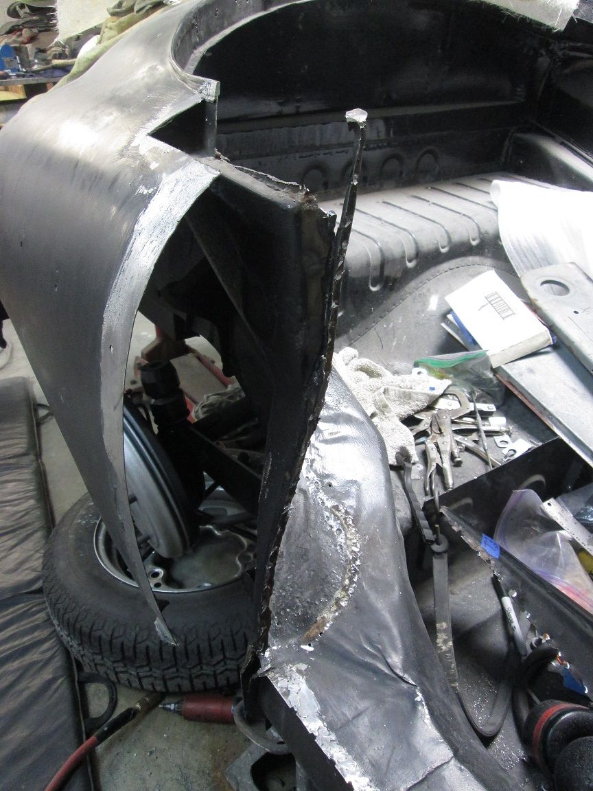

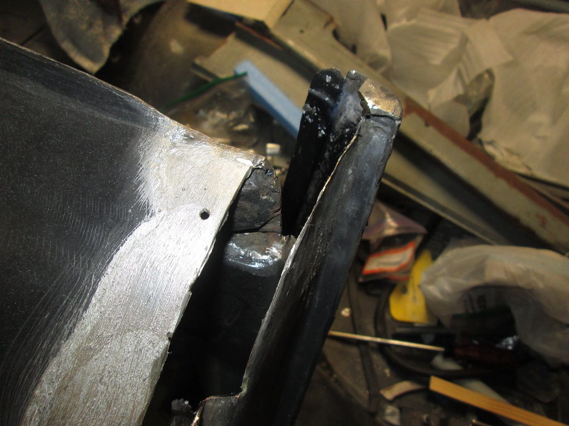

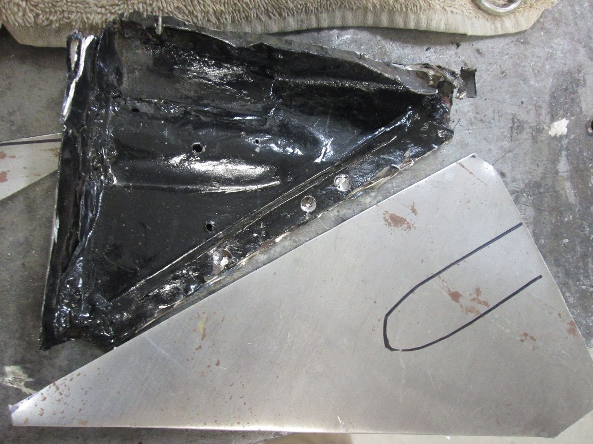

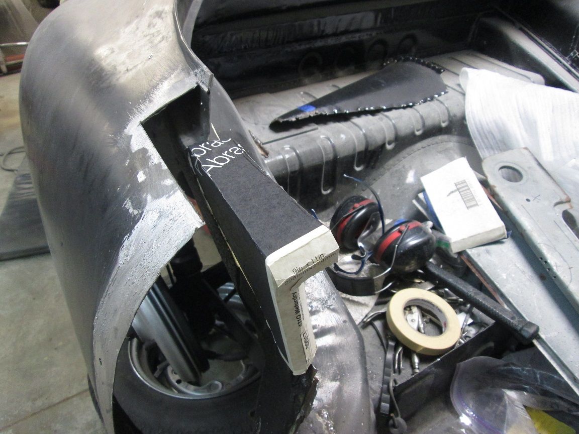

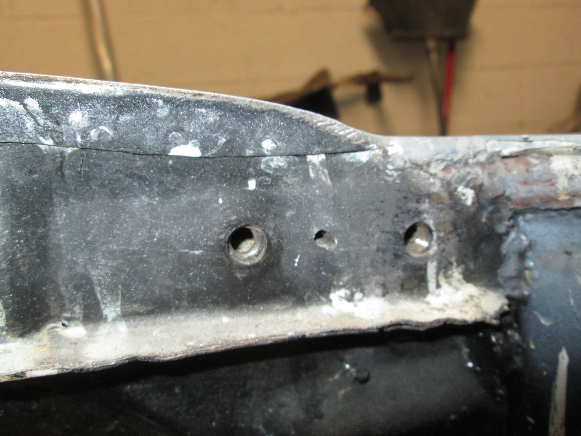

    Click image for larger version  Name:	IMG_4192.JPG Views:	0 Size:	125.3 KB ID:	107362 jumbled mess of partial patches and weld blob.

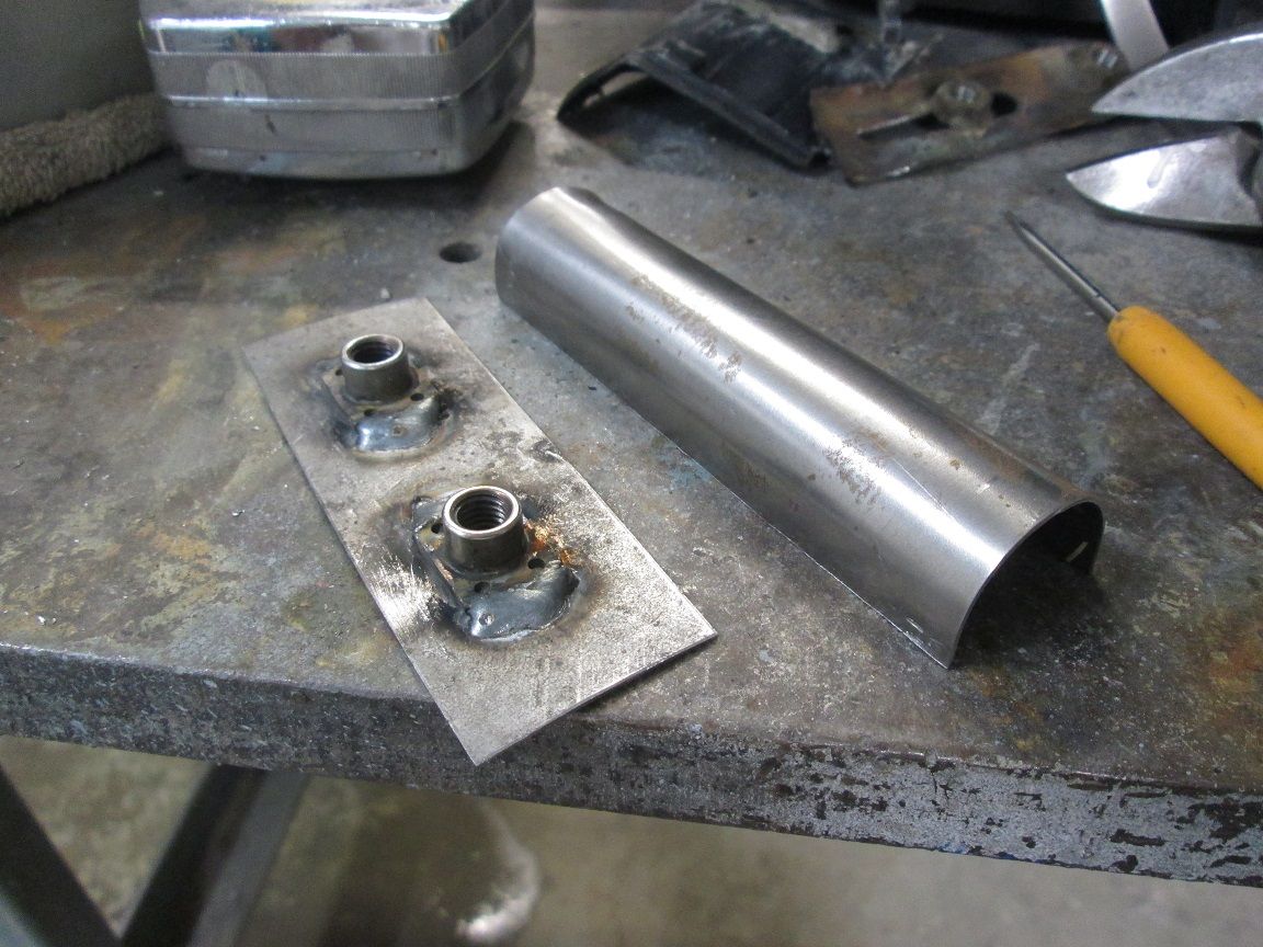

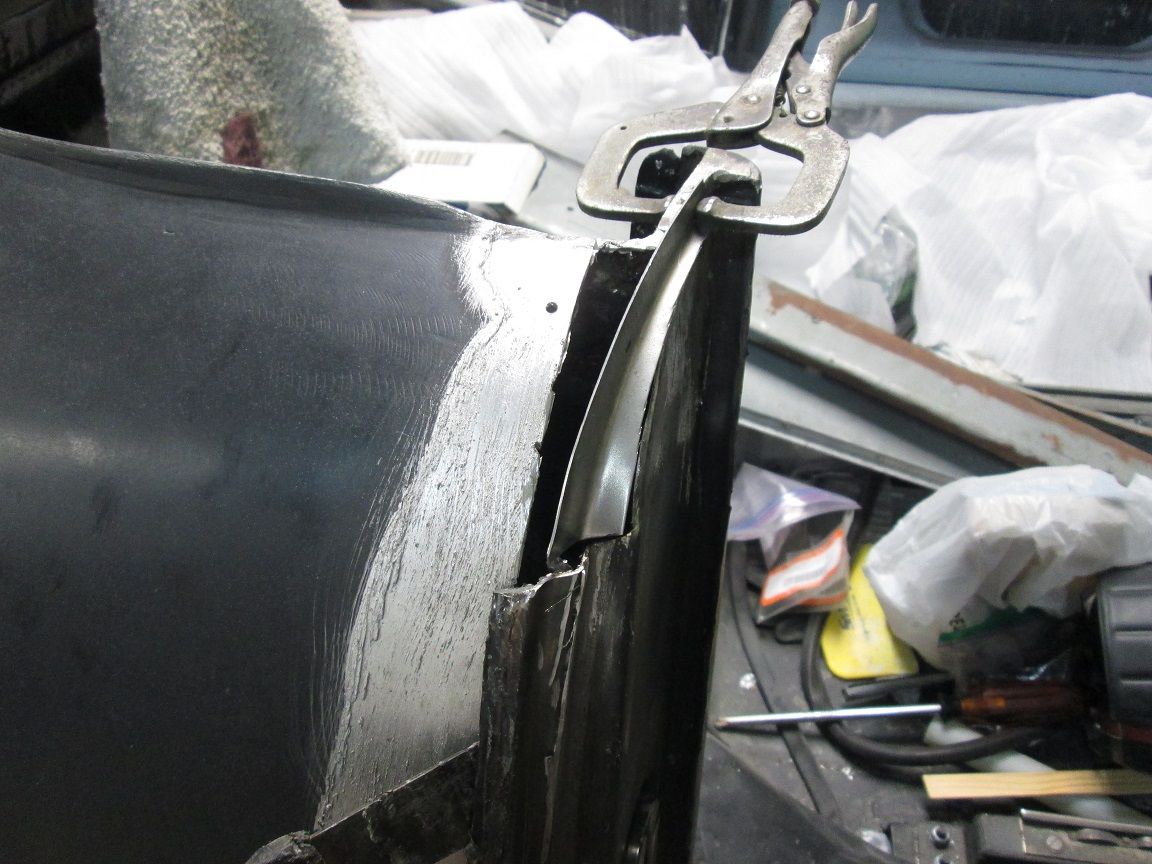

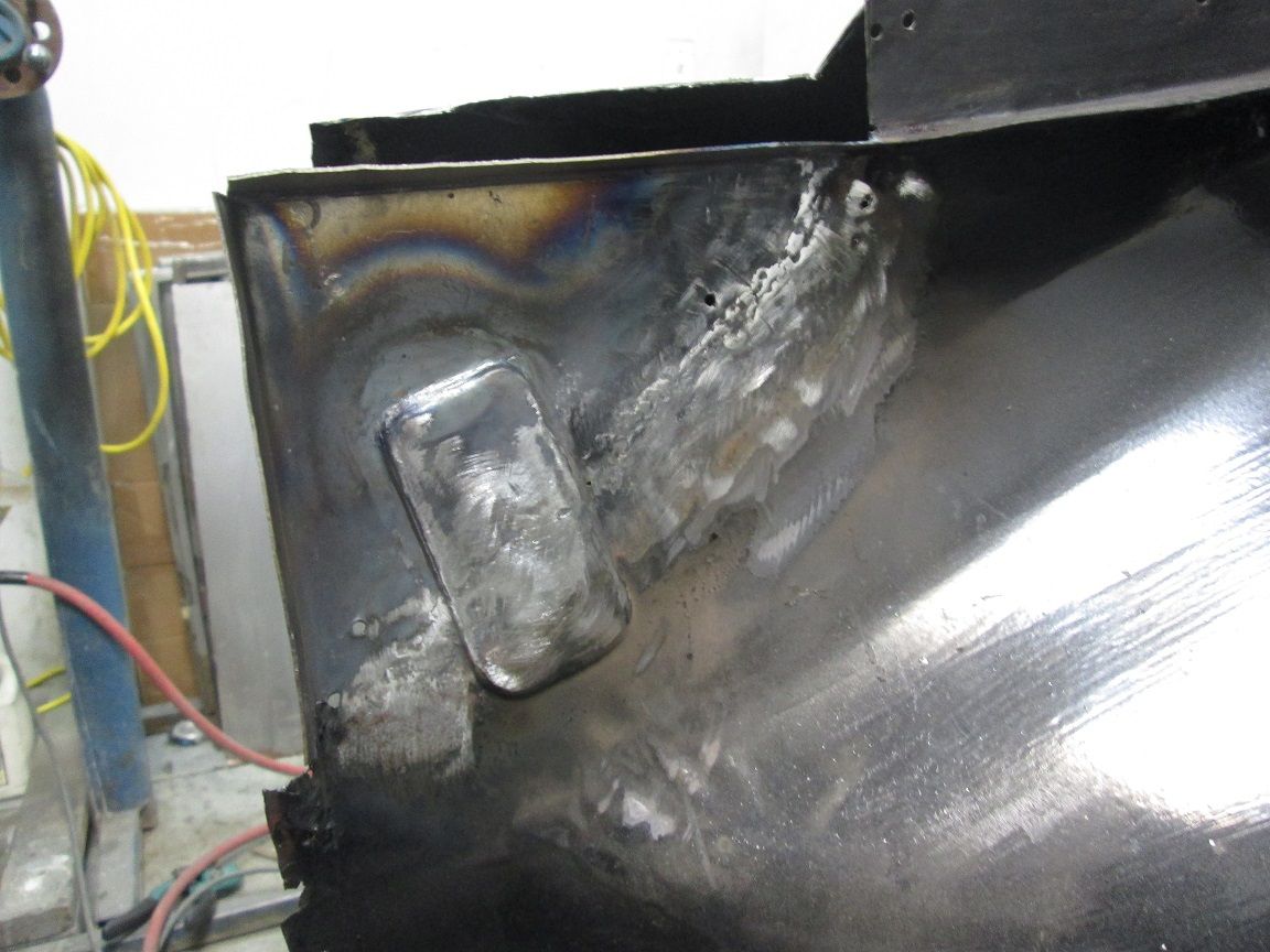

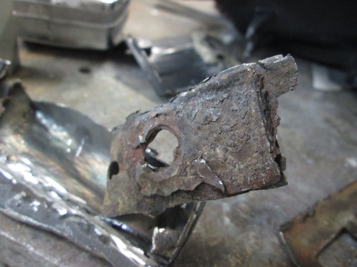

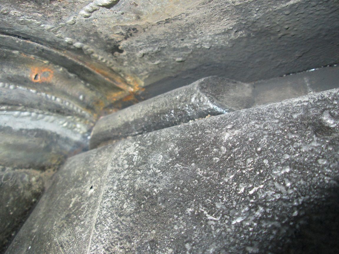

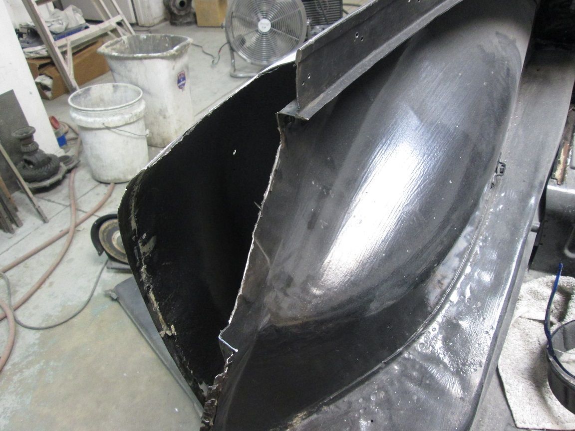

    Click image for larger version  Name:	IMG_4203.JPG Views:	0 Size:	154.4 KB ID:	107363 Could not bring myself to build on top of that so I ended up cutting past it.

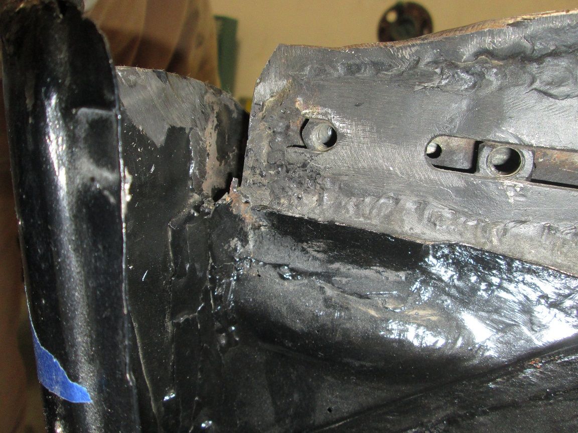

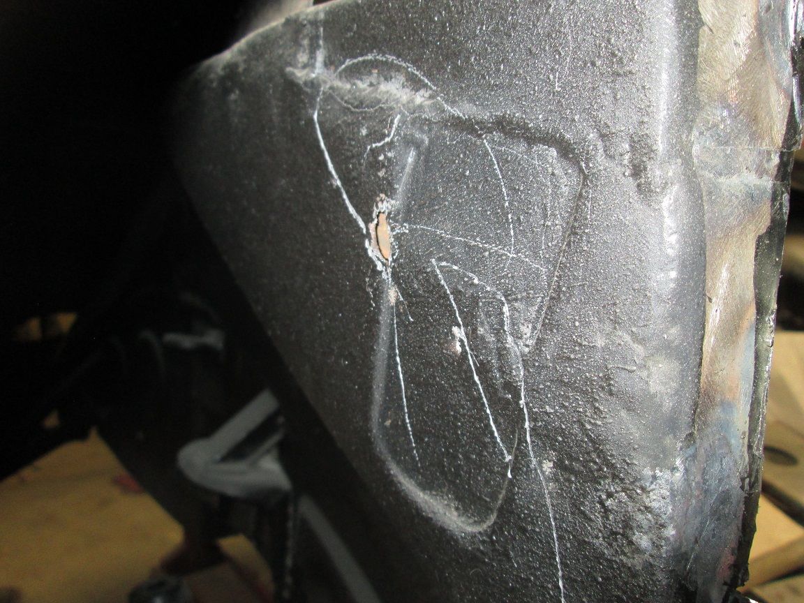

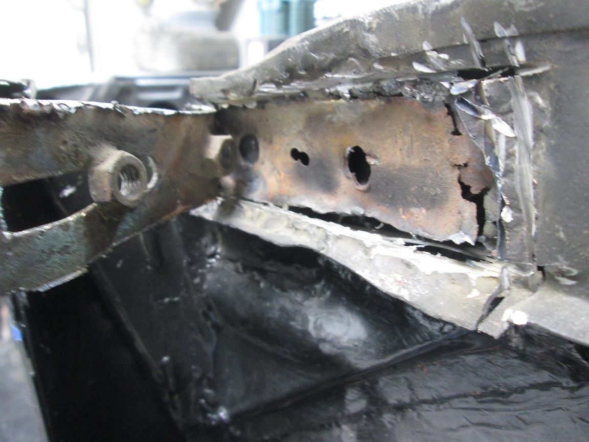

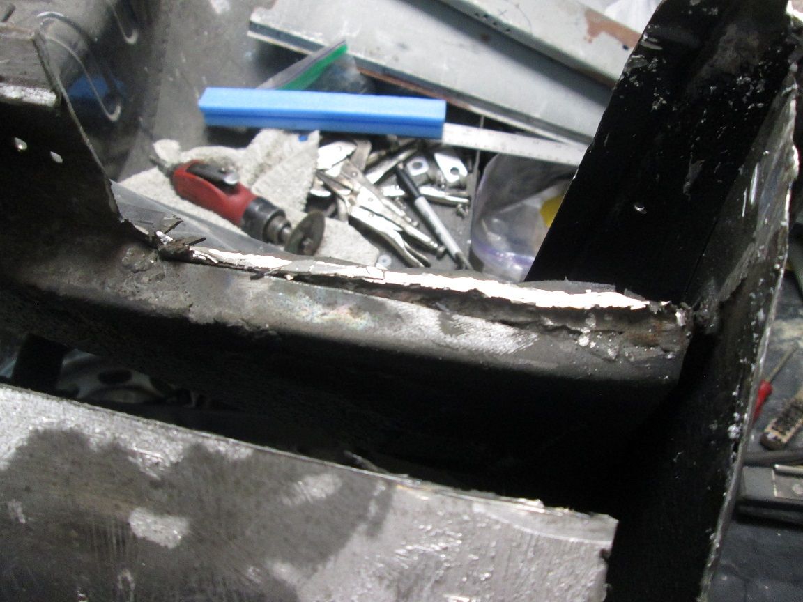

    • top frame mount "the slippery slope":
      Click image for larger version  Name:	IMG_4202.JPG Views:	0 Size:	215.9 KB ID:	107365 Then my attention was turned to the other side; the top frame mount itself. I knew it wasn't original months ago but its one of those things you kind of gloss over and put aside in your mind while you're plate is full with other issues. I was taking stock of it now. An obvious makeshift mounting surface with a lower substructure that's had patch attempts though still rusty.
      Click image for larger version  Name:	image_61879.jpg Views:	3 Size:	130.3 KB ID:	107366 The left side by contrast in original form. Note that small locating hole in the center.
      Click image for larger version  Name:	image_61880.jpg Views:	3 Size:	185.0 KB ID:	107367 The same small locating hole still present behind this "new" mounting surface. So the original wall was still there but just bashed in to make way for this new mount. This was even uglier than I initially thought.
      Click image for larger version  Name:	image_61876.jpg Views:	5 Size:	118.6 KB ID:	107368 That evening I contacted my buddy with this grim discovery and asked him what he wanted me to do. He of course wanted it corrected. Opening up what would be a more intricate can of worms next.

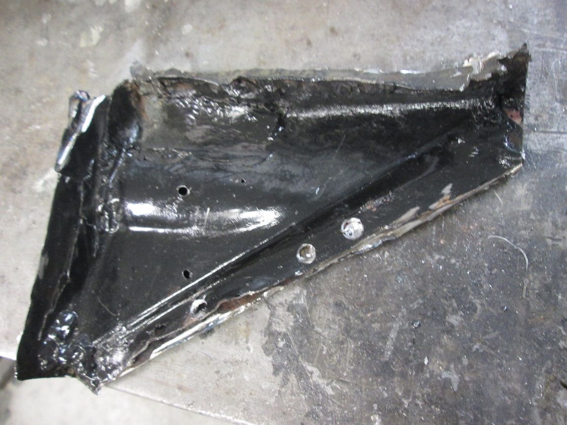

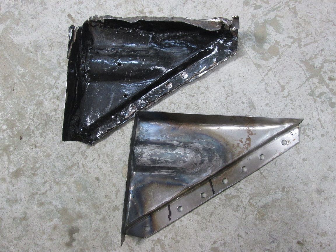

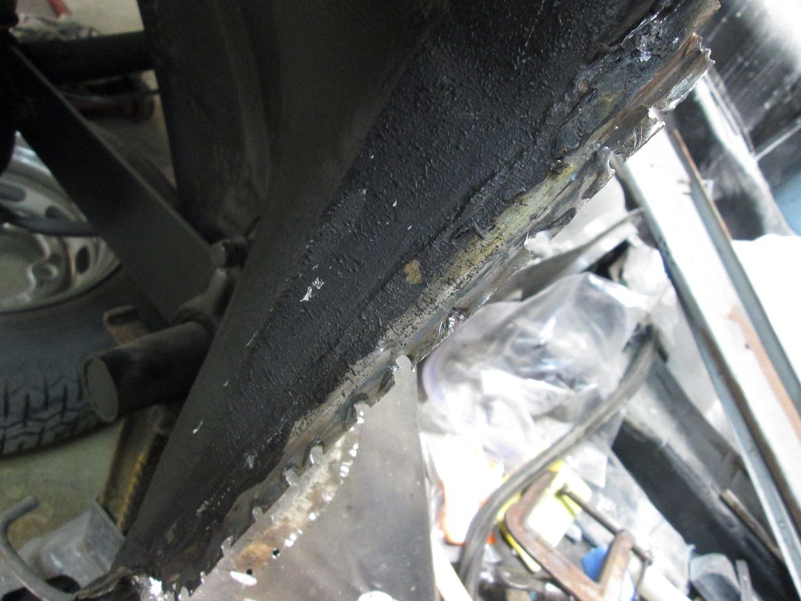

      • Begin unpeeling this onion:
        Click image for larger version  Name:	IMG_4214.JPG Views:	0 Size:	132.9 KB ID:	107370 As suspected the original mount surface was just underneath rusted and barely attached. Click image for larger version  Name:	IMG_4216.JPG Views:	0 Size:	151.0 KB ID:	107371 With the backside of stand in mount exposed the corrosion and brazed on nuts gives every indication that this was a very old repair. I would guess at least 30 years old. I think this plate started out as some sort of existing hardware by the stamping and elongated holes in it. Can't attribute this one to the previous shop but they didn't address it directly either. They just patch plated around it.
        Click image for larger version  Name:	image_61883.jpg Views:	3 Size:	159.9 KB ID:	107372 Original section now peeled back to expose more recent repair attempts. After looking at the untouched left side there is supposed to be a tubular enclosure that shields the top frame mount capture nuts and eventual bolt shanks from the elements. This like the rest of the mount itself had rotted away long ago. A new shield was attempted though; check out that air gap left behind...Amazing!
        Click image for larger version  Name:	image_61884.jpg Views:	4 Size:	122.3 KB ID:	107373 Instead of making a replica of the left side the previous shop hastily heated and folded over a piece of metal which is only welded from the top and one side. As you can see from the previous photo and this one the bottom was left unattached ! Also a secondary lap patch to the front conceals a rusty panel section just underneath.
        Click image for larger version  Name:	image_61885.jpg Views:	4 Size:	166.2 KB ID:	107374 All that mess had to come out too so a larger window is now going to have to be cut so I can get a clear shot at the back side of the mount. Cutting right along that patch line.

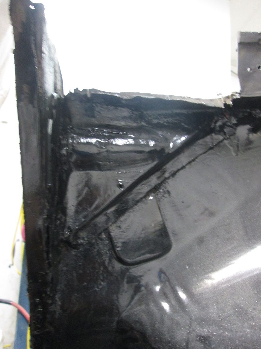

          • A much deeper dive than I anticipated:
            Two more seam welds to cut and I had the lock post back off.
ID:	107383 Now a clear path to get at that upper closing wall corner.
            Upper closing wall corner cut
ID:	107385 just below the inner reinforcement flange.

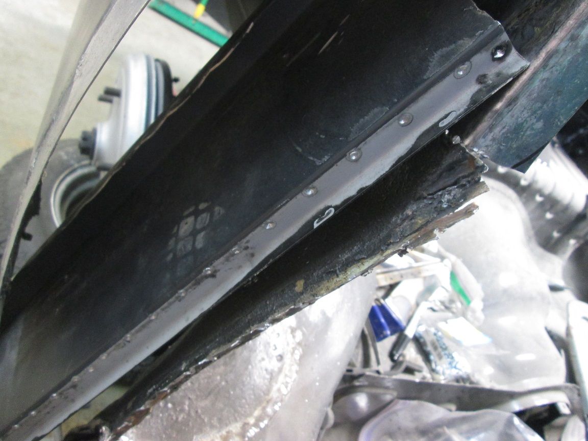

ID:	107386 Finally cut past all the rust and previous repair patches and touched bottom. Holy shit this thing snowballed quickly! I just intended to correct the top of the lock post when I started.
ID:	107388 A bit shocking after all the smoke cleared to find this gaping hole by sessions end. But by the token it was nice to see all those patches and rust gone.
ID:	107389 Click image for larger version
ID:	107390 A lot of intricate little pieces to make..

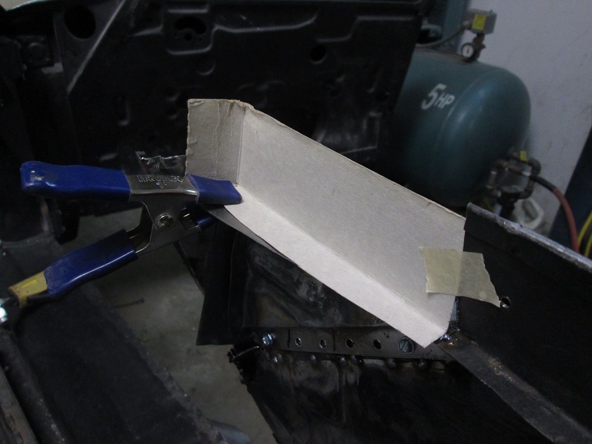

ID:	107391 Begin with upper closing wall templates.
ID:	107392 Thanks for looking!

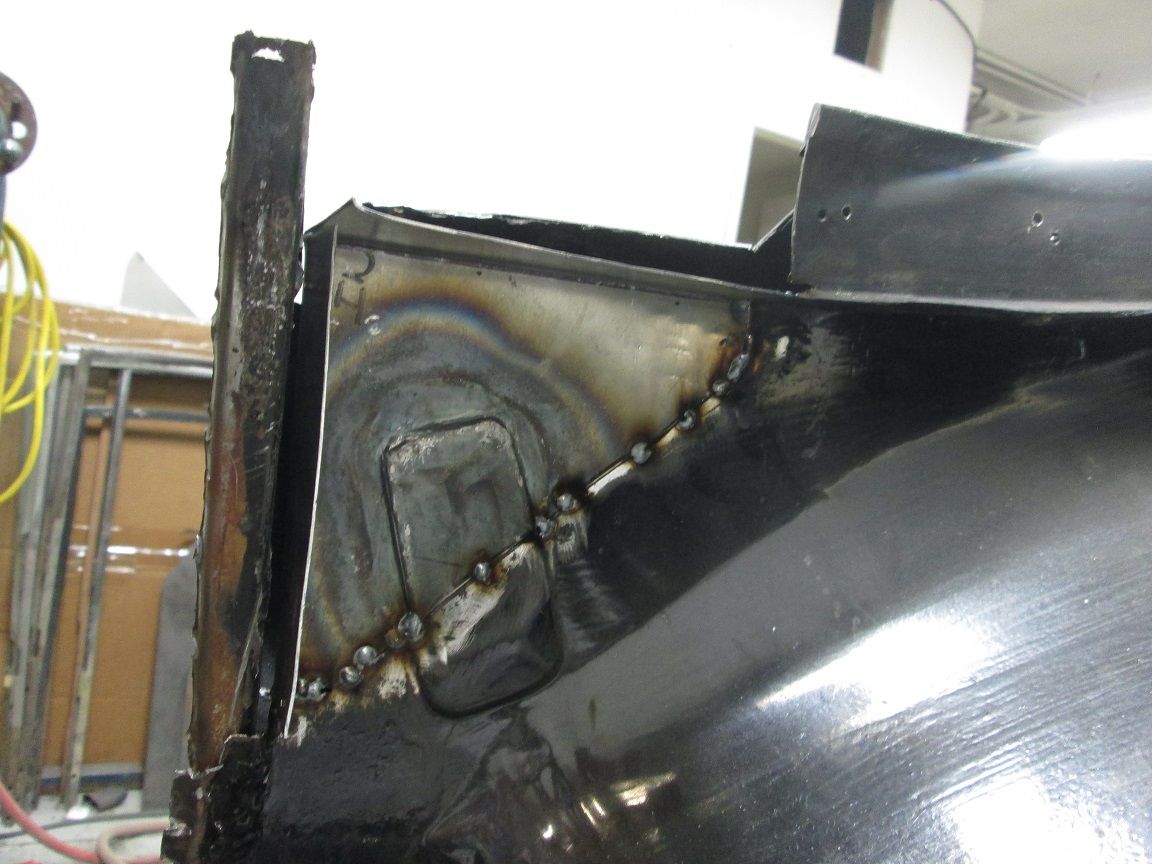

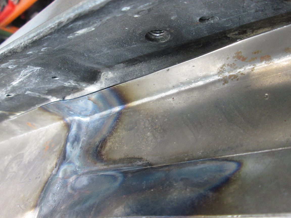

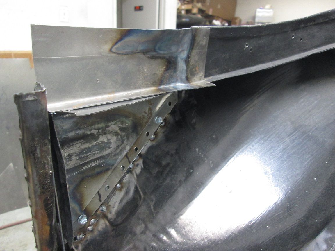

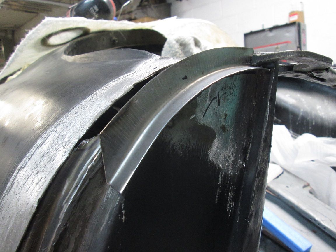

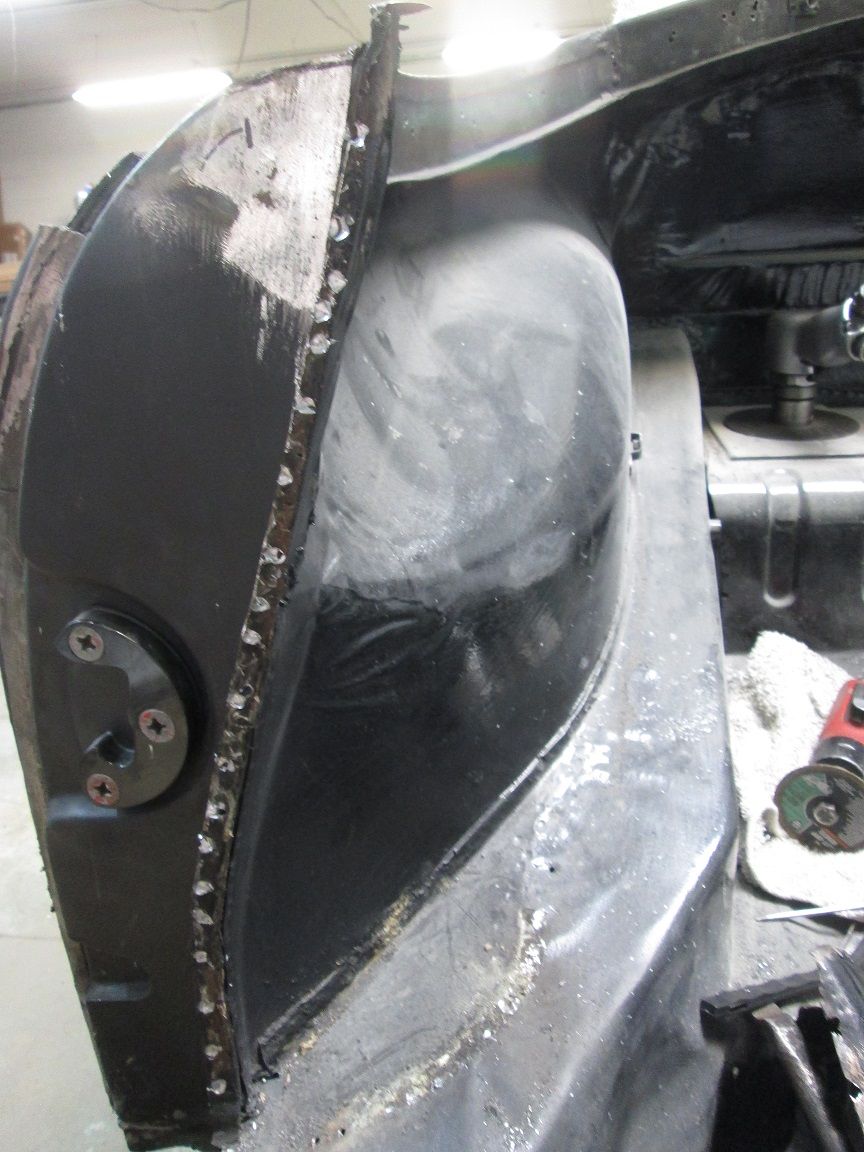

              • New upper closing wall corner:
                Click image for larger version  Name:	IMG_4249.JPG Views:	0 Size:	151.6 KB ID:	107403 Now in metal cut to basic shape and hammering in the rectangular relief shape.

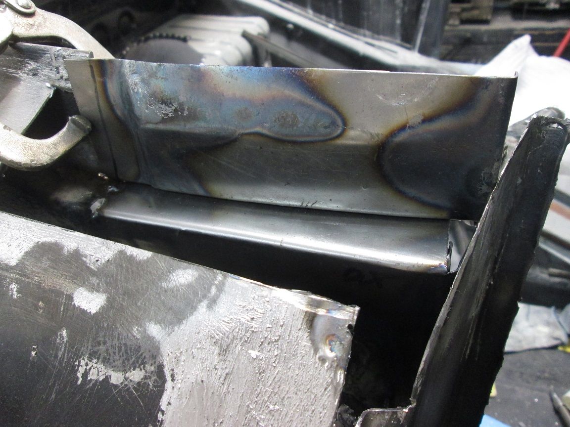

ID:	107404 Relief shape pretty much set. Now onto the flange folds.
ID:	107405 Upper flange in. Toughest part was keeping the relief shape aligned as I added the flanges.

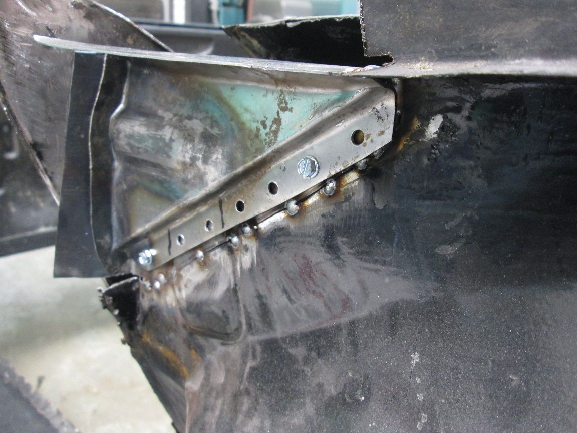

ID:	107406 Tacked into final position.
ID:	107408 Rough mock up with the lock post. So far so good.

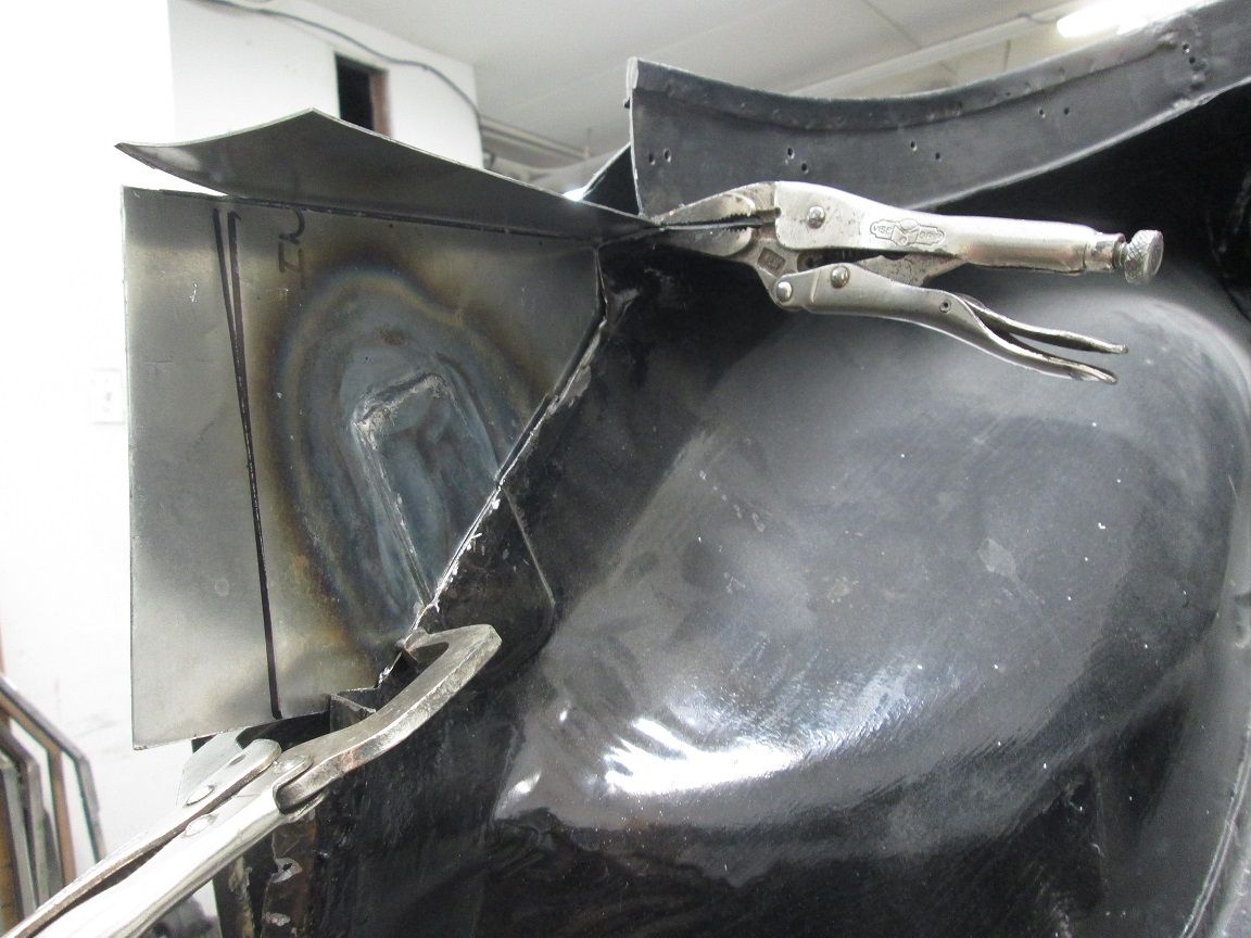

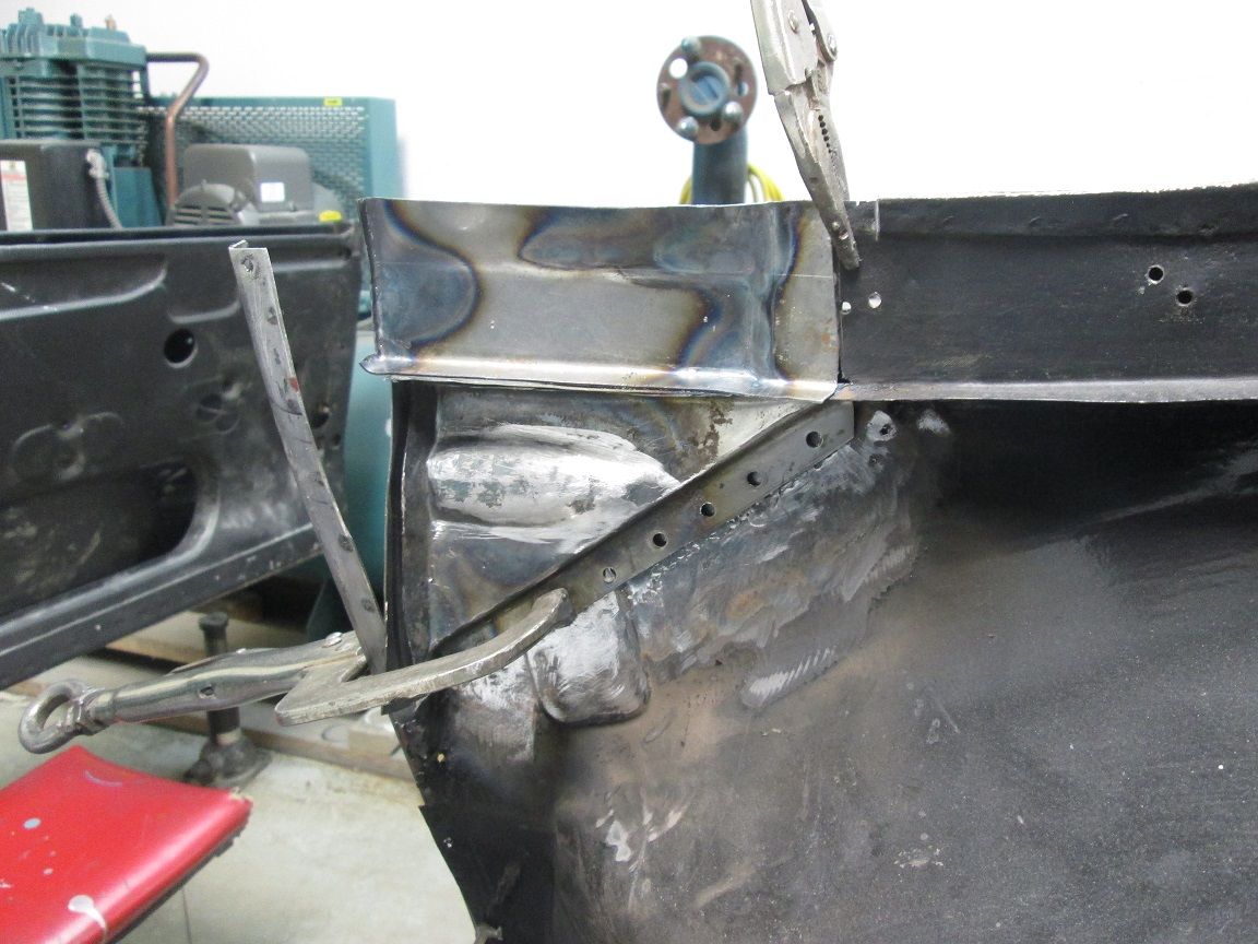

                • Inner reinforcement plate:
                  Click image for larger version  Name:	IMG_4265.JPG Views:	0 Size:	181.3 KB ID:	107410 Onto the inside feature of this upper closing wall. A little more involved to replicate this piece.

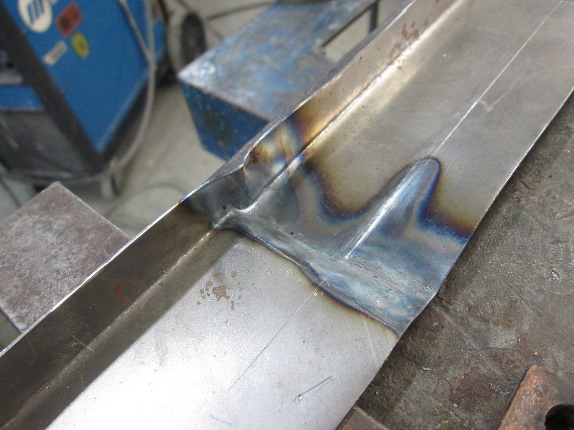

ID:	107411 After some time and plan of attack I had the basic shape copied. Just had to add the last flange of the leading edge here. A little tougher to do with that rounded relief shape in it.
ID:	107412 Eventually got it folded over. So relieved and happy I was able to add in all these shapes without cutting or welding; I had my doubts. Just have to trim the excess at that corner.
ID:	107413 New reinforcement plate copied.
ID:	107414 Quick mock up with set screws. Won't commit to any further tack welding until I get the remaining pieces built and fitted together. Onto the next piece of this puzzle.

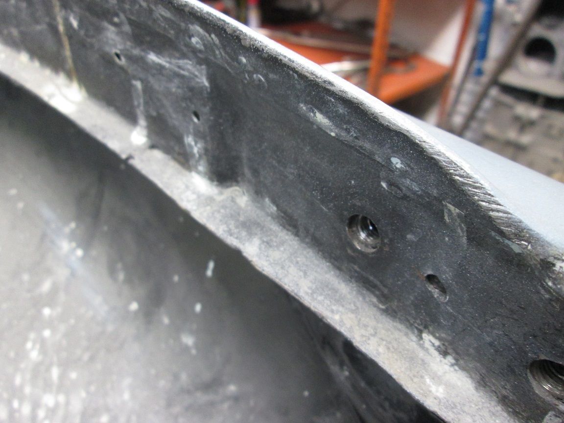

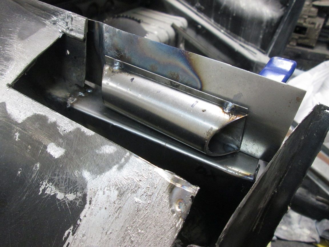

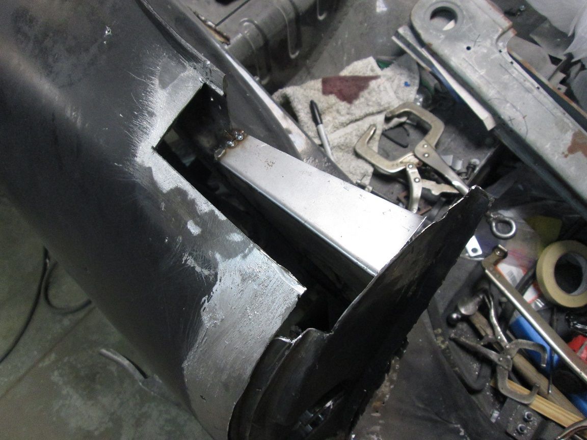

                  • Top frame mount:

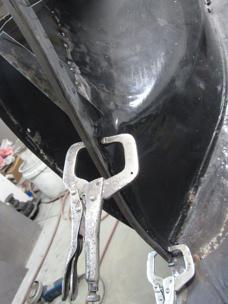

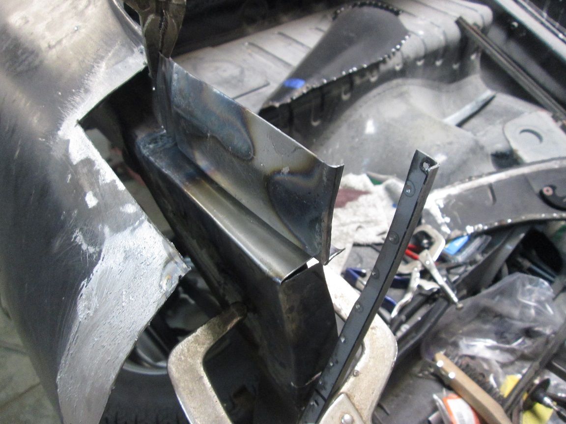

                    Click image for larger version  Name:	IMG_4276.JPG Views:	0 Size:	231.0 KB ID:	107418 Grateful to have an original example to copy from on the left side however its mounted way up high and tight so I could only get a basic measurement and its general shape.
                    Click image for larger version  Name:	IMG_4275.JPG Views:	0 Size:	126.9 KB ID:	107419 Fortunately I had just enough clues to reverse engineer it and make a close copy. The rusted out face on the right side did help me to confirm that it was double walled here.
                    Click image for larger version  Name:	IMG_4282.JPG Views:	0 Size:	167.5 KB ID:	107420 Here is my interpretation based on what I could gather. Cut a base plate from 18 gauge centered and spaced the mount holes accordingly and welded on the proper capture nuts. Rolled some flat stock to the circumference that seems closest to what I'm looking at over on the left side.
                    Click image for larger version  Name:	image_61918.jpg Views:	4 Size:	124.3 KB ID:	107421 Tacked together for now as I'm sure there will be changes that need to be made once I begin fitting to the car.
                    Click image for larger version  Name:	image_61919.jpg Views:	4 Size:	153.6 KB ID:	107422 Will also cap the ends once I'm sure its final shape is going to fit. Either way its better formed than what was in there.
                    More pieces next... Thanks for looking!
