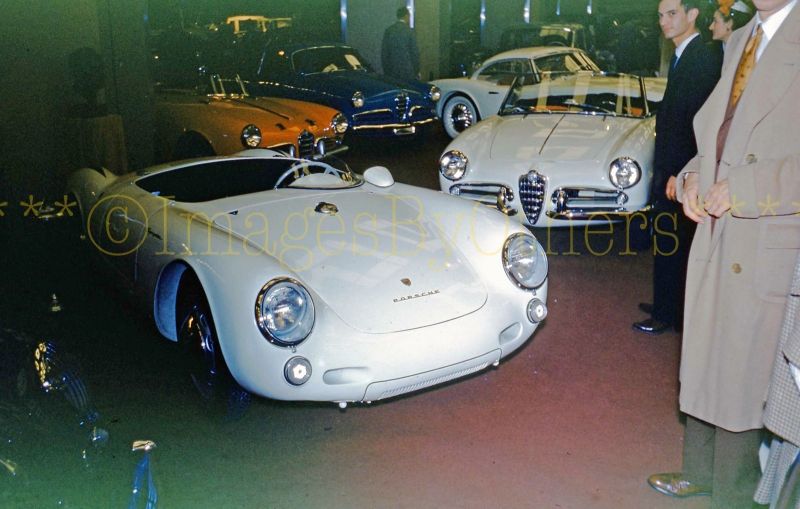

            Steve,
            You have 550-0077 listed as Silver with Blue interior and was featured at the 1956 Brussels Auto show.
            Here is the Spyder which was on the stand.
            • #96
              We'll look into it of course but this may not be the 1956 show pic. Check production dates---no white cars in this time frame and records indicate 0077 was show car.
