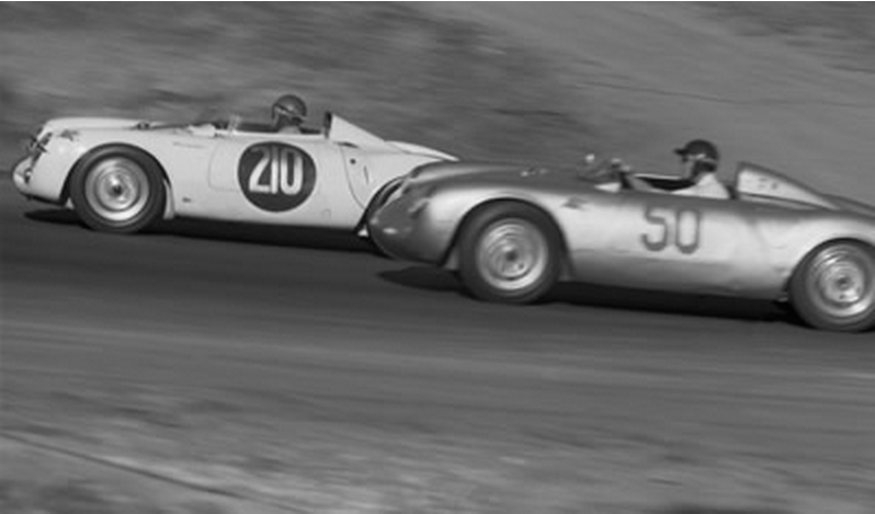

              • P599 - Paramount Race #210 Vasek Polak listed as driving 550A-0130 (which is a silver 550A) The car is a white RS550
                • Polak's spyder is 550-0081

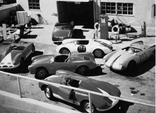

                      • HI Vietta,
                        In the yard photo, 550-09 has race #222. It only raced under that number on 31 May 1958, so I would assume any races around that time with #188 would be 550-0081
                        thanks Andrew
                        • I know a great deal more about RSK chassis numbers than 550's, but I do recognize Ken Miles driving Vasek's car # 50 in the photo posted above. Hope I am not repeating someone else's observation...
                          Richard Roth
