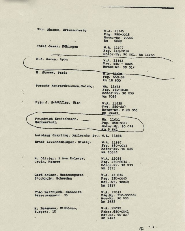

          I have been thinking about the best course here and have a plan. At the moment, we really cannot spend more time on this 05/07/0043 issue as we must get to some changes as well as resume work on the roughly 18,000 race database for the 356s (non-4-cam). This is an exciting project for us.
          Anyway, as to this passionate (for Jacques) debate, after the end of the summer, we'll post here on abcgt, a detailed timelime and more for 05, 06, 07/0043, and the Stuck correspondence, photos, list showing Annie's mother returning 07 for repair...and the entire story as we see it.
          Time soon for all this to settle down and we'll do our best to lay it out for review.
            Thank you for your patience and commitment to accuracy in this complicated project.
            Vietta

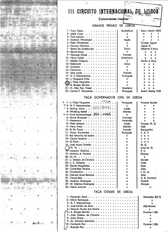

              Steve Heinrichs has asked me to post documentation about the 1955 Monsanto race. We decided to post this completed research since our comprehensive post date is a few months away.
              I have attached the entry list for the 23-24 July 1955 Monsanto race, date stamped at the factory "27 July 1955". By the date of the Monsanto race, Bousquet was driving the re-configured car 550-07/550-0043. We do not know if Bousquet or her car actually appeared at this race.
              Entry List:
ID:	62446Click image for larger version

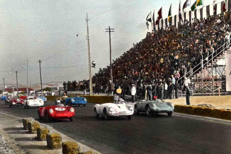

              I have also added a copy of a photo that shows more of the grid including Mascarenhas (#2) and clearly shows start #7 (Hezemans) whose headlights seem to have significant slant.

              • The colour photo is difficult as the cars have been hand painted, so the colour of the cars are inconclusive
                • Andrew, please let us know how the two lists should be considered in your view.
                  • Hi Steve,
                    With Monsanto, I really don't believe Bousquet attended and raced. I have searched everywhere and spoken to numerous people and there is no indication that the car was at the start line.
                    With the service listing I will need to look further into it. I appreciate you posting them.
                    thanks Andrew
                    • Andrew,
                      You may be correct that Annie was not there or her car not tested. If so, it matters almost none. Still, the pre race list is important in again tying into the fact it was not 550-05.
                      • Andrew,
                        The Monsanto list is from Porsche Archive.
                        Also, please let us know if you have any Euro 550-05 photos with new front end and which car was at Dieppe.

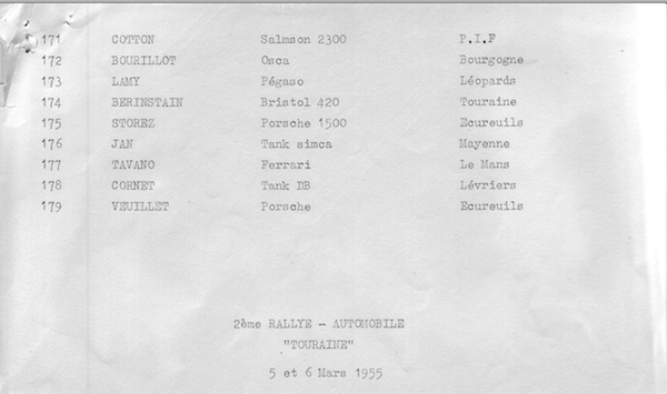

                          • Here is the entry list from Touraine Rallye
                            • With a simple date analysis of this service sheet, based on the owners of the previous cars on the list, Jesser did not own 550-0016 until April 1955 when he started racing it at Solitude. If the car had done 11,200 km when it went for a service, it could be highly likely well into May 1955. 550-07 listed may well have been 550-0043 with the 550-07 plate on the chassis (and the new engine) being returned to the factory after the D'Hyeres race for it to be prepared for the world record attempt.
                              Do you know why D'Hyeres was a DNF?
                              • Also Friedrich Kretschmann did not own 550-0037 until May 1955...
