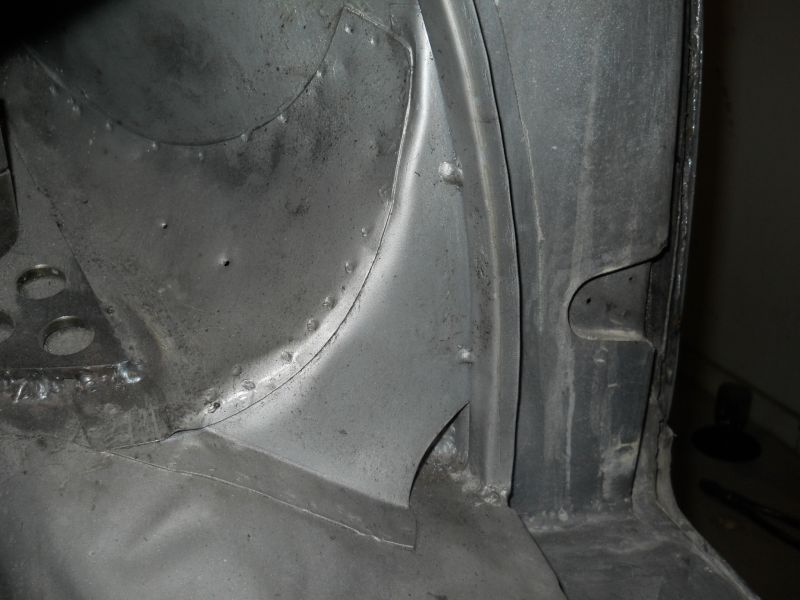

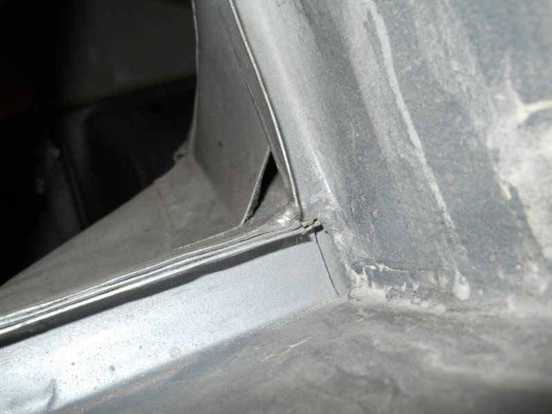

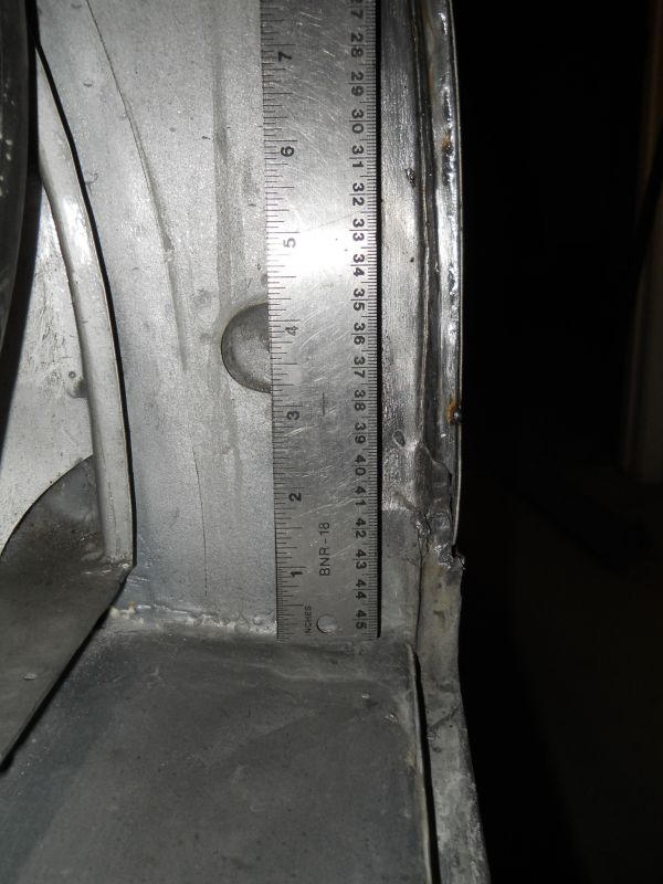

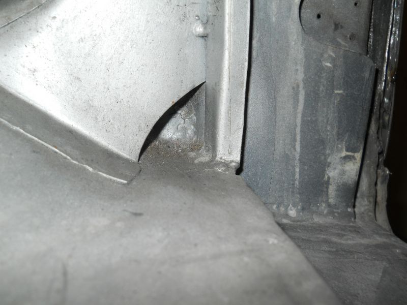

        Frank, I took some detailed shots of that rear corner for you. Hope these help...
        The three layers I described before.
        Reinforcment brackets/gussets to triangulate this corner.
        you can see here that the channel is attached to the top of the threshold runner.

          Appreciate the comments guys and thanks Justin for taking time to take and explain the pictures for me.

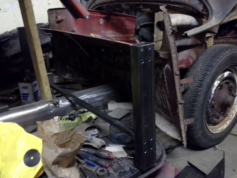

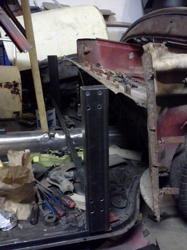

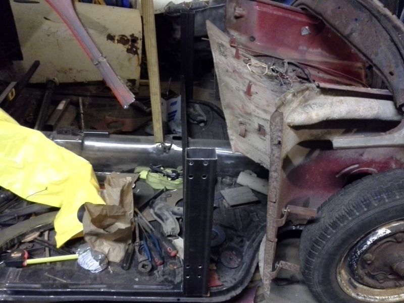

          1-20-2014
          I got the dash cut out of the Ghia front half.
          I also started welding up the door hinge post. It just setting there, I have a few more things to before I can get them welded in place.
          Not sure how I want to weld up the dash yet. Debating on welding like the Ghia directly to the trunk area or like Porsche did with the space and then the hinge panel.
