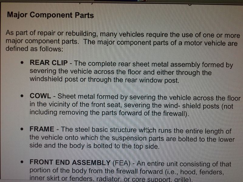

  • #76
    ...Missouri

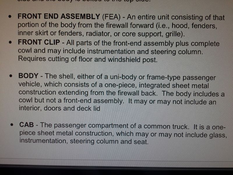

    The 64' Ghia title is clear. But they consider the rear clip a major component want vin numbers for every part.

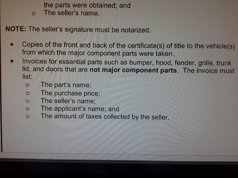

    • #77
      Now for the hood, doors, fenders, and trunk I wouldn't need vin's
      It's ridiculous, too many rules and regulations. If I don't have a vin# for the body, they won't let me proceed any further to get the constructed vehicle title to get it on the road.
      • #78
        So I have the vin for the Ghia and if I had a vin for the Porsche body, they would run the numbers and verify that they are not stolen. Then I could fill out papers to apply for a constructed vehicle title. after that is done they would issue the car a completely new vin number.

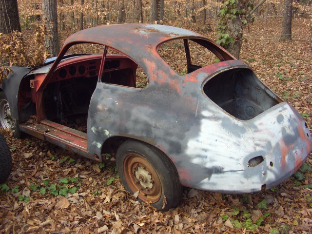

            We are happy to provide you ( or them ) with images before the car was sliced and diced-

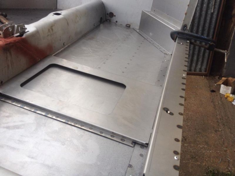

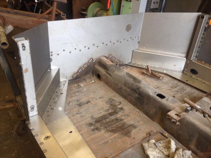

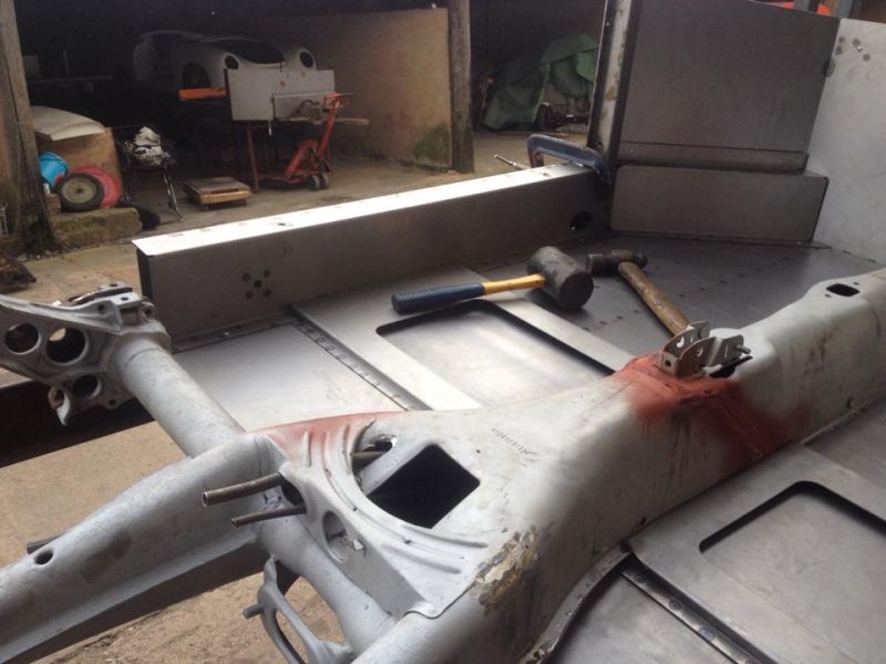

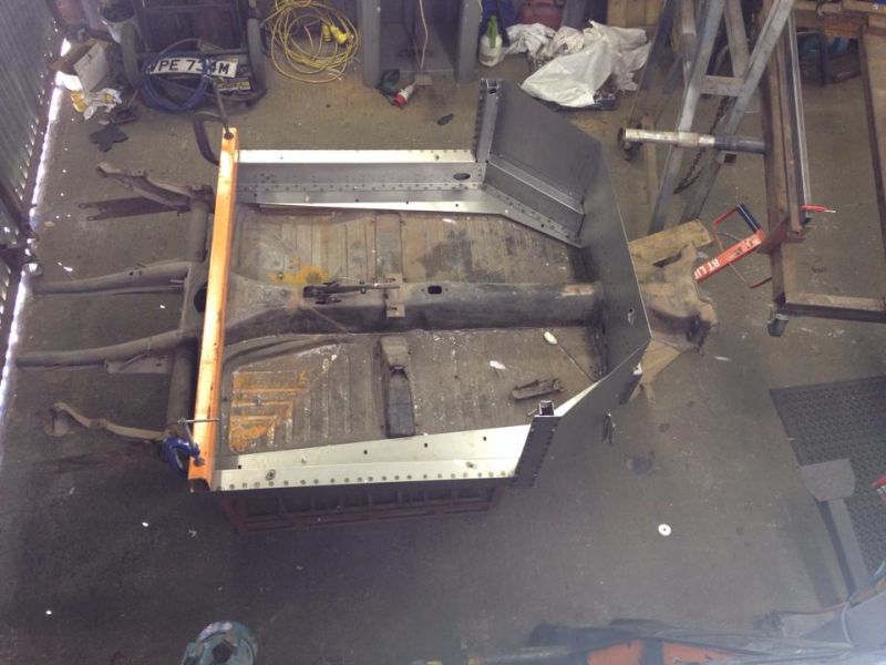

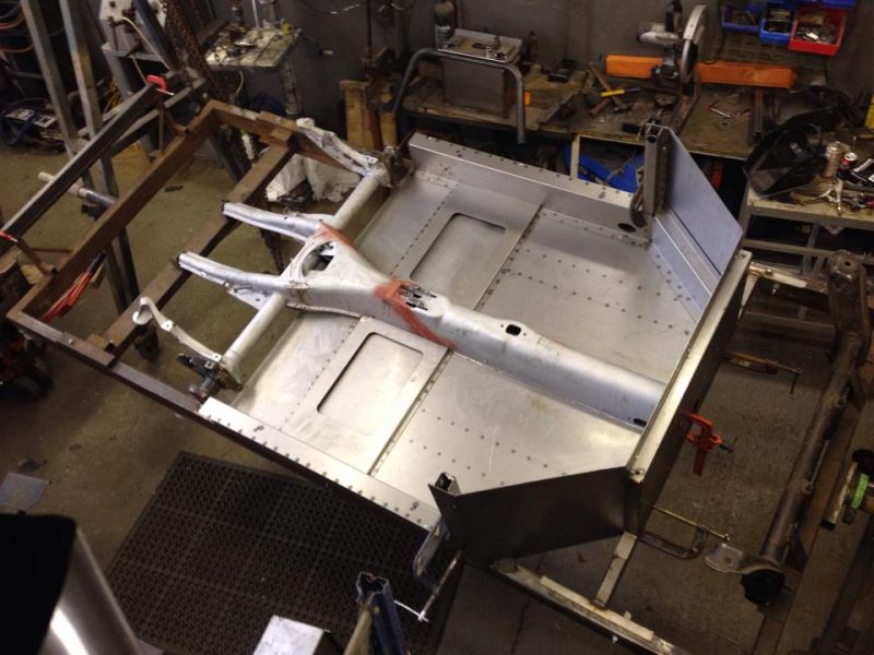

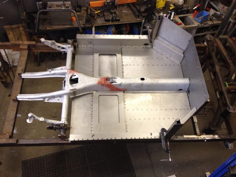

              A really slick and easy way to build sill plates on a VW pan to hang your 356 body work from such as your rockers ,hinge and striker posts. If you welded all that up as a unit it would really stiffen things up on your chassis too. Food for thought....
              • #82
                Hey Justin,
                Were the two photo from a build thread or just some random photos you came across? I would like to see it being constructed. I thought about changing things around with the chassis many times for my car, getting it to look more like the original but in the end it's still a VW underneath.

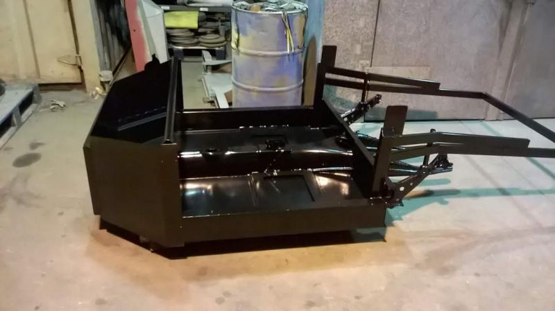

                • #83
                  This is a build by a guy named Gary Blundall. Its posted on the replica speedster FB page. Take a look. Here's a few more of it:

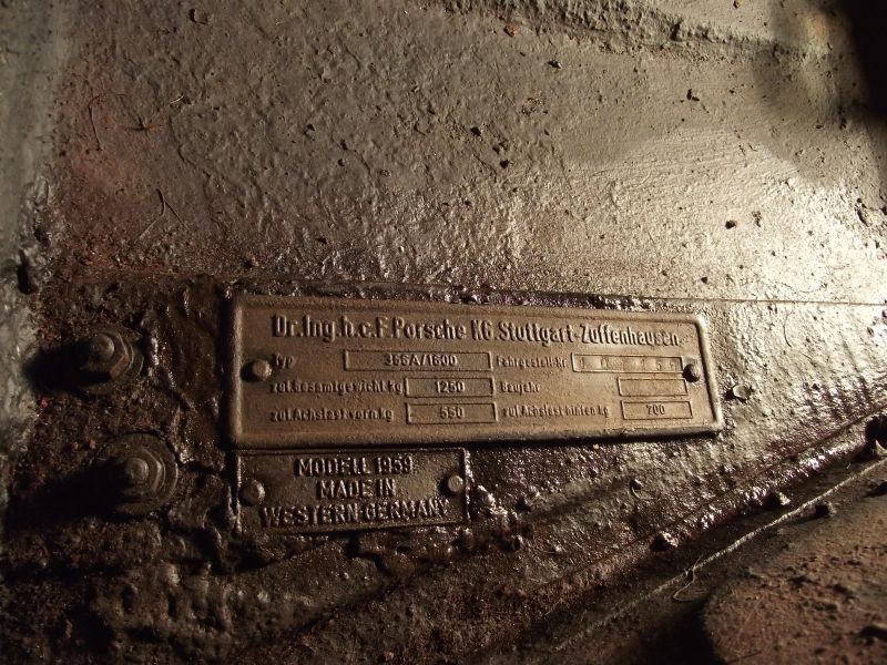

                      Does anyone have the small "1959 Model" tag laying around in their stash they would be willing to part with?
                      • #86
                        Glad to hear you're not giving up on this project Frank. Look forward to you picking back up with it. I might have one of those tags, I'll scrounge around.

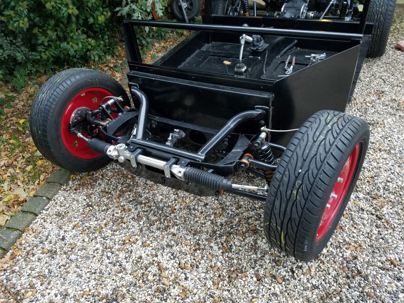

                          Hi,
                          Just looking at this blog and can see that you have some pictures up of one of Gary Blundall's Speedster Clinic Chassis. THese Are great Items and I have one that will be underpinning my Pre A Coupe. He does a number of different options so check out www.speedsterclinic.com to see his chassis options....This is mine nearly completed as a rolling Chassis with Red 9 double Wishbone front and coilover rear suspension.
                          • #88
                            Always thought Gary's subframe was a nice platform Rob and those photos help to confirm it. Love to see your pre-A build if you have some time.
