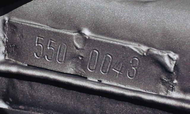

  • I will go out on a limb and say the first one

      • Definitely the second one is the fake Andrew. Plate should be either Spot welded like the first example or maybe gas welded at the very least. The second one has been attached with a MIG weld. Looks like a prime example of VIN tampering.
        • Well Andrew, even if you ask people such a simple riddle you shouldn't make it to easy and call the photo "fakechassisplate.jpg"

            • You are correct Justin (and yes, the file name was a giveaway!) I thought it would be a no-brainer for this forum. The tell tale signs are the welds and how it distorts the plate when fixed and also the condensed font used to stamp the numbers used by Porsche/Wendler. You can see a different font for the fake one. You do wonder why they go to so much effort to create a fake and the first thing you would check are the plates!
