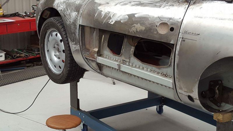

    The longitudinals look super heavy duty! How much did you raise your front beams? Love the way you laid back the head lights and rolled those doors down. The new roof line looks sweet as well. This is a fantastic tribute build to the Emory Special of which, you seem to be executing all the right details. Thank you once again for sharing this build with us. Great work!
      Many thanks Justin, the fabrication is being done by a friend, unfortunately my skills don;'t run that far. As we converted the car from a coupe to a cab we decided to use 3mm plate steel with ribs inserted to strengthen the longitudinals, should do the job!
      We raised the front beam by 2 inches, according to Dick (my panel guy) it actually wasn't that tough to do. It also keeps the geometry of the front suspension the same.

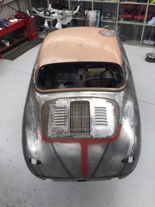

        Some more photos

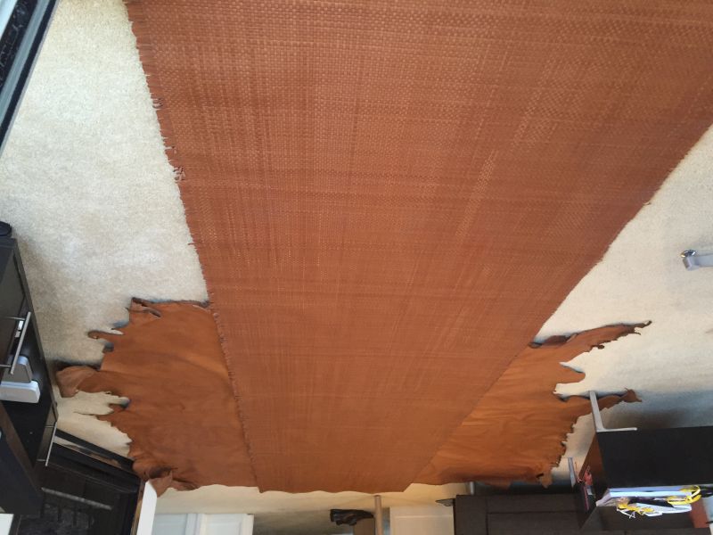

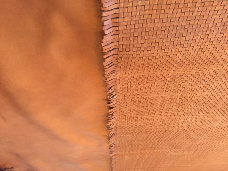

        Here's the Spinney Beck leather

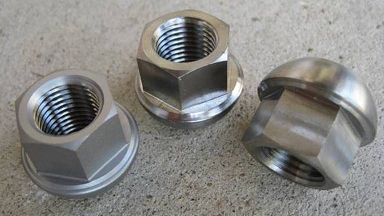

          Titanium wheel nuts.

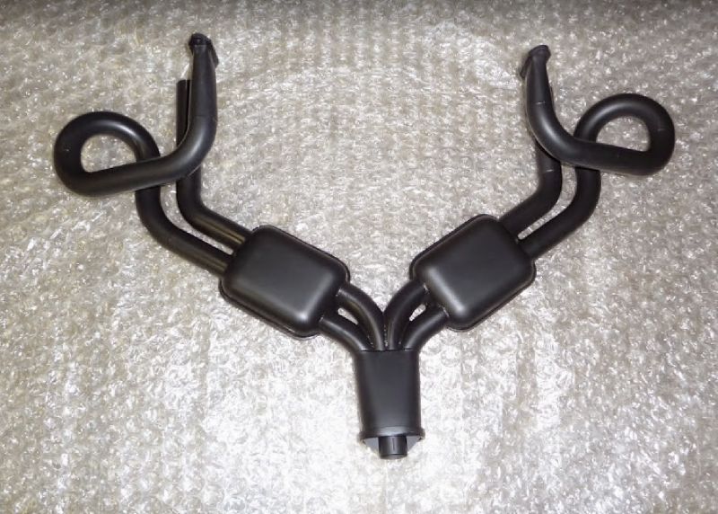

          Jim Constas Sebring exhaust

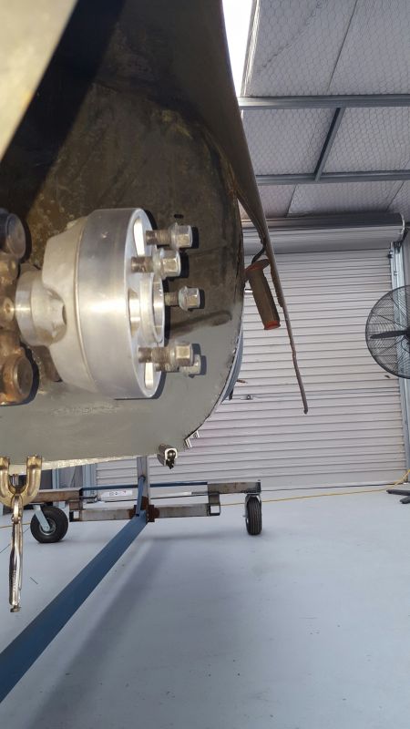

          Front wheel spacer that pushes the wheel out to the guard.

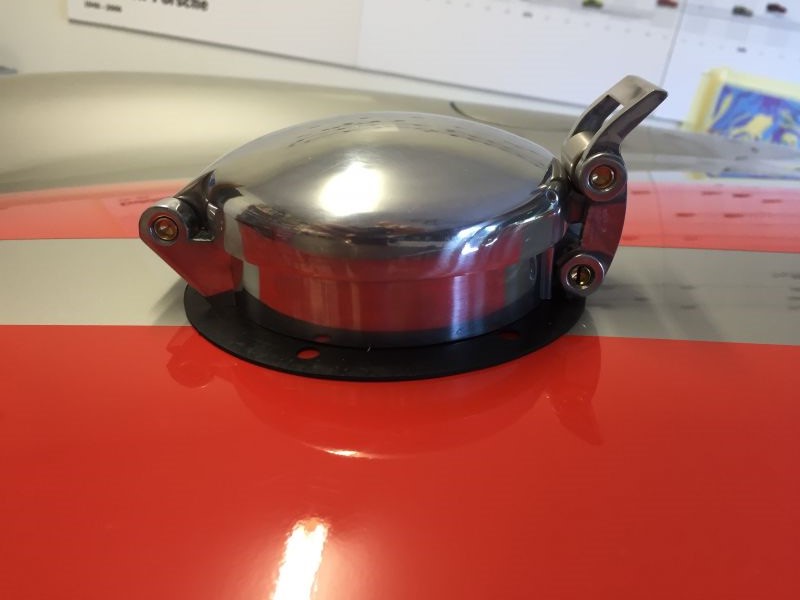

          Picture of the centre fuel filler for the hood

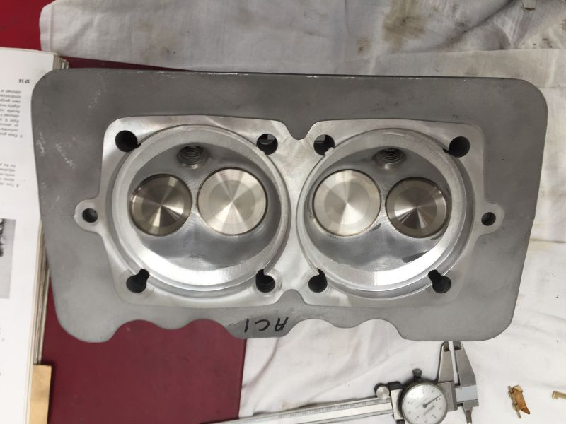

          Heads for the 2132cc engine, CNCed by Willhoit's.

                I Think those heads are bored and opened up about as far as they'll go.
                Very trick, Titanium lug nuts! Who did you source them from??

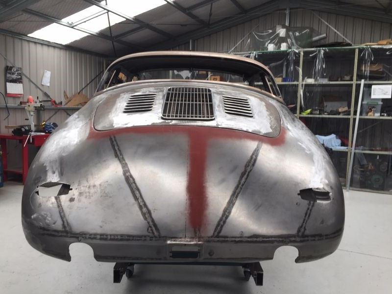

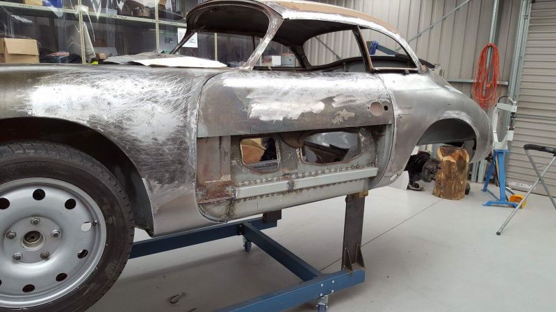

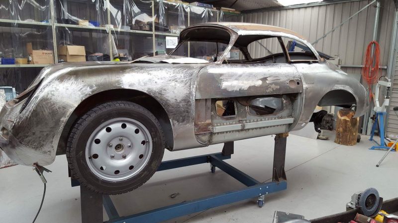

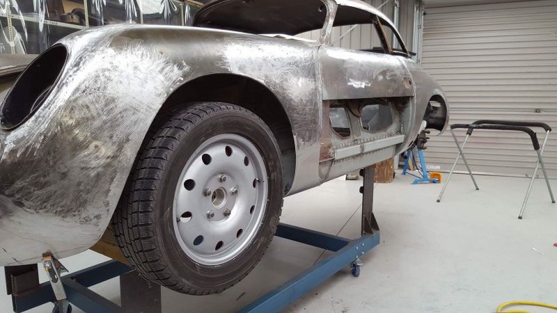

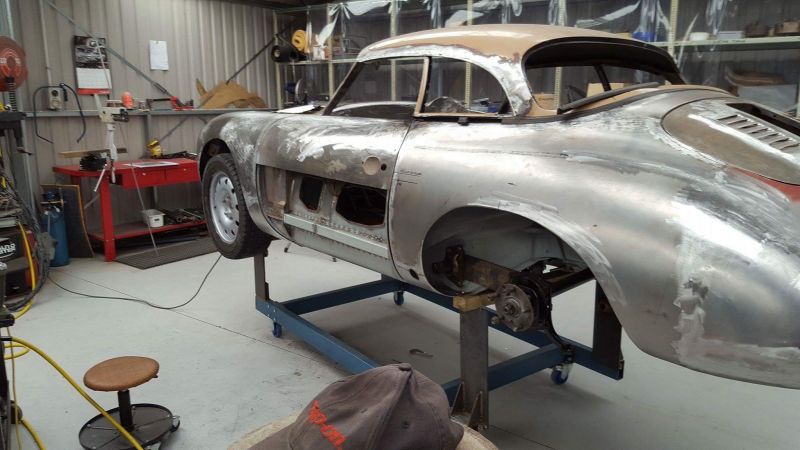

                    Some photos of work in the doors and front guard this week.

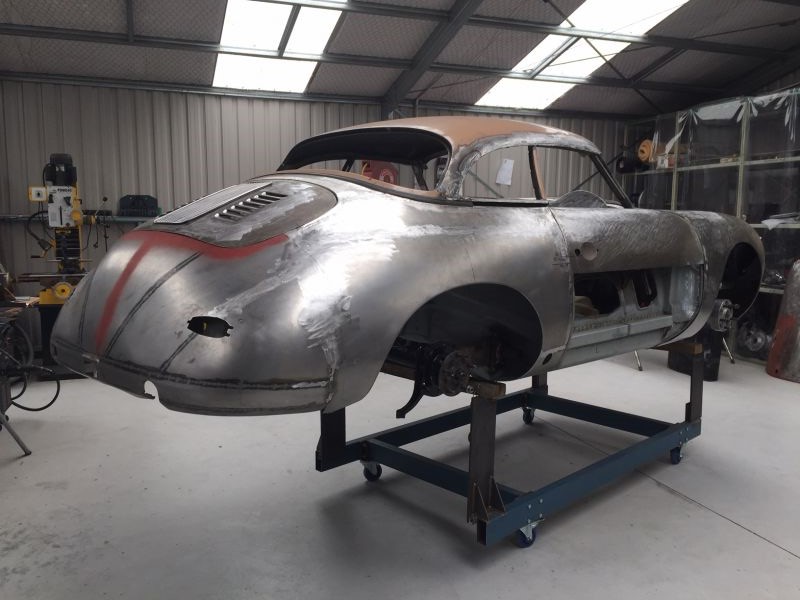

                      The swoop arch downward looks fantastic Angus. The pick and file work at the weld joints on those fenders looks very nicely done! Thanks for the info on those lugs and this update on your progress!

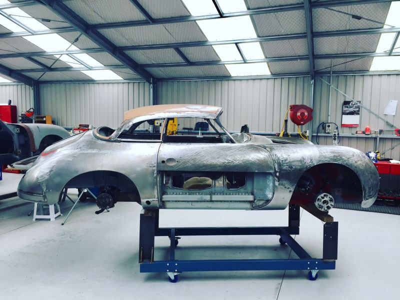

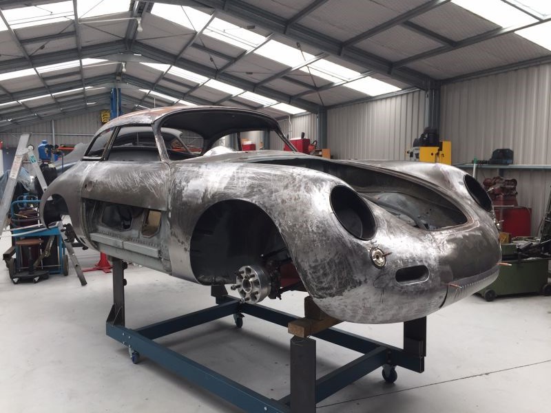

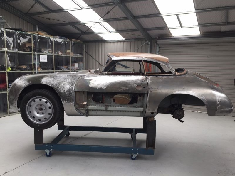

                        Further progress.
                          Being you're from New Zealand is that why the pictures are upside down?
                          Sorry to hear about that earthquake!
                          • #28
                            I hope you and all your friends made out well in the quake.
                            I ordered my Spinney Beck leather samples today. Thanks for the steer, going to do my 66 912 seat centers with that weave. I think I am going to do a woven dash also. The best part is the matching full hides. So the doors and everything else will the same. Great steer..

                              I have no idea why the photos are upside down? Must be a hemisphere thing as you say
                              Thanks re the earthquake, lots of damage but only 2 died so which was very lucky!

                                The Spinney Beck leather is expensive, but the quality is 2nd to none. You won't be disappointed.
