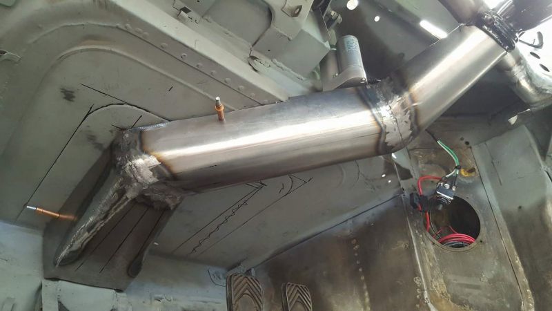

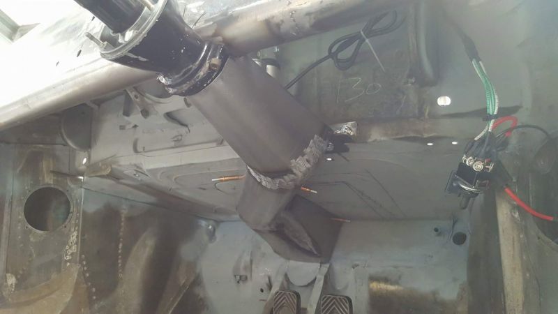

            Dick spent yesterday working on the cover for the 911 rack & pinion steering we have installed in the car.
            It won't be noticeable once the car is on its wheels and the underside of the dash is painted black.

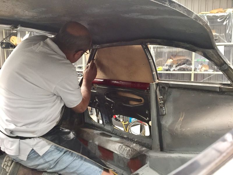

            • #51
              Dick working on the window templates.
              With the roof being chopped by an inch and the door quarter windows removed the windows require a bit of fitting. Plus the regulators need extending to take the longer (width way) glass. The intention is for the door glass to seal like a standard cabriolet against the rubber. Dick also had to move the hardtop B pillar inwards about an inch so that it lined up correctly with the A pillar given we had tilted the A pillar back to match the hardtop chop!
              The shape of the top of the doors is now completely different to standard as well. The doors roll over and follow the general door shape as opposed to the sharp edge normally seen on a 356B/C

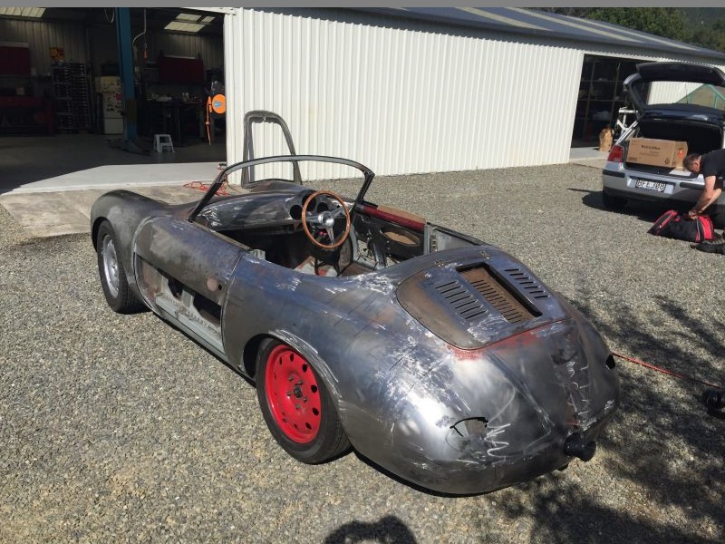

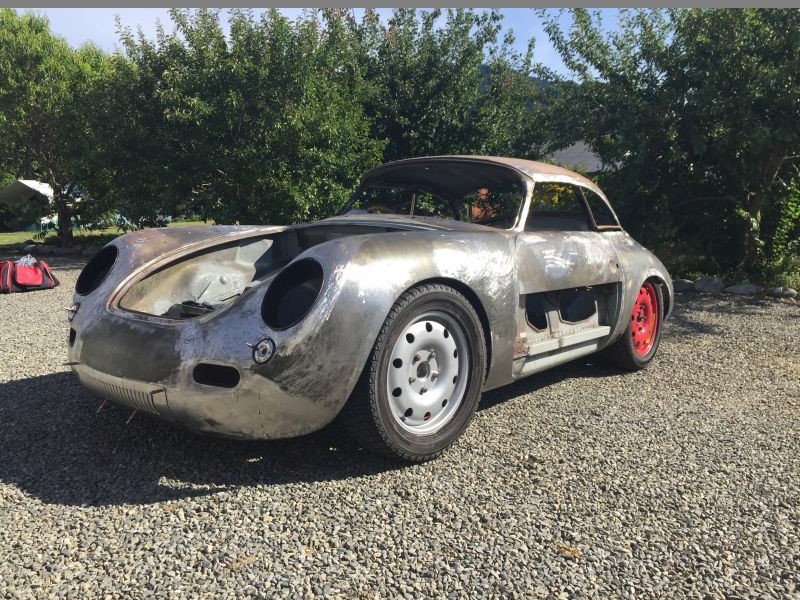

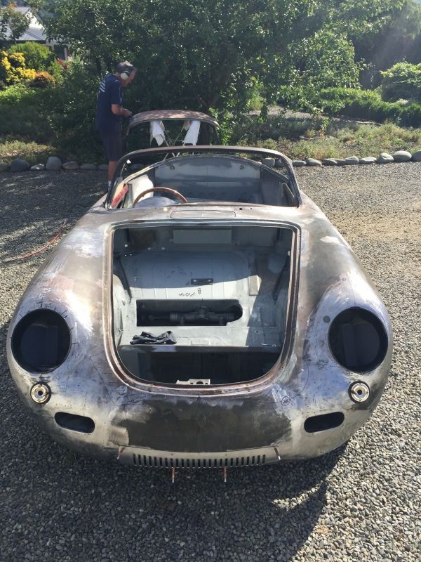

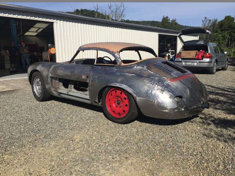

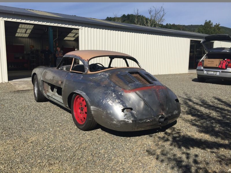

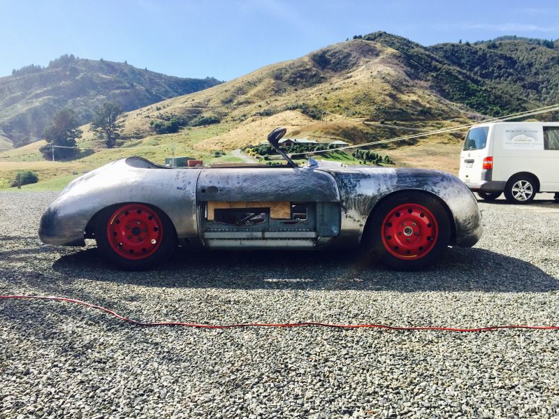

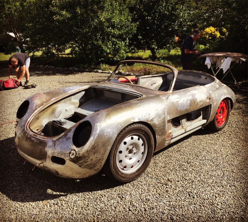

                    Latest pictures of the car from yesterday. Been a little quiet over Christmas & New Year holiday but the guys are back into it now. We hope to have the body ready to send of for premier in 6-8 weeks all going well. Lots of details at moment which slows down the big obvious changes.
                    Roof off for the first time.
                    You can see the 911 rack & pinion steering in this photo.
                    I like this shot, nice background

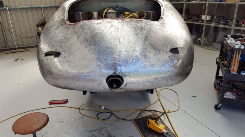

                    We are now very happy with the rear of the car, loving the exhaust exit.
                    Poor came off later that day to be stripped down and file finished.

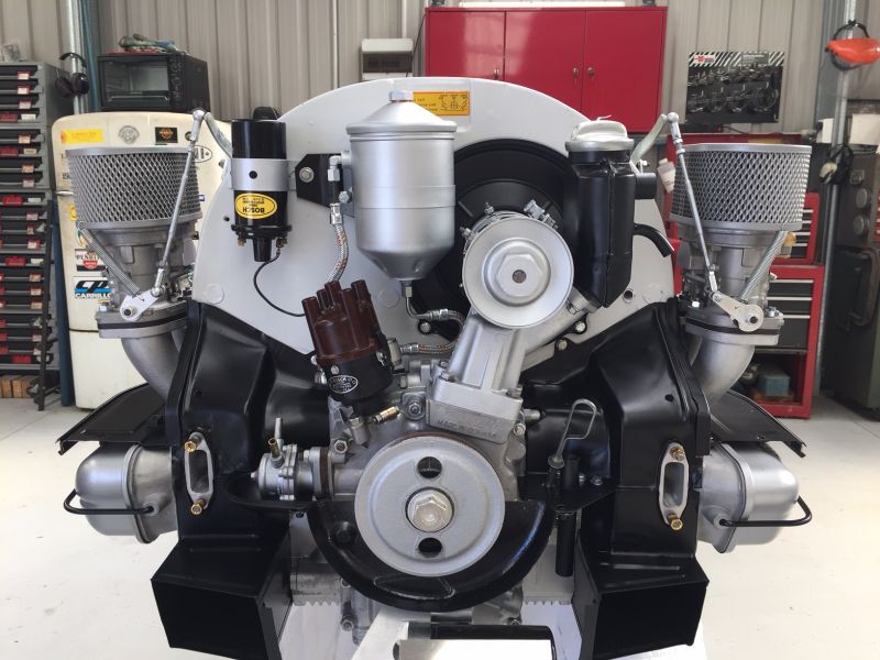

                        The engine almost complete thanks to Kip Colvey at 'One at a Time'. John Willhoit 2132cc engine, running 44 Webers. For the train spotters, yes the oil filler is shorter than normal. We needed to shorten it due to raising the engine/transmission to lower the rear, otherwise it wouldn't have cleared the engine lid.

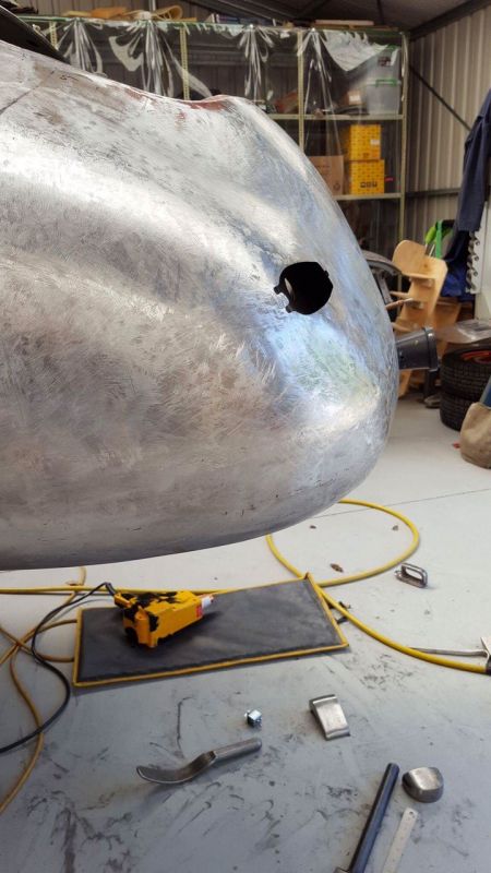

                        • #57
                          Does this make my ass look too big honey?
                          Here's the rear mostly finished, hammered and filed.
                          • #58
                            A ton of pick and filing time in those panels. Looks fantastic!

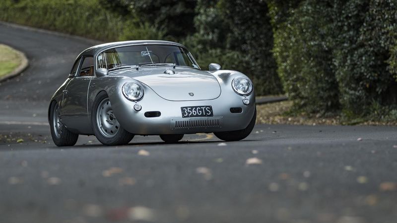

                              Wow... Ay. Cooper. How about some updates mate..
                              Found this online from auto car.co.nz. Looks like Kiwi Cooper has completed his coupe. For some reason my iPad won't let me paste the link. But here are the photos from the article.
                              Ahha fixed it.. Follow the link.
                              http://www.autocar.co.nz/classic-reviews-app/porsche-356-coopster-review
                              • #60
                                Perfection. Great taste, vision and execution. John in CT.
