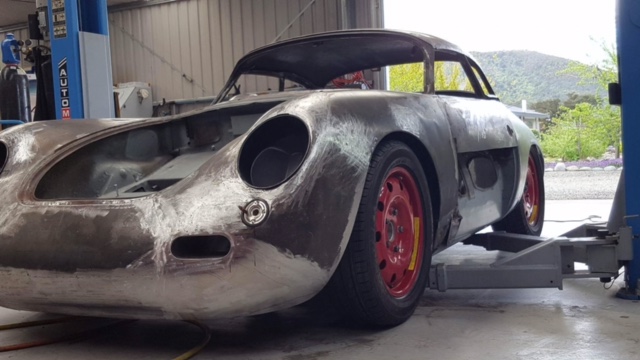

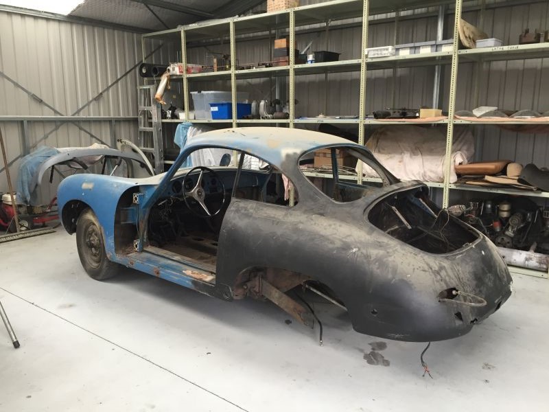

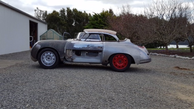

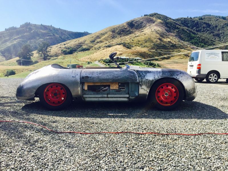

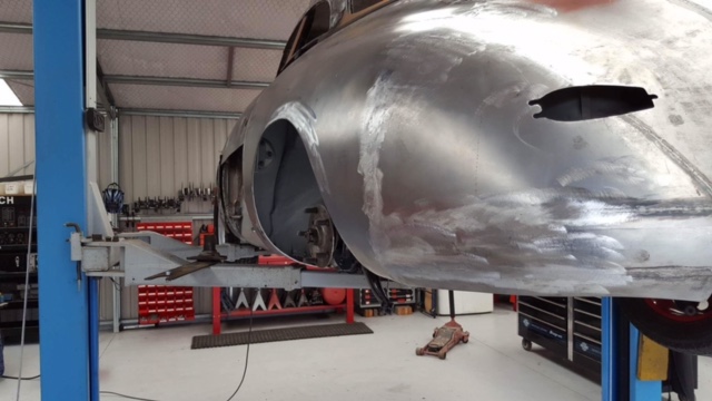

    We are one year or so into an Outlaw build here in New Zealand. The car is essentially a copy of two of Rod Emory's cars blended into one project. I would have loved an Emory car but couldn't afford the folding $$$, so in typical New Zealand fashion we thought we'd 'give it a crack' and build one down here.

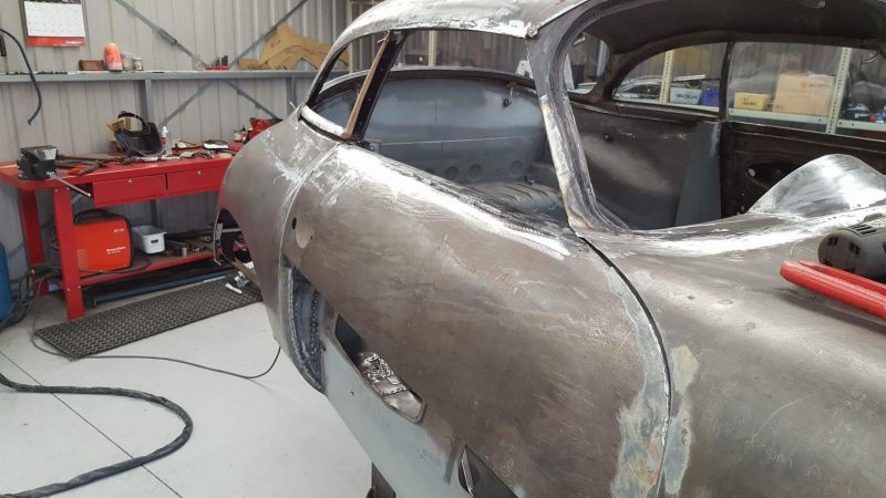

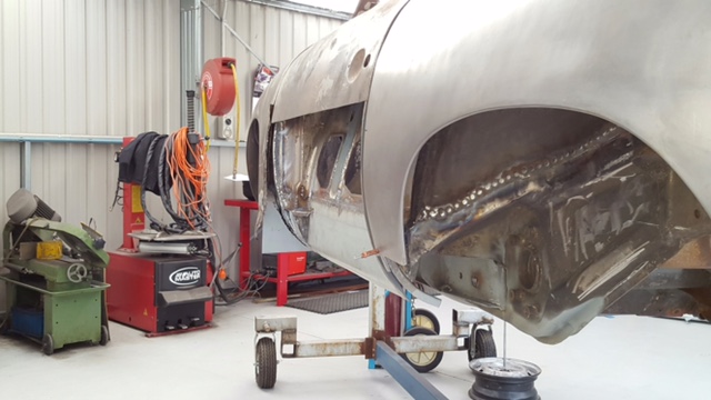

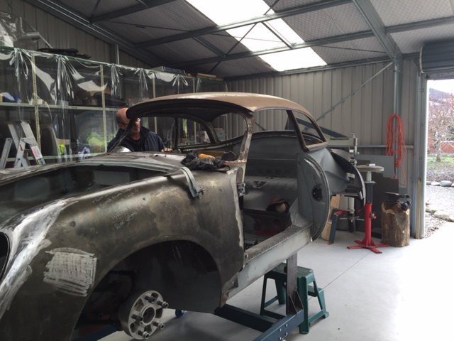

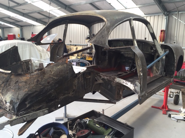

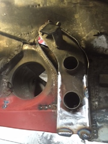

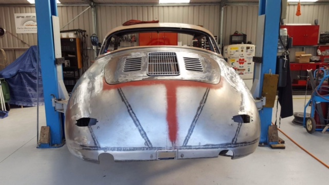

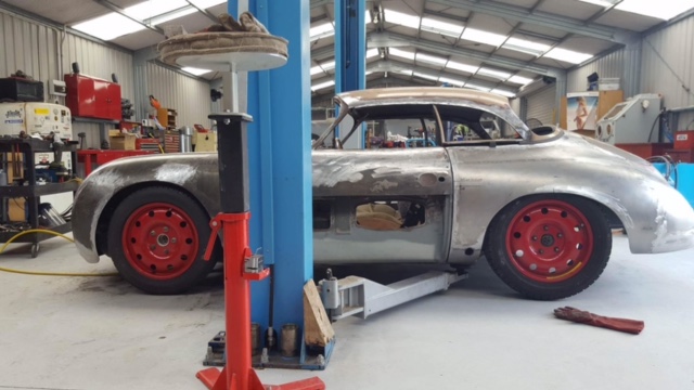

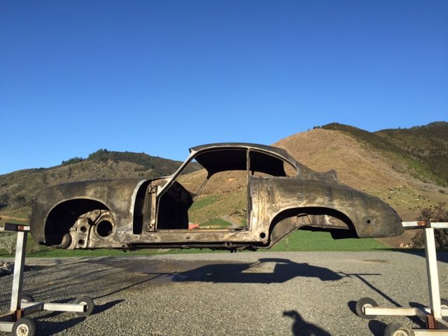

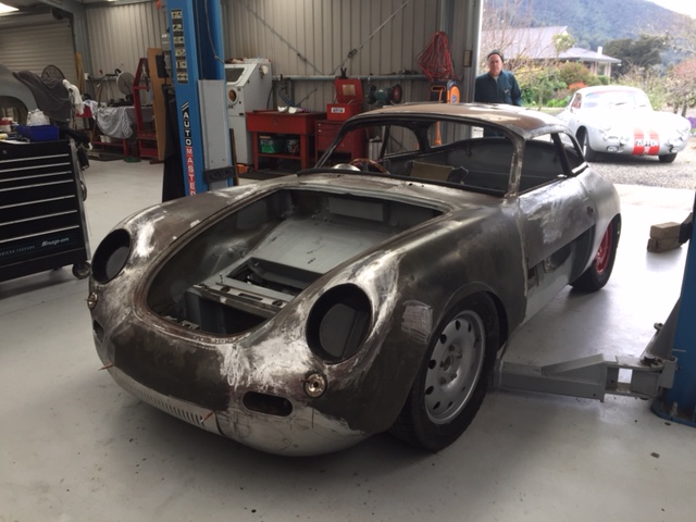

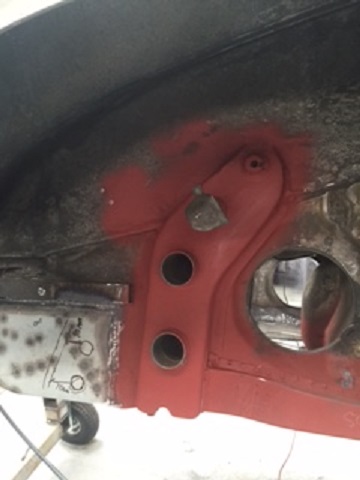

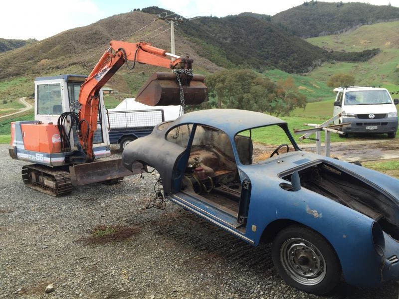

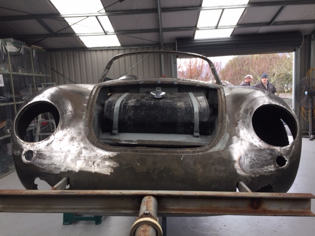

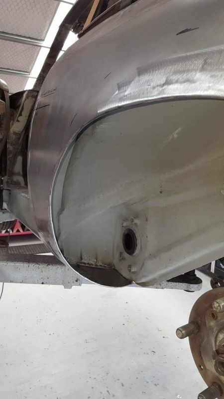

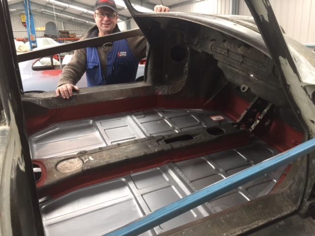

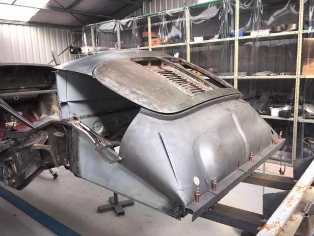

    Started with a 1963 356B T6 Coupe that was found under a mango tree in Hawaii, purchased and rescued the car by good friends up there. The work from there has been extensive converting the car into a Cabriolet and then some. Think the pictures tell the story but 1300 hours of panel work to date.

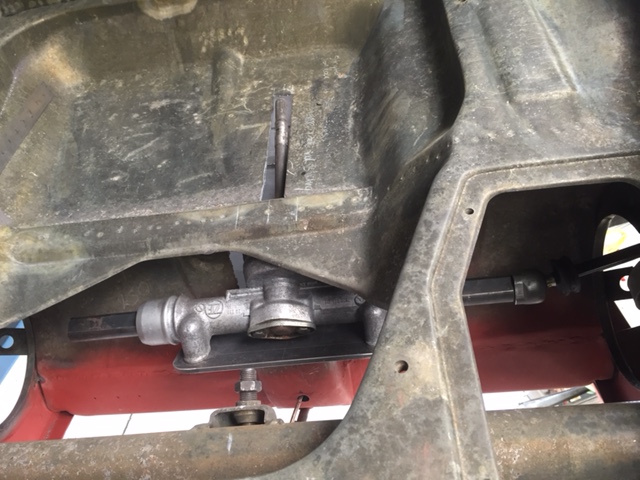

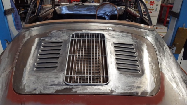

    The car will run original 356 engine, transmission (12 bolt) and suspension. However have gone early 911 rack & pinion steering for a giggle The engine will be a John Willhoit 2132cc mated to a fully rebuilt 741 transmission. Car has been converted from LHD to RHD, interior will be 944 seats cut down and built similar to early 911 seats. The leather will be Spinny Beck the same as the Singer Porchse.

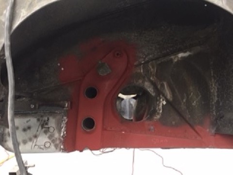

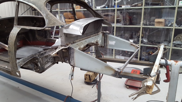

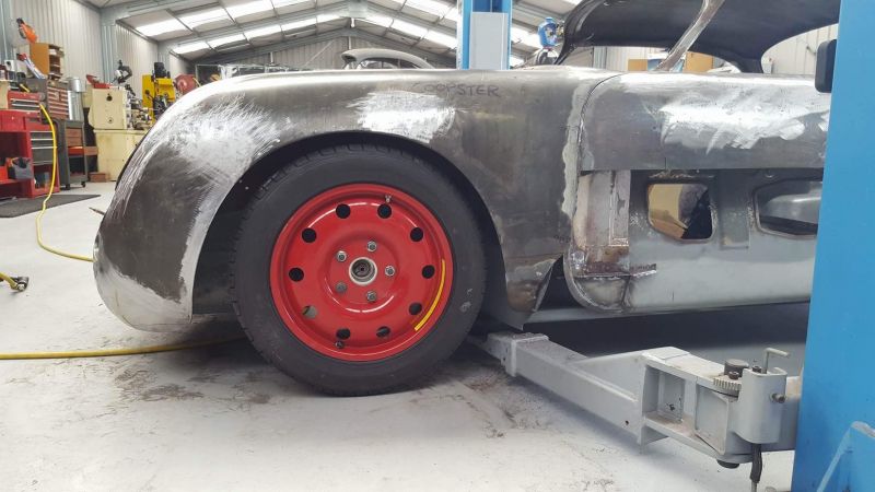

          Further photos, how to lower your front suspension

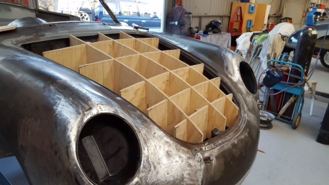

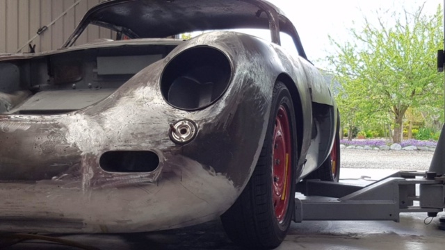

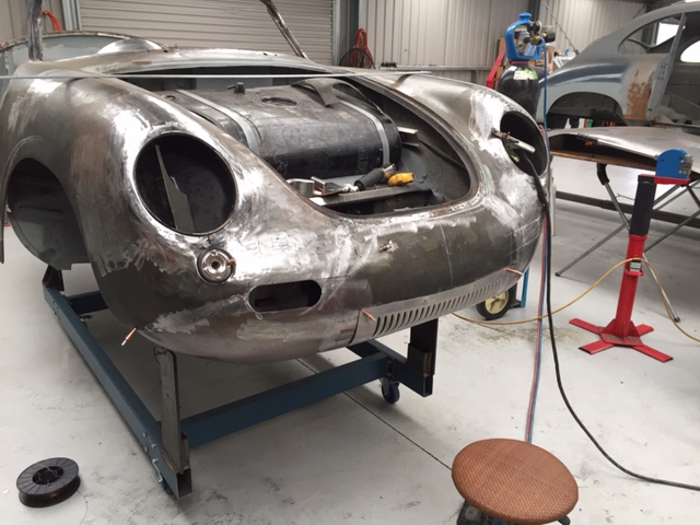

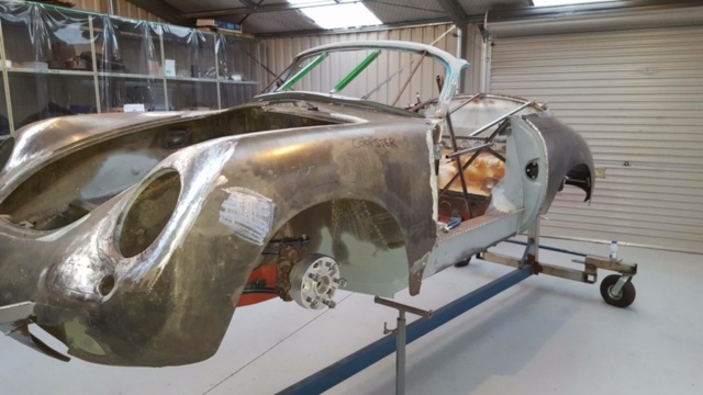

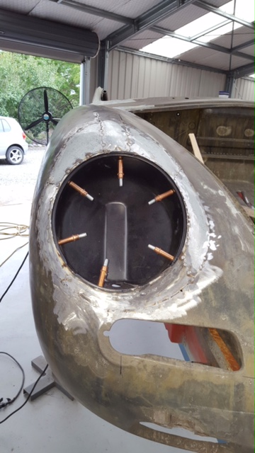

            Some of the front of the car, lights cut out and angled back and down.
            Flat hood yet to be built.

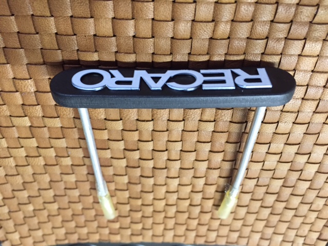

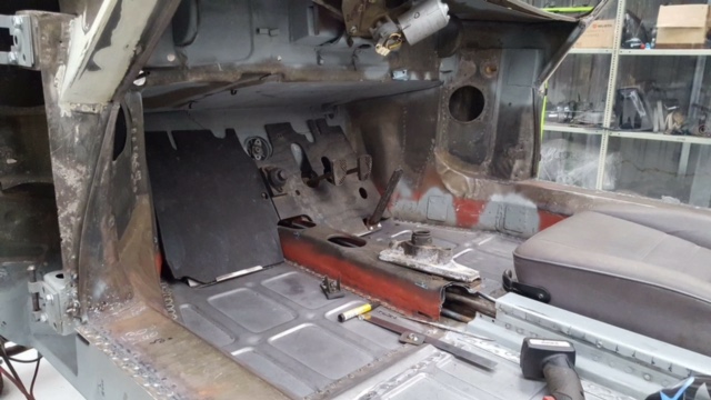

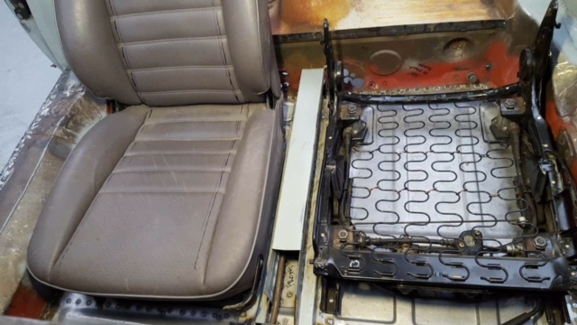

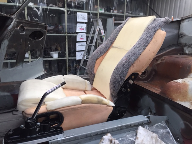

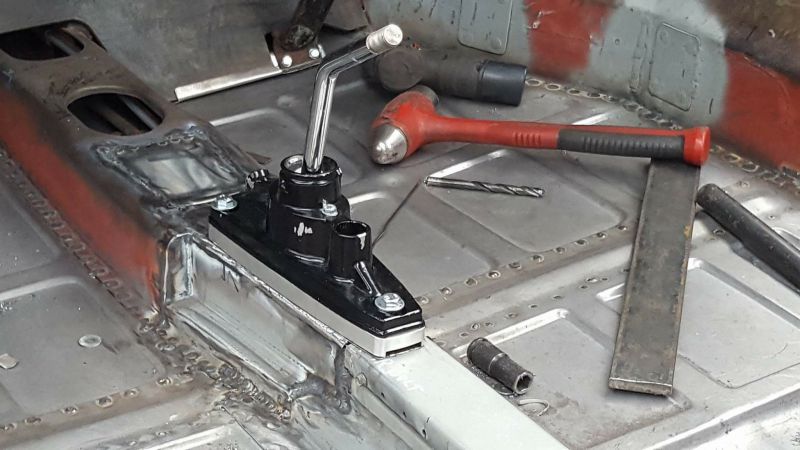

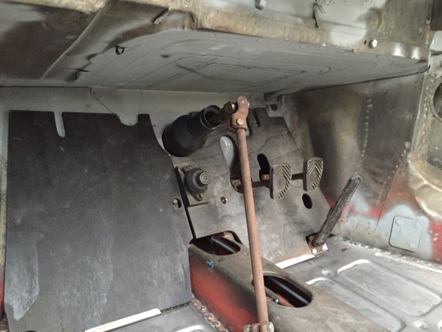

              Some interior photos. As we are chopping the hardtop by an inch and I'm 6'2" we have had to mount the seats onto the floor. This meant cutting the tunnel down, shaping 944 seats to an early 911 recaro seat, gear shifter moved back to a better position allowing for the above. You can see the rack and pinion steering through the front wheel well wall. Dash is hand built. SpinnyBeck leather the same as Singer Porsche going on the seats and interior.

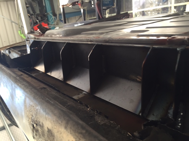

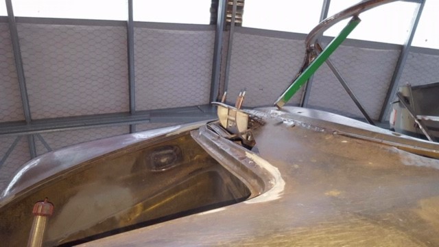

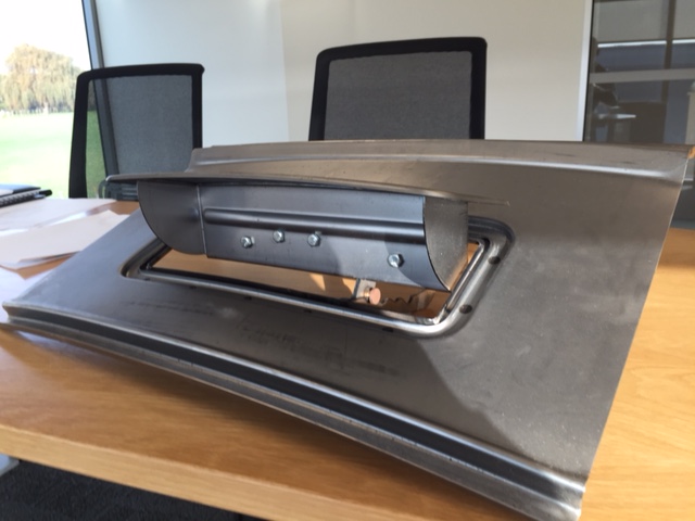

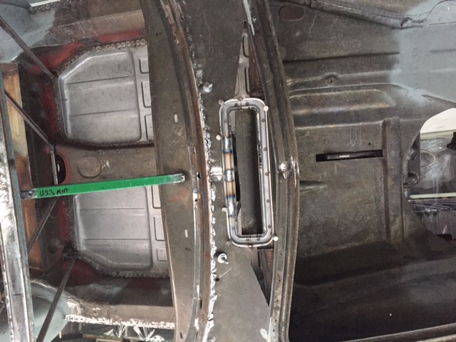

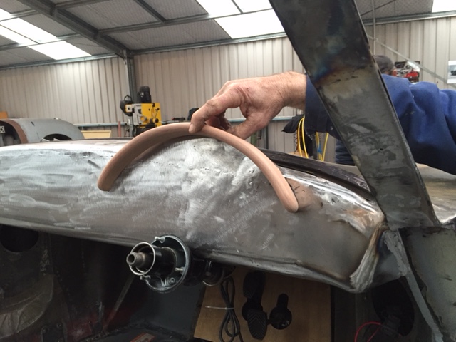

                Cute-down 57 Ford vent inserted in the cowl. Cool breeze on a hot day, this operated by a 12v actuator, hit the button it oops up or down.

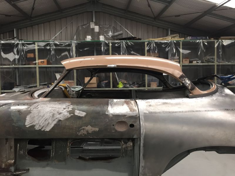

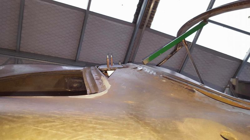

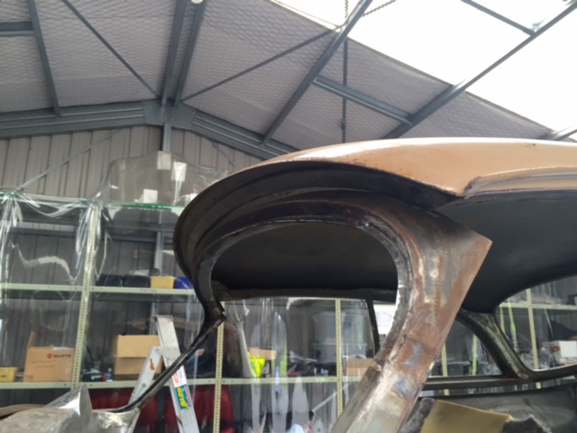

                  Chopping and shortening the hardtop, plus removing the drip rails.

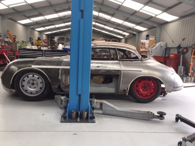

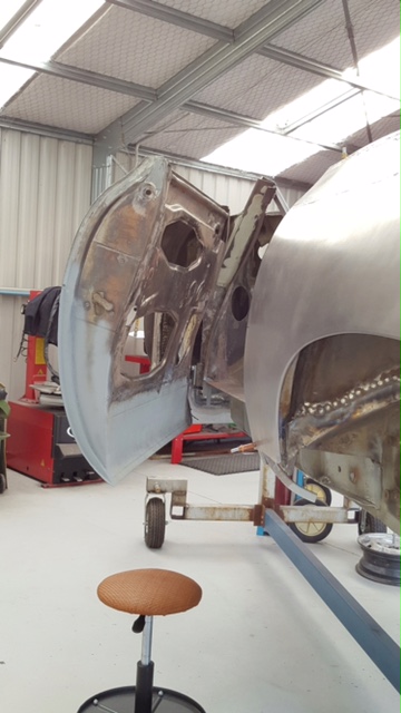

                    Rolled the doors to the rockers

                          And these....the windscreen is tilted back 12 degrees, the front cowl in lower an inch to take the hump out of it.

                            Hard top chop

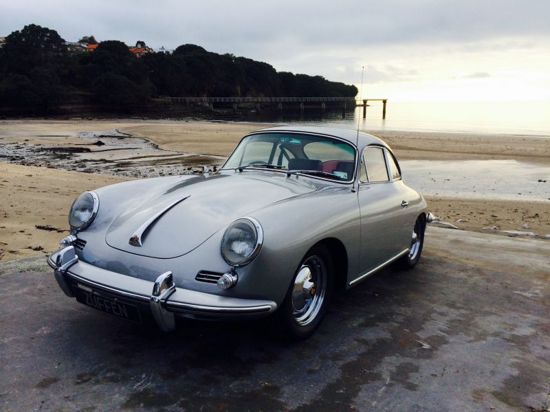

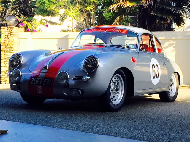

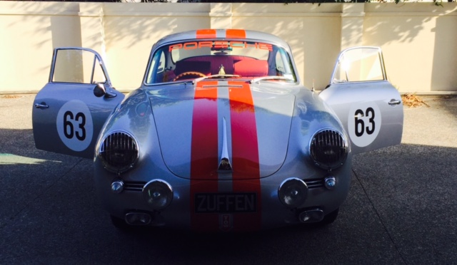

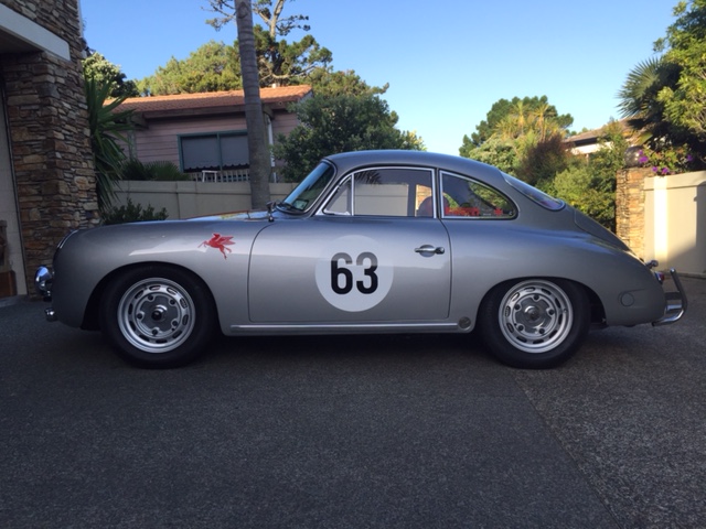

                              My other 356, a 356B T6. Mild Outlaw here, everything can be changed back to the original factory look within 24 hours.
