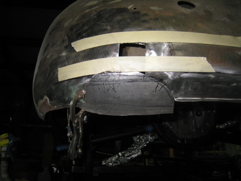

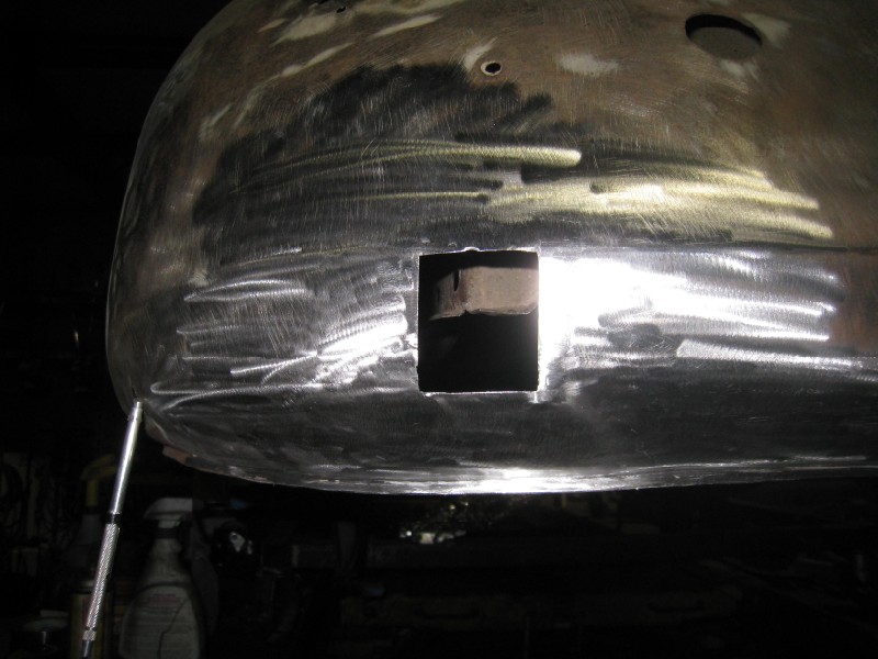

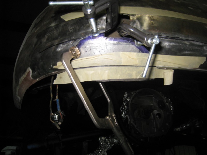

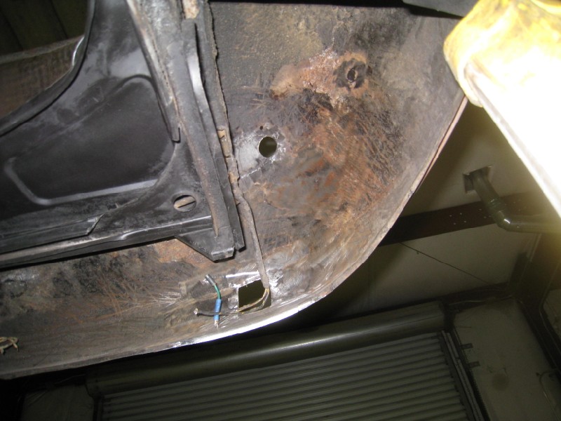

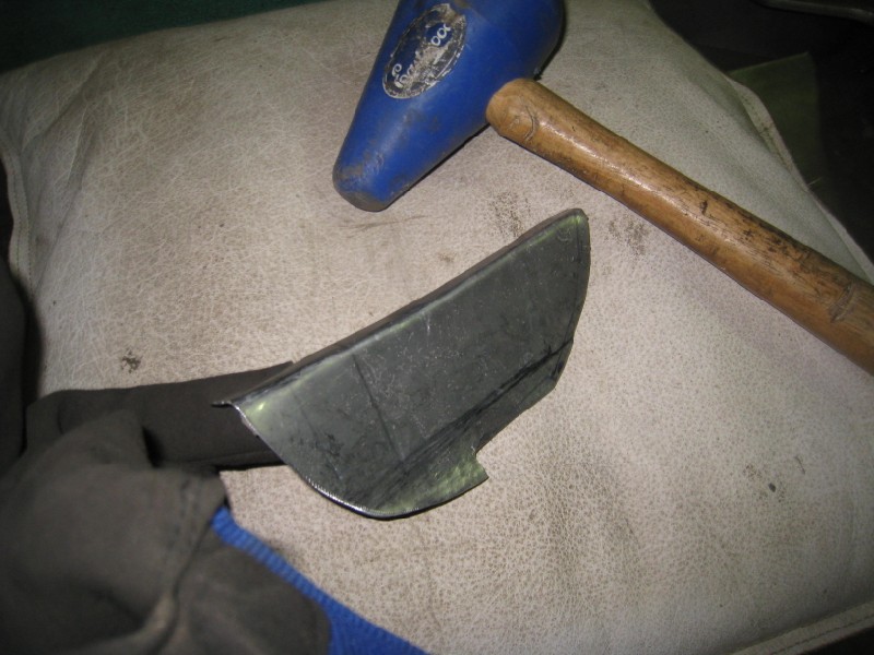

              I spent last Saturday working on the exhaust cutout that a PO did. This cutout was done over 20 years ago. I am guessing that the same person that installed the 912 motor did the cutout to make room for the stock 912 exhaust. Probably did it at the same time he hacked the two rear corners of the engine bay to make room for the muffler. Somewhere along the way, he decided to change to a two out sport muffler, but never made the repairs. Just as well, it would have been hacked. It is interesting, at least to me that all the mods done to this car were done over 20 years ago. I know this to be true since the last owner, who was gracious enough to sell to me, bought the car exactly like it sat, 20 years ago. I have the original Atlanta Journal classified ad, which he circled and saved from when he first saw the car.
              Anyhow, enough talk. Here are pics of the repair I did on the exhaust cut out. Next up, Beehive tail light restoration.

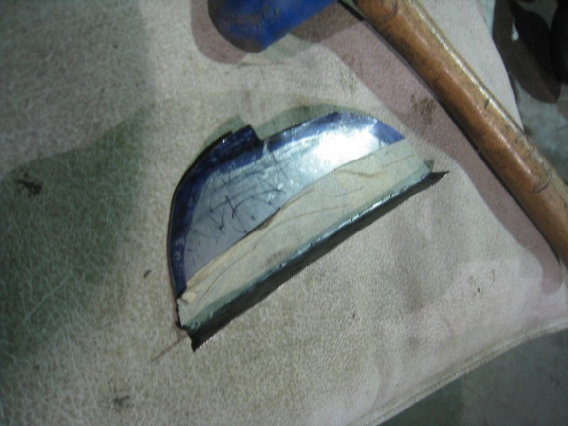

              First step was to make a pattern and rough cut some metal.

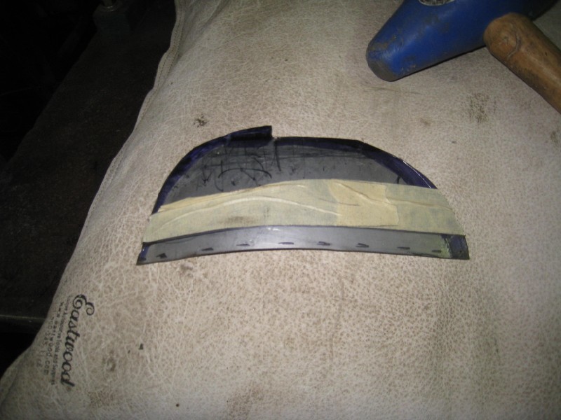

              I then took it to the English Wheel. I have a lot to learn about how this wheel works. Most important, keep your fingers out of the way. Learned that fast. This wheel is a real art. When you see guys use it, they make it look soooo easy. Not so. I got it to do what I wanted, but fortunately, my work was very simple. I have a long way to go before I will be knocking out fenders.

              In this pic you can see the shape beginning to take shape. After the wheel, I used the sand bag. On and off the car a few hundred times and the shape was close.

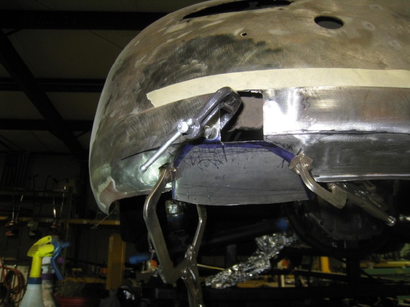

              After I got the shape close, I used some Dykem to mark out the edges in preparation for perfect fit.

              Once I got the piece fitted, I then had to fold the edge over to match the original. I used some take to create the line I wanted and then hand worked it.

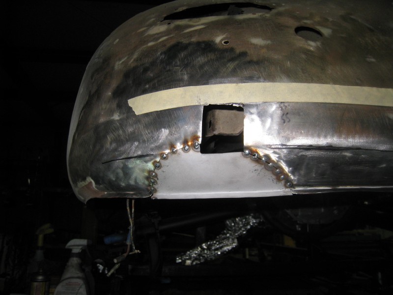

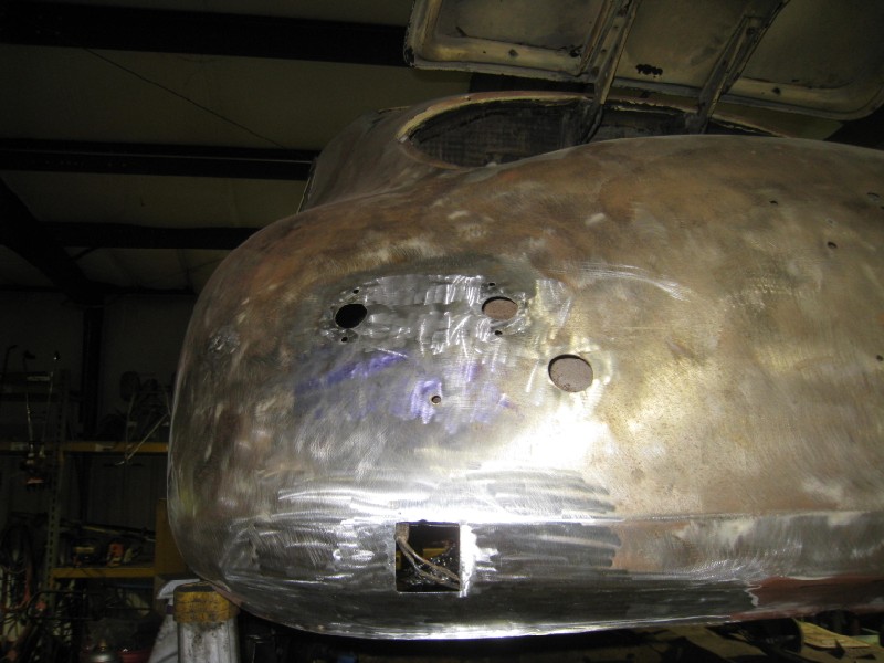

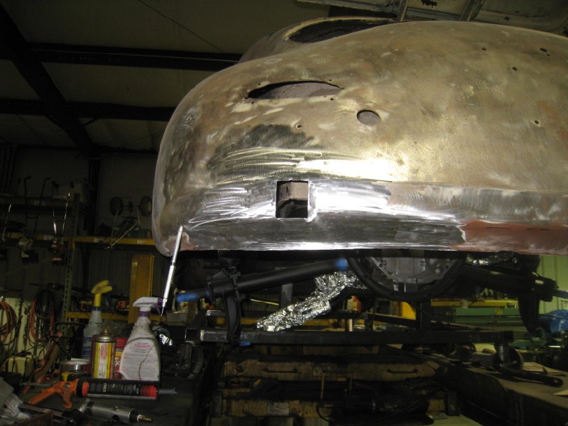

                Next up was actually welding the piece in place. This of course had to be done slowly to minimize any potential for warping. As I weld, I grind some of the welds and hammer and dolly the spots to help relieve any tension. Sometimes it works. This piece had so much curve to it that it did not seem to move much during the process. You will also notice that the sides of the opening are a little uneven. For some reason, the side I was working on was smaller than the one on the right, so I actually opened the hole up to match the right side so I was not worried about the inside opening. I guess when these cars were hand built, no one went around with a scale and compared right to left. I also had to line up the body lines in the piece. Hard to do because the lines are very subtle. There was over a 1/4" of bondo on this area and I am not sure why, it is in very good shape. I have not even hand worked the car yet. I also finished the back side so the repair is almost invisible. With some seam sealer and undercoat you will never know. Thanks for watching.

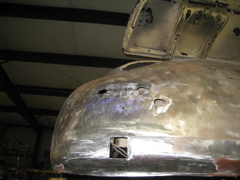

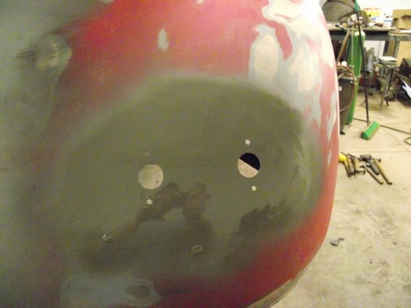

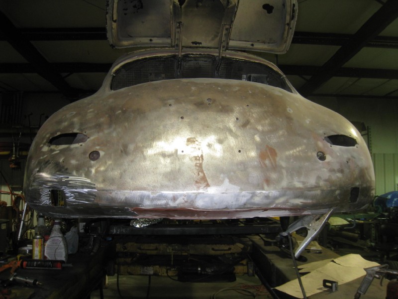

                              Here are a couple pics from the BH repair. One thing that is odd, the two inboard holes for the lights are not in line with each other, top to bottom. The strange thing is I do not see any evidence of other holes or patches. These were the original holes that were hiding behind the tear drop lights. Maybe the large hole is off. I have not fine tuned the light holes. I just hogged them out real quick with my carbide tipped bit. I did not have the lights with me for test fitting. Any help or ideas would be appreciated. Justin, can you tell me the diameter of the holes? I obviously have a good bit of hand work and finishing to do to this area. This repair was actually more difficult than I expected due to the compound curves involved.

                                Looks Great Mark! It all seems so familiar. You're exactly correct the outboard lights/holes are slightly kicked upward in realation to the inner tail lights. That is the subtle detail in the placement that the factory got right on. Also the very reason why most Beehive attempts without a guide look off or wierd.
                                Here is mine with the elevation clearly shown. Yours is right; no worries! As for the hole diameter go to the front of your car; the front turnsignal holes on a T1 will be exactly the same as the rears would be. Its going to be pretty tough to get perfectly round holes by filing. I tried it on my first attempt and was not happy at all; had to use a die-punch to get a clean job. You could make a template from your front holes and color the excess with a marker and rat tail file the colored area I suppose. Thats probably the way I would do it. I hope this helps! Great job on the patch! Great to see it going back to beehives!!! Justin
