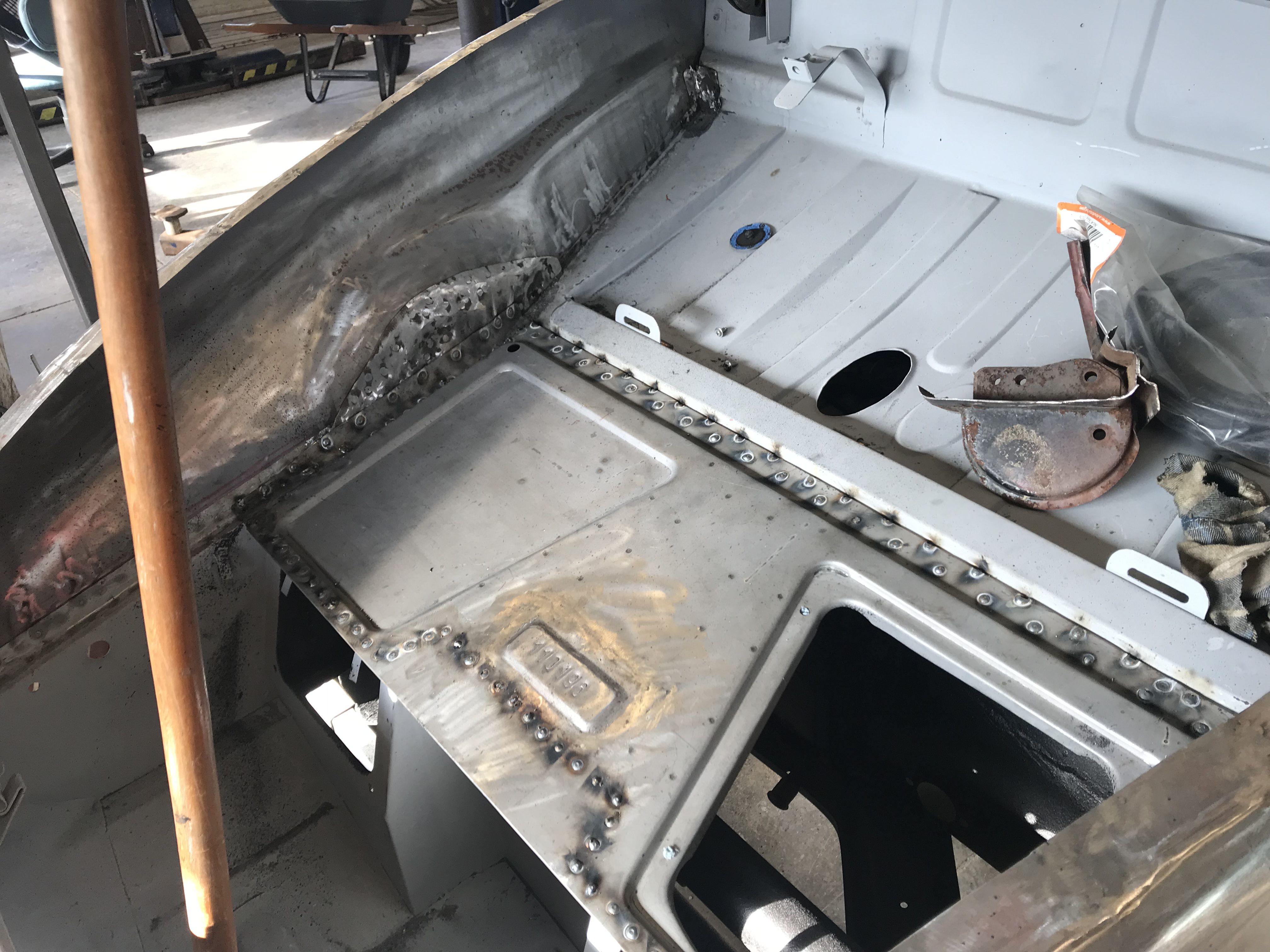

  • Think I should paint the inside of this cavity before I weld in the vin panel. I have epoxy coated but need to learn about finishes. What paint gets sprayed in this area and is it later coated with gravel guard. Any guidance on what is required and colours would be appreciated. ? ?

        Hi Scott, Sorry for the late response. Get is all behind a good coat of sealer then follow the area up with nice coat of semi-gloss black. Now is definitely the time to paint this cavity it while you've got a clearer shot at it before adding in the trunk floor. Justin

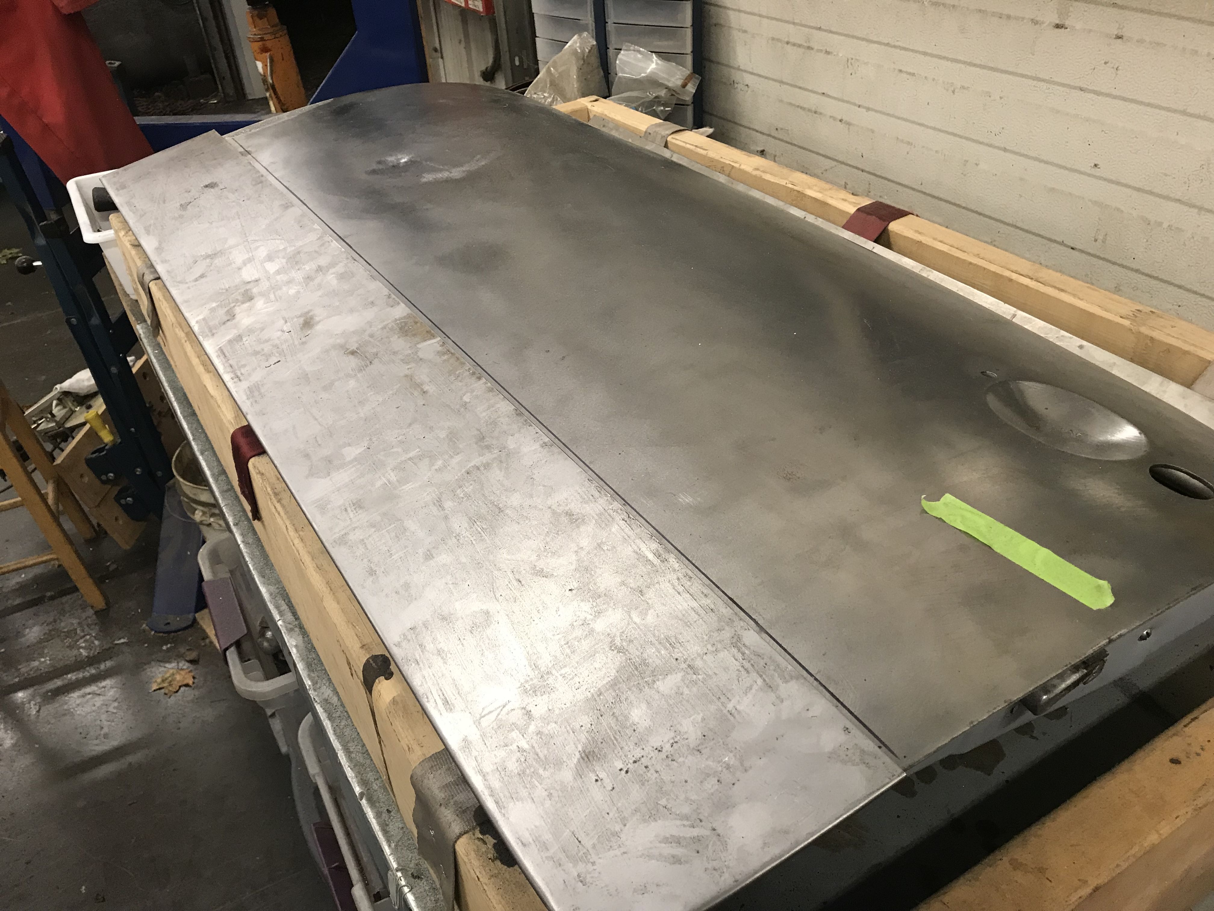

              • Slowly sneaking up on door skin fit. Made a metal buck to shape the front corner Click image for larger version
ID:	107086 Click image for larger version
ID:	107087 Click image for larger version
                the slight crimping along the edge to form a ledge for the new skin should provide a good base for welding.

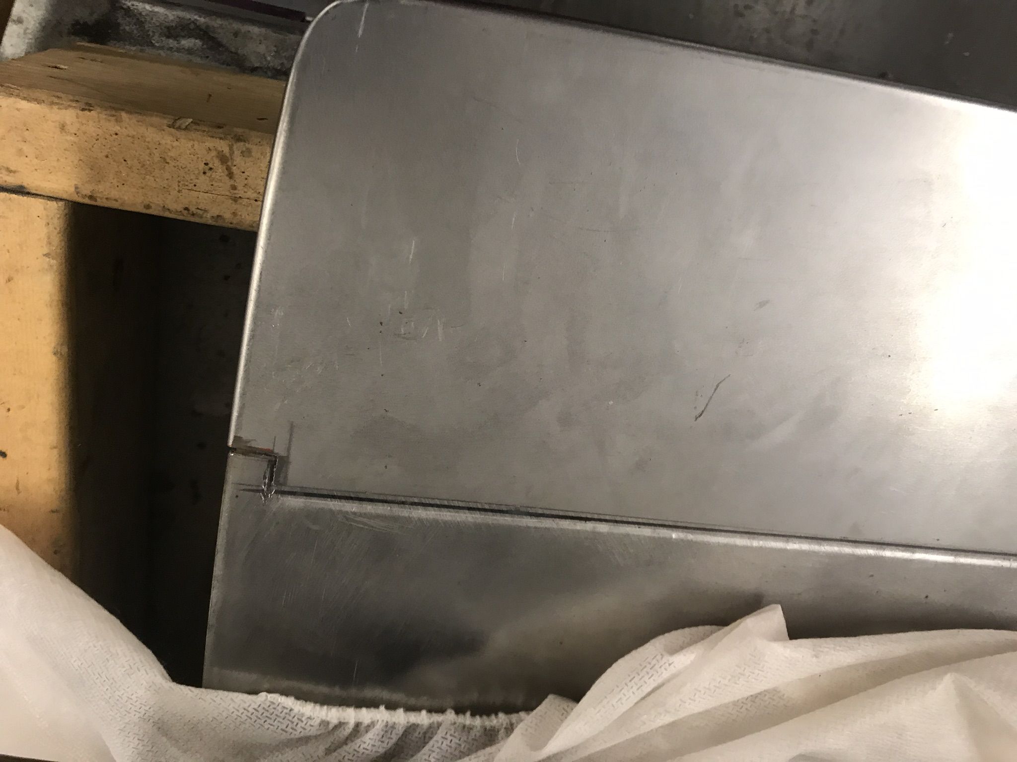

                • Tried a scape piece to test buck for shaping the edge. The front corner is odd. It starts with just an 90 degree bend following along the vertical leading edge of the door the transitions to a full fold over along the base of the door. Click image for larger version
ID:	107090 Click image for larger version
ID:	107091 Click image for larger version
                  also drilled led out the welds on the front rocker so I can pull it out a quarter inch to line up with the door which is a little proud when aligned with rocker.

                  • Anyone have any pictures of how this section of the inner front fender panel and top shakehands and come together? Click image for larger version

                    • Your missing a flange section on that rear vertical wall where that seal channel is. Here are some shots I took when I dealt with this area:
                      First two are factory.
ID:	107154 Click image for larger version
                      The need to lap each other for the joint. Again yours is missing the flange next to that seal channel section.
                      More details here:
                      Hope this helped.
                      • Thanks Justin for the images. I had previously made the flange along the seal ledge so roughly positioned. I recal that I had wanted to wait to put it in later but before I had welded in the inner trunk panels - unfortunately they are welded in now.

                          Yes, under the splash shield. So reverse of the way you are showing it above.
