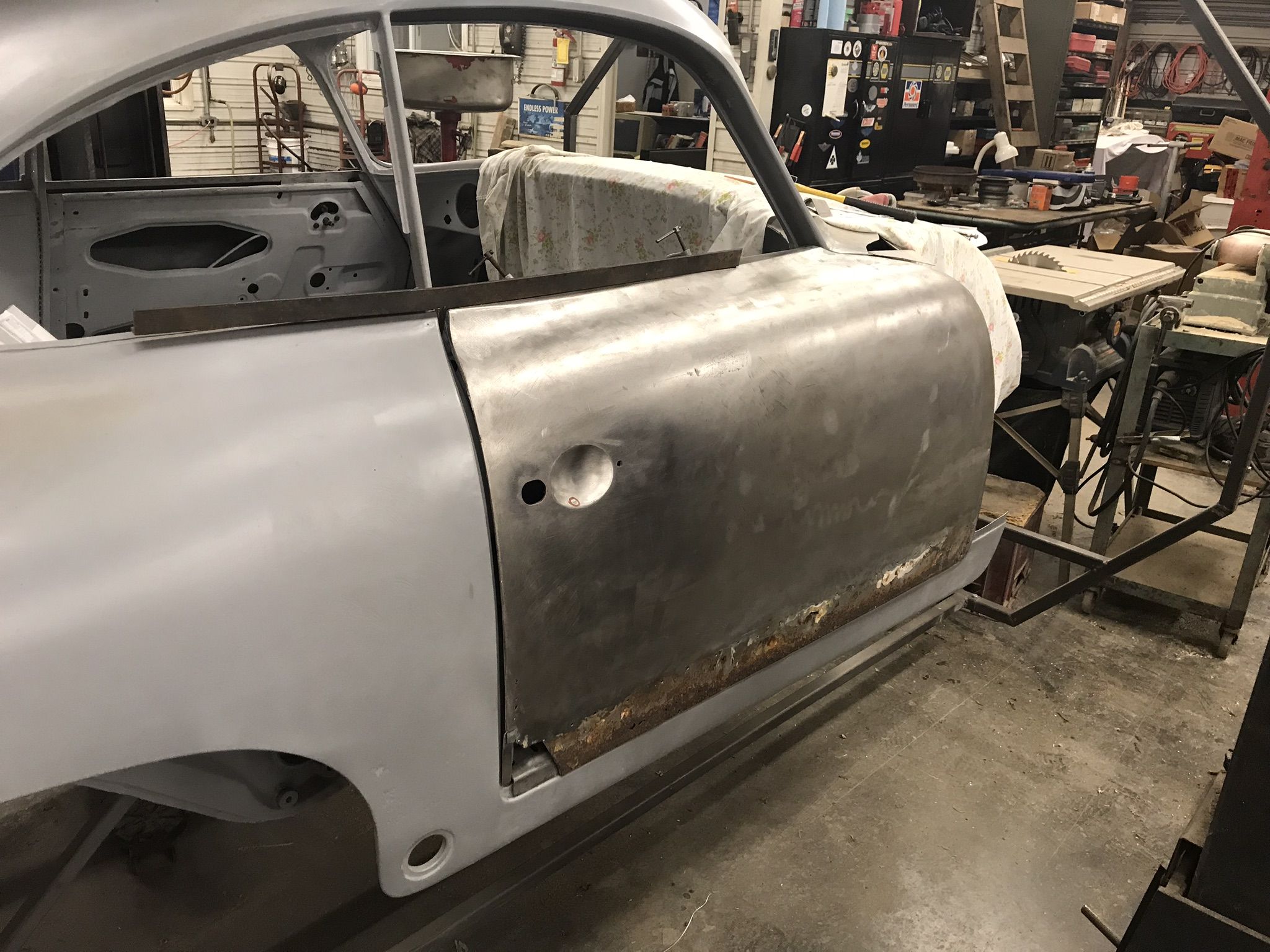

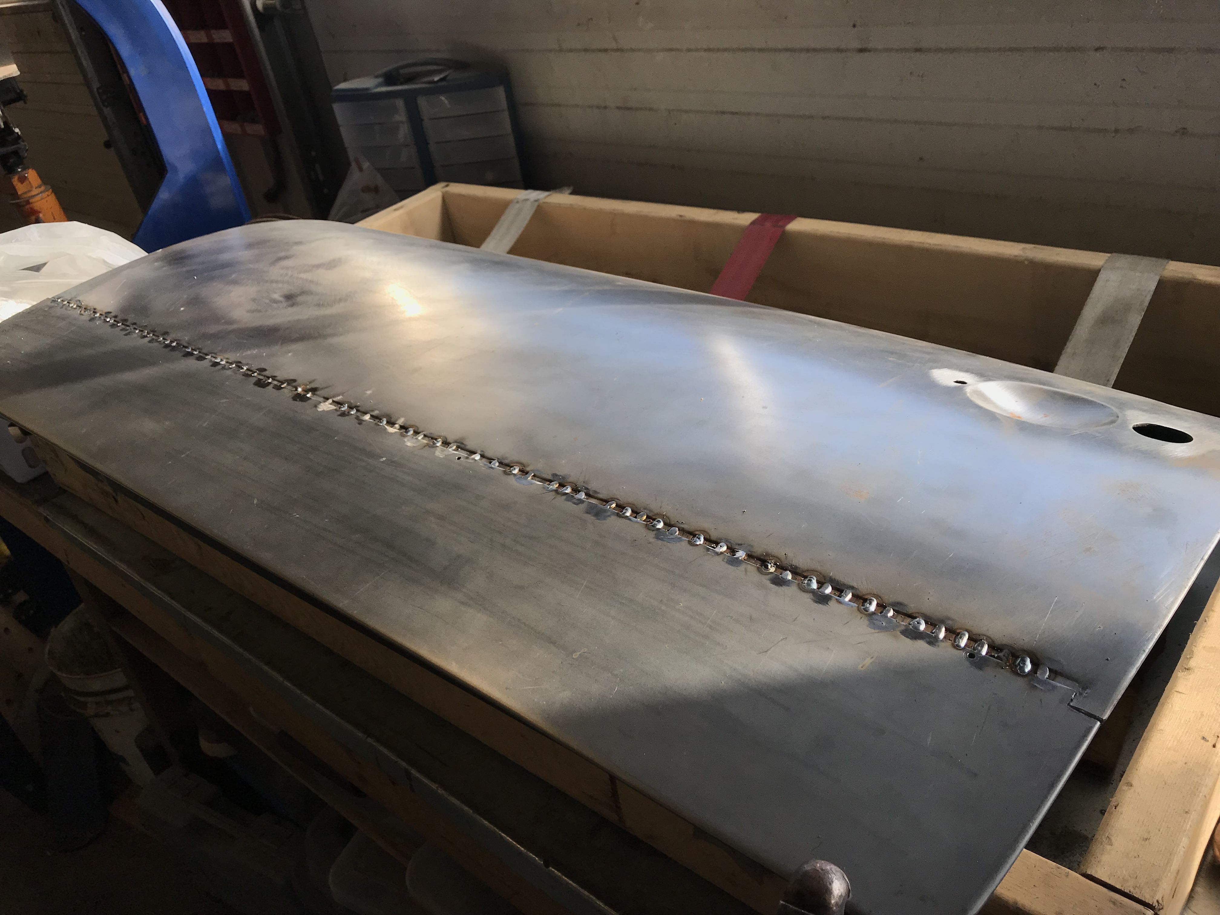

      • Bottom door skin all fitted and set with clecos. Ready to burn. Slow process one little tack at a time and an air hose to spray air to cool as I go for each weld. Click image for larger version
