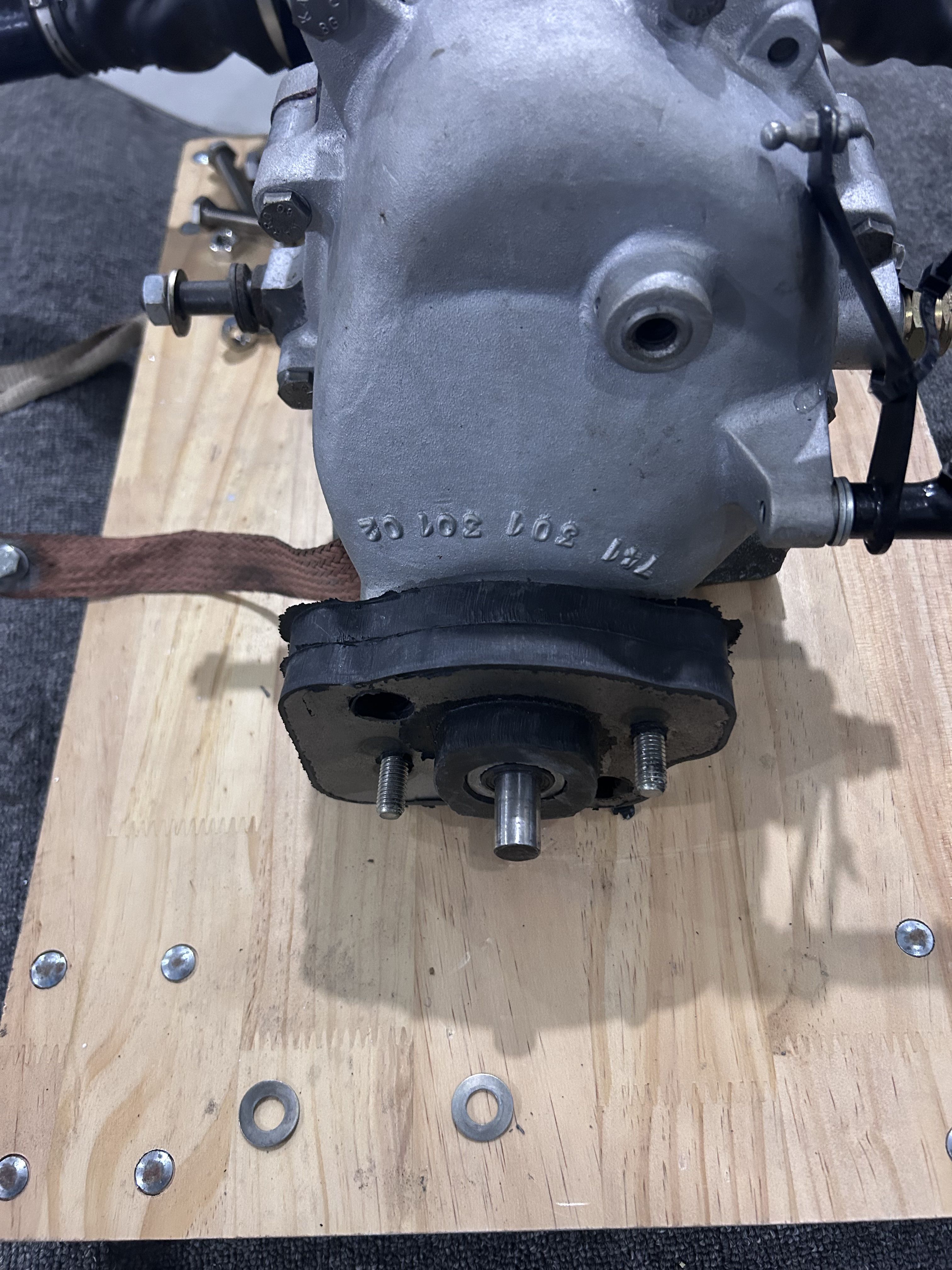

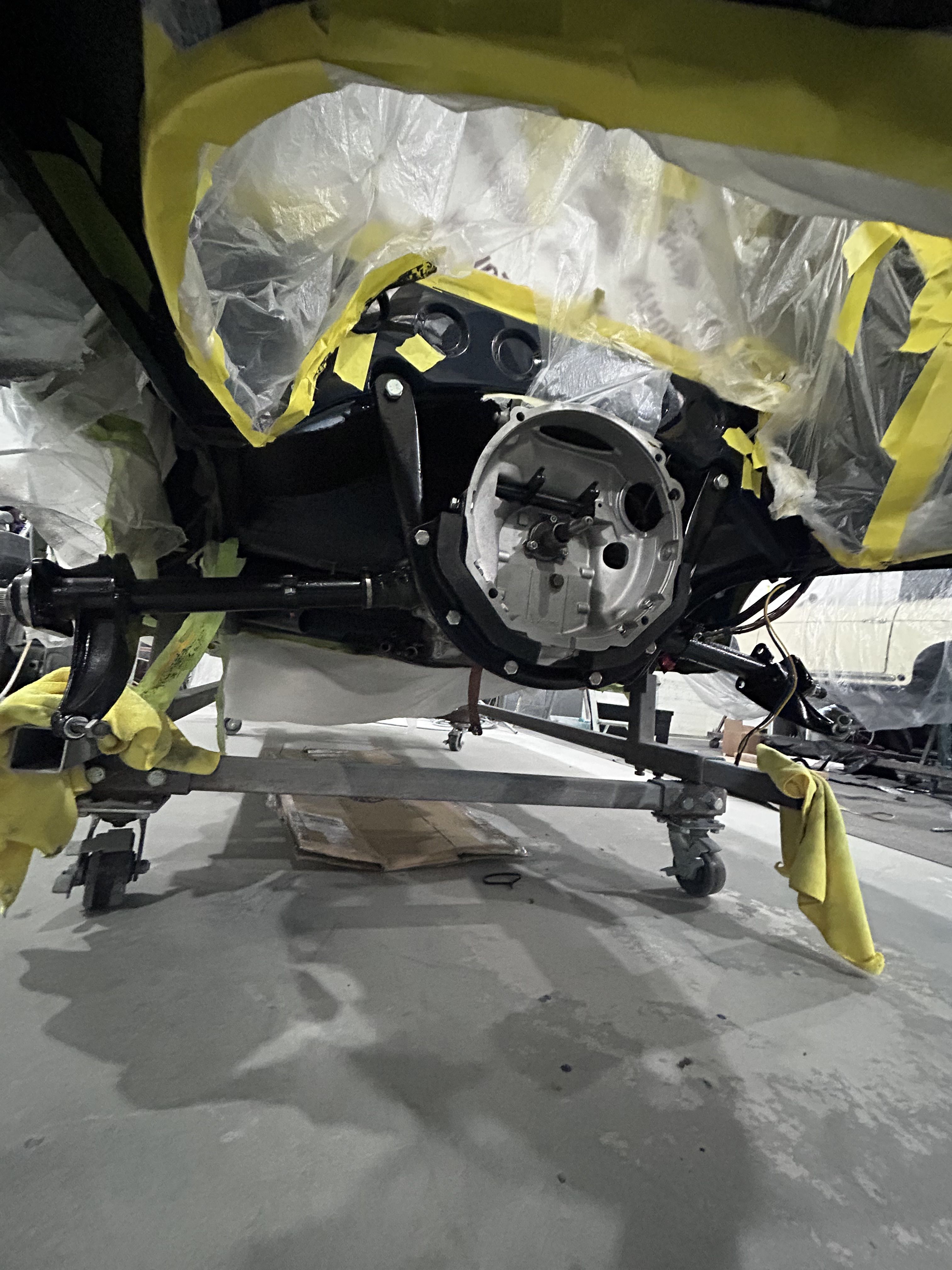

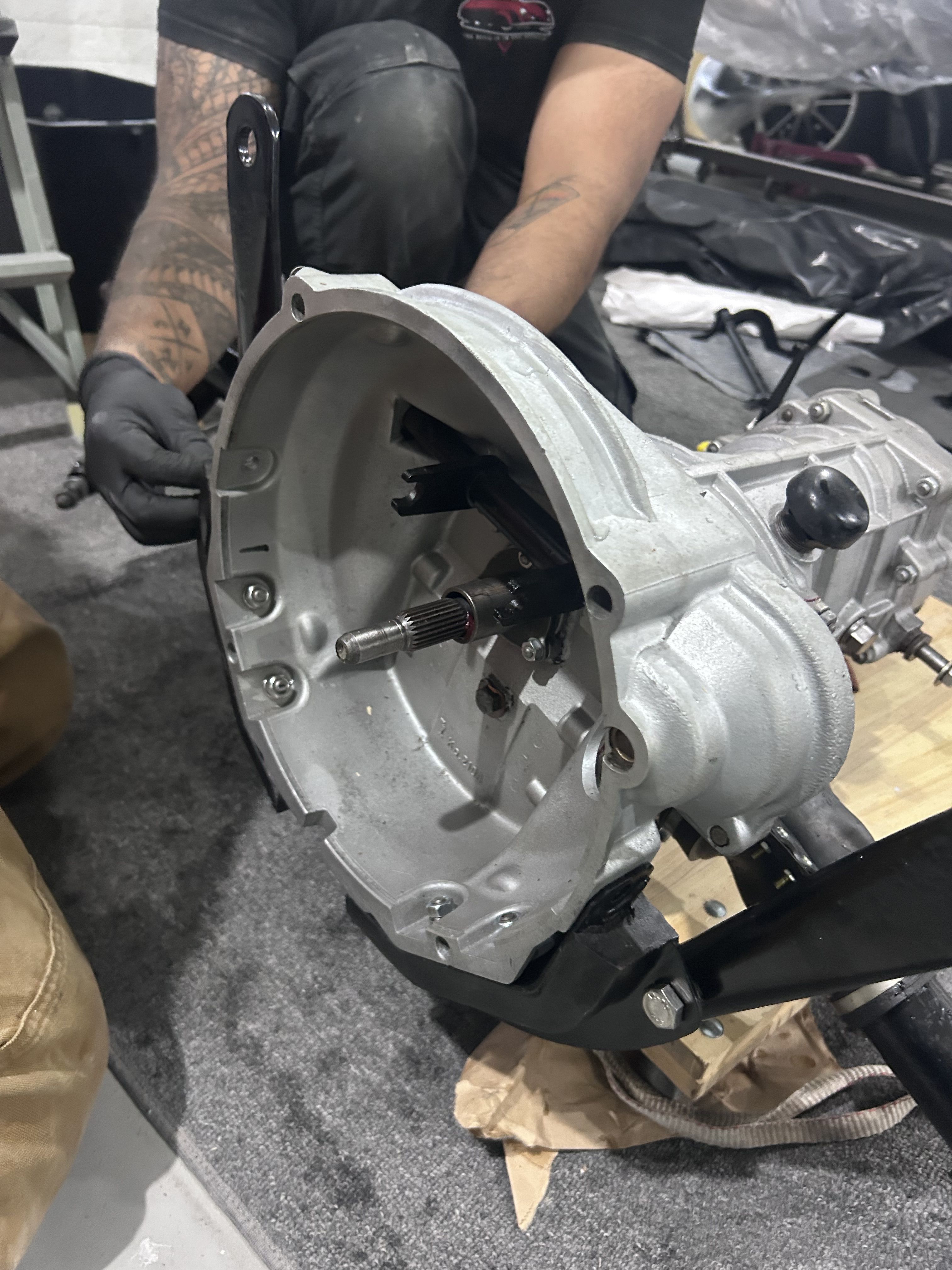

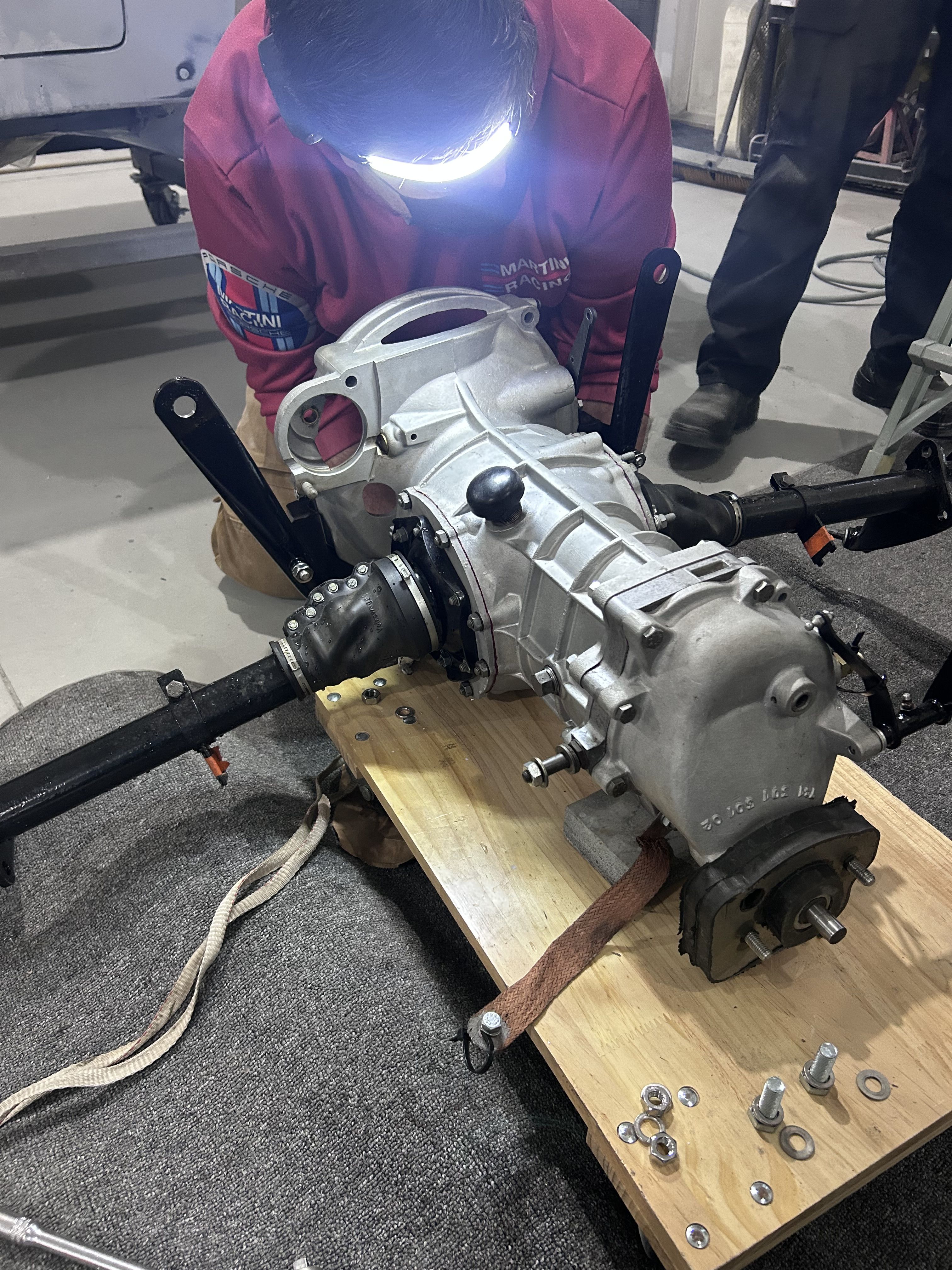

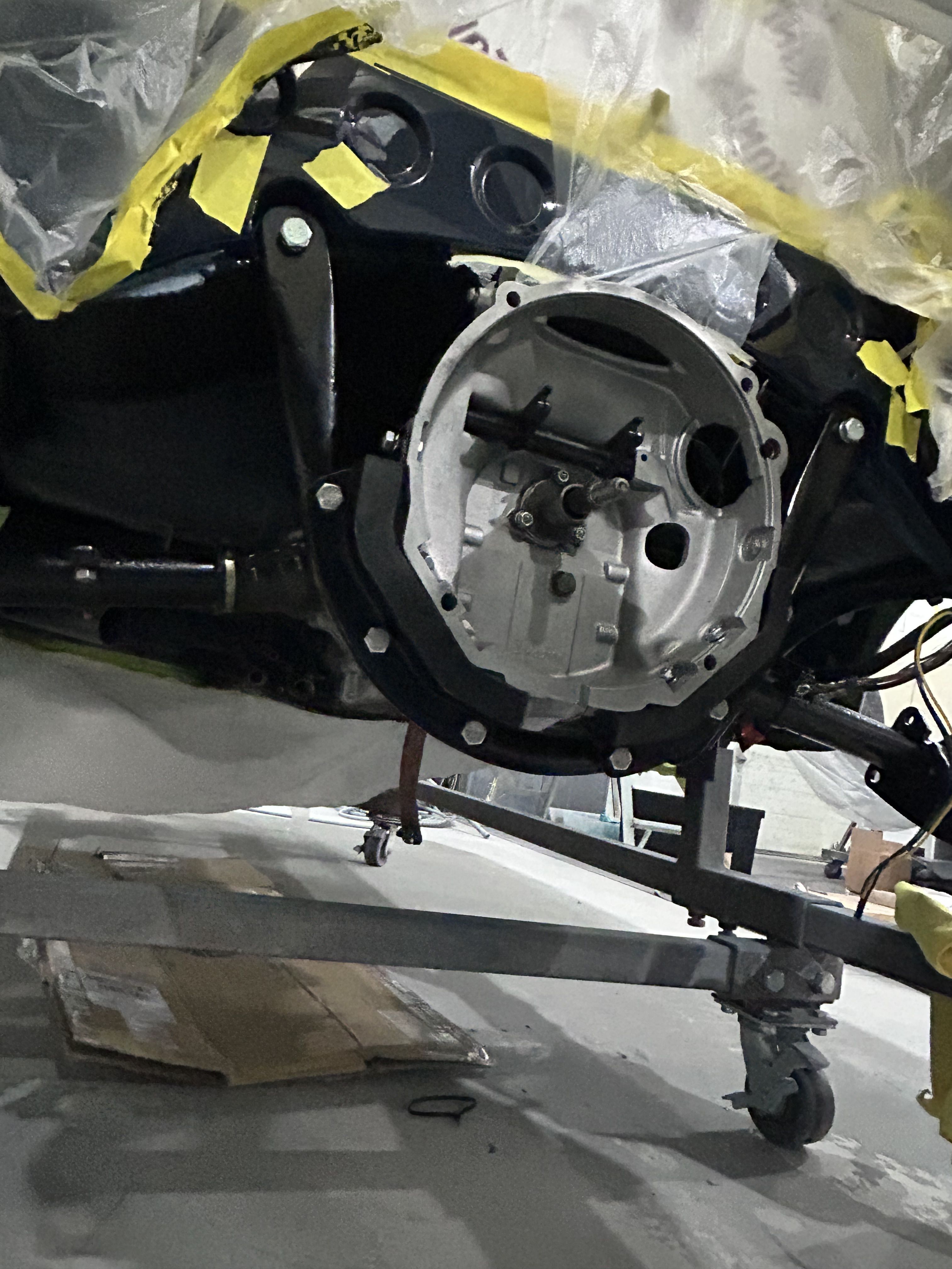

    356 Registry main thread;
    • Installed refurbished numbers matching transmission. https://www.facebook.com/share/r/18d...ibextid=wwXIfr Click image for larger version
ID:	117271 Click image for larger version
ID:	117272 Click image for larger version
ID:	117273 Click image for larger version
ID:	117274 Click image for larger version
