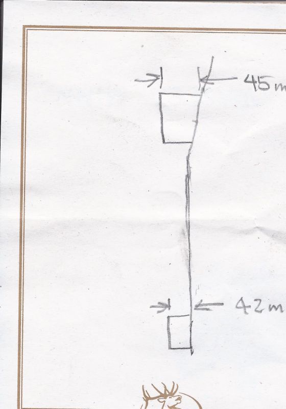

      I measured my 63 T6B Reutter body and made a sketch.

      Hope this is what you were looking for. I would make an offer on the part(s) above.

                Hi John,
                I'm late to read your thread, but I'm excited to have another project on here. Congrats on your find. My T6C is also on this forum, so feel free to ask for help if you need anything. Much of my five plus year project is on the 356registry forum. This link may work.
                http://porsche356registry.org/356talk/4/20893.html
                I measured my hinge mounts according to Phil's drawing and got 43mm and 54mm for the top one. Uh oh, we aren't even close on the top hinge. I hope he transposed the numbers mistakenly. Please let me know, my car was made by Karmann.

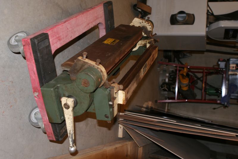

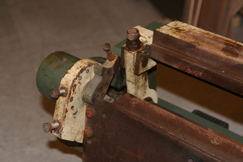

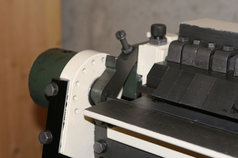

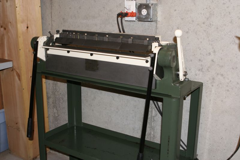

                  I found a 24" Diacro finger brake locally at a good price as it needed a restoration. It's going to be put to good use making parts to redo Bubba's attempts at welding

                  Before.

                  Before.

                  After derusting, sanding and painting.

                  • #54
                    Excellent restore. Nothing better then well made tools.
                    • #55

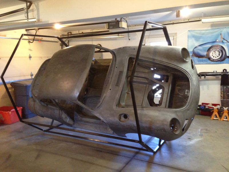

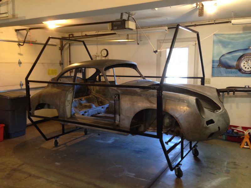

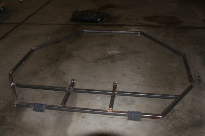

                          Anyway....on to better things. I spent some time finishing the hoop rotisserie. It's going to be quite useful working on the bottom of the car. No more sitting/laying on cold concrete. It was a prime opportunity to improve my welding skills too I ended up attaching the front to the lower torsion bar with a "U" of 3/8" threaded rod. The rear is attached to the tranny mounts. Everything is nice and level....well as much as possible for a 50 year old car

                          Completed front hoop before paint.

                          Completed rear hoop.

                          Complete.

                          Action shot. Very easy to turn over and get to the bottom.
                          • #58
                            Cool frame and brake, you are off to a great start! Enjoy the journey no matter how long it takes.
                            • #59
                              Nice work on that cage John! Life is so much better with the ability to roll the body over. Looking forward to your continued progress! Justin
