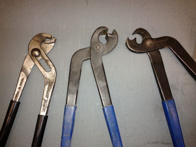

        • I'm trying to catch up on all the sections and threads here on Justin's great site, to learn and share what I've already learned myself....perhaps to find there are better ways to resurrect old Porsches.
          Tom posted: "Disregard the pliers in the picture, They didn't do most of the work. Instead, very careful prying was done to prevent distortion on the top side of the skin."
          Most guys who do this kind of work as a serious hobby or a vocation find or make things (devices and tools) as needed. Usually, it's Continuing Education courses in the School of Hard Knox. Here are the modified and found de-crimpers I use. The blue handled are the same, from Eastwood, just narrow and wide jaws for straight or radius unfolding. They have a gradual angle that cannot make the 90* needed for a lid delamination with mono-direction SQUEEZING, so I made the other tool to push the return up WITHOUT prying, for as Tom says, I learned the hard way that prying of any sort raises the other side of the crimp and makes the refold very vulnerable if any grinding or filing is needed. The added work-hardening can also cause splits, especially when hammering back into a fold, so it's wise to anneal that fold before and during any work like this. Don't get it too hot, not even too blue, just too warm to touch, both unfolding and refolding.
          Bruce Baker

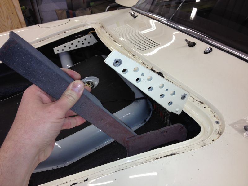

                I'm new here, so maybe it's been covered, but if the inner frame is badly buckled, the out skin will be stretched as well. Shrinking and shaping that while accessible is to be remembered prior to rejoining.
                The hinges should be checked along with the 'pods' in which they mount. Tearing will mess with the symmetry, symmetry controls the lock/unlock function of that (imperfect) design, so I made a tool out of scrap that checks and can readjust the angle needed.

                    • Thanks all, good idea Bruce to check the hinges first. I'm having some trouble getting my hood to line up in the left/right direction although it's getting better. I hate to rely on the seals for that.
