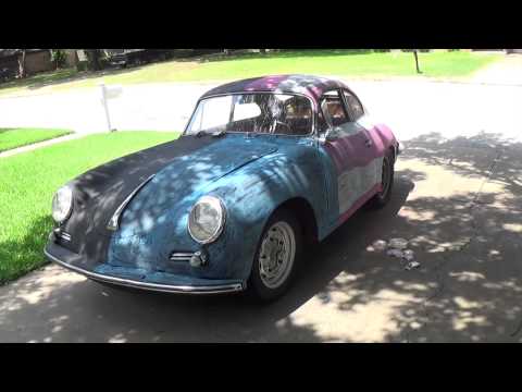

                Tony you are my hero, love the attitude. They look so cool in Matt black. I don't think I have the guts to go too far from stock, I love what you've done and how you are going about connecting with the car. Good on you mate!
                • #53
                  Somehow I lost track of this car & just re-read the whole thread. Awesome job & excellent car! Chalkboard paint is definitely cool. Saw a vw bus like that once.
                  For someone who didn't know much about 356s you sure dive right in on any project it needs. My hat is off to ya. Keep up the great work & vision.
