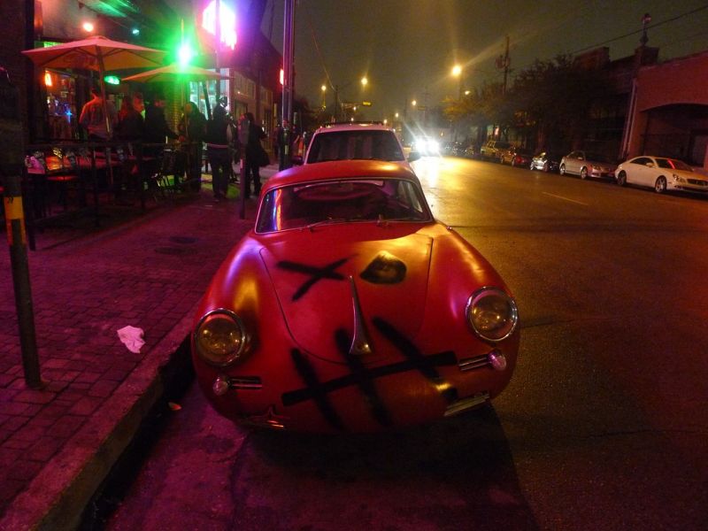

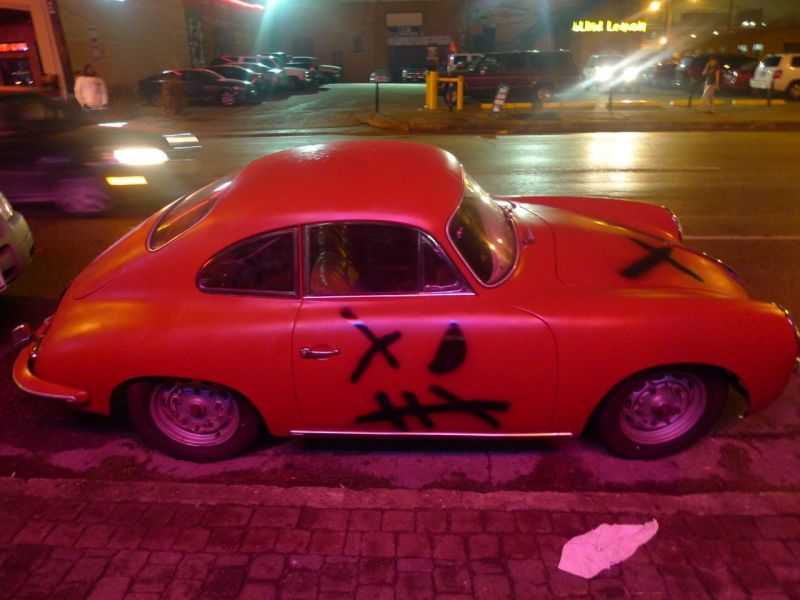

        I may lose some respect here, but I spray painted the car red with my band's logo to coincide with my band's new album release.
        I think it looks ok, although I'm not a fan of red cars.

          Cool Tony! You won't lose any fans, its only paint. Post a photo of your album cover so we have some context. Good luck with it BTW!

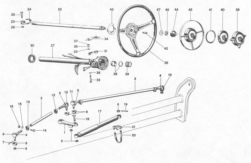

            For the horn, is there supposed to be a spring in there?
            Mine just has a rotted piece of rubber, but I see on sierramadre's website, they sell a spring as well.
              Tony, I'll post an exploded view of the steering column from my parts book tomorrow. It will show you everything thats in there... Justin

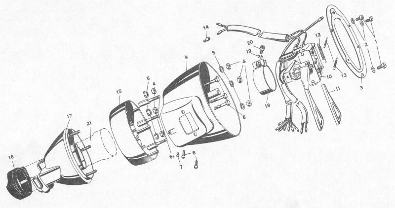

                  Would you happen to have a diagram of the blinker switch??? Cleaning the switch didn't get the left blinker working.

                    Here you go Tony, an exploded view of all the components that comprise your steering column.

                    Part #29 is the tension spring I think you were referring to.
                    Hope this helps! Justin
                      ahh very cool.
                      I think that was still there, I just need #44.
                      Ordered that a few days ago, maybe it will come in today.
                      Thanks once again Justin!!
