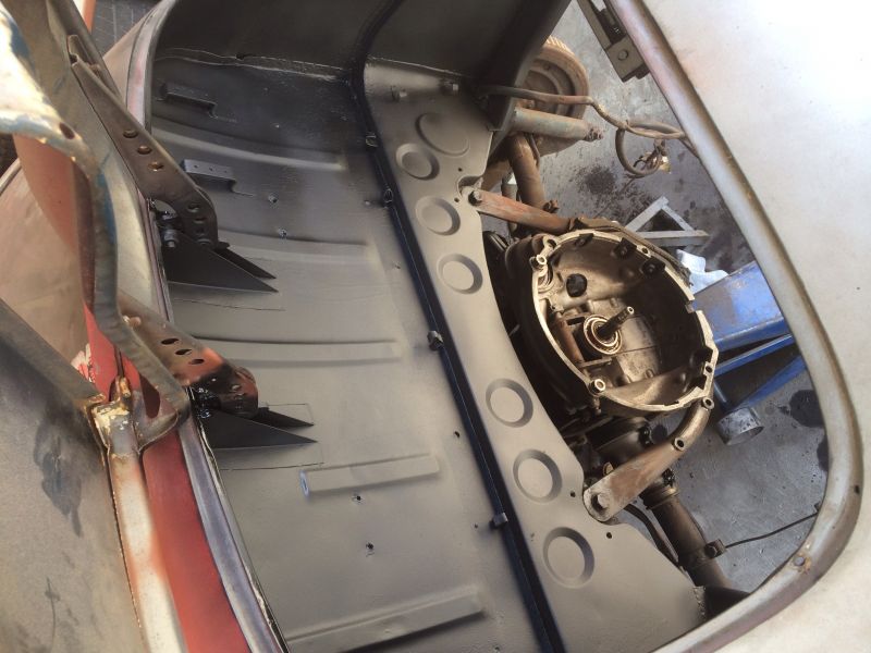

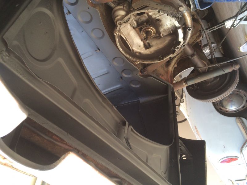

      So I pulled the motor out to clean it up as well as the engine compartment and address the bad tranny mount.
      I used a wire brush and sand paper on the rust in the engine compartment, then applied some Napa/Permatex rust converter. Afterwards, applied some seam sealer then I primed and painted it black, but then decided to apply some rubberized coating.

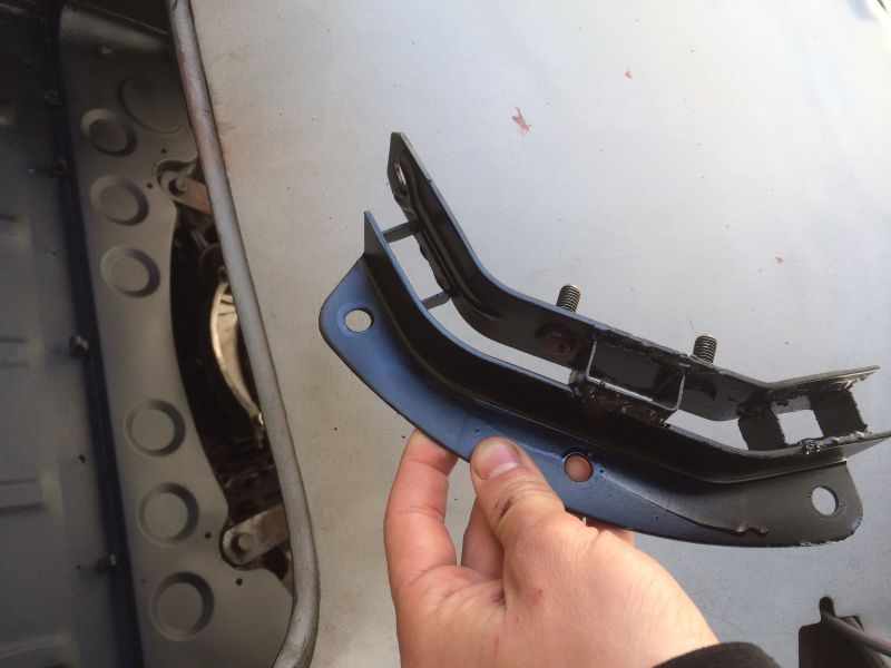

      The rubber on the drivers side trans mount was completely ripped apart. I cleaned it up and welded in some square tubing. I'm hoping that will not cause too much stress on the trans. It still has one rubber mount so it can flex some.

      I cleaned up underneath the car some as well, in the rear.

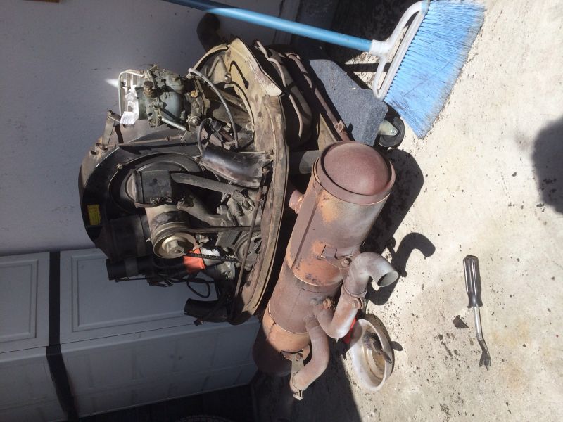

      And here is a pic if the motor just for fun.

          Looks nice. Here are the mounts you need. I wouldn't take a chance on cracking the housing.

              Glad to see you back on it! A lot of race cars go solid trans and motor mounts for performance but there is a trade off. The original rubber mounts insulate and dampen engine vibration and noise from transferring through the car and into the cabin. What your going to notice with your stand-in repair is that the car will sound a lot more noisy and feel rougher than it did before. I know money gets tight but your piece of mind and a more enjoyable driving experience is a worthy investment. Engine compartment looks good! The VW powerplant would make for a killer upgrade. Justin

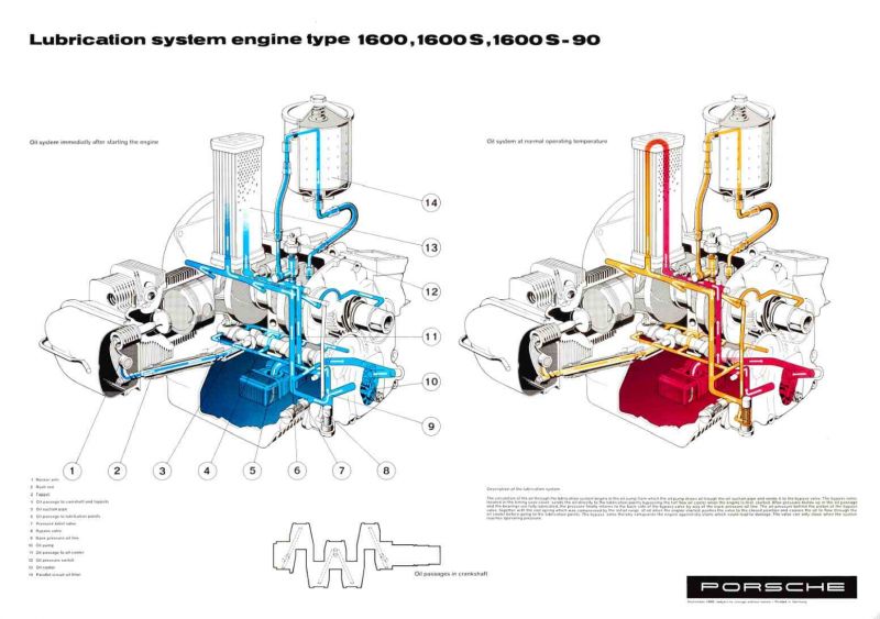

                  Tony,
                  Look at the picture and you see how cold/warm oil travel thru engine.
                  Oil in on top/side of oilfilter and then thru filter.... I hope it helps you some

                    Thanks,
                    I don't see how the oil is supposed to go through the filter and into the tube that goes down and out of the bottom of the canister.
                    The lid bolts into the top of the tube so I can't figure out where the oil is supposed to enter the tube.

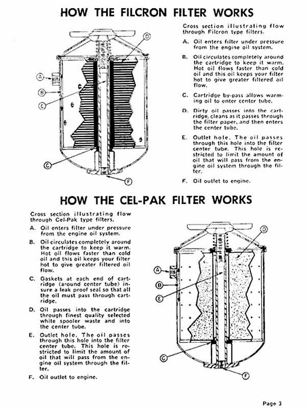

                      Look at this picture and read the text.
                      Could you inspect inside the canister for cleaness and also on the middle tube for inlets!
                      Also you might what to check your oil lines....if they are way old it might be time to change them.
                      If you remove the lower oil line and inspect and maybe just blow some air true it to check passage
                      I have never encountered your "stop" of oilflow before...

                        Ahh there is a tiny hole in the center shaft that I found, thanks to the diagram there.
                        I blew out the tube and replaced the rubber oring with a paper gasket that came with a new filter and it no longer leaks oil.
