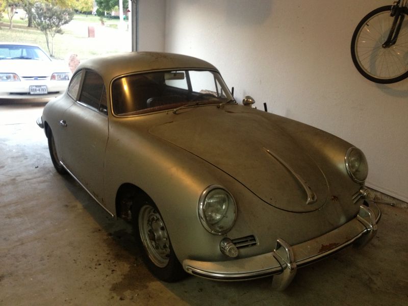

    I always wanted a 356 since my parents had one when I was 5 or 6. I finally got one, a 1960 356b #110270. A T5, just like theirs.
    I saw it on eBay and didn't win the auction, but I ended up getting the car. It looked good, normal rust, but the previous owner dousched the fuel system, put new brake lines and wheel cylinders as well as new tires on it.
    I drove it back to Dallas!

    Here it is parked next to it's brother, the ghia.
    I can't really afford the car, but I'm going to try and keep it a little while and fix somethings before I have to sell it.
    I would like to prime it and lower it pretty quickly, because I love that look.

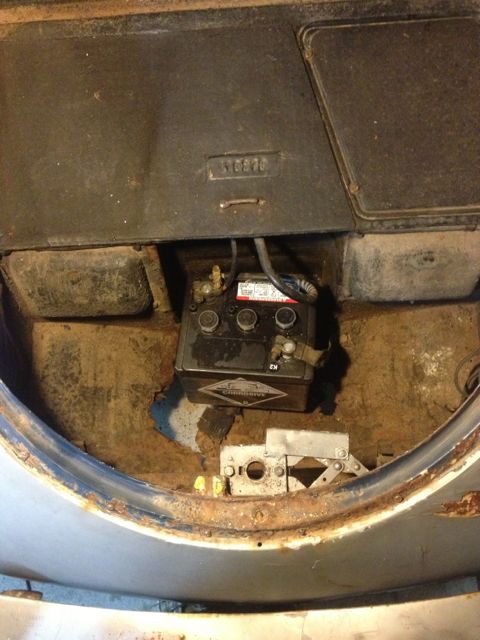

                Instead I think I will just spot weld patches in where needed without altering anything. This will keep the battery from falling out etc.., and be easily removable when the next owner or myself is ready to make it look factory.
                I suppose I will cut back to where the metal is good then shoot it with self-etching primer, cut a patch that overlaps a half inch and put a few spot welds in. Then some seam sealer and some primer?
                  Hey Tony,
                  If your plan is for temporary patches to keep the battery from falling out etc. Just keep the "ease of removal" as the most important rule when installing your repairs. Ed Hyman made a good observation on the structure around your front suspension. He thinks it might be to rusty and weak to be safe. Do you have any detailed pics around the torsion tube areas so we can see how rusty you might be? Justin

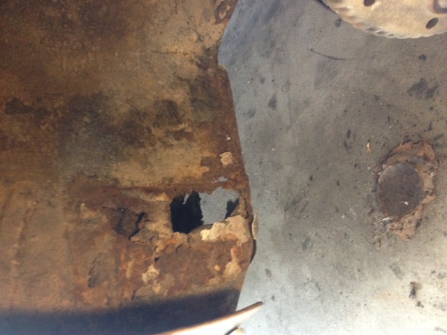

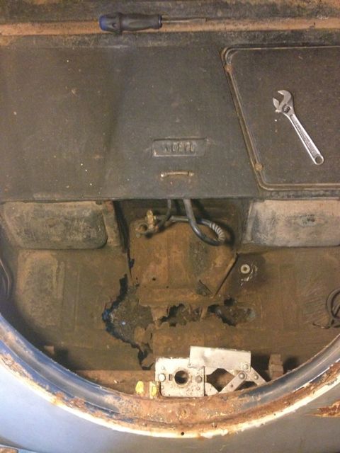

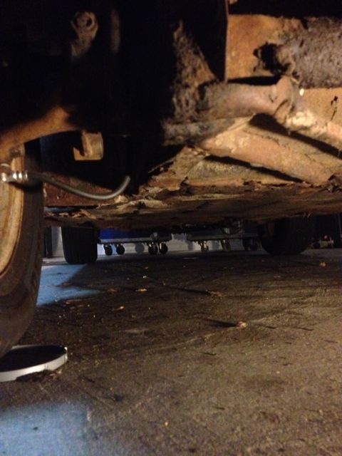

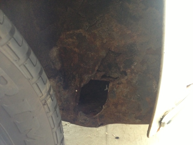

                          Got a chance to work on the 356 a little bit.
                          The good news is I found some fuel issues. There is a problem with the fuelcock in the Aus position, and there were no gaskets on the fuel pump, just rtv. Can't wait to see how it runs with proper fuel pressure. Waiting to get a metric tap and die to clean up some threads before I put it back together.

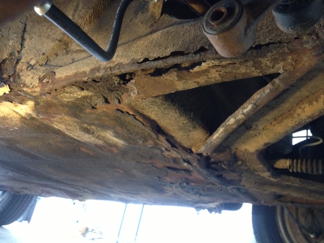

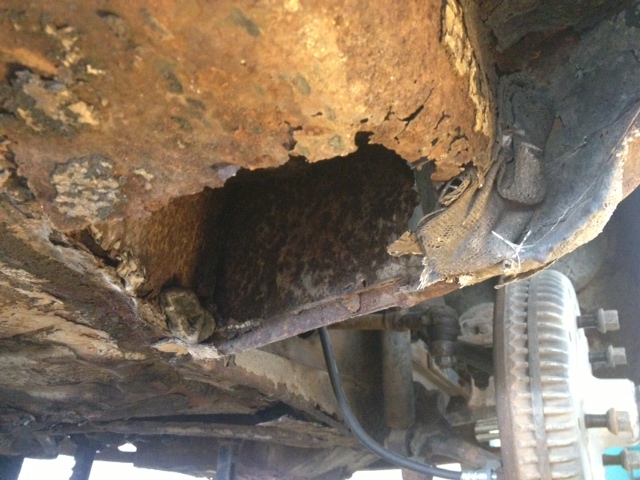

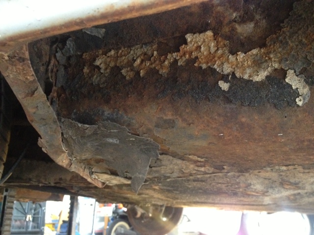

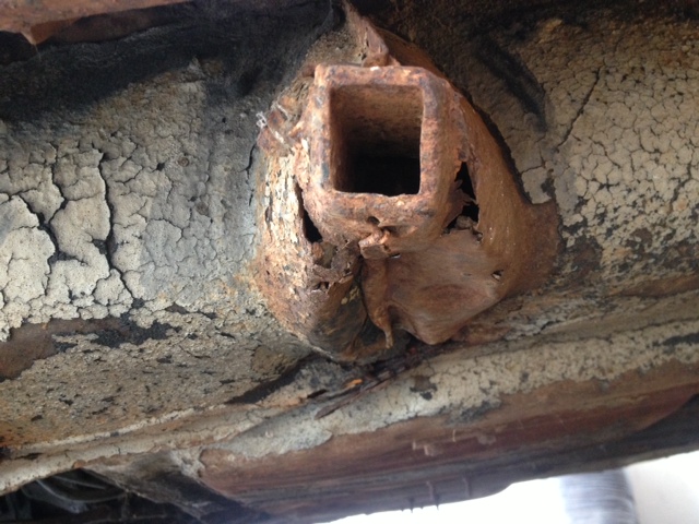

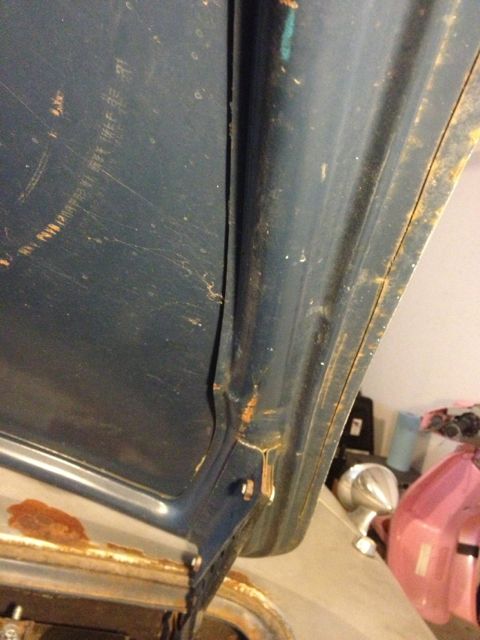

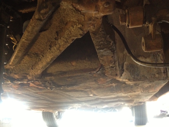

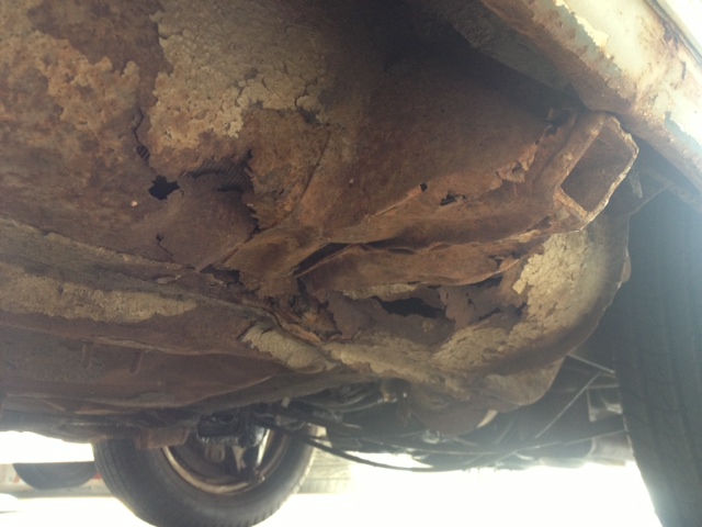

                          I snapped some shots of the rust in the front of the car.
                          Please take a look and advise!
                          Thankfully, the rear torsion area is very solid with no rot.

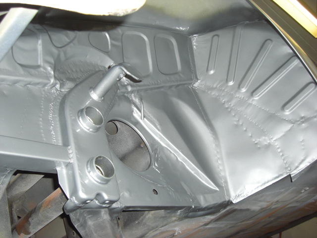

                            Hey Tony,
                            Great to see you back and thanks for the update. Actually your car seems to be in pretty good condition as far as I can tell from the photos. The floor pans appear to be solid for the most part. The longitudinals of course are shot but the rust is certainly not as bad as alot of cars you see getting rebuilt these days. These closing panels actually make up a "tube" on both sides of the car and are actually the backbone of its strength. However because its a coupe you have the triangulated support of the roof so you could get away with putting it around easy for while but I would not wait too long. When you do actually repair them I would recommend doing one side at a time and not opening them both up together just to ensure there is minimal chassis flex or movement. Again being a coupe eliminates alot of this danger but I have heard of coupes sometimes changing shape slightly under the load. Do the weakest and most rusty side first. The rusted out side runners behind the front torsion tube are nothing to be really concerned about provided the "inner" wall-flange is not rusted out. Can't tell from the photos. The reason I say these runners are no big deal is because they were actually later add-ons that factory started installing sometime in mid-late '57. All pre-a and early T1 1956-early57 cars like mine don't have them and they get along fine without them. However you will want to fix them. Here are some photos of this area.

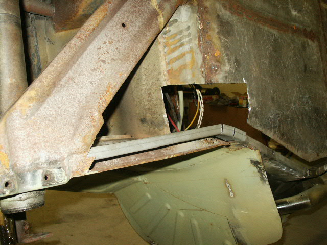

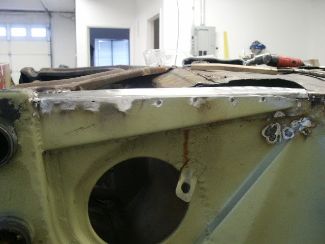

                            The bottom of this reinforment was gone on this speedster much like your car but the inner wall was also shot. I'm putting in a new perimeter section here.
                            The upper portion was fine so it made no sense to replace it all so I just put a new bottom on it and grafted it in.
                            Here's my very early 1957 coupe which never had these reinforments; meaning your car is still structually sound provided that the inner walls are not rotted out. Hope this helps! Justin
