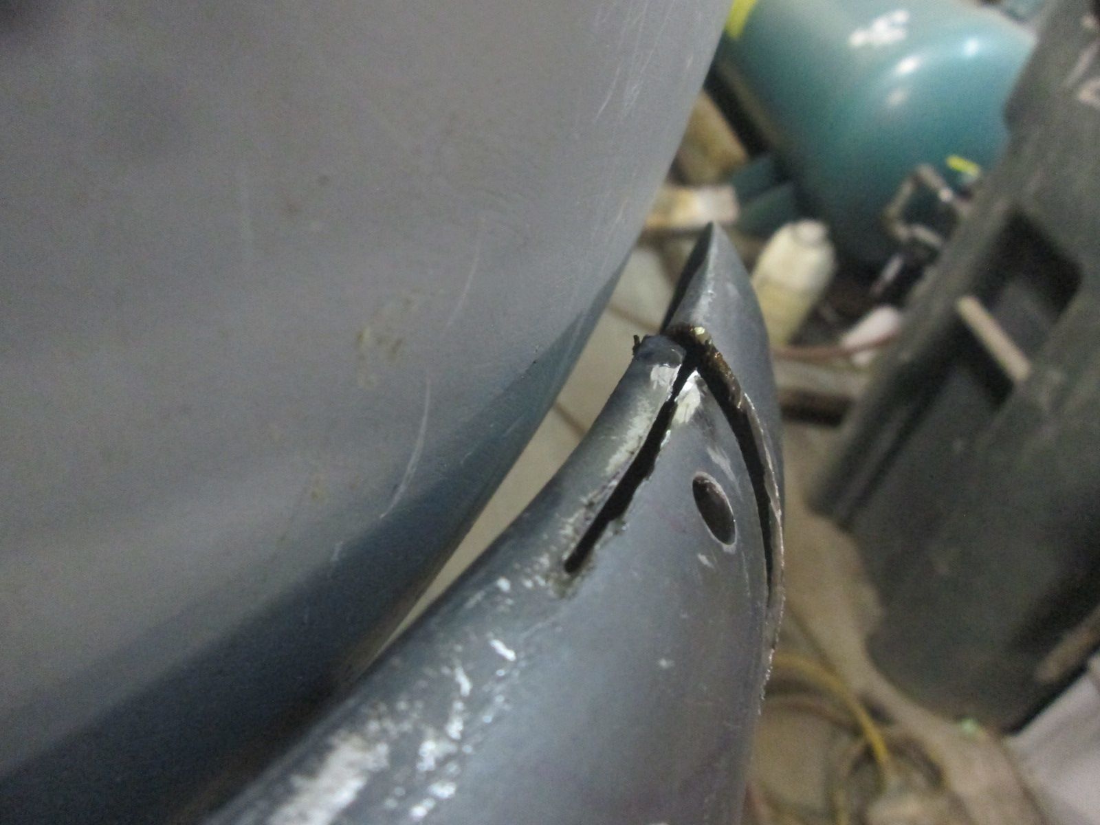

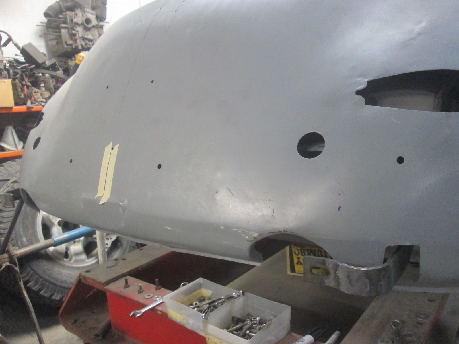

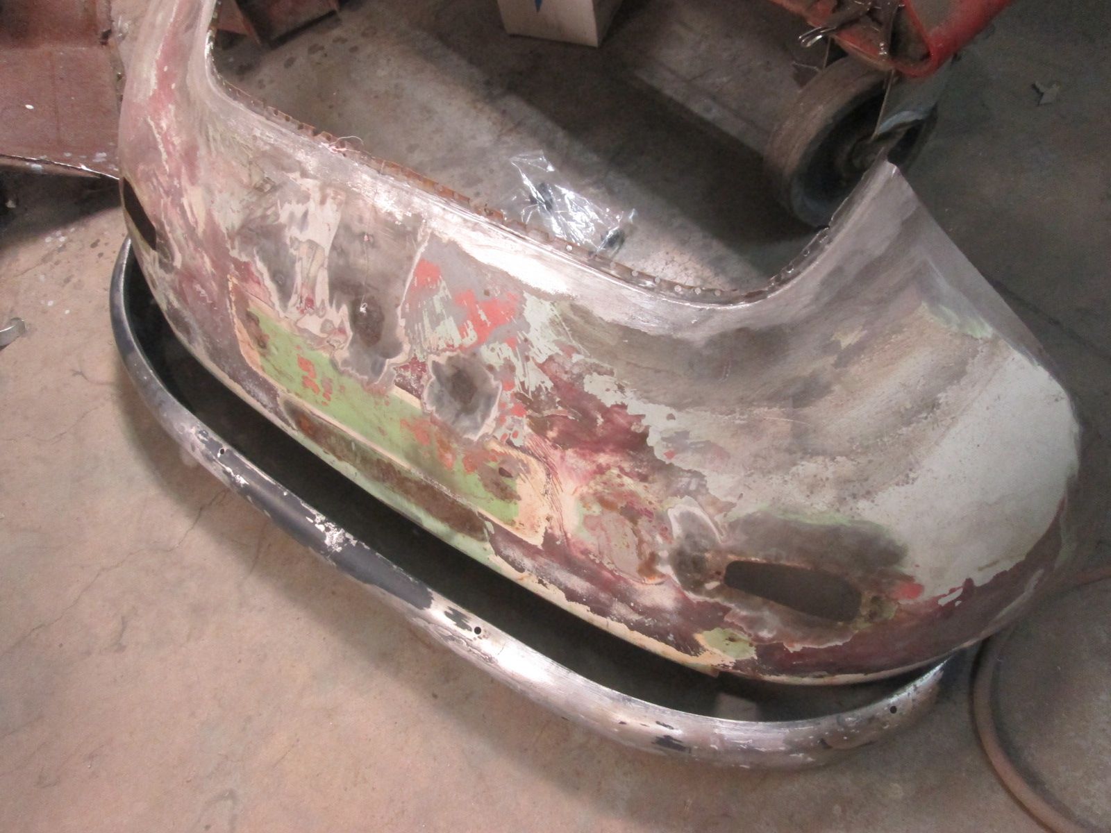

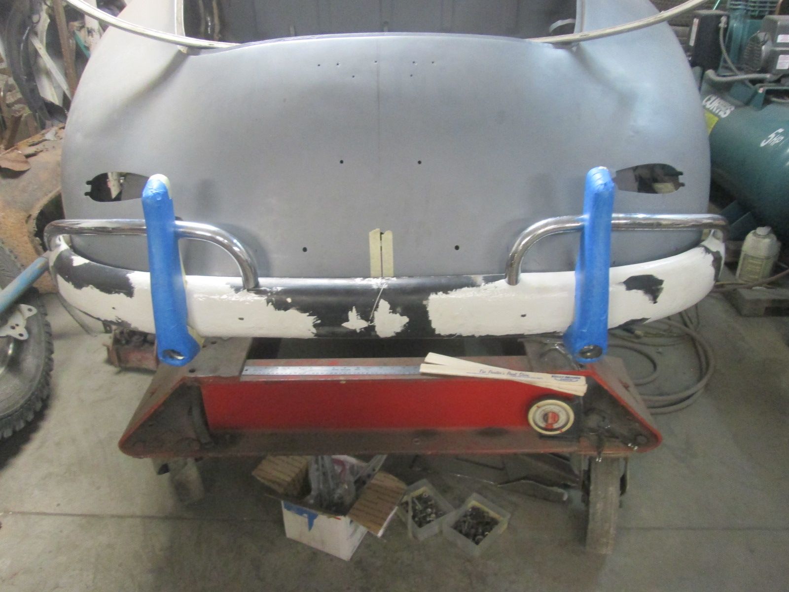

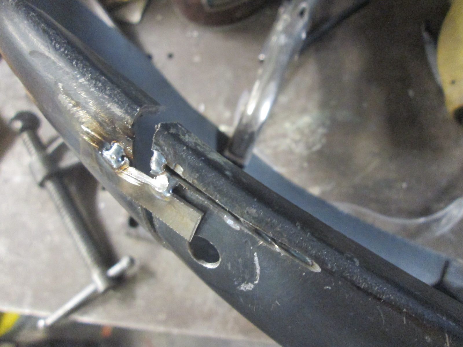

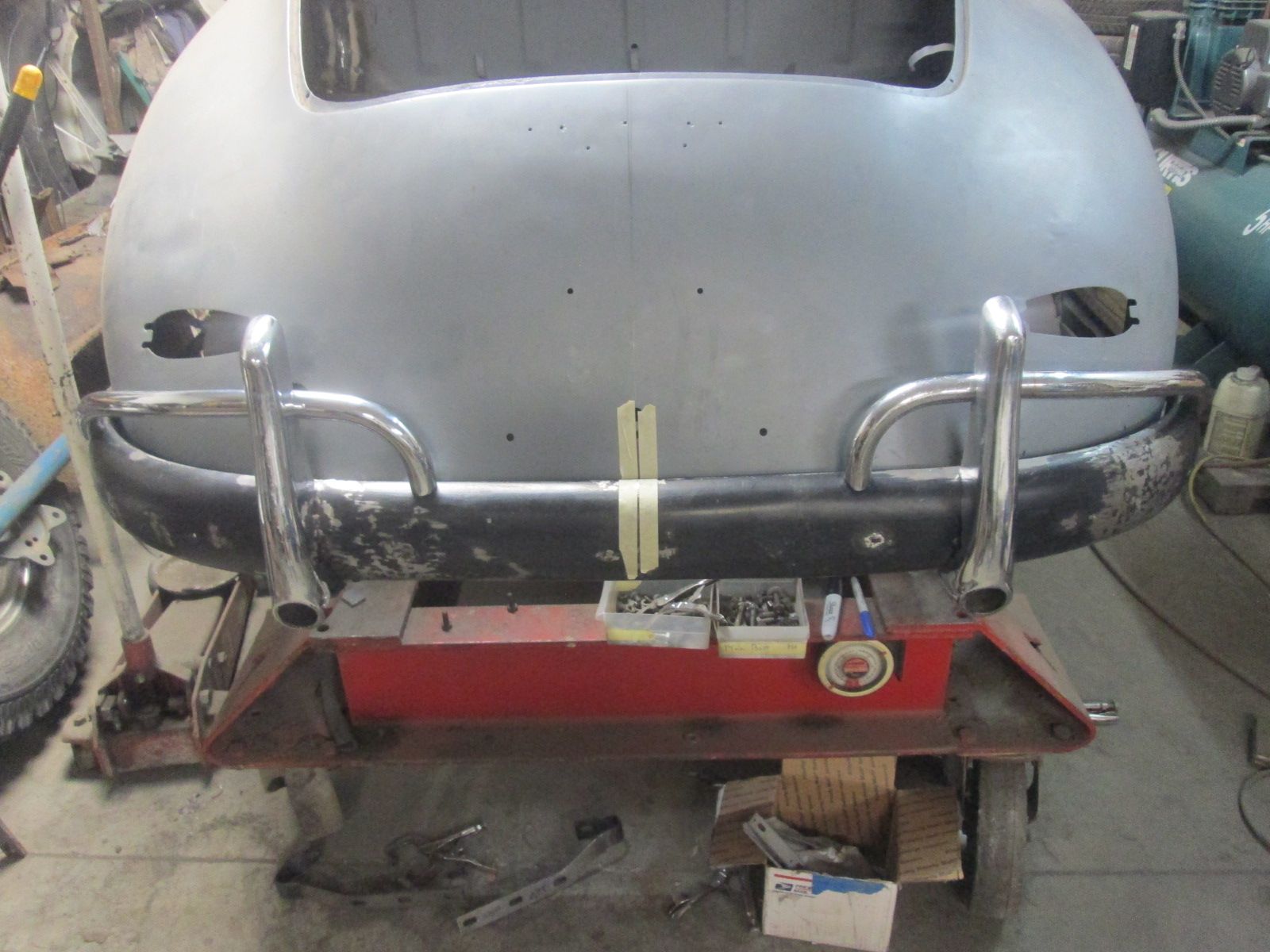

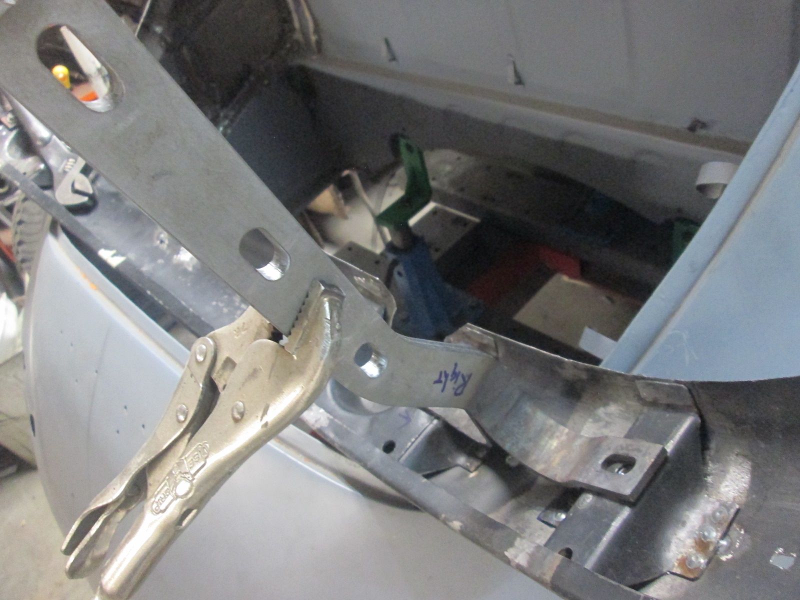

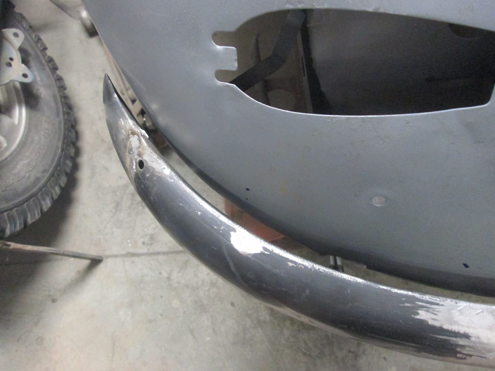

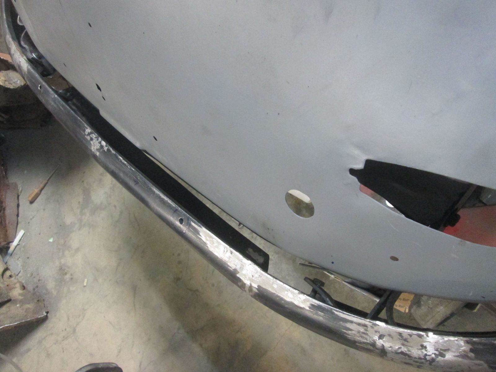

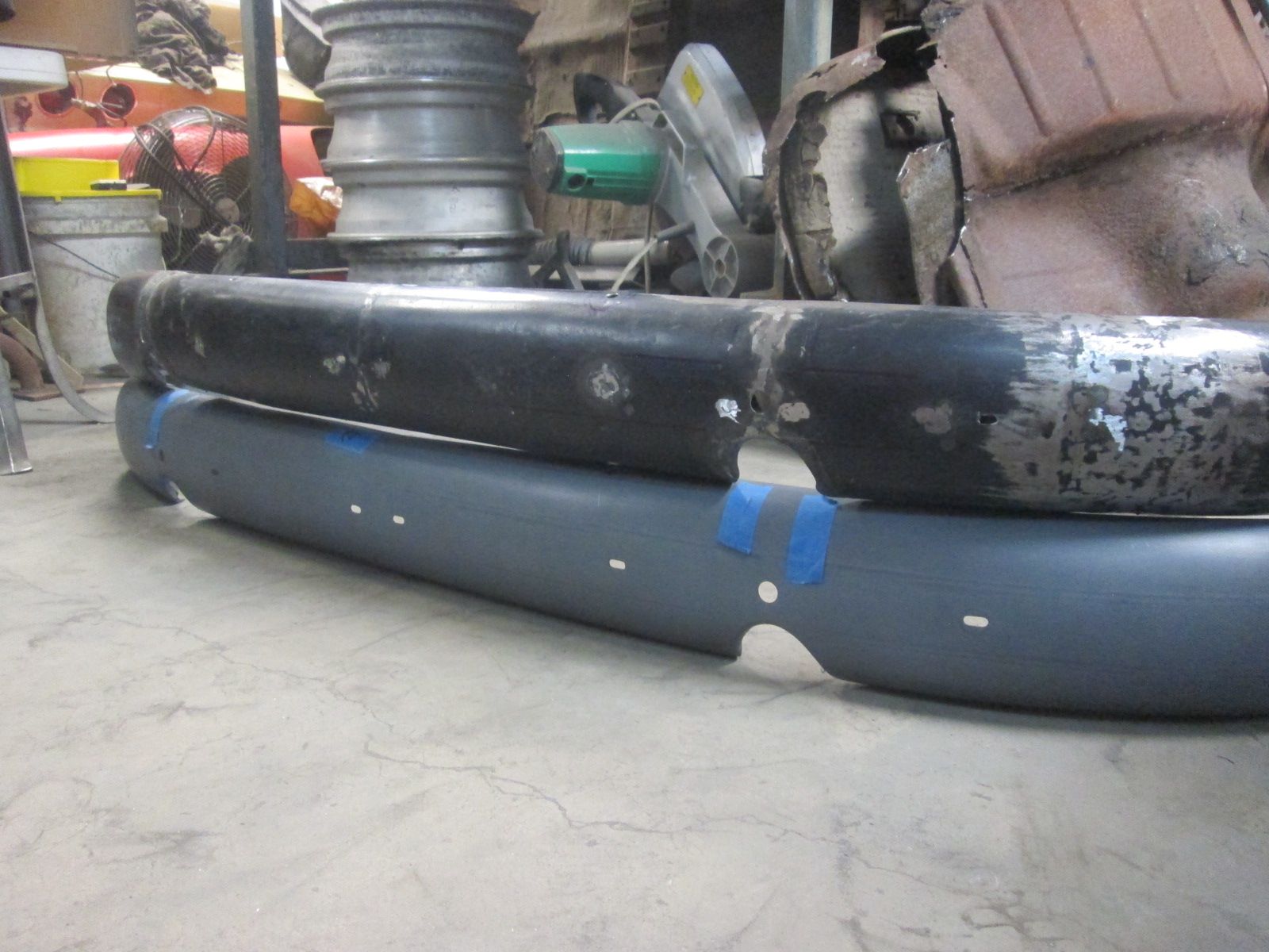

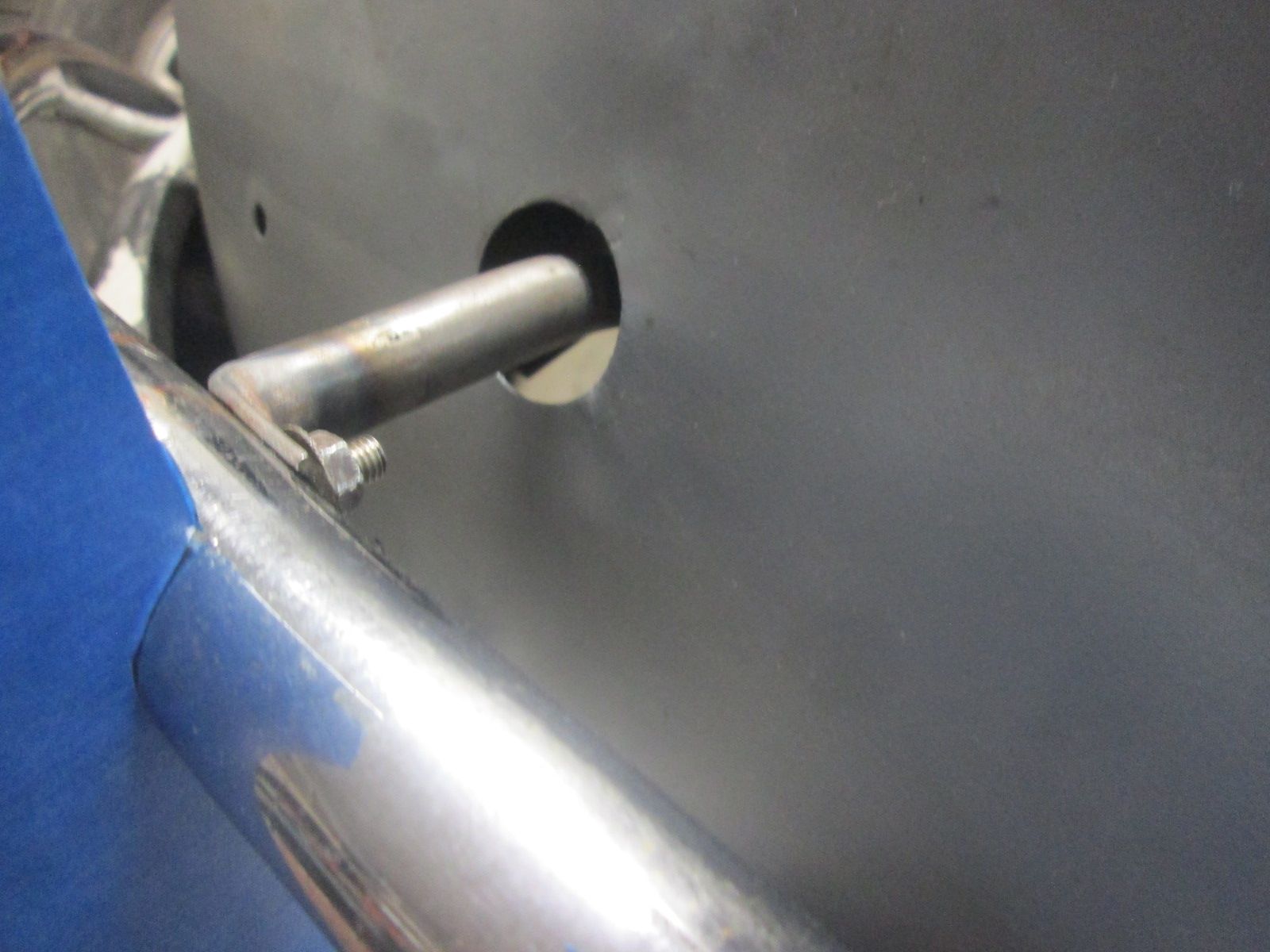

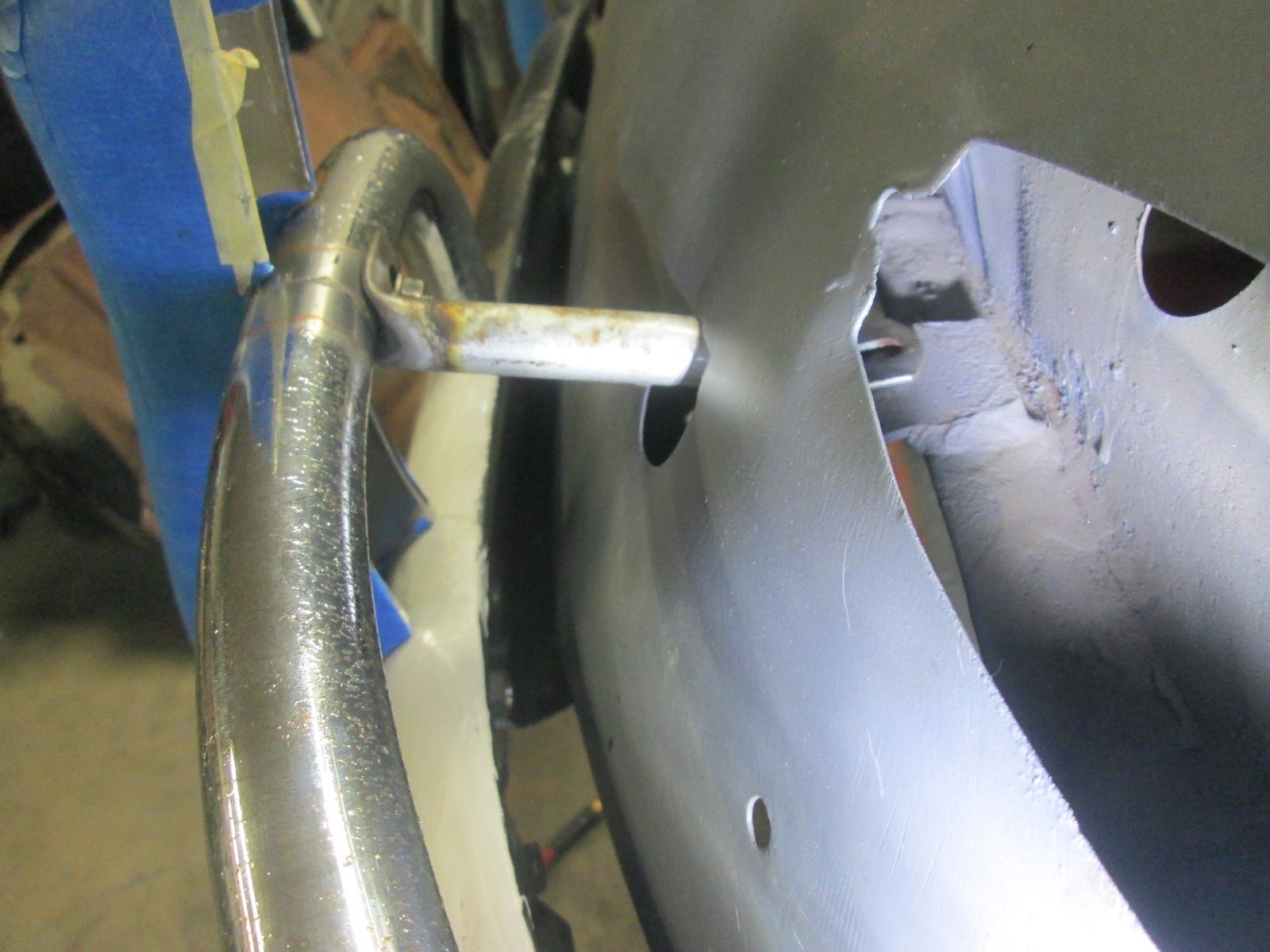

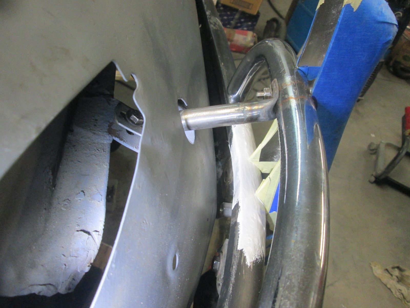

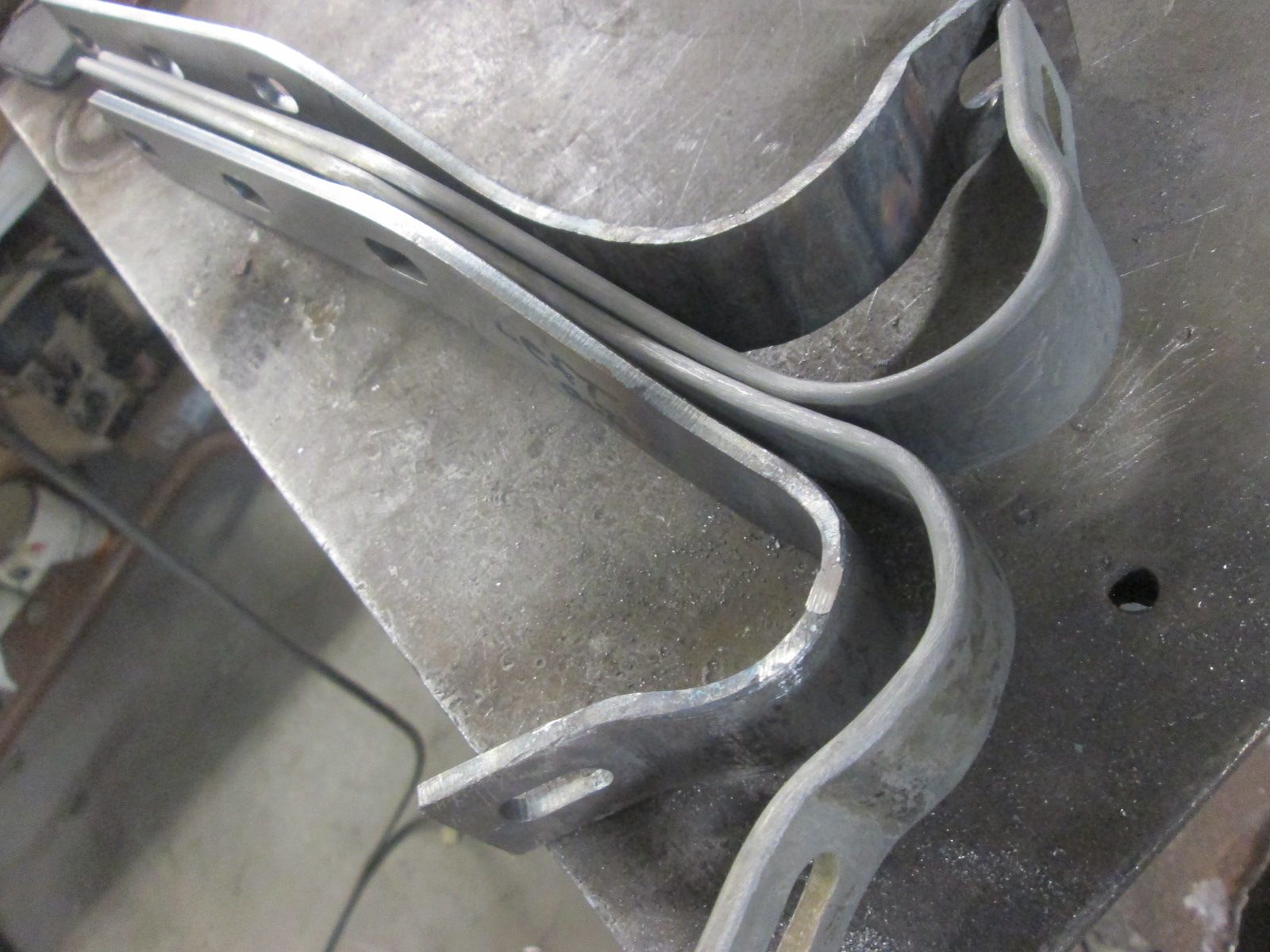

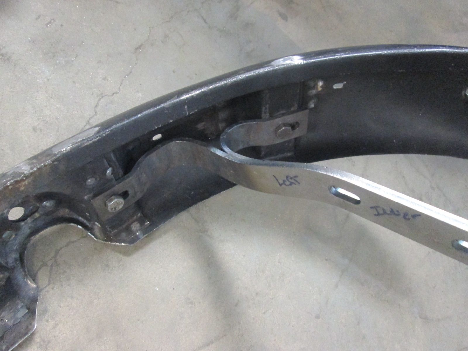

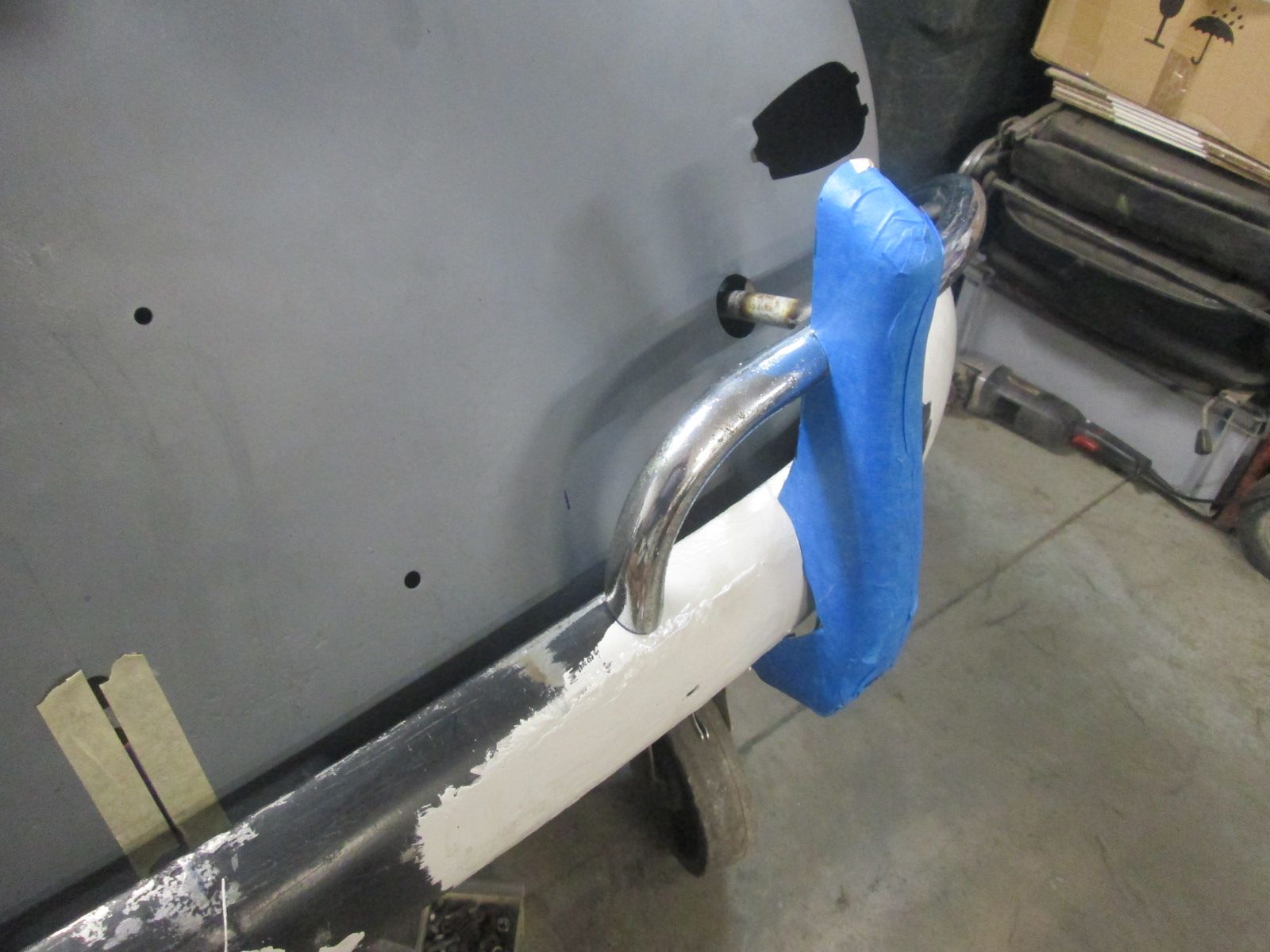

  • Click image for larger version  Name:	IMG_3204.jpg Views:	0 Size:	214.4 KB ID:	116958 Direct comparison with the stock unmodified bumper. Again, everything from the exhaust ports inward remains original.

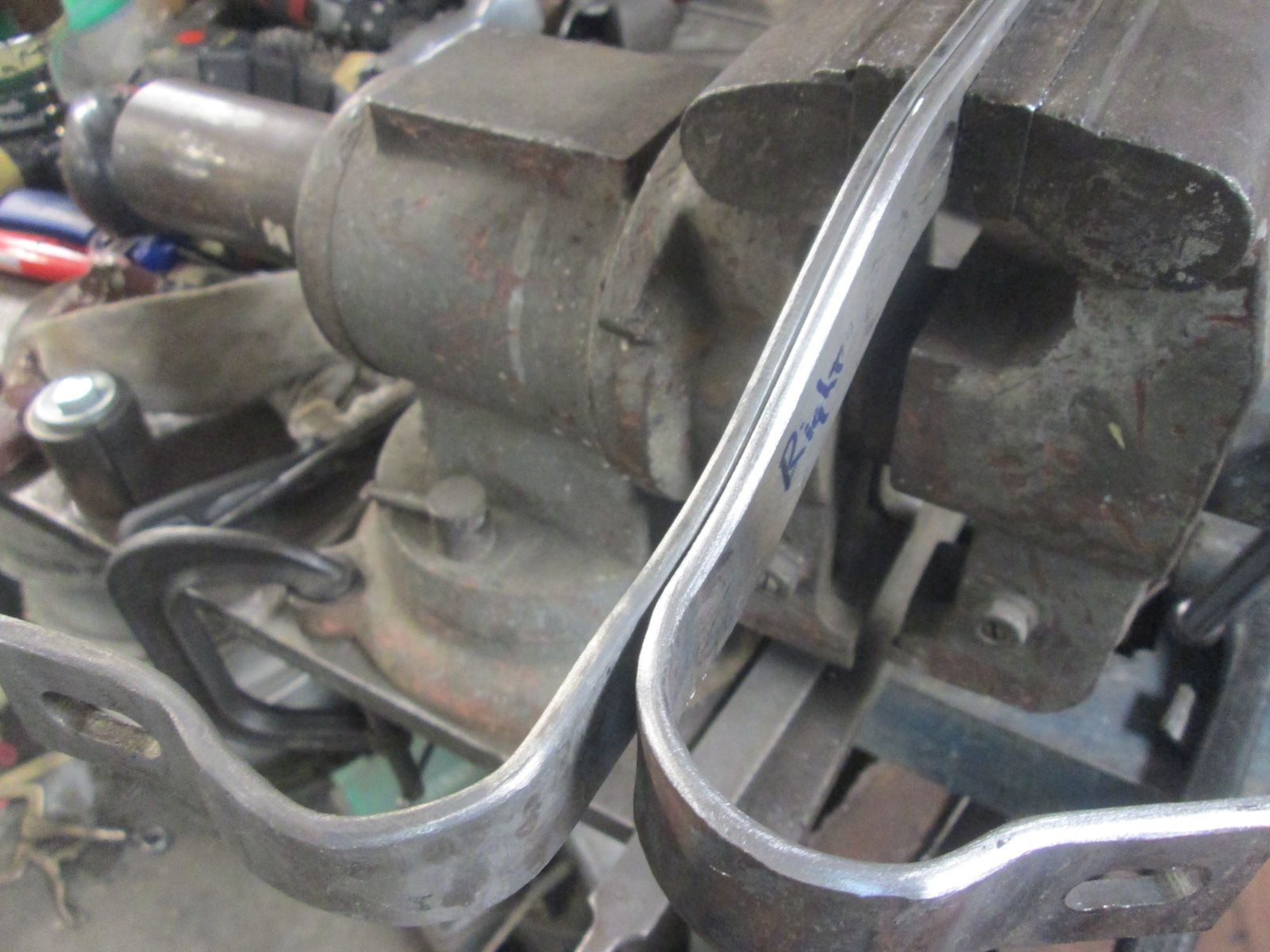

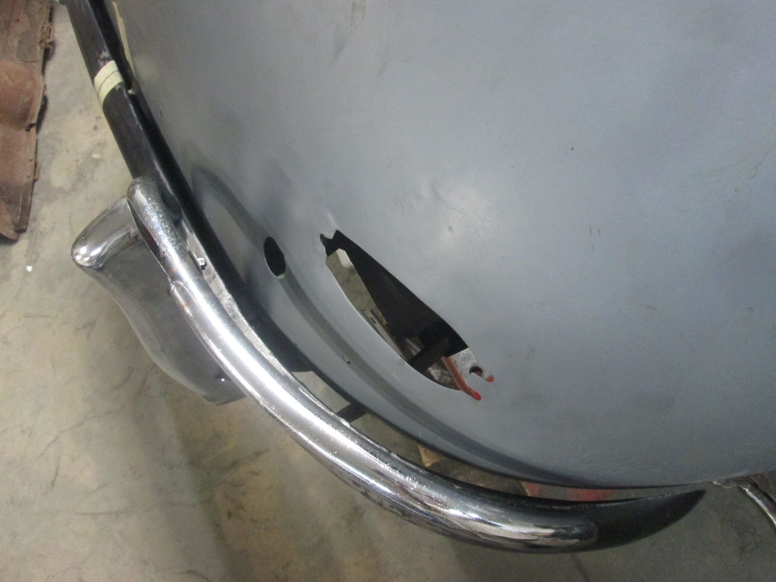

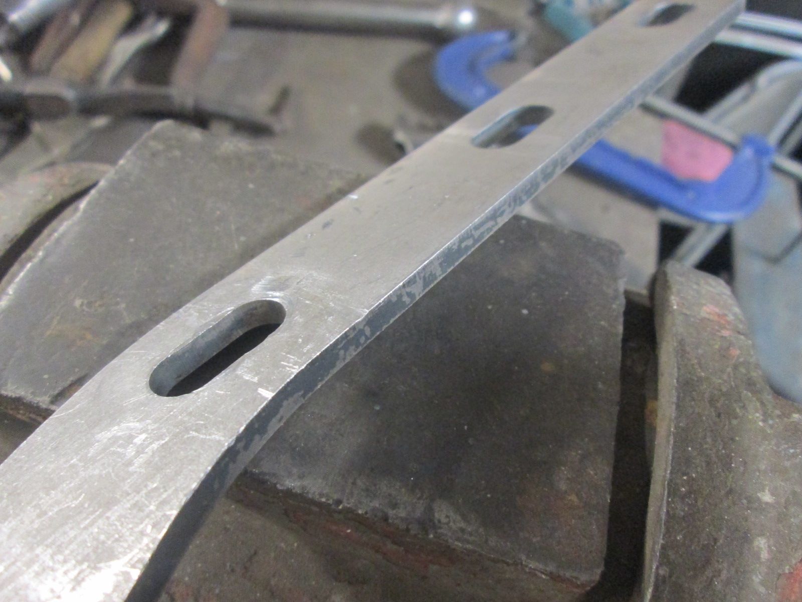

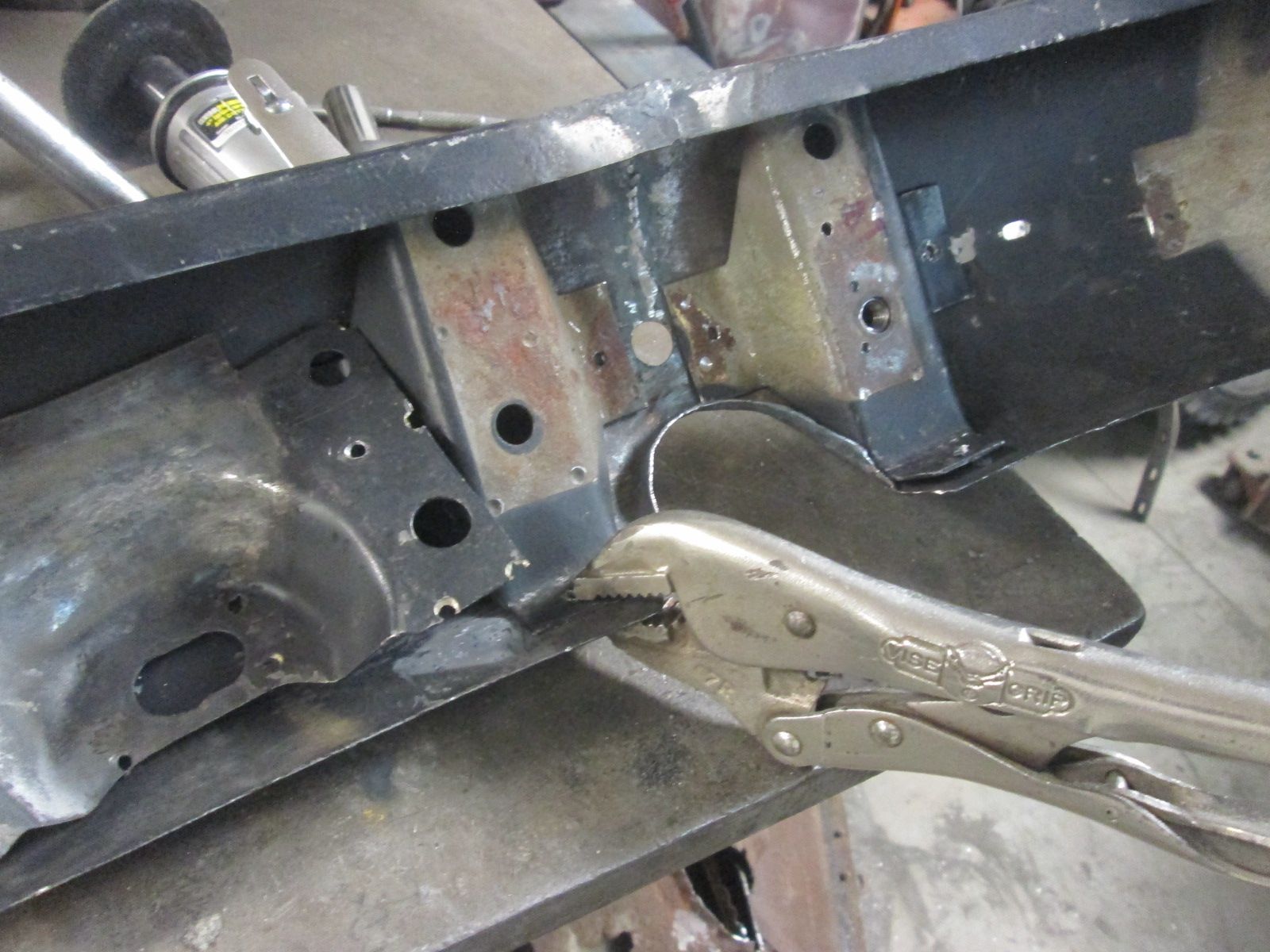

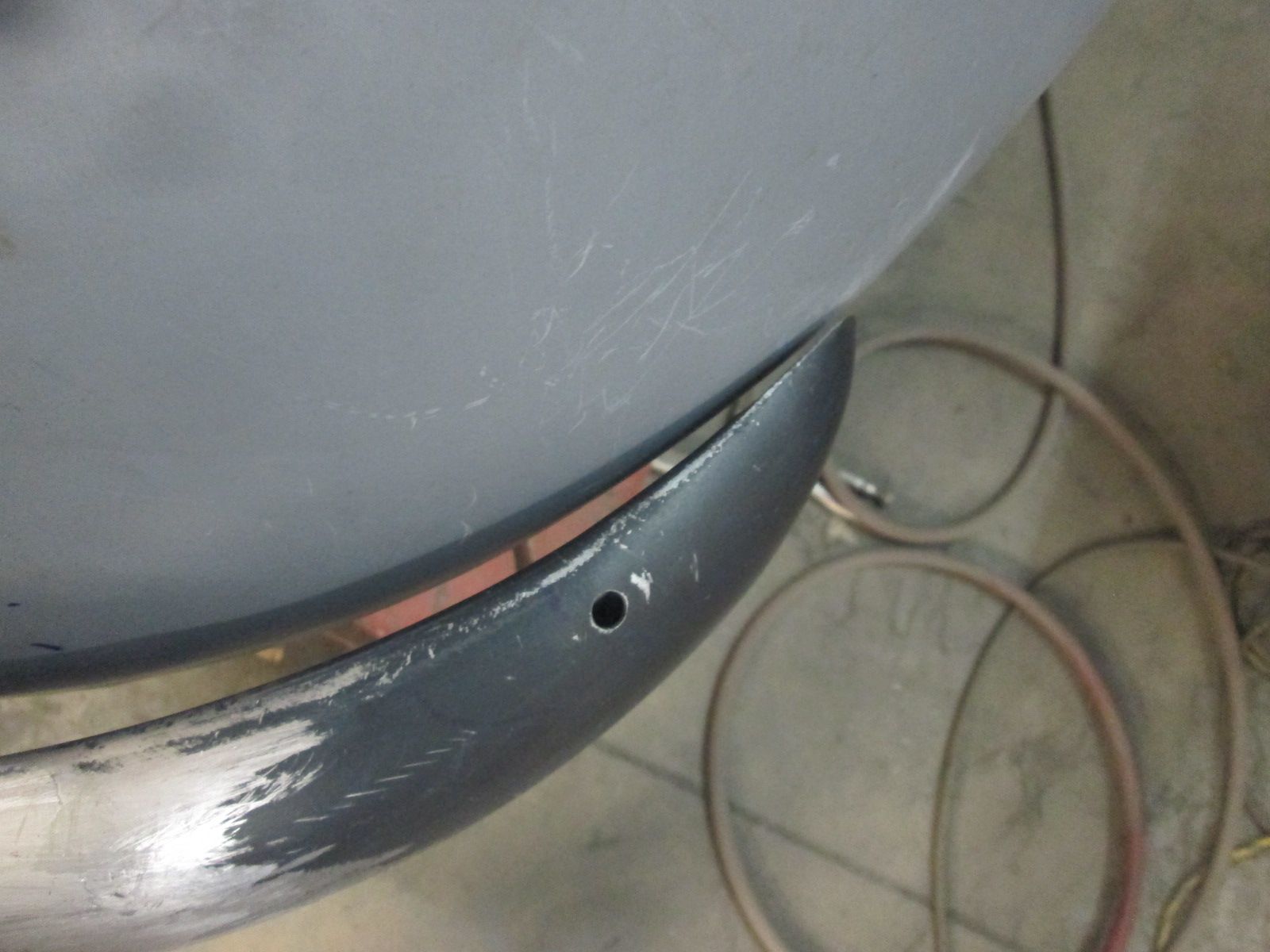

    Click image for larger version  Name:	IMG_3206.jpg Views:	0 Size:	174.6 KB ID:	116959 but outward at the corners its an inch shorter with a much tighter radius to match that narrowerT5 tail the car was fitted with. Outer overrider mounting hole really highlights the change.

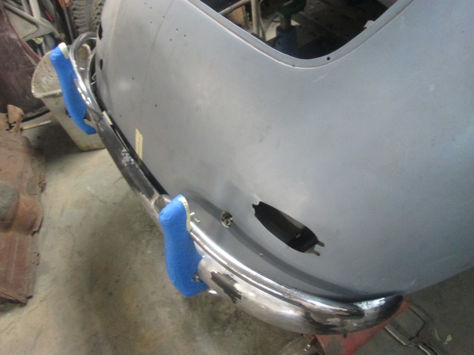

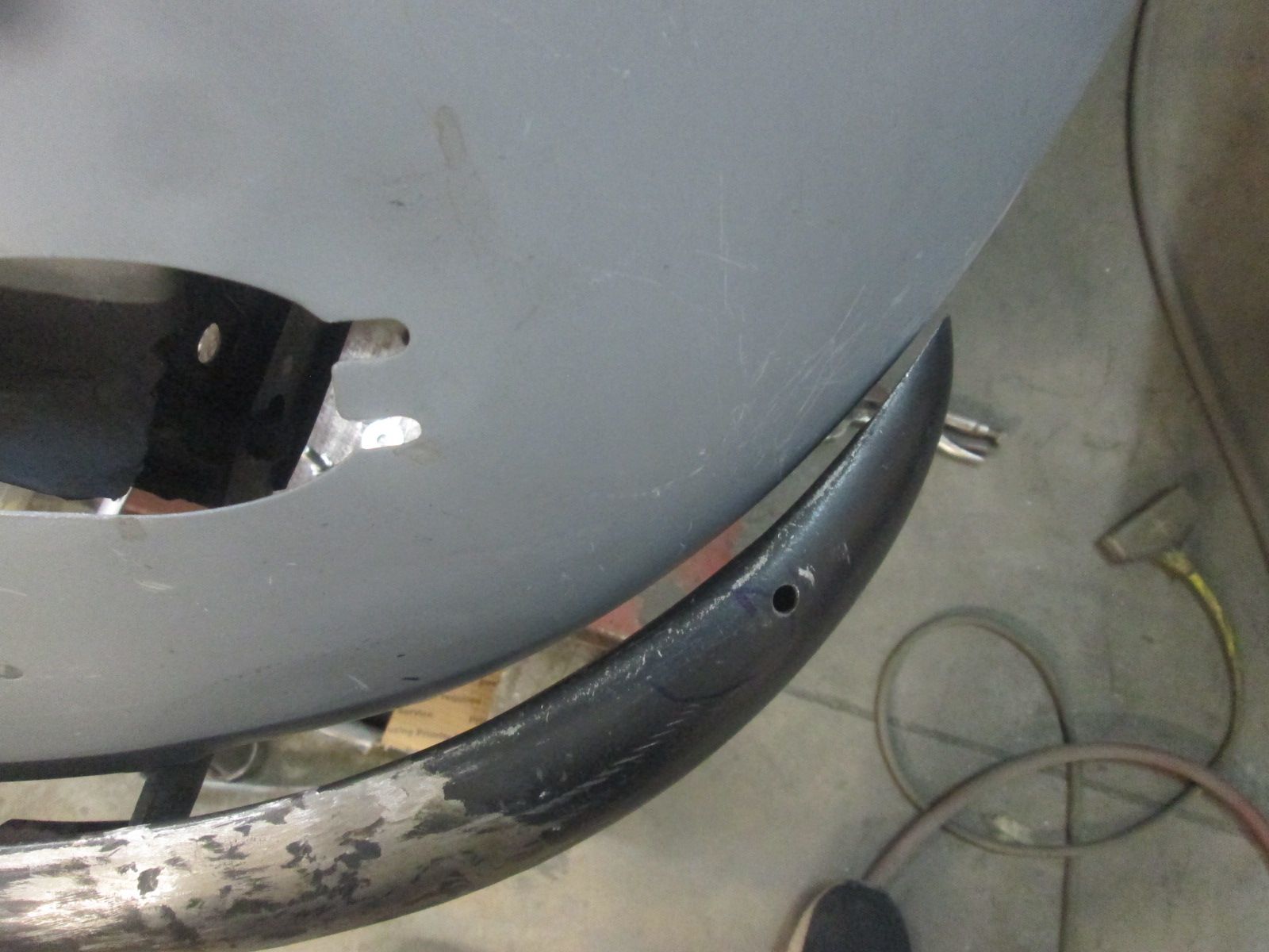

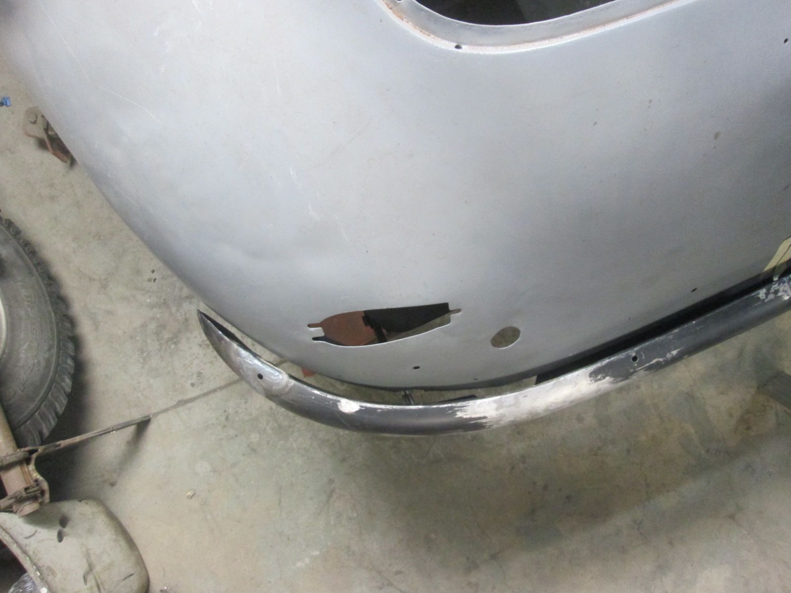

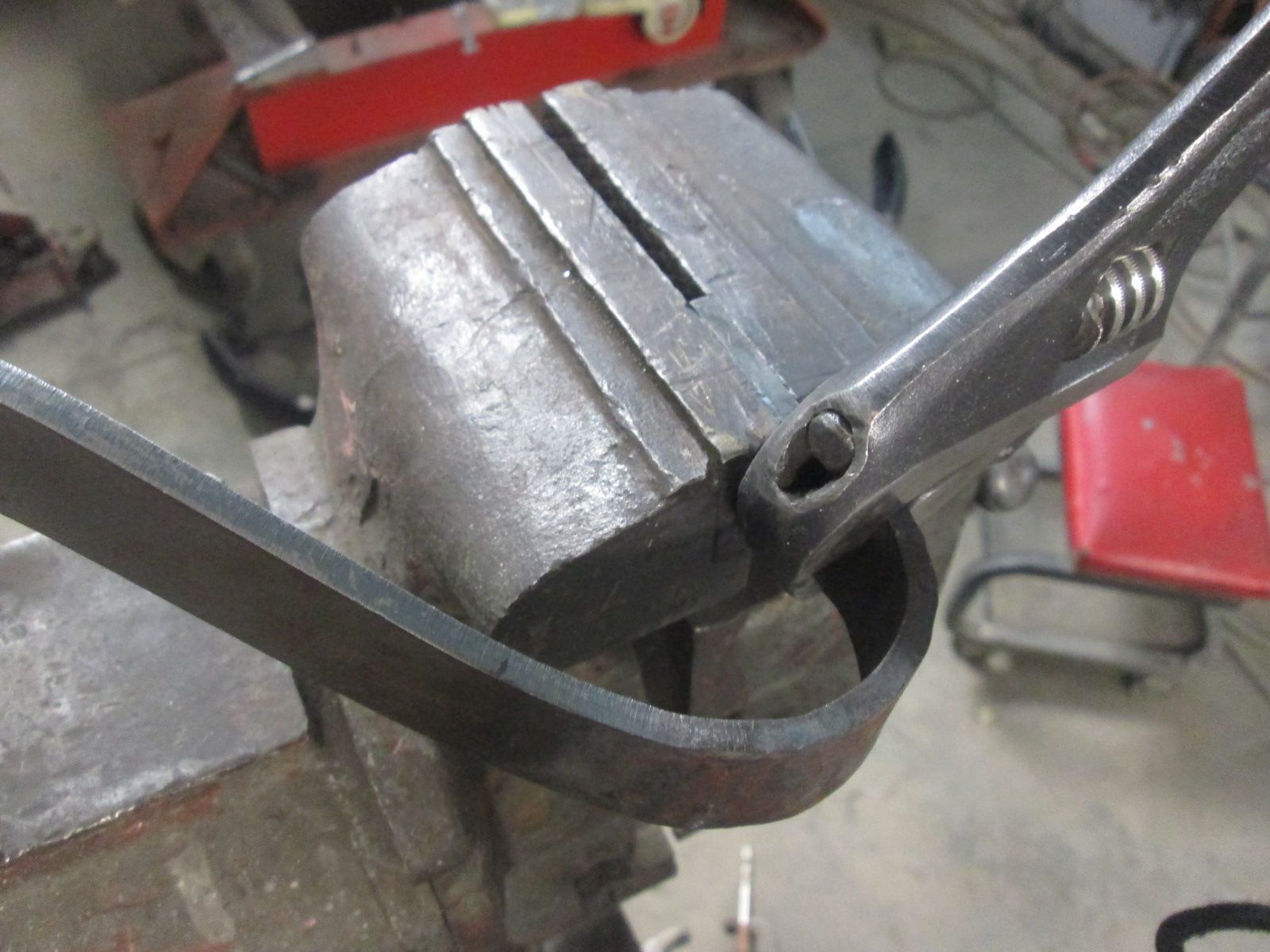

    Click image for larger version  Name:	IMG_3208.jpg Views:	0 Size:	230.9 KB ID:	116960 Onto reinstalling the bumper bracket mounts themselves so I can get it properly mounted and adjusted to the car. The best feature about making the alteration cut at the exhaust port is that once this bumper bracket mount is all welded in it will both conceal the weld joint as well as bridge and support this area.

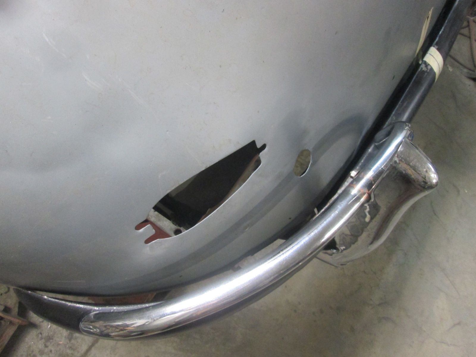

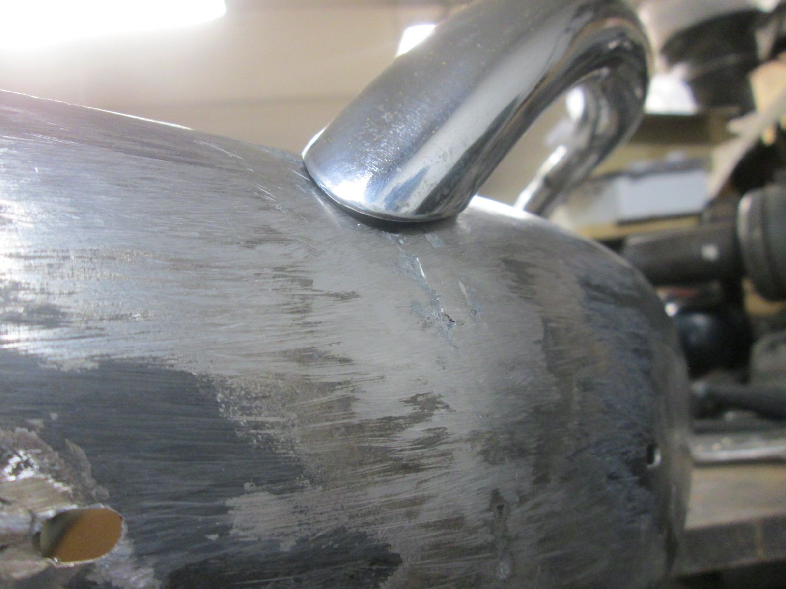

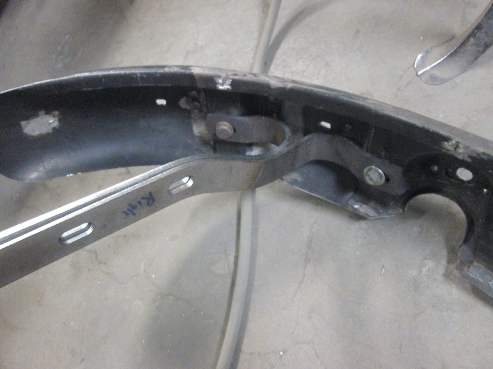

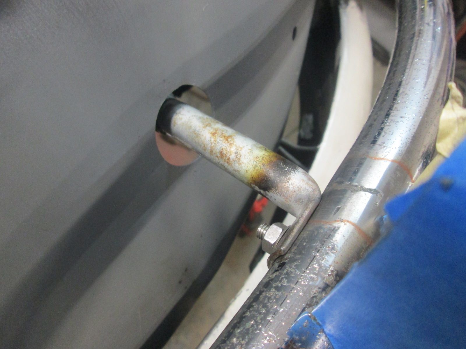

    Click image for larger version  Name:	IMG_3214.jpg Views:	0 Size:	181.9 KB ID:	116961 A very rough and preliminary fit with the new bumper irons. Couldn't get all the bolts in either but it was just a starting point.

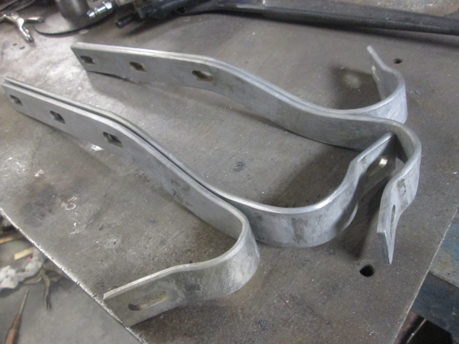

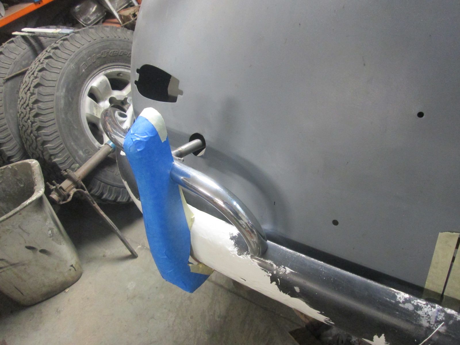

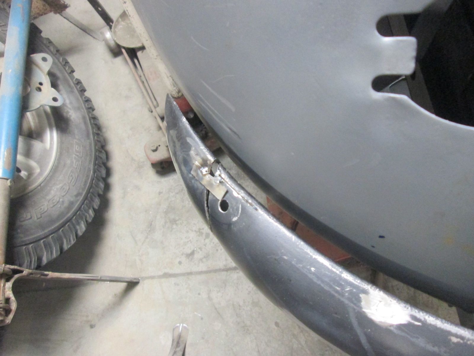

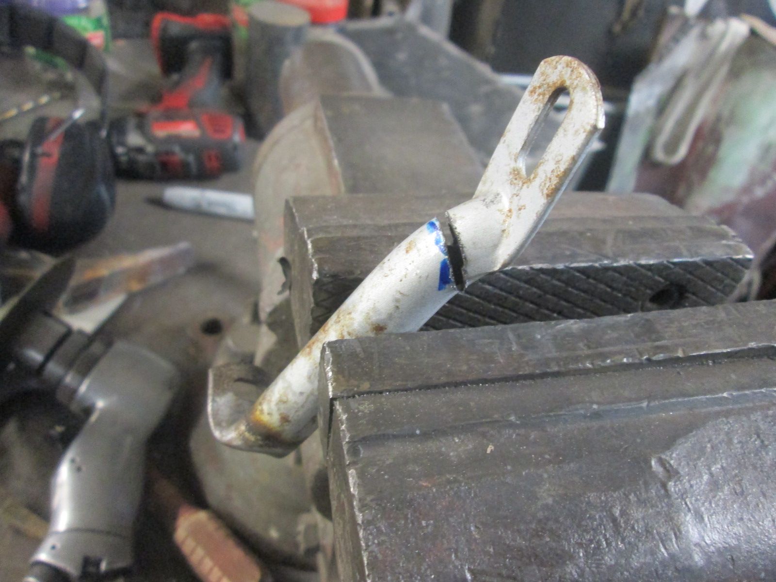

    Click image for larger version  Name:	IMG_3216.jpg Views:	0 Size:	179.5 KB ID:	116962 Really happy with the reveal the bumper is creating with its new contoured shape against the tail but its ending up tight at the corners. That will require a bit more rework but the mission at the moment is just to get the bumper fully mounted.

    • Justin by the time this is finished you will deserve to be called the bumper expert !
      Well done
        Well, I wouldn't go as far as to say expert but I did learn a lot from this little side project. Thanks again Roy, its always greatly appreciated! Justin

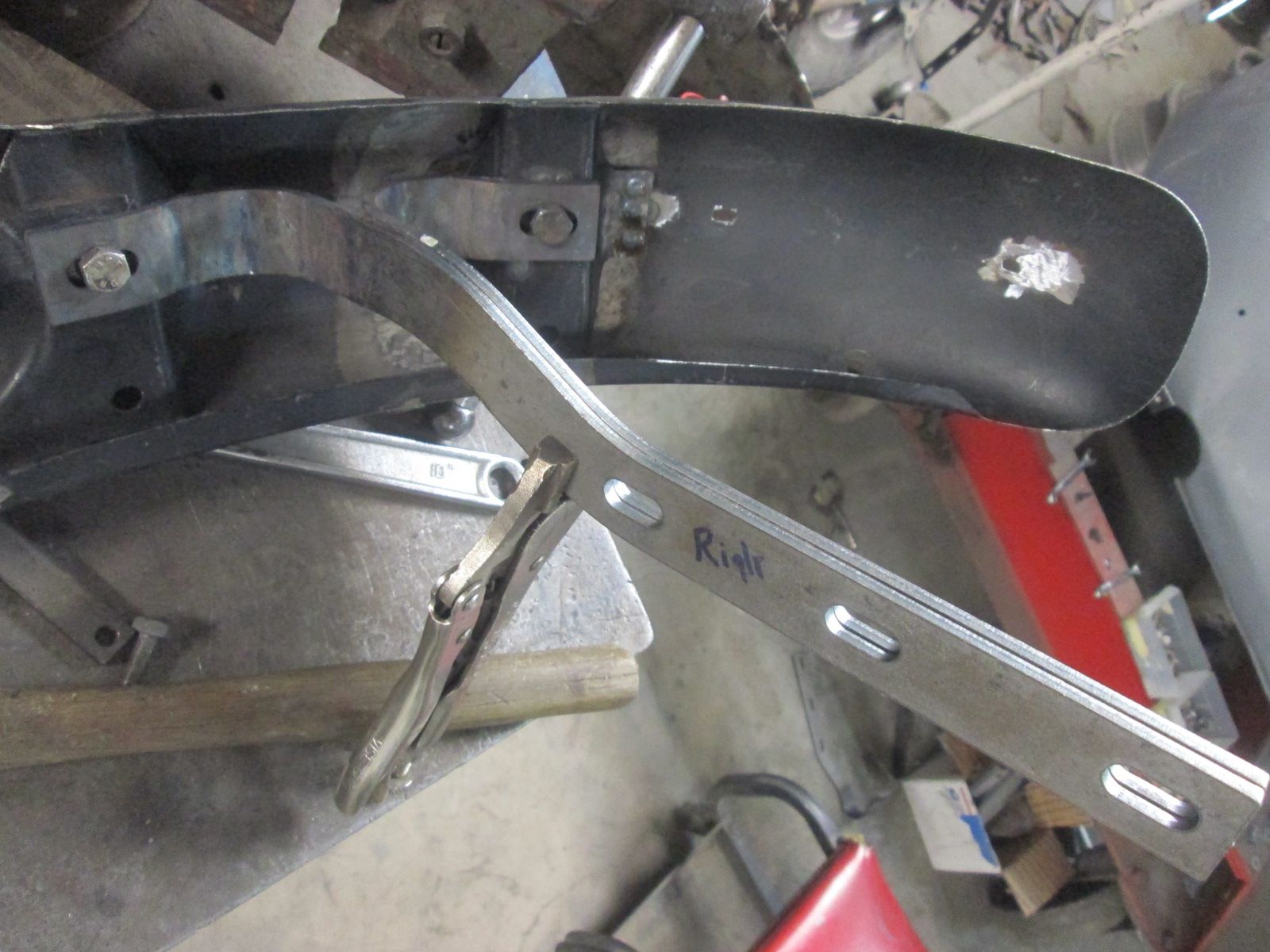

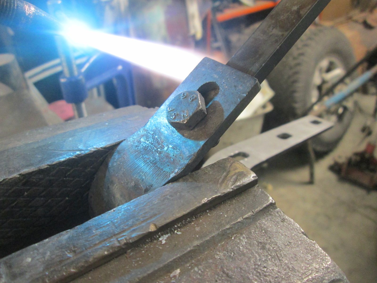

    • Bumper iron shaping then reshaping again....

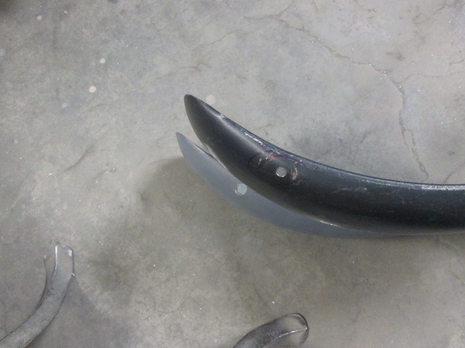

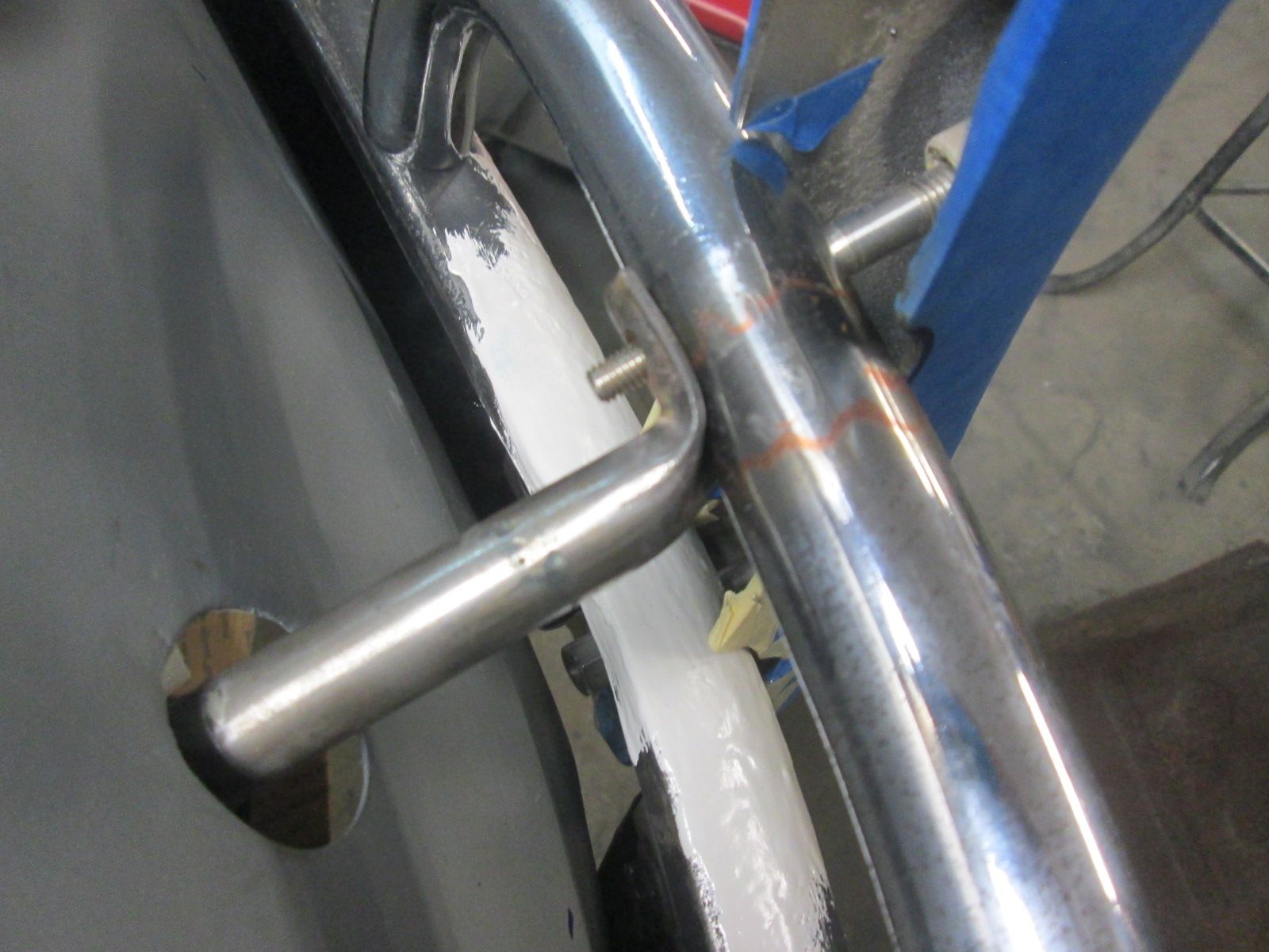

      Click image for larger version  Name:	IMG_3222.jpg Views:	3 Size:	170.0 KB ID:	116966 Basically starting from scratch as these are new irons with a modified rear bumper. Began dialing in and shaping the inner halves of the brackets as jumping off point. Much easier to establish this baseline first rather than trying to take both sides on as a unit.
      Click image for larger version  Name:	IMG_3228.jpg Views:	3 Size:	223.3 KB ID:	116967 Heavy steel and very uncooperative cold. This was one of many, many rounds of heat then tweak; test fit and repeat as needed.
      Click image for larger version  Name:	IMG_3227.jpg Views:	3 Size:	208.2 KB ID:	116968 Before it was over I also had to bend the ends rotationally at the mounting surface to get the bumpers' final pitch corrected with it snuggly bolted down.
      Click image for larger version  Name:	IMG_3229.jpg Views:	3 Size:	199.6 KB ID:	116969 On the chassis side I wanted the eyelets on each half of this bracket to remain open and aligned with one another for maximum adjustment range. At the same time through all the bending and reshaping I had to have the eyelets on the bumper side mount as evenly as possible with one another for maximum lateral adjustment ability.
      Click image for larger version  Name:	IMG_3219.jpg Views:	3 Size:	217.2 KB ID:	116970 This is the final fit and alignment I was after. Bolts in the bumper sit evenly in the eyelets in relation to one another for max lateral adjustment options and at the same time the eyelets on the chassis side are aligned and opened fully. I had this fitment on both brackets only to find out that the approach angle on one side was off with the chassis. As I bent the end into alignment the halves of the bracket would slide misaligning the eyelets I had worked so hard to keep open. This would require yet more heating and tweaking to iron out. It tried my patience on more than one occasion but I eventually got it all put to bed.

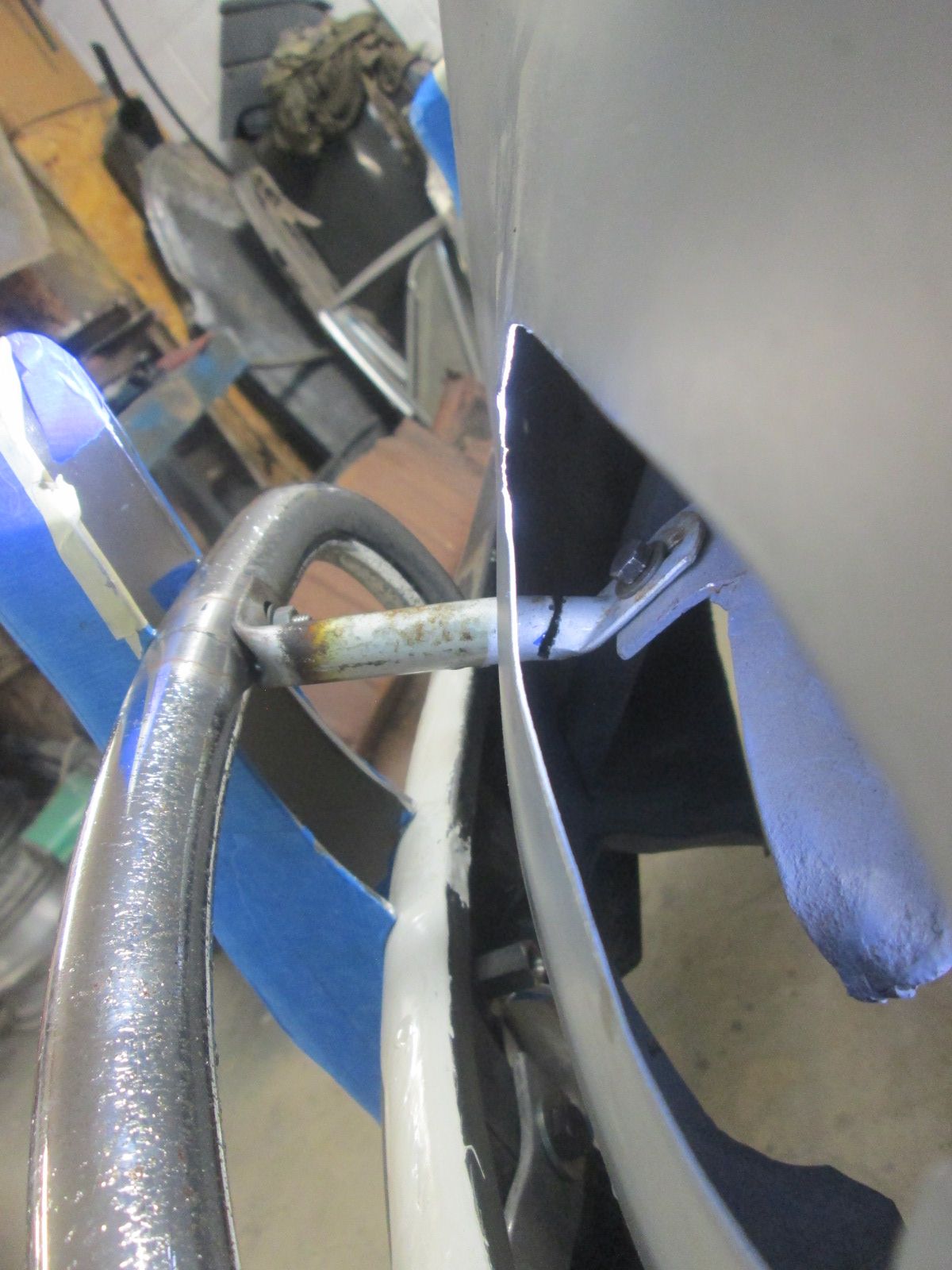

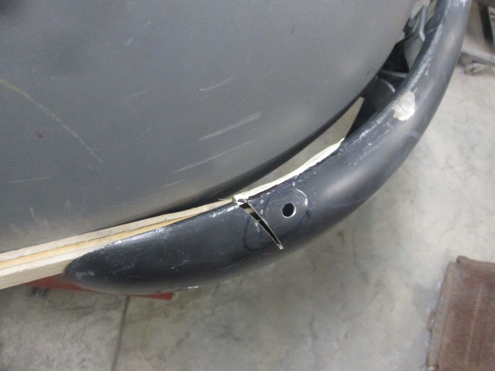

      • One more mock up
        Click image for larger version  Name:	IMG_3223.jpg Views:	0 Size:	206.4 KB ID:	116972 now fully mounted and adjusted on its new brackets.
        Click image for larger version  Name:	IMG_3224.jpg Views:	0 Size:	175.6 KB ID:	116973 Reveal shape and contour runs along the tail as closely as I could hope for but it turns too quick and tight at the tips.
        Click image for larger version  Name:	IMG_3225.jpg Views:	3 Size:	168.8 KB ID:	116974 Same problem on the left though just a little tighter still. Will have to relief cut the ends and relax these corners.
        Click image for larger version  Name:	IMG_3230.jpg Views:	3 Size:	199.8 KB ID:	116975 But I am at least finished with these bracket mounts.
        Click image for larger version  Name:	IMG_3231.jpg Views:	3 Size:	178.5 KB ID:	116976 To center the bumper with the body the eyelets are just about maxed out on both sides but it gave me enough to get by. I'll take what I can get.

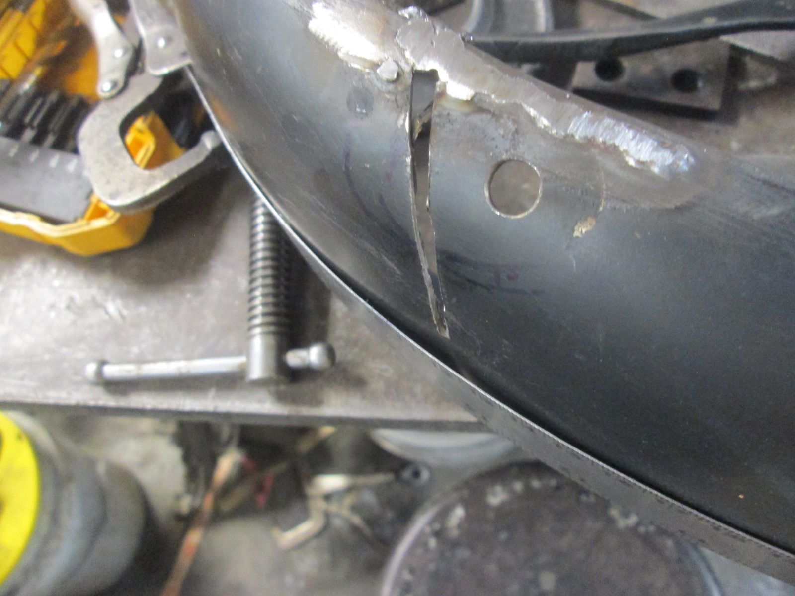

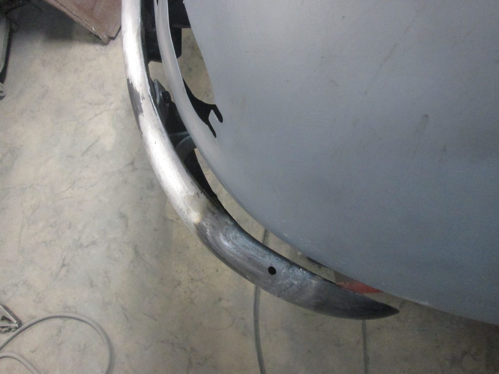

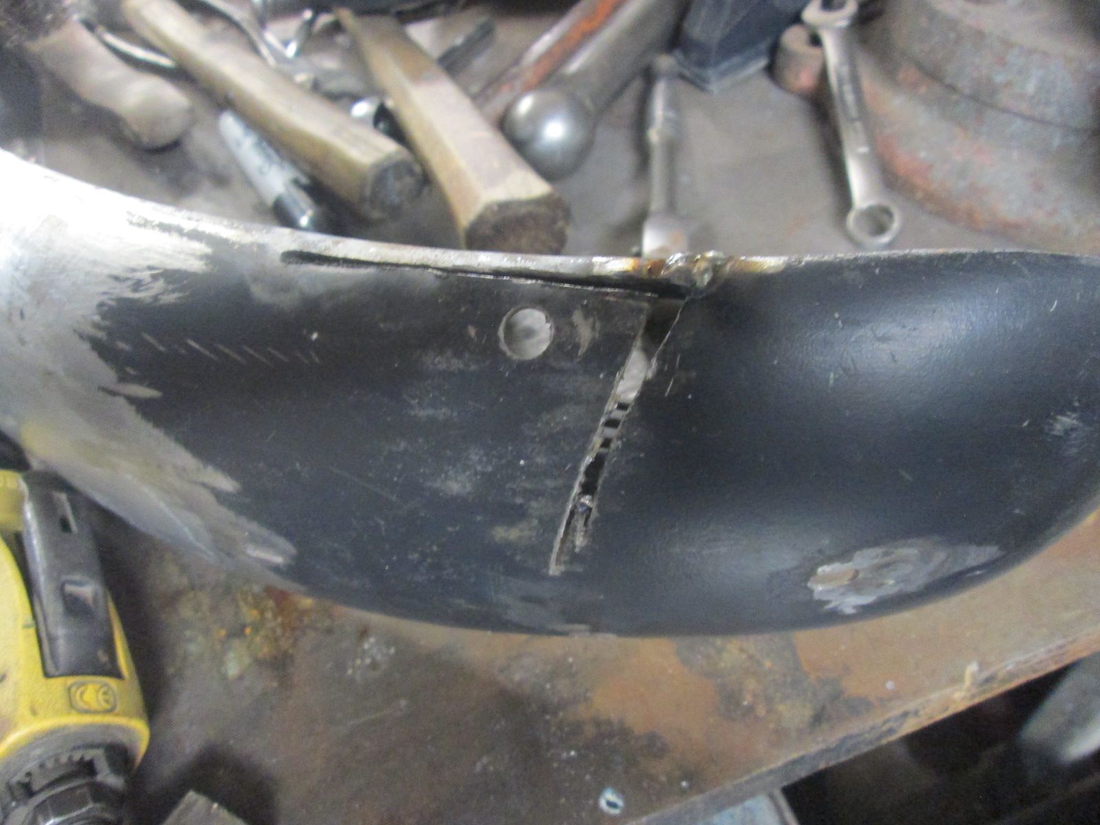

              • Relieving the corners:
                Click image for larger version  Name:	IMG_3260.jpg Views:	0 Size:	164.9 KB ID:	116997 Bumper stripped back down then remounted in its best adjusted position against the body. Relief cuts added both top and bottom and now in the process of matching this final section to the shape of the body.
                Click image for larger version  Name:	IMG_3262.jpg Views:	3 Size:	186.5 KB ID:	116998 A second relief cut had to be added along the edge just above the overrider mounting hole to bring this area in for a smooth transitional line across this change.
                Click image for larger version  Name:	IMG_3263.jpg Views:	3 Size:	197.0 KB ID:	116999 A quick lap of metal tacked on to hold that shape while I dismounted the bumper for final backfilling and welding.
                Click image for larger version  Name:	IMG_3264.jpg Views:	3 Size:	204.6 KB ID:	117000 Beginning to stitch all of it back together. This change in shape has created a buckle through the center where it was not cut but this can be hammered upward into position once all the cuts are backfilled.
                Click image for larger version  Name:	IMG_3274.jpg Views:	3 Size:	183.8 KB ID:	117001 Welding complete and remounted for a test fit. That buckle through the center has also been worked out. All set on this side.
                Thanks for looking.

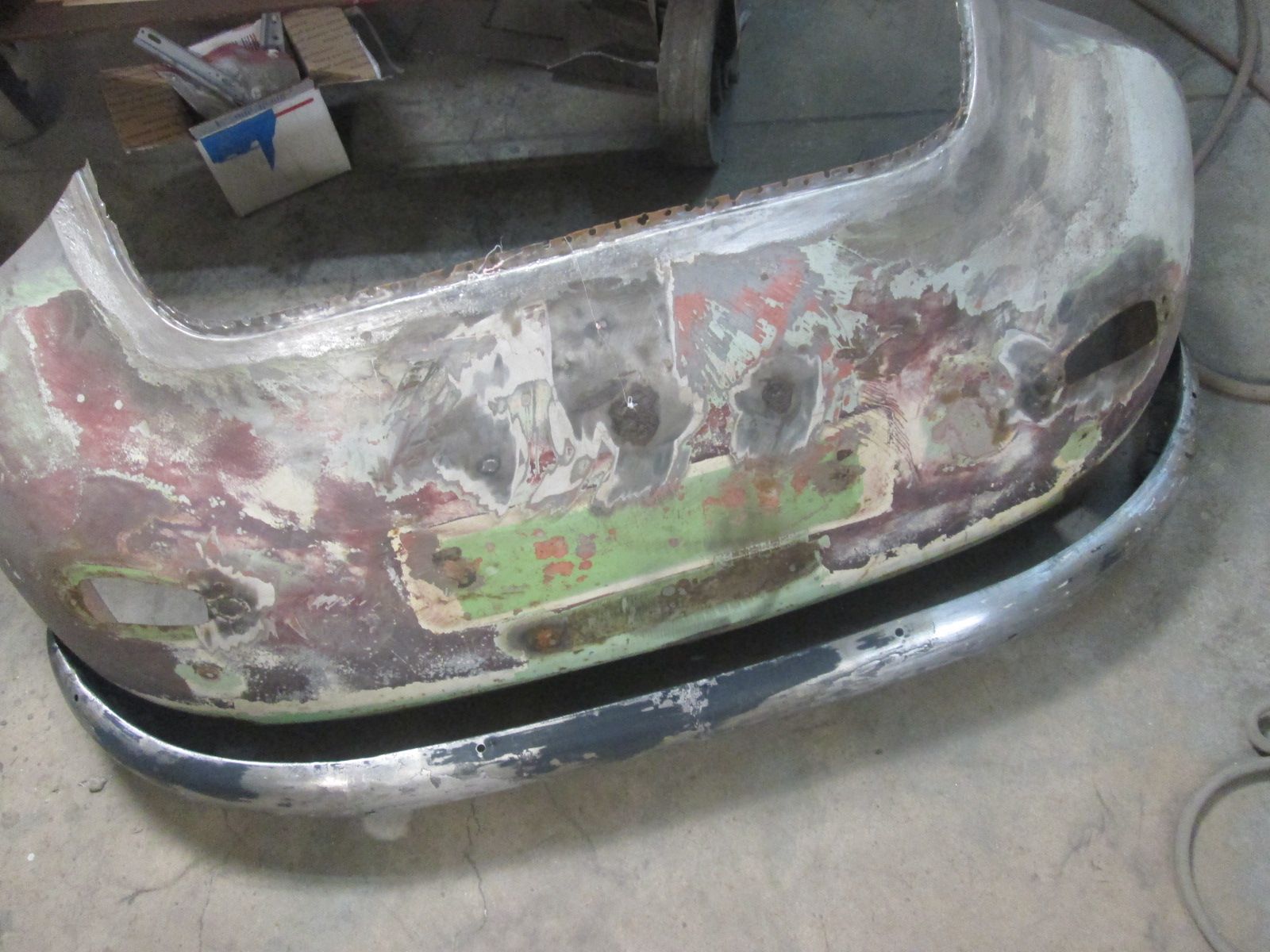

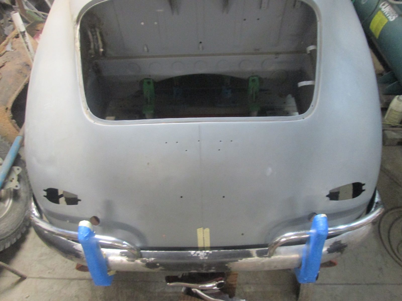

                  • Click image for larger version  Name:	IMG_3312.jpg Views:	0 Size:	237.1 KB ID:	117036 This bumper is now officially a 1959 356 "AT5" version. Its now not even close to fitting around the profile of a 356A tail.
                    Click image for larger version  Name:	IMG_3313.jpg Views:	0 Size:	226.0 KB ID:	117037
                    This is as close as it will get before the corners bottom out against the skin.
                    One more and final confirmation fit.
                    Click image for larger version  Name:	IMG_3286.jpg Views:	0 Size:	171.9 KB ID:	117038
                    Bumper dressed, fully mounted and adjusted to make sure it all fits and presents like it did before that last round of alterations.
                    Click image for larger version  Name:	IMG_3285.jpg Views:	0 Size:	176.8 KB ID:	117039Reveal shape and contour are good to go.
                    Click image for larger version  Name:	IMG_3284.jpg Views:	0 Size:	190.0 KB ID:	117040
                    Relaxing the corners have made the ends of tube fit even better. against the bumper. This raw fit will clean up perfectly once the paint and bodywork is completed.
