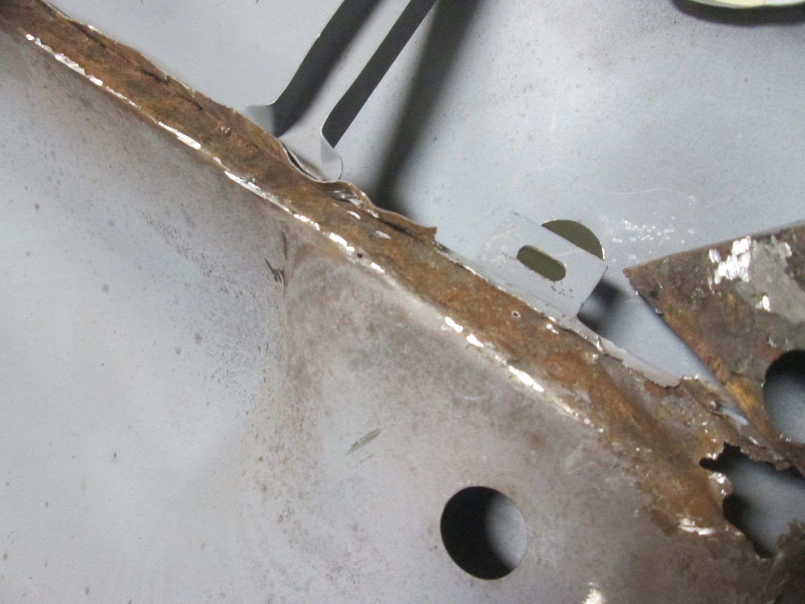

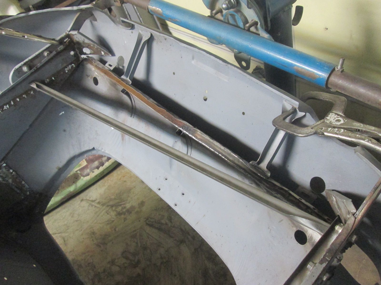

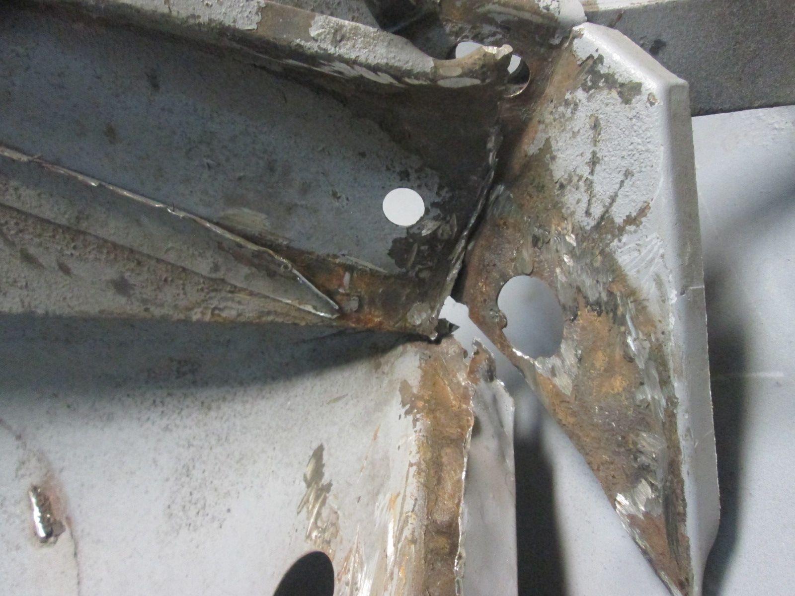

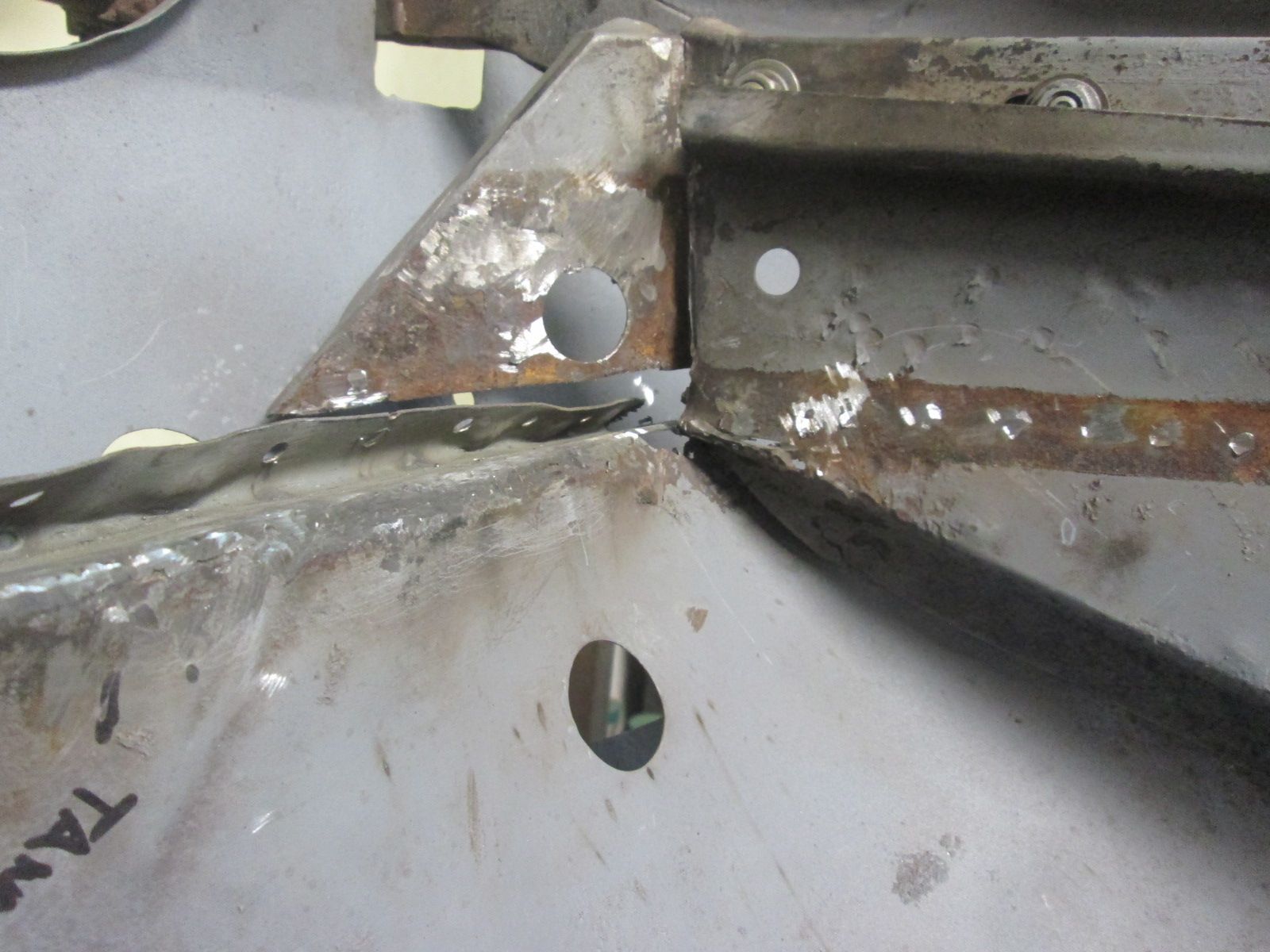

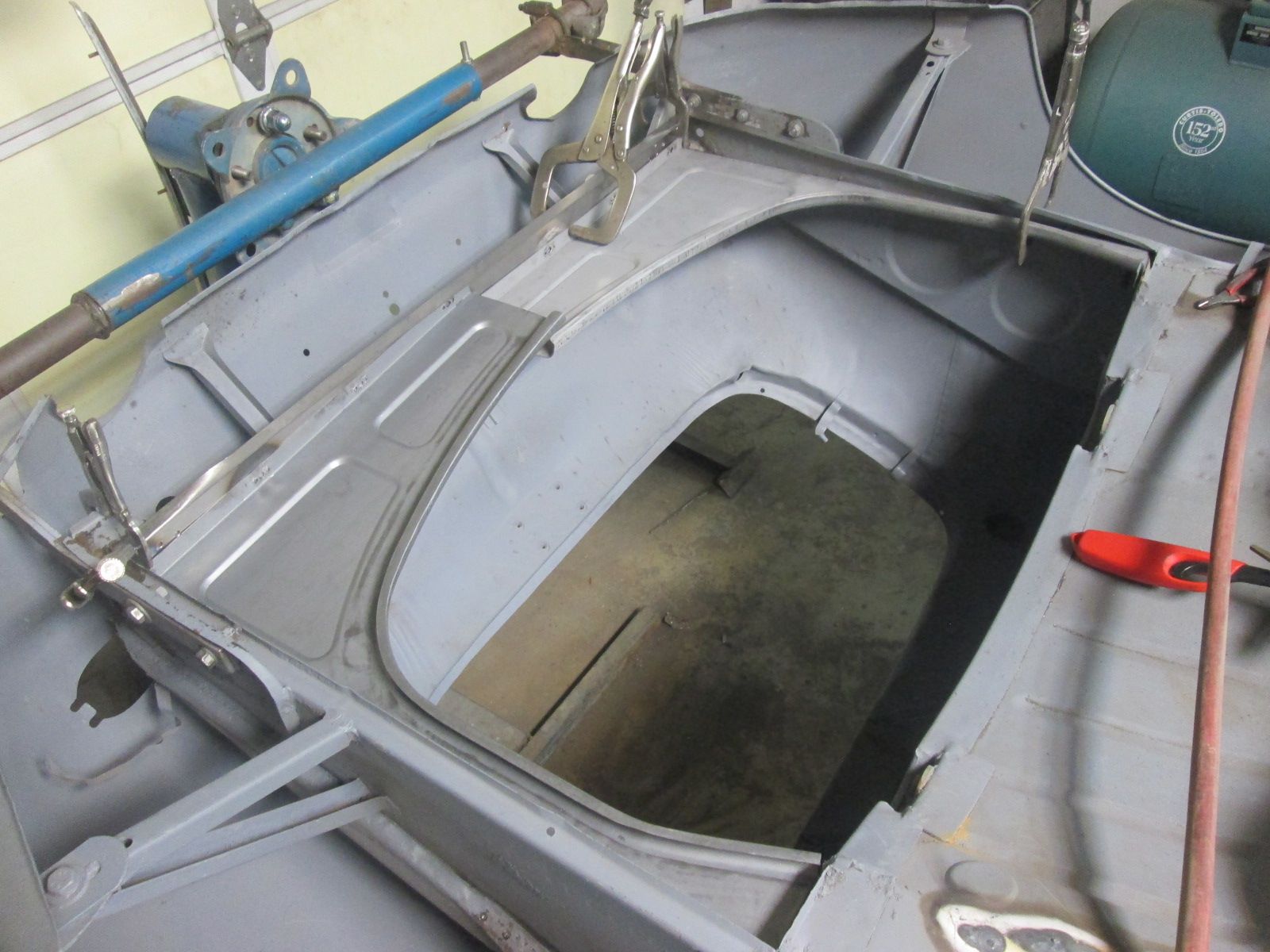

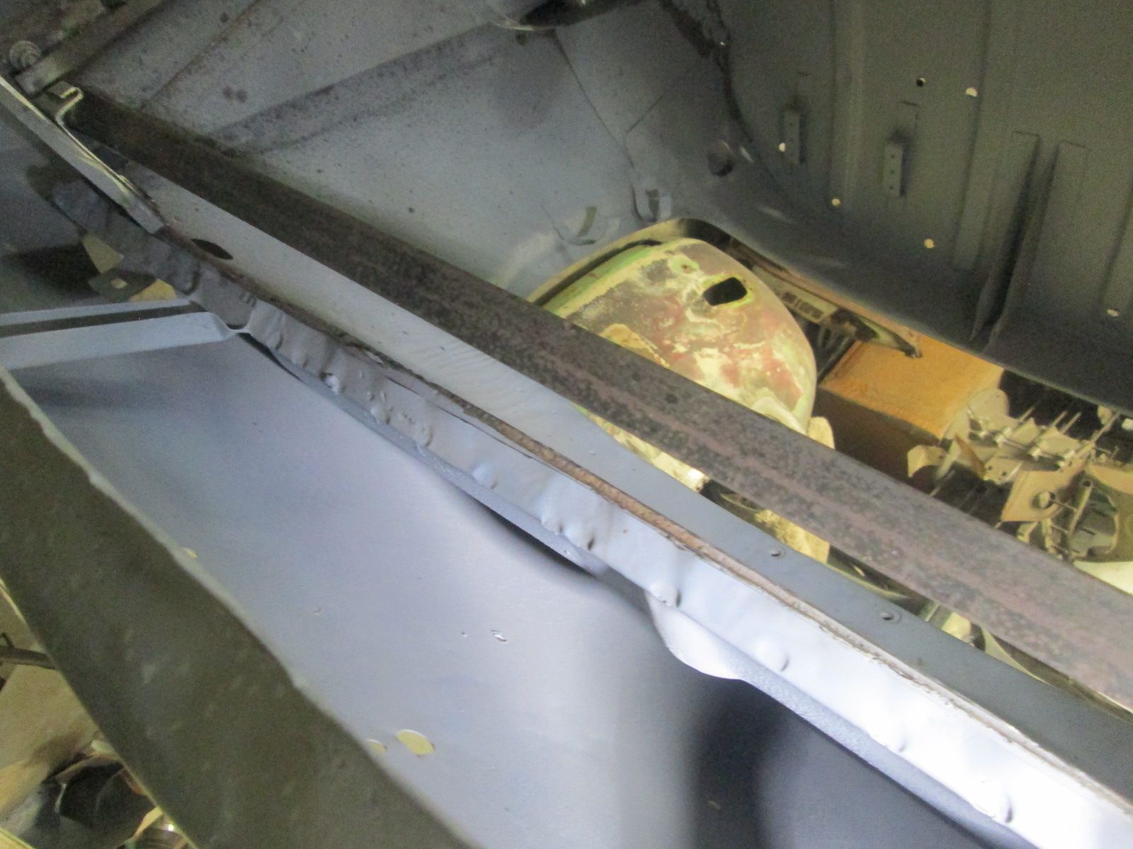

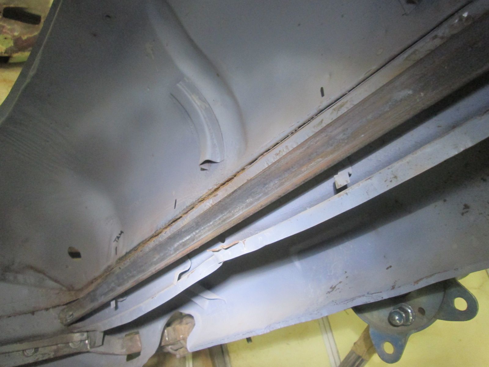

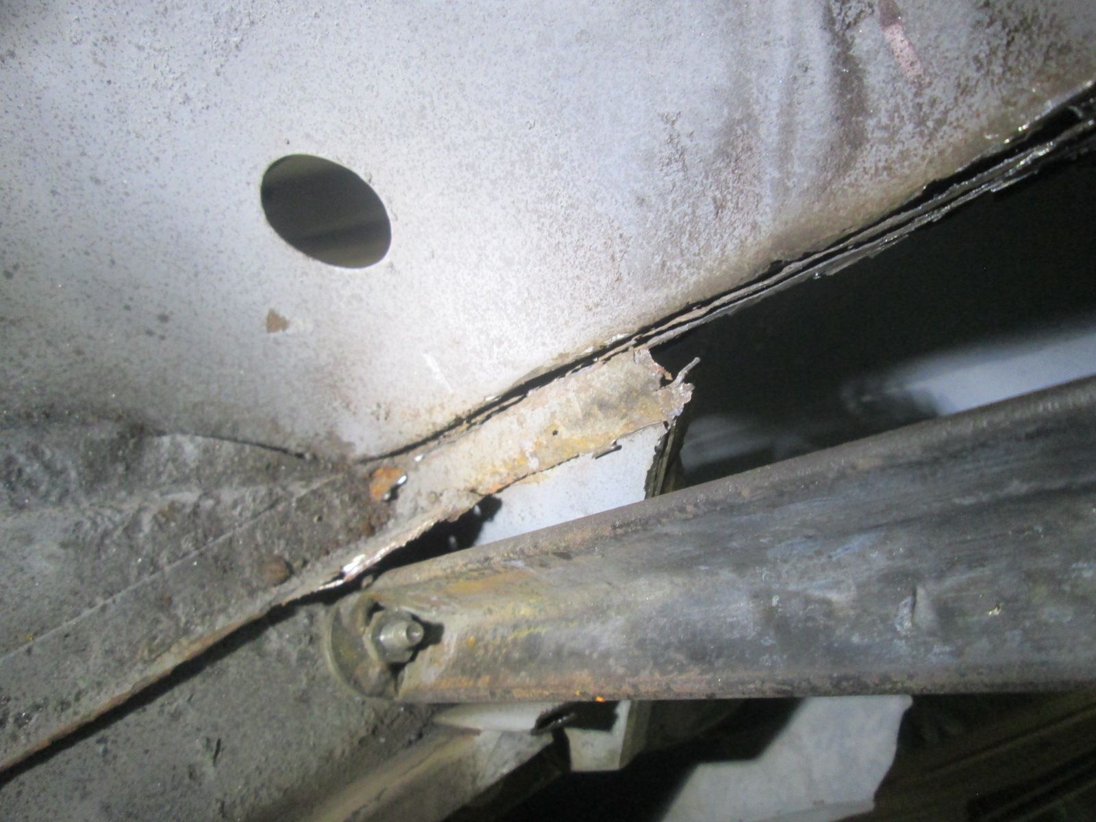

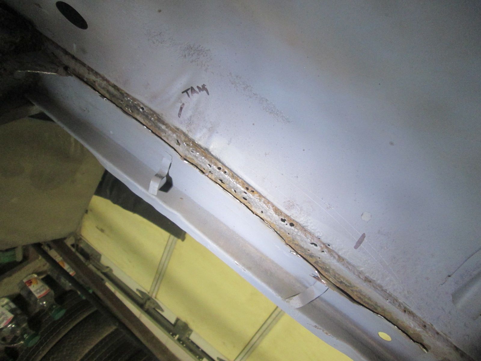

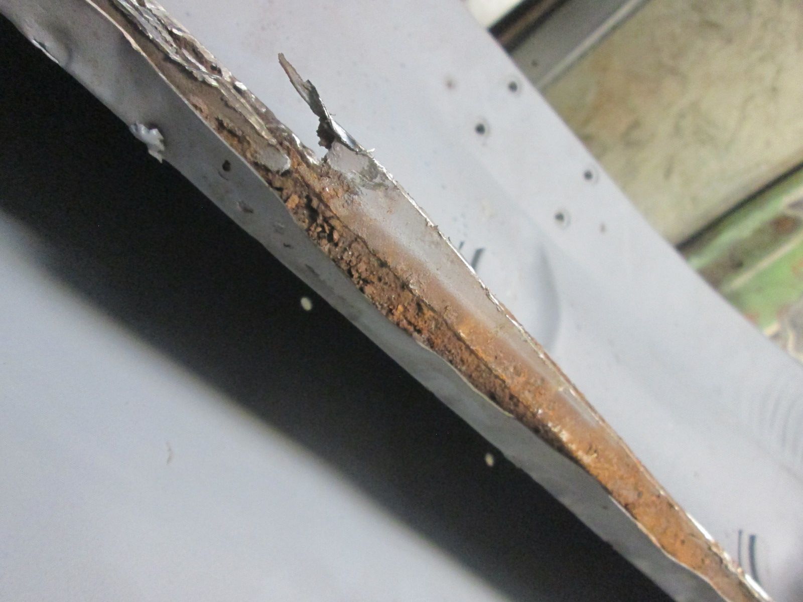

  • Rear cross member rust repair:
    Click image for larger version  Name:	IMG_3383.jpg Views:	0 Size:	190.2 KB ID:	117163 We have some rust repair to address along the backwall/rear cross member flange. The original engine shelf was cut out before the car came to me and I can only assume it didn't fare much better than this flange directly above it.

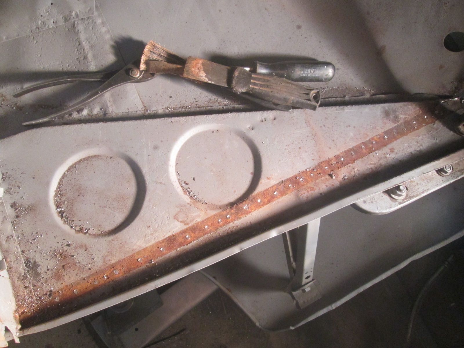

    Click image for larger version  Name:	IMG_3386.jpg Views:	0 Size:	199.1 KB ID:	117164 The rot is localized to the right side of this run only. With the left side intact I was thinking I might get away with just gas welding these holes closed. Began wire wheeling this area to get a better idea of just how far gone it was.

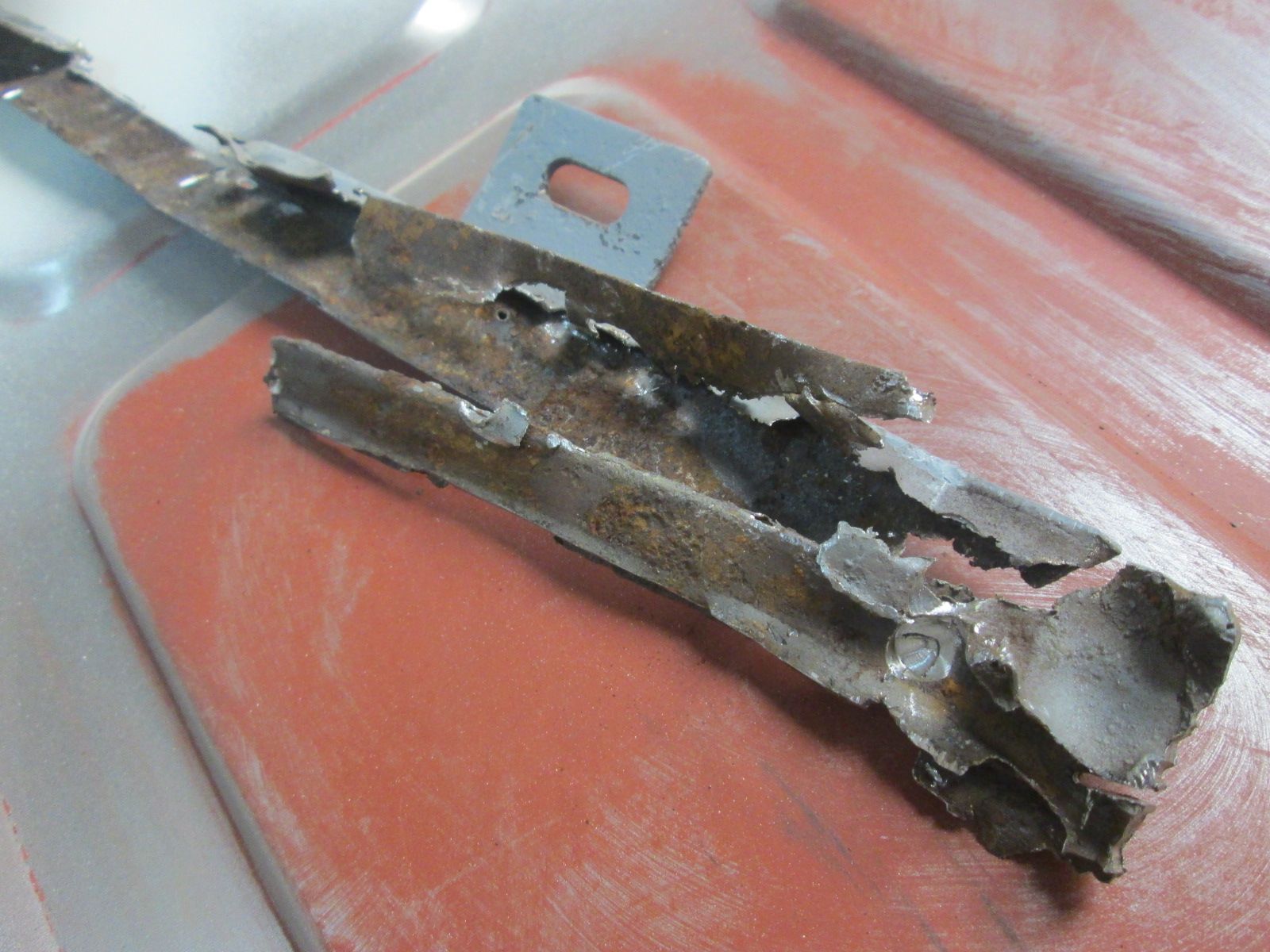

    Click image for larger version  Name:	IMG_3388.jpg Views:	0 Size:	175.5 KB ID:	117165 It was looking like I might get away with that approach but looking at it from the back side of this flange it was becoming clear that it was a bit too advanced. You can see in this shot that the wrap around flange of the closing wall as also rusted through.

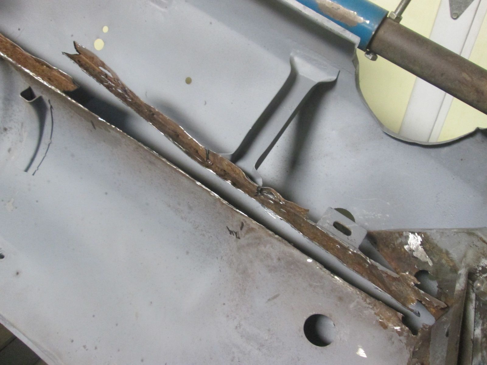

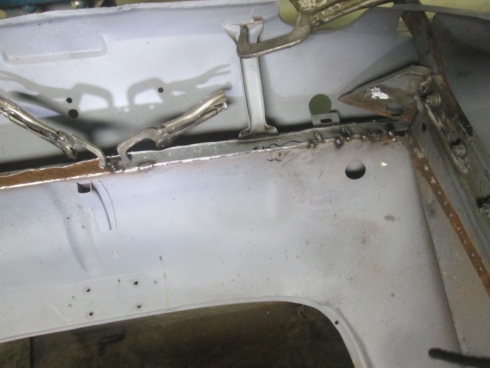

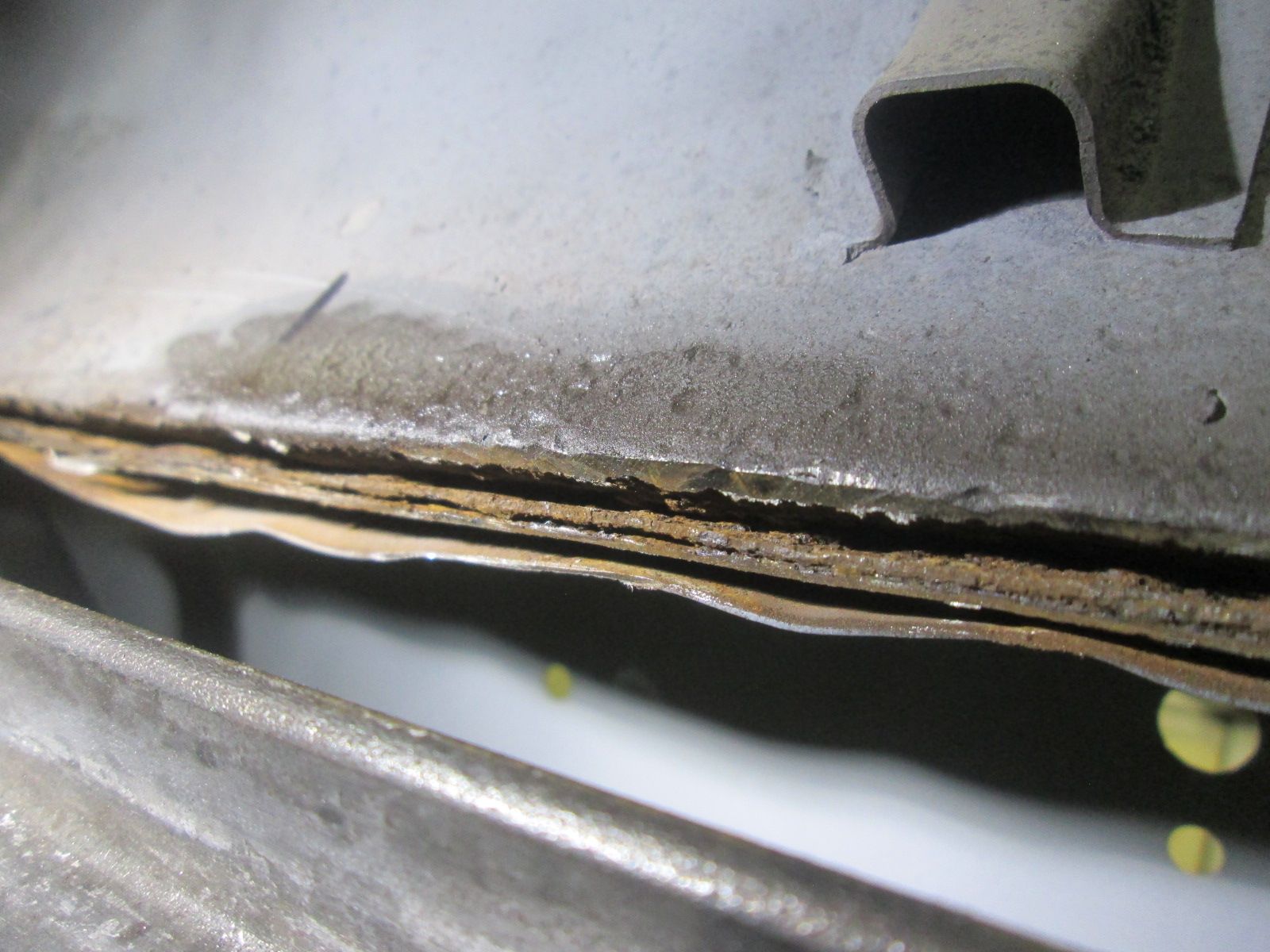

    Click image for larger version  Name:	IMG_3389.jpg Views:	0 Size:	222.8 KB ID:	117166 Too much heavy scale and advanced rot down in this joint to leave behind.
    Click image for larger version  Name:	IMG_3390.jpg Views:	0 Size:	184.0 KB ID:	117167 The light shining from the front side here shows more breaches above and around the bumper mount flange. To fix this properly the entire cross member would have to come out.

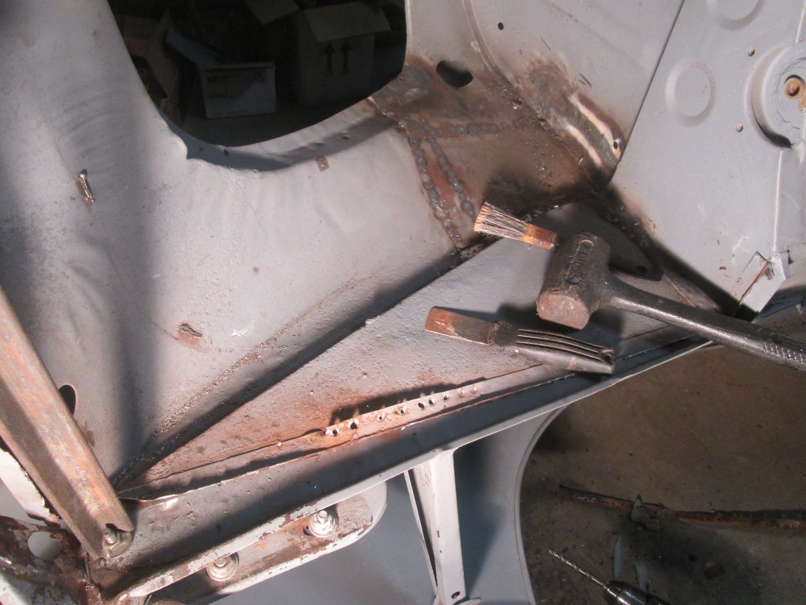

      • Flange clean up and beginning corner clean out.
        Click image for larger version  Name:	IMG_3399.jpg Views:	0 Size:	206.4 KB ID:	117175 Needed that angle iron out of my way to wrestle this the rest of the ay out.
        Click image for larger version  Name:	IMG_3401.jpg Views:	0 Size:	200.9 KB ID:	117176 All coming free with only what remains at the corners along the outer bumper mount gussets.
        Click image for larger version  Name:	IMG_3398.jpg Views:	3 Size:	205.2 KB ID:	117177
        The tricky part next. The corners remain intact so I'll have to unpeel this onion without damaging the outer bumper mount gussets and the frames side walls.

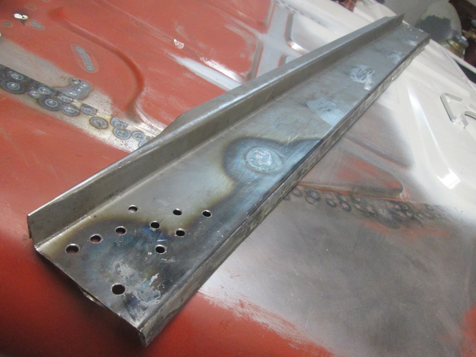

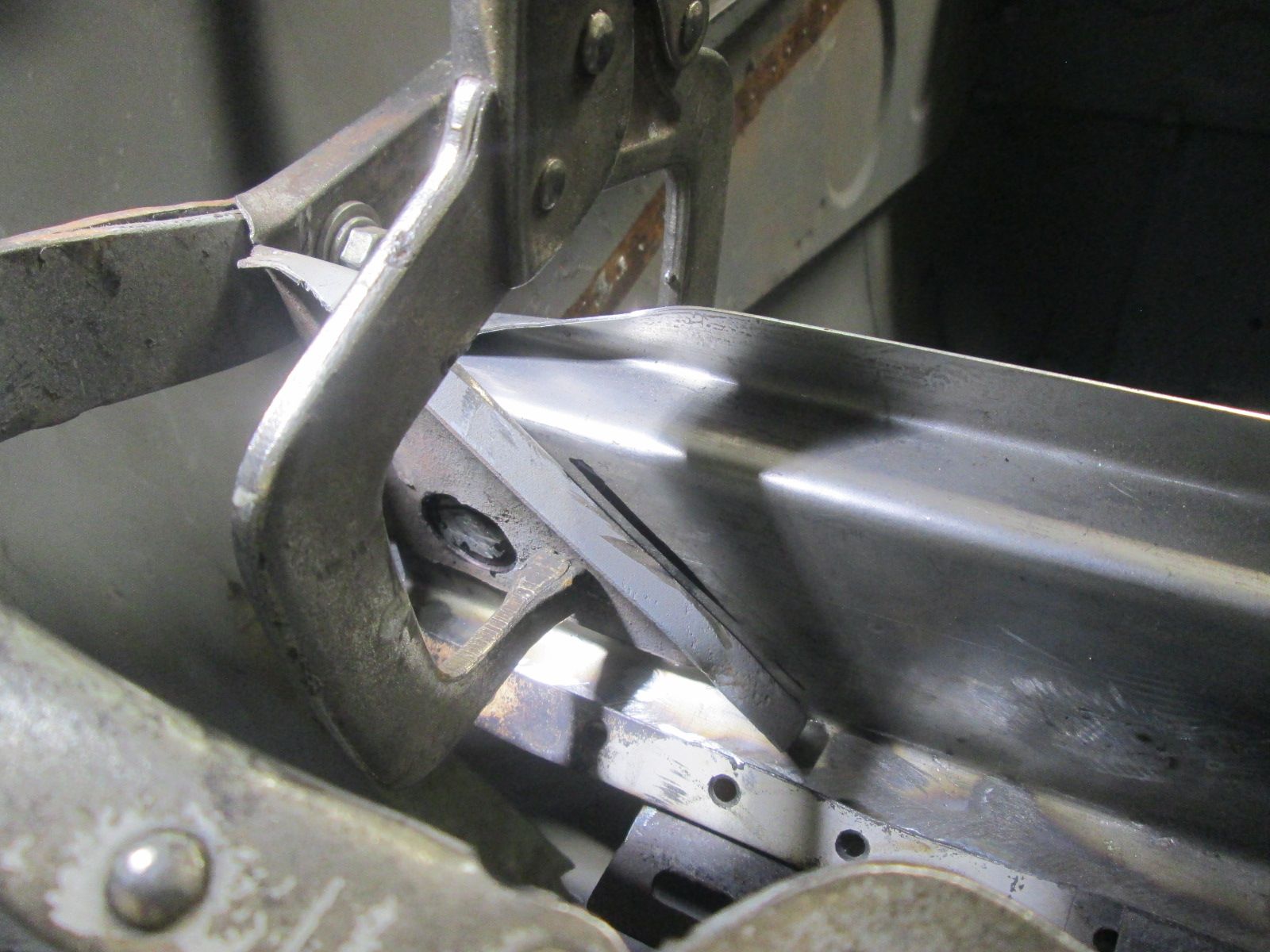

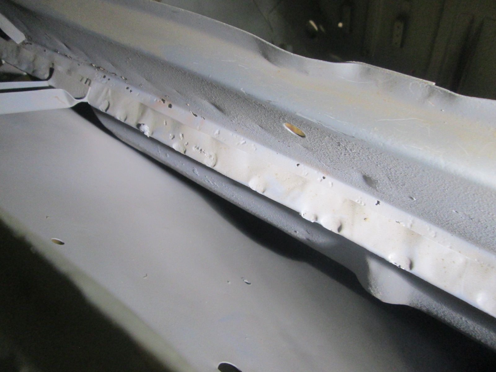

        • New cross member prep:
          Click image for larger version  Name:	IMG_3402.jpg Views:	0 Size:	189.2 KB ID:	117181 Getting the inside of that gusset cleaned of old crossmember bit by bit. This cleanout was extremely tedious so I had to take breaks from it.
          Click image for larger version  Name:	IMG_3387.jpg Views:	0 Size:	198.0 KB ID:	117182 In between the long grinding sessions in those corners of the frame I needed a break and began prepping the new crossmember for installation.
ID:	117183 This car is so late that the factory finally ran out of crossmembers with these pre- punched elongated holes for the 1956-57 removable engine shelf. Even though they hadn't been utilized for a couple of years the earlier 59's still had these holes lurking under their welded in engine shelves.
          Back filled for a correct late '59 appearance.

ID:	117185 Welds dressed smooth. Double folded upper flange detail replicated for appearance and increased strength and rigidity. Like most frame components this new part is made from 20 gauge whare the original was 18 gauge. Not the end of the world back here as its not critically load bearing as the technical end the chassis is at the trans hoop mount but I'm glad to muscle it up were I can.

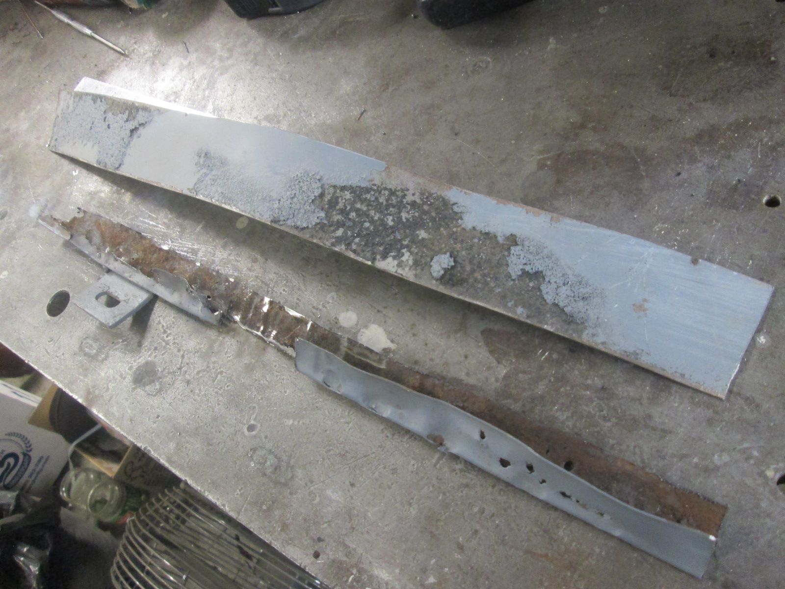

            • Flange clean up continued.
              Click image for larger version  Name:	IMG_3413.jpg Views:	0 Size:	234.4 KB ID:	117205 Finally touched bottom in this left corner. Gusset and pinch seam cleaned of the last remains of the old cross-member. Still have to clean off that strip of metal down the sides of the frame which was the old mounting flange. That a bit later.
              Click image for larger version  Name:	IMG_3423.jpg Views:	3 Size:	193.8 KB ID:	117206 Moving over to the right side of the pinch seam. It became clear that this side did not fare well and was too thin and compromised to salvage.
              Click image for larger version  Name:	IMG_3424.jpg Views:	3 Size:	188.4 KB ID:	117207
              Decided to replace the entire right side of it. Didn't replace more than I had to though and made my break line right whare the severe rot ended.

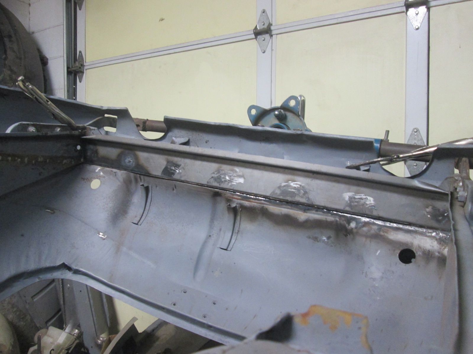

                    Click image for larger version  Name:	IMG_3466.jpg Views:	0 Size:	203.6 KB ID:	117254 All stitched and dressed right up to the corner.
                    Click image for larger version  Name:	IMG_3468.jpg Views:	0 Size:	191.0 KB ID:	117255 New lower cross member just about ready to go in but before I could do that I had to repair these additional rusted out areas along the sides.

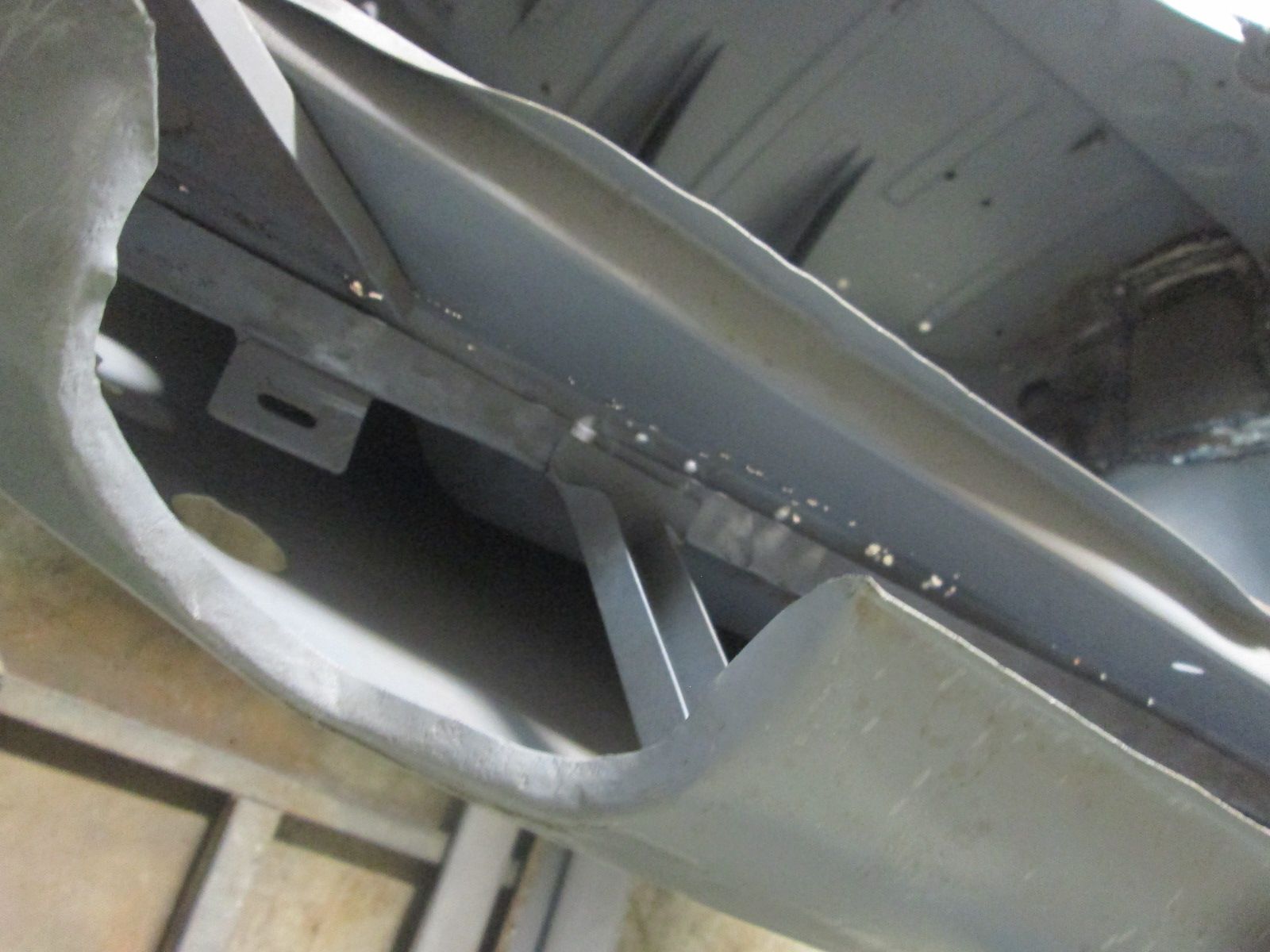

                    • Begin fitting the new cross-member.
                      Click image for larger version  Name:	IMG_3469.jpg Views:	3 Size:	226.6 KB ID:	117260 With the new flange fully installed and dressed I could finally begin fitting the new cross-member. Of course it begins a touch too wide as this was as far as it would go on the first try. Bottom leading edge of the cross-member gets a simple folding over in the corners to seat into the side wall flanges.
                      Click image for larger version  Name:	IMG_3471.jpg Views:	3 Size:	188.3 KB ID:	117261 It took a series of repeated test fits and fine trimming as it began slipping in closer and closer between the side walls before finally seating squarely and tightly against the corners.
                      Click image for larger version  Name:	IMG_3473.jpg Views:	3 Size:	219.9 KB ID:	117262 Corner gusset foot print traced to so I could drill for the plug weld holes.
                      Click image for larger version  Name:	IMG_3474.jpg Views:	3 Size:	209.2 KB ID:	117263 Dismounted one more time to drill the holes as well as other last minute prep before it goes back in for good.
                      Click image for larger version  Name:	IMG_3475.jpg Views:	3 Size:	215.3 KB ID:	117264 New Cross-member back in for the last time. Before I began welding, I dug out the new engine shelf to both test for square and clearance. I try to never make the mistake of just assuming the next part is just going to drop into place...because it never does. Fitment here was close enough to comfortably proceed. Welding the cross member next.
