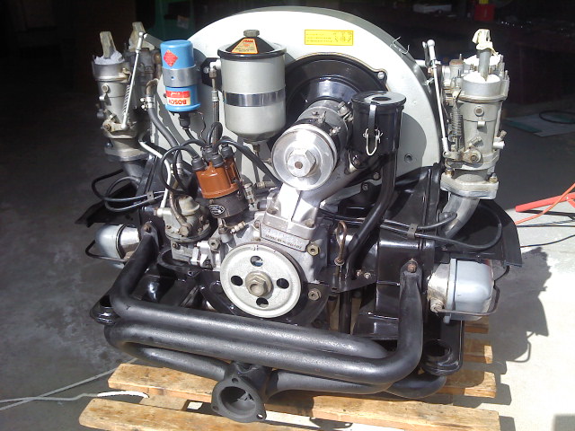

                          Here is a pic just before it went in.

                              Hey MIC,
                              RE your exhaust system in the pic.
                              I know that you have talked about it before, but it reminds me of the EMPI that I had on the Roadster in the 70s.
                              Did you build it?
                              Looks nice.
                              • #60
                                JR -- Can't take credit for my exhaust. The engine builder put it on back in the late 70s/early 80s. I did see one at the Hershey swap last year for $75 though. Should of picked it up because I do like it. Seems to be well built & fits nicely. It mounts onto the stock j-pipes. No idea who made them & can't find a similar one searching the web.
