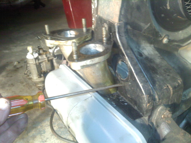

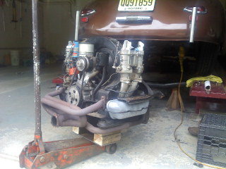

    I removed my engine to replace the mounts & clean everything up, paint tin etc. I thought removing the tin would be easier than I'm finding it to be. The side tin pc. in the pic does not come off unless I remove the intake manifold also. But, I cannot remove the intake easily without removing the same tin pc. Is there something I'm missing? It seems when going back together they will need to be installed at the same time & I will need to reach into the spark plug openings in the tin to access the inner intake nuts. Is this correct? I should mention that I have no idea what intakes I have as my engine has 48ida Webers. Maybe that's the reason I'm having difficulty?
    Here is the intake.
    I think I found my answer. I should of researched more before posting here but here is what I found. The intakes I have look to be for super 90 or 912 with solex 40 carbs. The tin I have is for non solex 40 carbs. The tin I need is split. See the Stoddard link below. No wonder it was a pain, two pc. tin would make it easy.
    I should know by now that nothing is simple. It looks like I'll slice these & weld a tab on one side.

        48IDA's? Really? And on those manifolds? Hmmmm...pictures please.
        I see them in the background I think. What jetting? Cam? That's a heck of a lot of carb on a 356!

          I was thinking the same thing Craig; dual 48's are way too much carb for any motor under 2000CC's. In the late 80's I bought a pair of 44IDF's from Harry Pellow for a 912 motor with a 1720 big bore kit with a stock 912 cam. Even they were too much and I had no real bottom end torque. I ended up taking the motor to a Porsche mechanic who put in smaller venturies and rejetted them. After that the motor ran great! Those new venturies in my 44's choked them down to perform like 40IDF's. Bigger is not always better I suppose especially if it overwhelms the capacity of the engine... Maybe Mic has his 48's chocked down to work properly with a 356 motor??
          Right Mic, Later Split tin must be used with the later solex or Weber style manifolds if you want to be able to remove them without having to tear down the intake system..
            I know you are all interested in my engine, as am I. The back story is My Dad's friend Hans Ziereis built a hot street motor for it early to mid 70s. My Dad had all the tins, etc. sandblasted & dropped them off. Miscommunication & the oil fill was never cleaned out completely so it didn't last very long. A tired loaner was installed while this engine was built in the late 70s. It then sat until maybe 1995 when it was finally installed.
            At the time it was built I was in my late teens & involved in other things so didn't pay much attention. The rumors were it had "all the best parts". Now I'm finding out maybe not? It does run good even though it is kinda flat below 3200 rpm. Rich? Yes very rich but doesn't foul plugs.
            What I know for fact is a 912 case, 48 ida, old style steel rockers & now 912 intakes. The rumor is the cam is a custom racing grind designed by Hans. Since it is reliable I see no reason to tear it down just for curiosity.

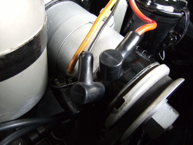

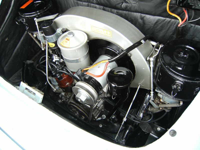

              Next question, on top of my generator is something that looks like a condenser. My memory tells me it has something to do with limiting the radio interference? Can it be removed?

                  Mic,
                  Sure looks like the 'supressor' fitted from new to my car probably by the importer to the UK when they fitted the Motorola valve radio. All my cars in the 60's had them fitted I remember well a mini that didn't have one. Everytime he came past my mum and dads house it made the radio 'crackle' like mad. My dad used to say 'that blighter ( a term I never understood ) is outside again!
                  So I have kept both mine on the car if you look at the 1st photo its fitted on the bracket between the oilfilter housing at the top and the coil.You can just see the top of it. That one is connected to the coil. The second one is to the generator like yours.In the 2nd photo an old one I took years ago you can just see it. My dynamo assembly was last removed in 1965 the position for the wiring connections is some degrees past where it should be like yours. I know this position suits the 356C because of the different oil filler and clearance for wires. I guess the Porsche mechanic of the time just did it that way when he worked on my engine soon to be 50 years ago!!
                  As I understood it you could have more than one supressor fitted to the car to supress more than one electrical item? thats why I have two of them/
                  I guess you could re-route it to another position, To prove our assumption is correct you could remove and try a radio by the side with the engine running In saying that maybe current radio's have something to overcome the problem fitted in them now??

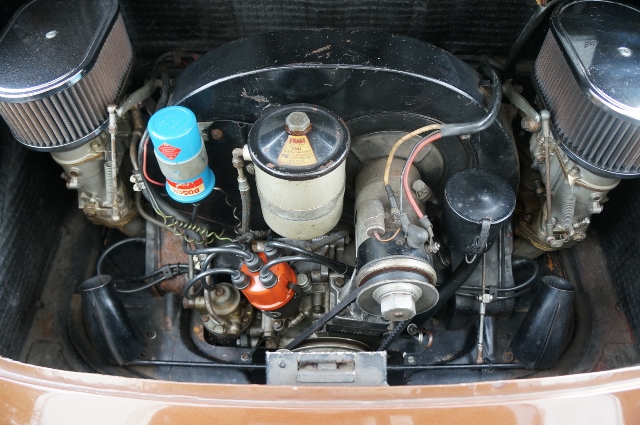

                  [attachment:1]2013_1087 bday356enginenormtimmeissen 011.jpg[/attachment]
                  [attachment:2]2012_1042 regulatordynamowiring 006.jpg[/attachment]
                    Mic,
                    No picures came out I try again!
                      Thanks for the pics Roy. Your engine looks so nice. I'm going to use your picture for inspiration. Did you paint all of the tin glossy? I was thinking of doing that to mine even though it's not original. I think the gloss looks so much better.

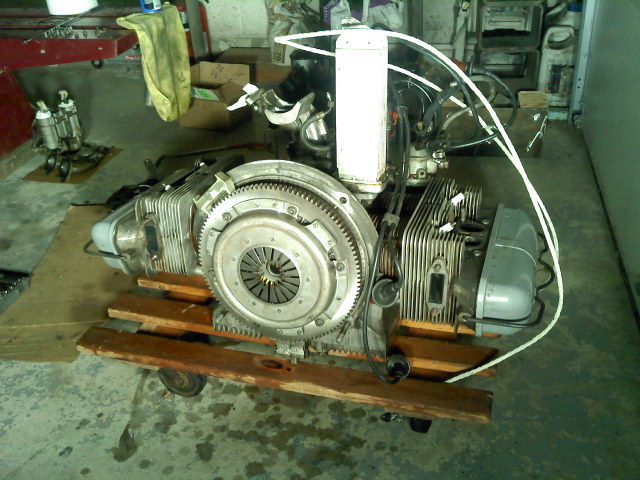

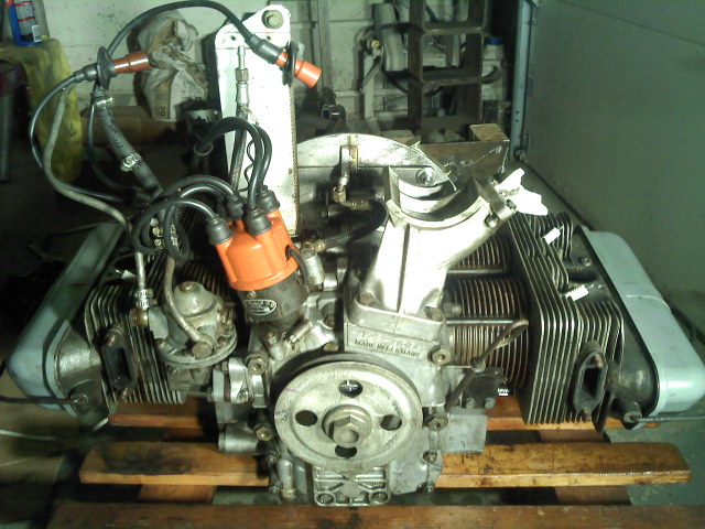

                      As it sits now. Just washed it off in 20*f temps. That was cold. It wasn't to bad but a few small leaks that attracted dirt. The engine fill was not real tight on the gen stand, one tin screw was missing where it goes into the rocker box & it seems the pulley seal may be starting to leak.
