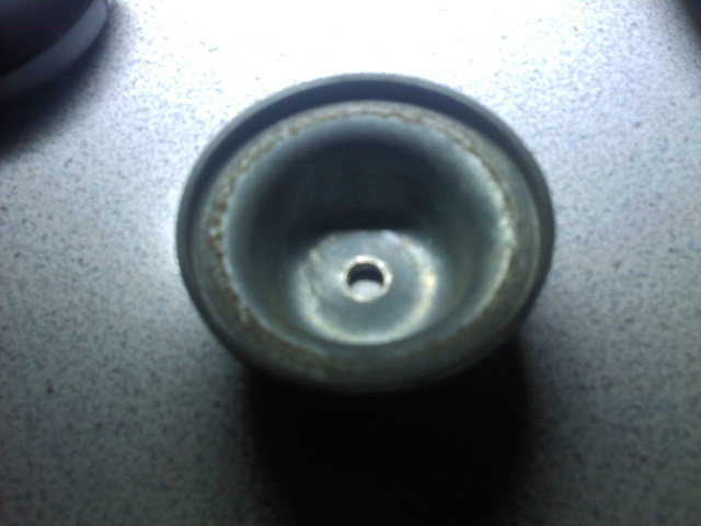

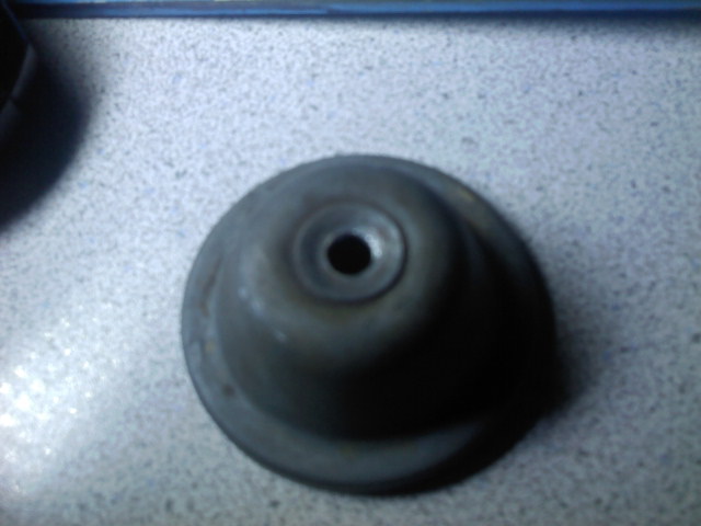

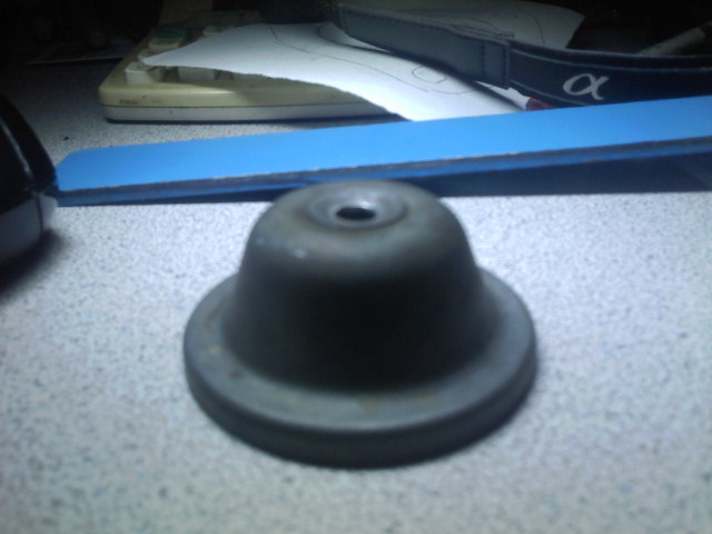

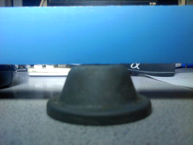

    Another question. Being curious I couldn't wait for the new gasket to remove the "bell". The top bolt area is slightly dished, the bolt boss is even with the top so if I just set it on a table it won't push out. It looks like I would need to set the top on a pc. of pipe or socket to massage it flat. I would set the top outer diameter on a socket not the flange with the gasket. Being that it is a casting I am apprehensive about doing this. Should the boss be up above the outer top rim?
    How much will it actually bend before cracking?
    I will wait for the new gasket to see how it fits, maybe doesn't need any straightening.

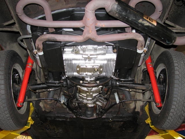

      I kept looking for the old EMPI flyer that I got with my exhaust system in the mid 60s (or so) I guess it was, but couldn't find it.
      The Bursch system got put on 9/26/86 and has been fine ever since. It didnot get prettied up during the engine rebuild and replace.
      I should have done that so it would look as nice as yours.
      This pic is after the engine rebuild, showing the new Konis and the Bursch system.
      I guess they don't make the 'bullet' mufflers anymore.

        Mic, that is collapsed quite a bit! Generally, I usually just set it upside down on an anvil and dolly it down with a large drift as far as it will go. One did crack once. Keep checking to see that it remains parallel to the base. You can file the threaded area down a bit for more crush.
        • #64
          Ditto what Jack said. I use a surface plate and an old plastic handle
          screwdriver to get it flat. Handle end on the cover, centered on the hole.

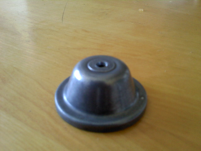

                  I was able to push out the top cap of the fuel pump. I used my hydraulic press & went a little at a time. Very over kill but controllable. I thought a hammer & drift would have more chance of cracking it.

                          Here is a pic of the top fuel pump cap after straightening. Now it has maybe just shy of 1/8" between the inside of the cap & the threaded boss for the hold down bolt. Plenty to snug up to eliminate leakage.
