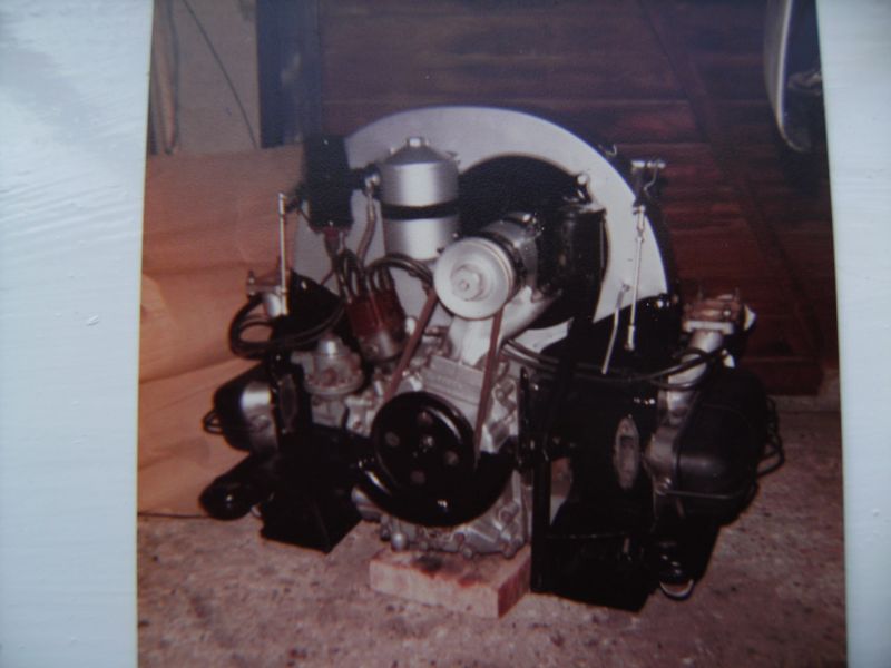

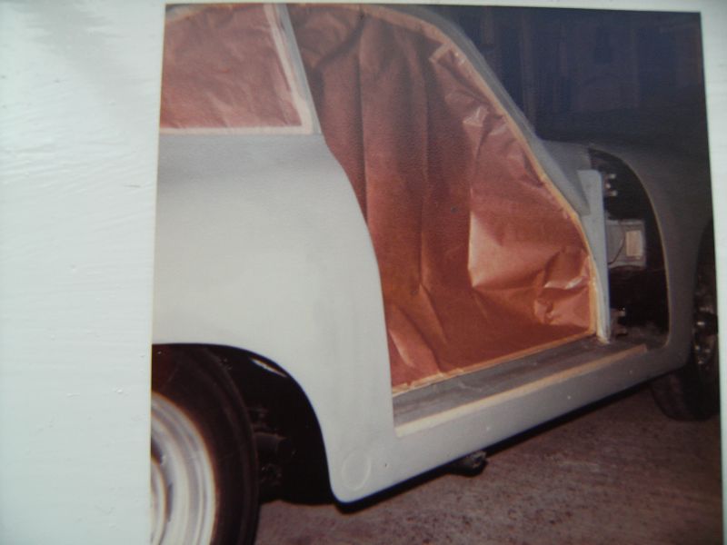

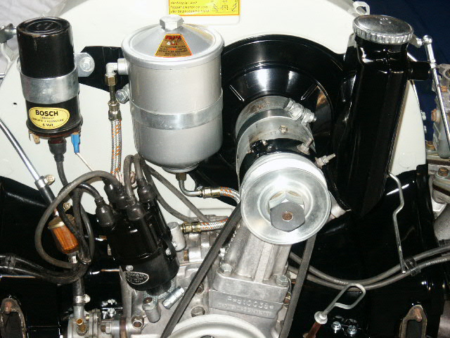

      Attached a pic of my engine in 71. The galvanised strap for the filter I sprayed black! now removed thwe paint back to the original finish. Likewise the rocker covers are now a silver colour.
      I pic of my first body spray job about 1977.

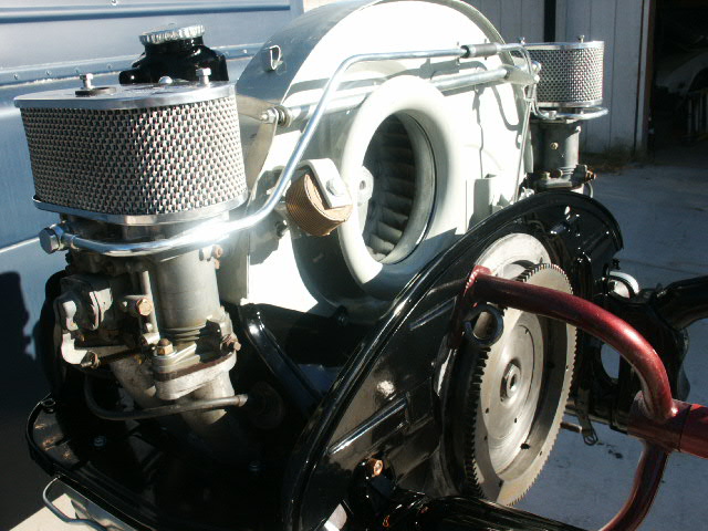

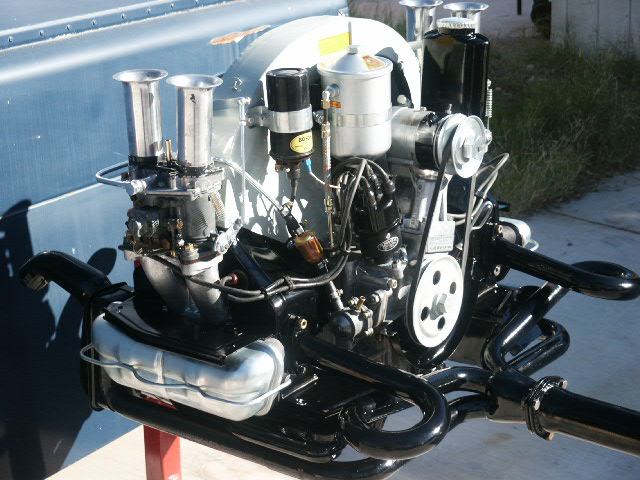

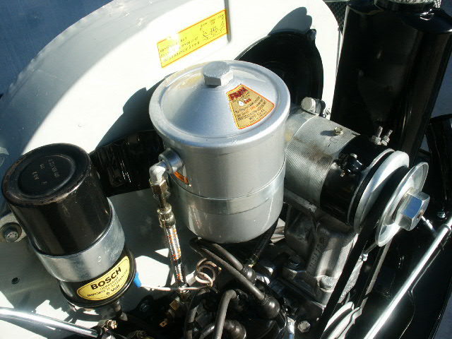

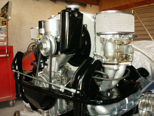

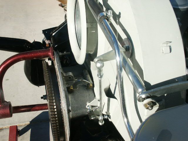

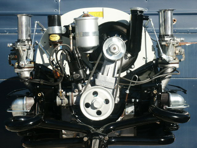

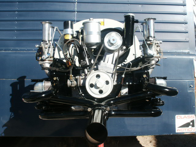

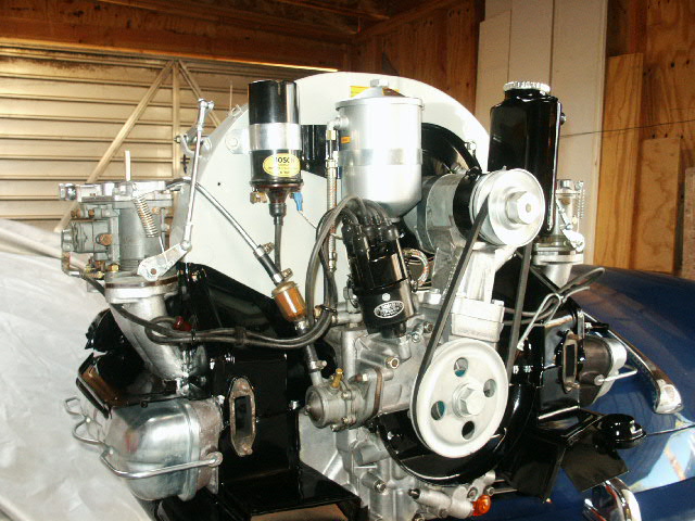

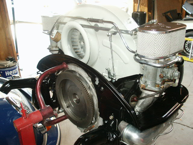

        Hey Mic, I have been meaning to post these for about a week now. They are of my old SC engine we rebuilt about 10 years ago to sell to raise money for my coupster project.
        1964 SC engine which came in a box with the old '56 coupe my father purchased. This was a hell of an upgrade when they installed this back in the day.
        Shroud was urethane painted in the correct off Grey-green color.
        Everything painted black was powder coated in the correct 30% semi-gloss black.
        Valve covers, bails, bolts, straps, pulleys, fuel line, air cleaners where all Zinc plated.
        I was shooting for top dollar at the time so We went the extra mile on full detail.... Justin

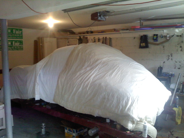

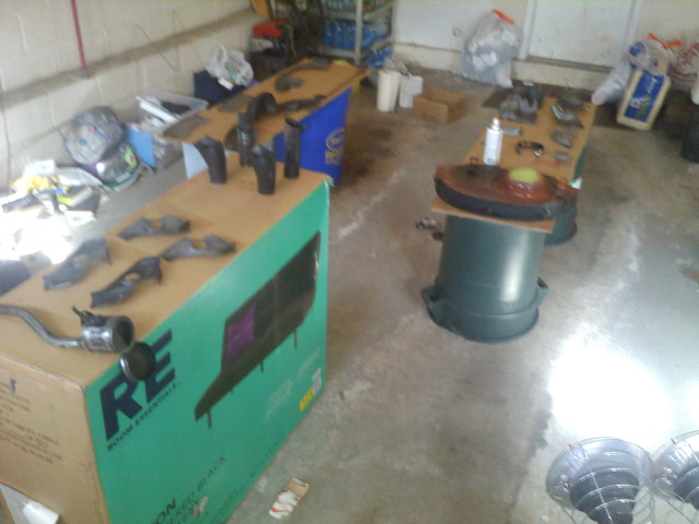

            It seems I can't find time to work on my car so I actually put today on my schedule to do some stuff. Started painting the tins, primer is going on. I settled on a gloss black top coat for the tins. I broke down and ordered the correct oil filter canister paint from Stoddard & also the silver fan shroud paint for late A supers although the shroud paint is on back order. I just hate paying $25 for a spray can.
            Due to the cold weather here I'm doing this in my house garage rather than my shop. Covered the car up & stinking up the house.
