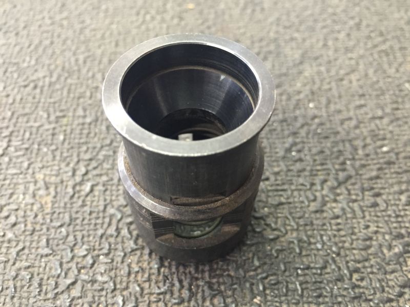

                I've had this tool for a while (like about 40 years). Calibrated from 36 to 44 mm.
                Anyone need it.....(cheap)?
