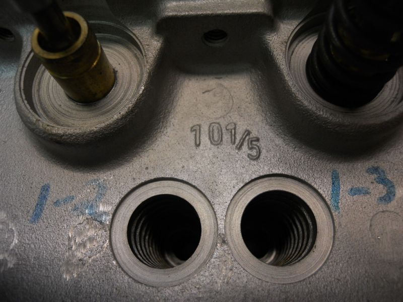

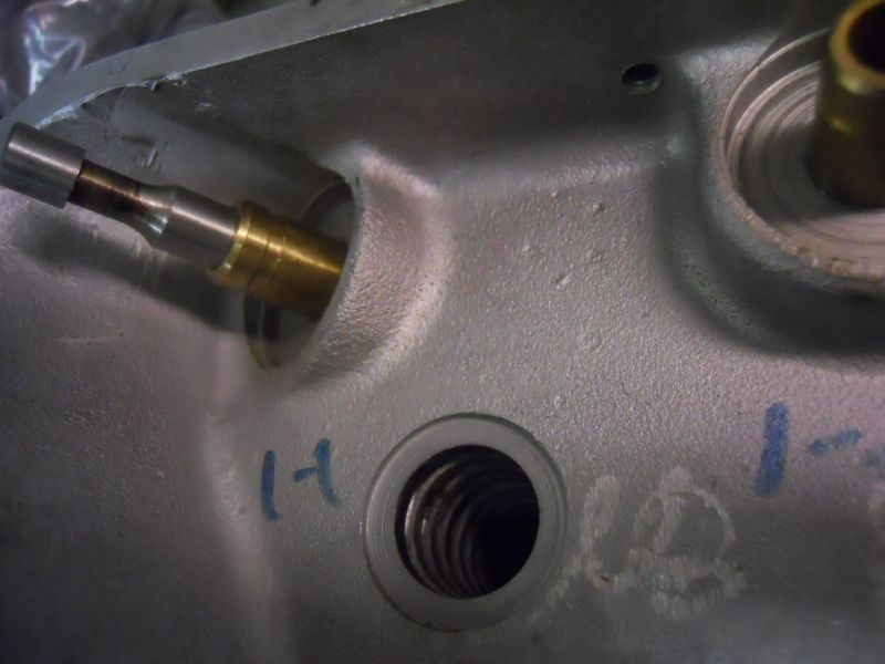

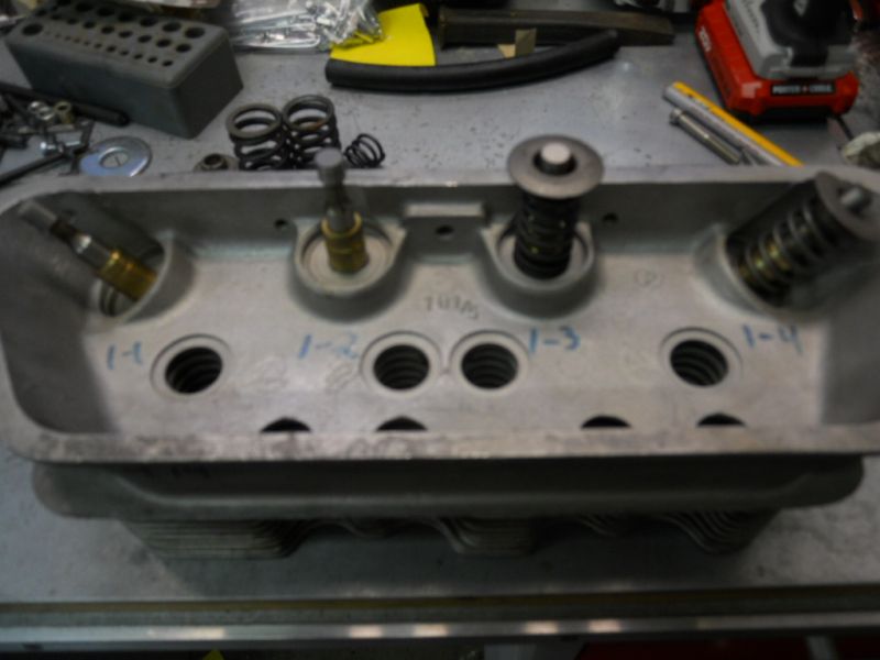

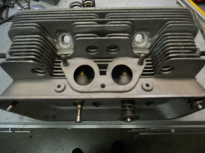

    Jack, i'm having trouble getting pictures on this forum anyway here's a little info on the heads.
    the only numbers I find on them is 101/5 this is cast in the rocker area.
    they have 2 studs and 1 long manifold bolt. also oval intake ports.
    no triangle wedges cast into the rocker area.
    sparkplug holes have helicoils.
    they have brass intake seats.

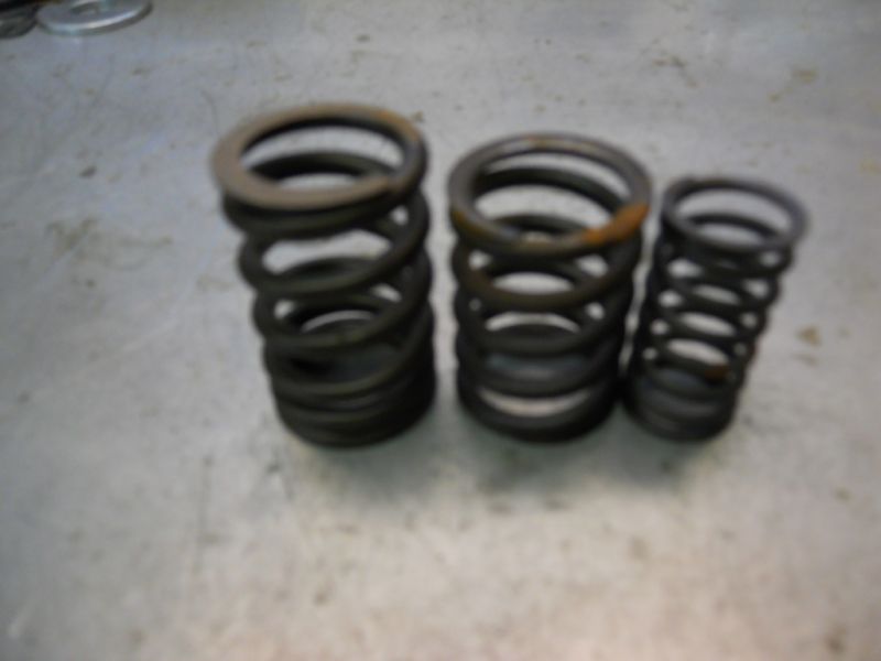

    the valve spring pockets have shims and the new springs fit as they should they are the same OD as the 2 piece springs.

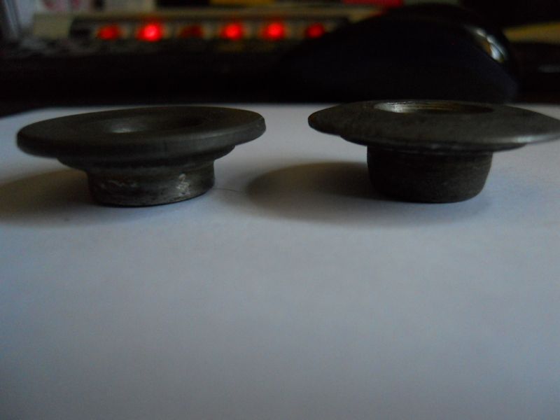

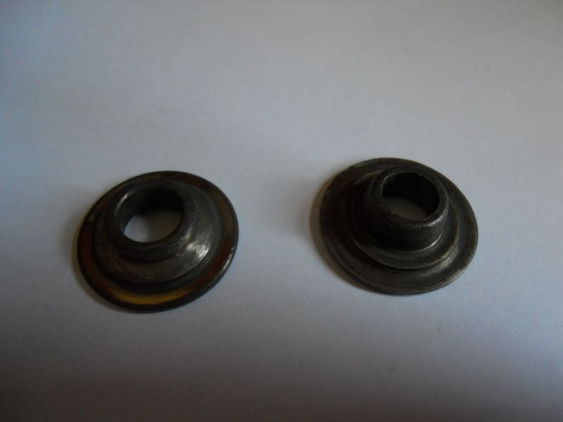

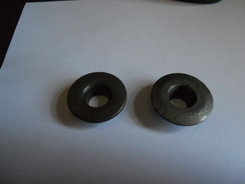

    the retainers I have are steel and are of the flat design 2 of them have been ground in the center to make the small center spring fit the retainer and are a different retainer flat style
    Jay D.
      Jay, the easiest way to post multiple pictures on this site is to only post a single picture on your first attempt. Verify that it worked, then by EDIT, ad another pic. Check, then add another, then add another, then add another, then ...ad nauseam.
      After a few pics, start another post, and also show pics of your heads from multiple angles, seats, valves... well, everything. You are well lost in the woods with Hansel & Gretel at this point.
      I am very interested to know how you determined compression ratio in light of this new information, but we will get to that once again, depending on your replies. At the very least, your heads will need more work.

        i would defer to Jack but hi mileage heads with brass/copper seats should have the seats replaced since they tend to fall out.

                What's the deal with the heat discoloration on the intake valves?
                  don't know that's the way they came new, maybe a heat treatment ?

                    Your heads are a menage'a different parts...no wonder there is such a 'problem.' Get Stellite seats, eventually set 'correct' springs (singles)(not Chevy) at 41mm after asking nicely and someone will likely offer you whichever keepers and retainers you wind up needing. I gave all my trays and racks of bins of those parts to Eric Wills, but I would (offer) if I still had all that collected "stuff".....but whoever posted that you either tied the hands of the machinist who did the heads or they didn't know squat about 356 heads....and either way, you should find someone else....that was good info.
                    Good luck with the unraveling,

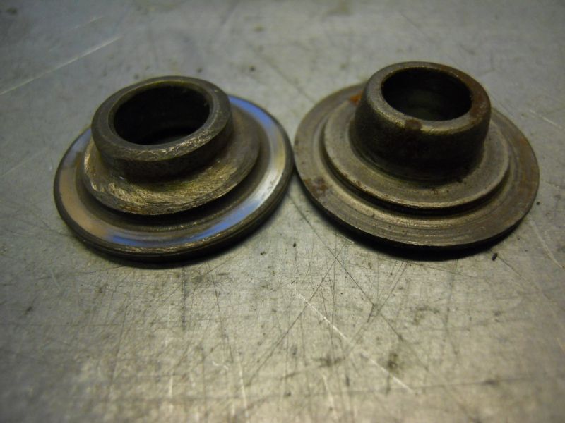

                      Jay, take a measurement between the spring perch on the head to the back side of the retainer, with the small springs that you have on in your pics, with NO shims in place. As Jacques said, you need 41mm on the intake and 40mm on the exhaust installed spring height for 6k redline, (lower redline engines can be a bit taller), but you always need at least one shim in place. Factory shims come in a couple different sizes, 1/2mm being thinnest. I'll bet that your numbers are going to be quite close to ideal with those old flat keepers. I sometimes fit them when heads need a big stack under the spring. Let us know the numbers you come up with.
                      PS: I would not install a head that did not have steel seats.

                              here's the info Jack wanted
                              exh. valve installed height is 42mm
                              int. valve installed height is 41mm
                              spring pressure is apr. 87lbs @ 42mm
                              spring pressure is apr. 90lbs @ 41mm
                              this is with the flat retainers no shims. now I assume that by flat retainers your talking about the one in my picture that have been ground on. as the other one won't fit the springs. i'm going to post some better pics. of the retianers
                              the problem is that the springs don't fit the retainers. that is the majority of the ones I have the small step on the underside of the retainer is to large. spring measures 22.3MM ID the dia. of the step on the retainer is 22.9. it looks to me the wire size is slightly larger on the new valves
                              i'm in agreement with you guys about the bronze seats i'm going to call Walt at CI tomorrow about changing them.

                                the one on the left fits correctly and I assume that's the flat one your talking about being the flat one. that's the one someone ground on so the small inner spring would fit on the 2 spring, springs
