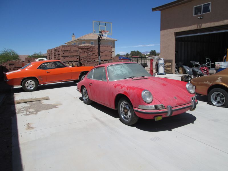

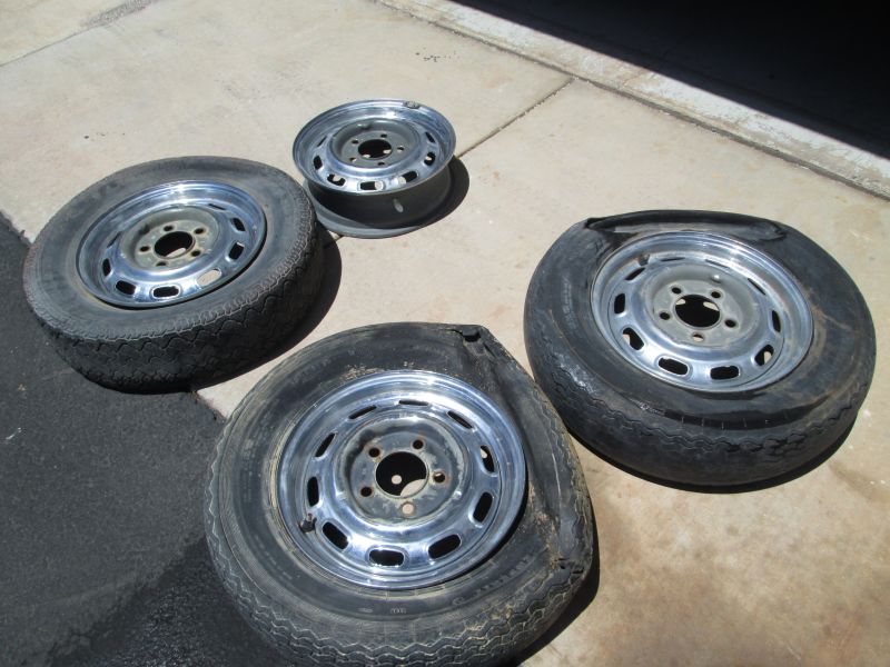

    Getting ready to put her back on the old steel wheels.
    Found something really cool while sifting through old paperwork trying to locate the cars title. Its an old recipt from automotion, care of Foreign Auto Supply (remember them?) dated April 13, 1968 for a set of Semperit tires.

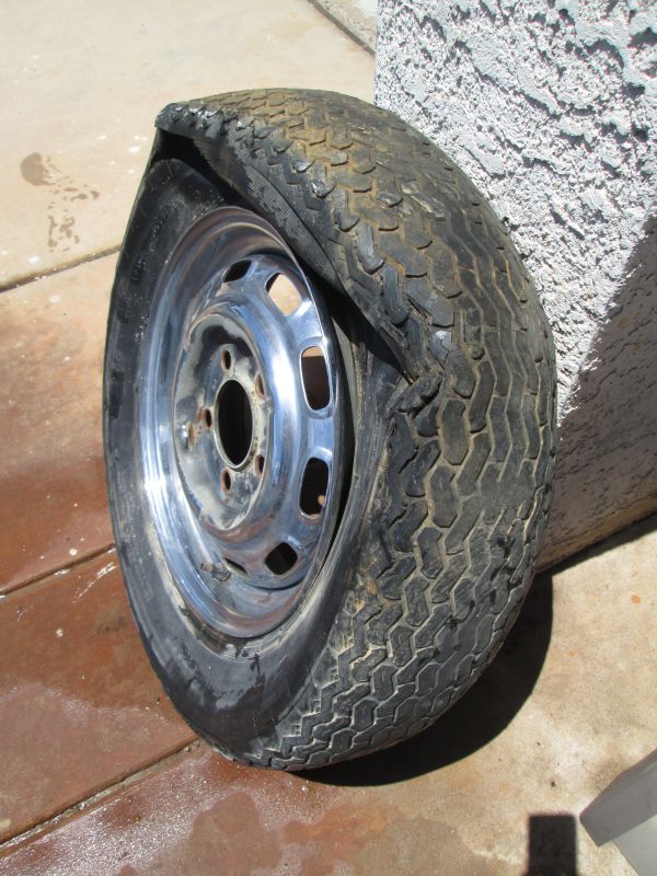

    This is one of two from that old set that managed to hang around all these years.

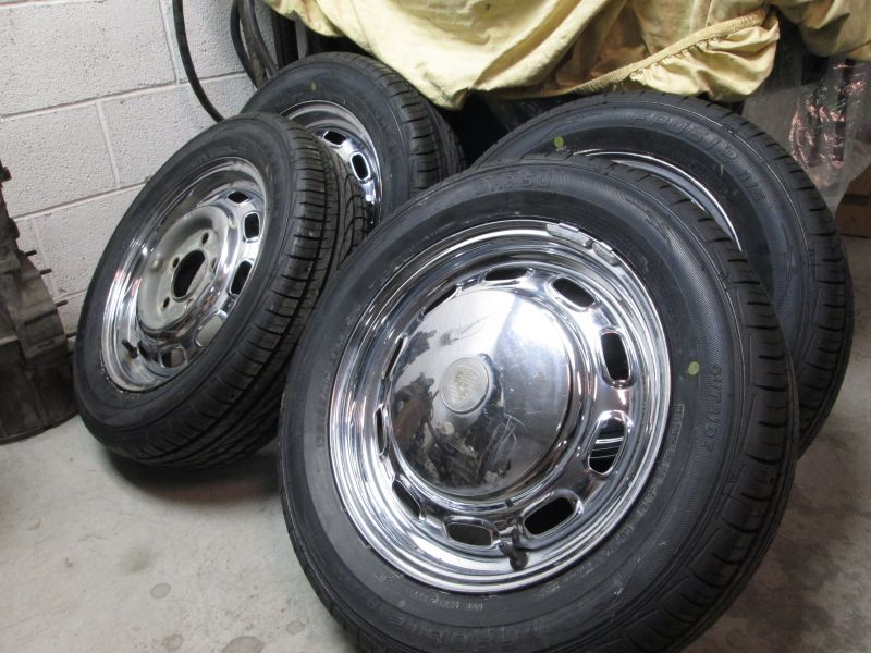

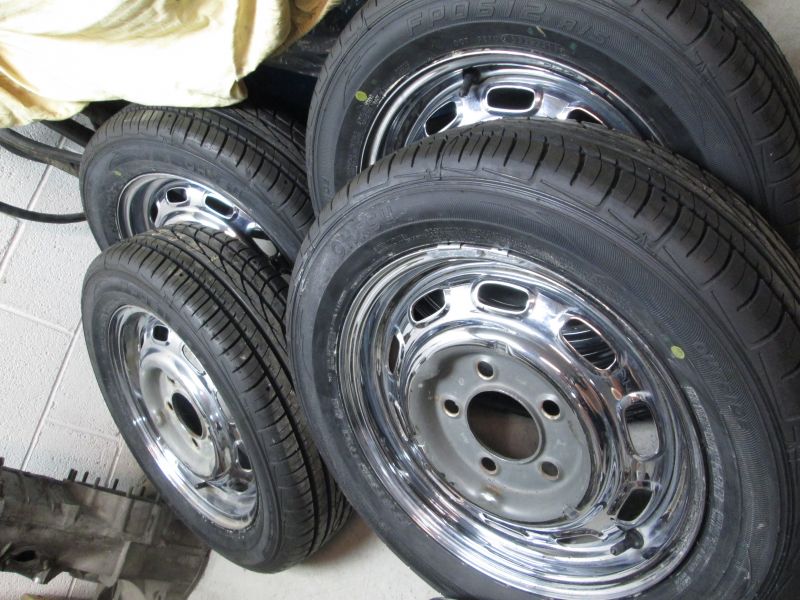

    End of the road for them today as its off to the tire shop for some fresh rubber so I can roll this car around.
    • #62
      new rubber
      Wasn't picky about the tires or brand as I just needed them to be round and hold air. These are 175-65's and they look pretty nice on those narrow 4.5 inch wheels. The original chrome BTW cleaned up pretty nice. Not perfect and one of the wheels of course did not fare as well as the other three but they are all really nice driver quality. These have been rolling around loose and where of course not stored carefully for over 40 years. Like most people we didn't care about those ugly old steel wheels; Porsche alloy's was what is was all about then. Fortunately the dry desert climate saved us from our mistake.

      All the wheels here are Lemmerz but the wierd thing is two are dated 7/65 and the other two are 8/65. The spare(not pictured)is actually a KPZ in chrome. Through my 356 experience they should all match perfectly but these for whatever reason do not. This is how it left the factory as these are the wheels that have always been with this car and we certainly never bought any additional steel wheels. It was Porsche alloy's only. We didn't care about the hubcaps either. I've only managed to find one but I'm optimistic I'll find the rest.

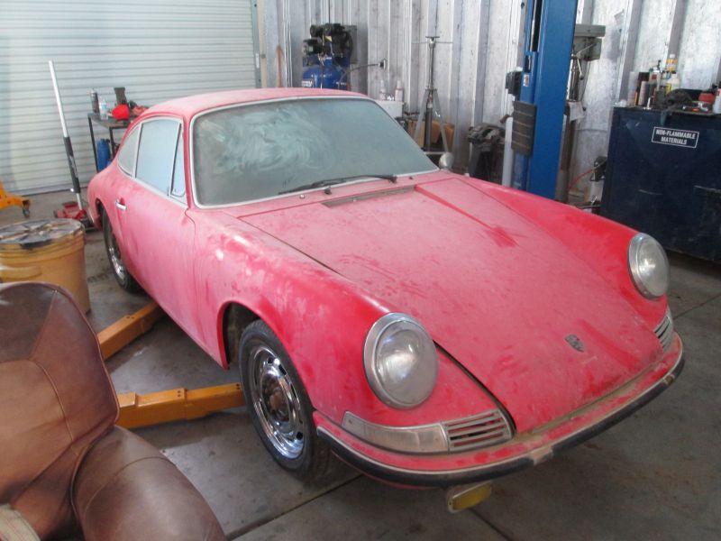

            A major moving day on the 17th. To get both this car and the 67 Targa ready meant reassembling the targa as best as possible for shipping and swaping back some major components that my father used to keep this car running through the 1980's. This definitely could not be performed on site so I had to enlist the help of my long time childhood friend Eric to help me with both transport and the use of his shop lift to have any real chance of getting it accomplished.

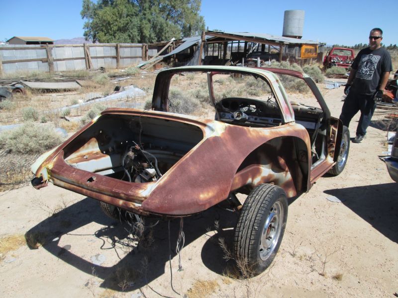

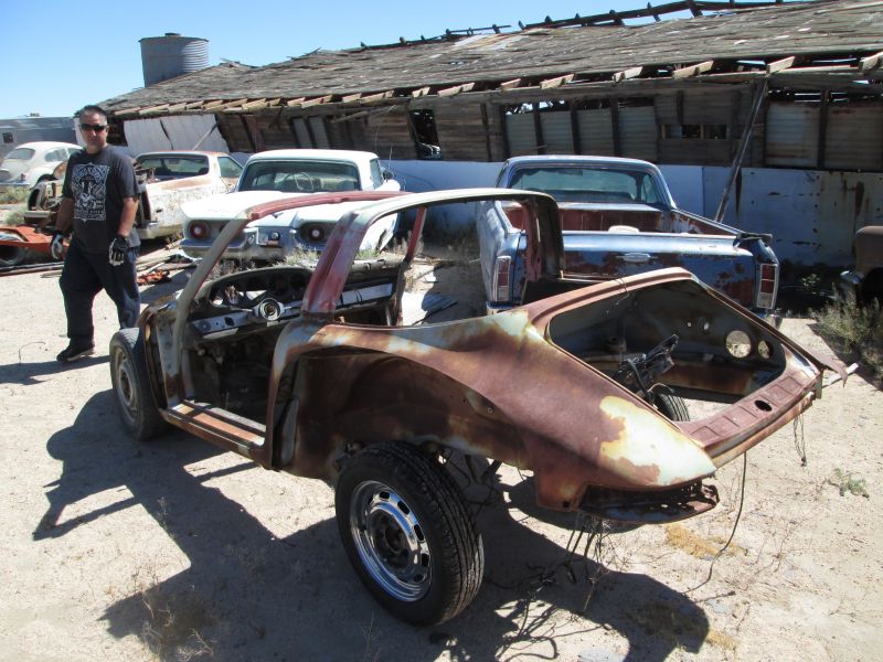

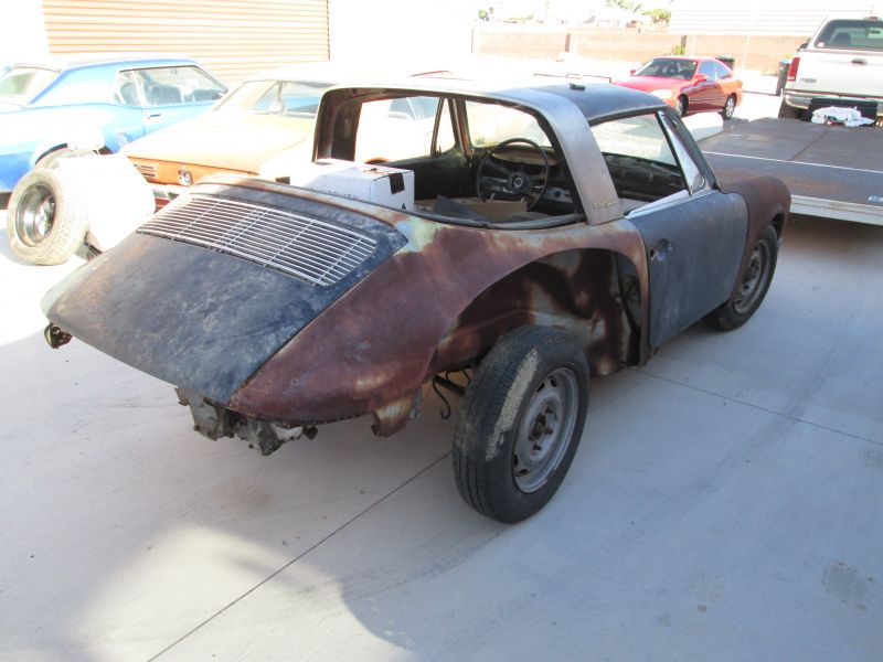

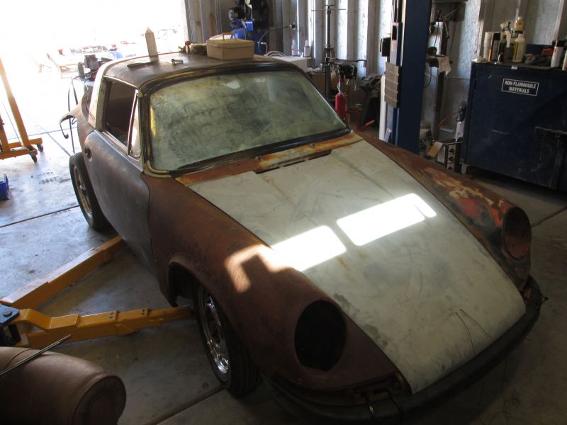

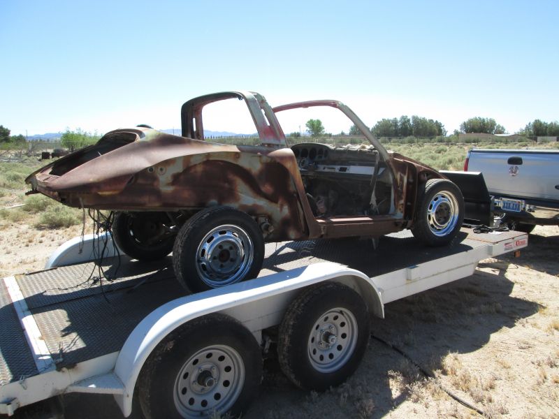

            Targa was extracted first. Some shiny chrome rims and fresh tires sure brightened its outlook even in its current state. Click image for larger version
            Thats my buddy Eric in the background. I was and still am so grateful for all his help with this mess. I'd have been up shits creek without him.

            Loaded up and almost ready to make the 2.5 hour trip back home. Eric wanted to knock it out and get both cars moved that day. 2 hours there, 2 hours back, 2 times = at least 8 hours on the road not including all the futzing in between. It was a very long day.

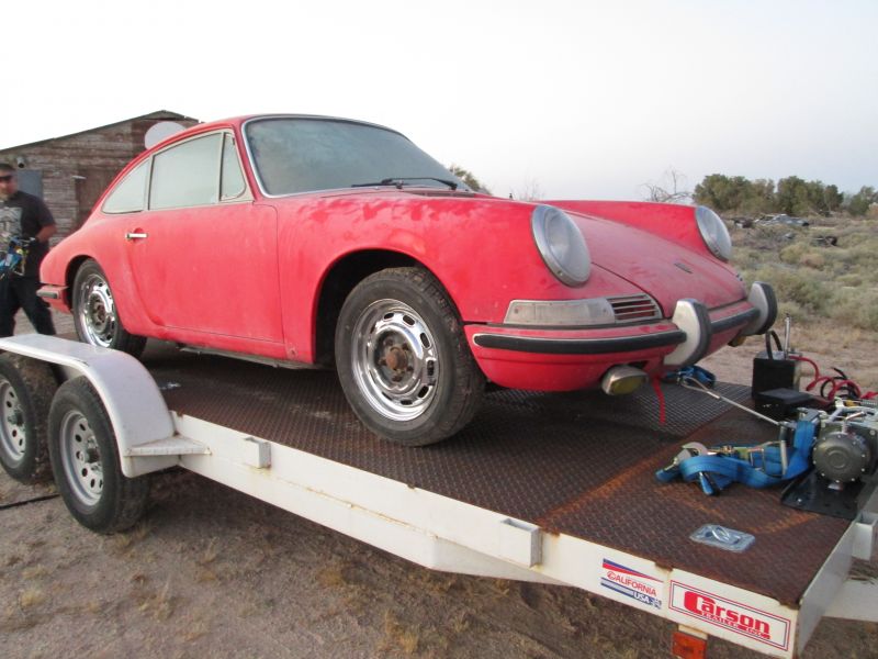

            Eric had the brilliant forethought of staging the '66 before we left with the targa. He said, lets get it all done now before we're really spent so when we get back all we have to do is loaded up. So glad I brought him. In process of swaping tires with the Targa here. So glad we did it sooner rather than later, it was a PIA to get it as my Dad had them packed together tight as a deterrent.

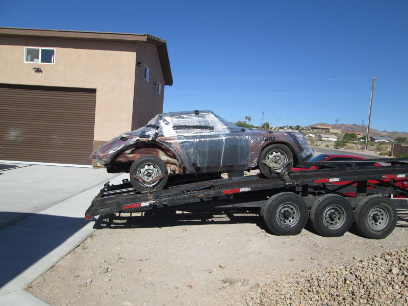

            It wasn't easy but we managed to get the new tires on it and pushed out without damage.

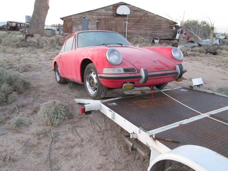

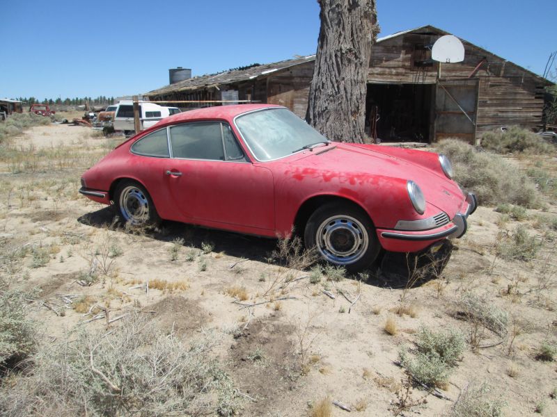

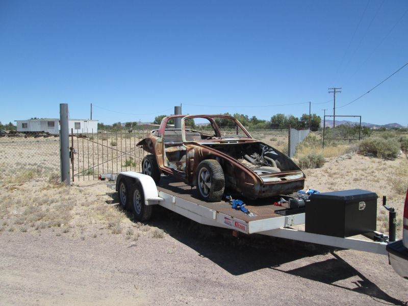

            Headed out with the targa. Its literally been 40 years since this car has left this place. More later and thanks for reading this!
            • #66

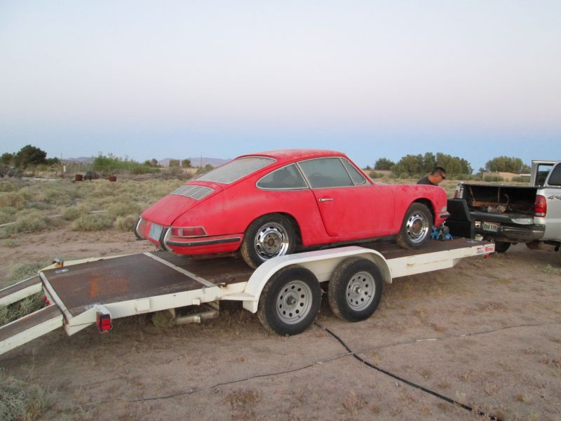

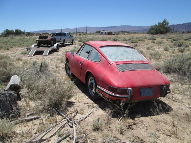

              Made it back right at dusk with just enough light left to get her loaded up.

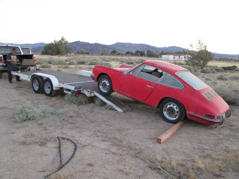

              Had to use the winch this time as it was a little heavier than the targa.

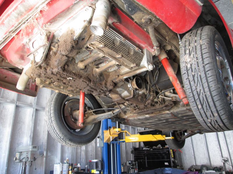

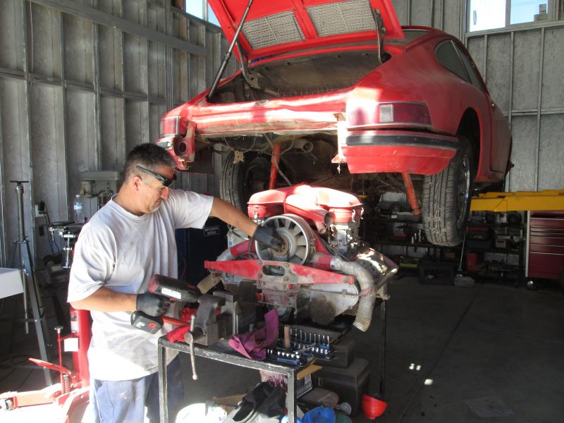

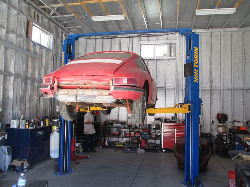

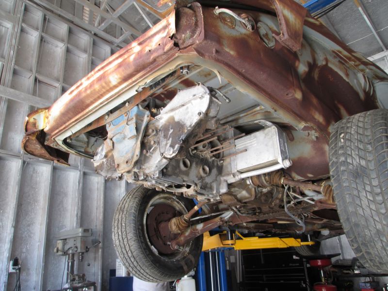

              Eric to the rescue once again with his wonderfully appointed shop with a bitchen lift. What an absolute luxury not having to drop the drivetrain on our backs. I owe him big time and will certainly compensate him well for all of his help! Got a good look at that old rear accident damage and as you might well of guessed, its bit more serious than I first thought. More later...
              • #67

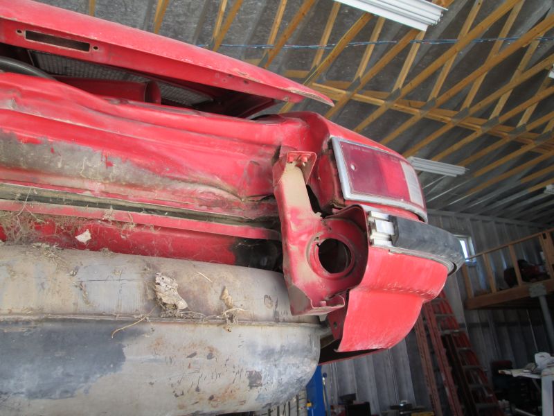

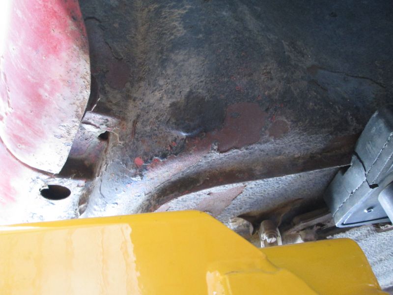

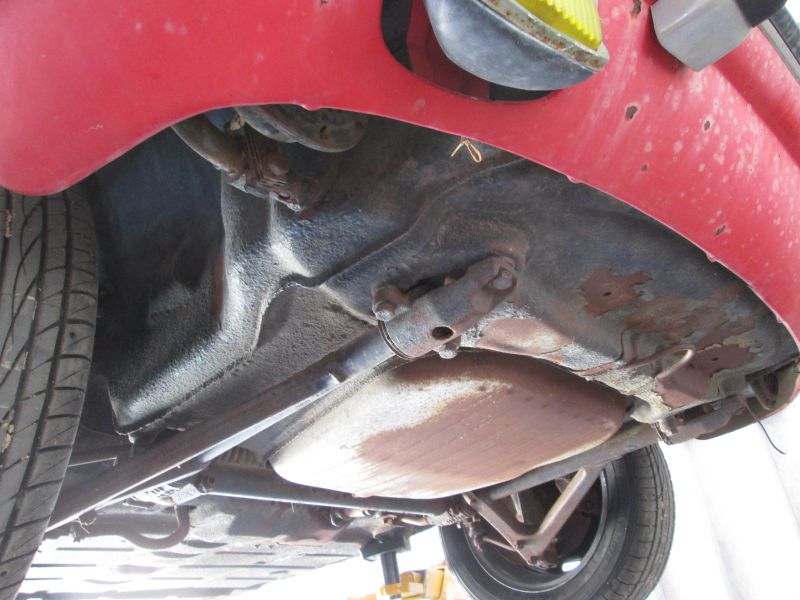

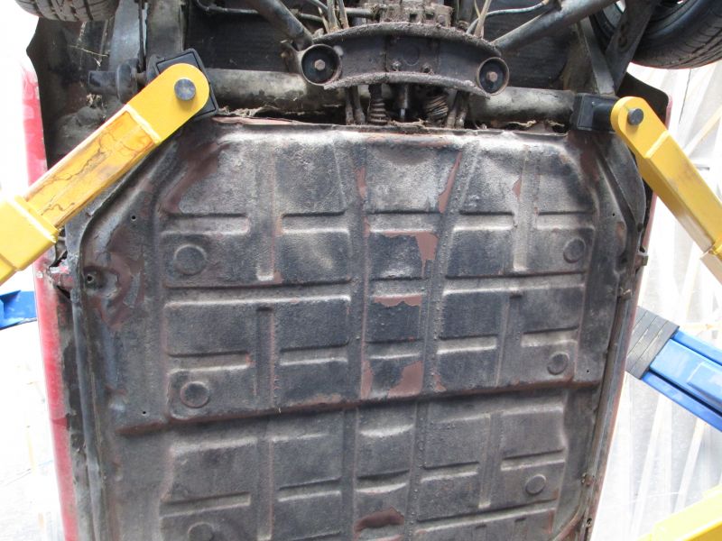

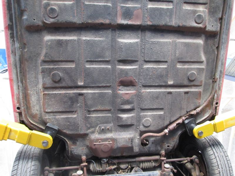

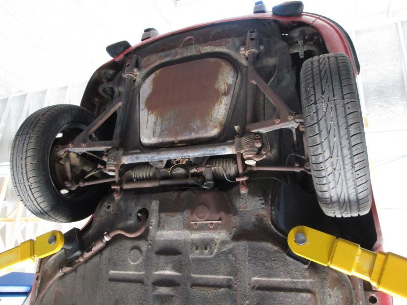

                Yeah, once we got the motor out it became very clear how much damage the cross member took. That later...

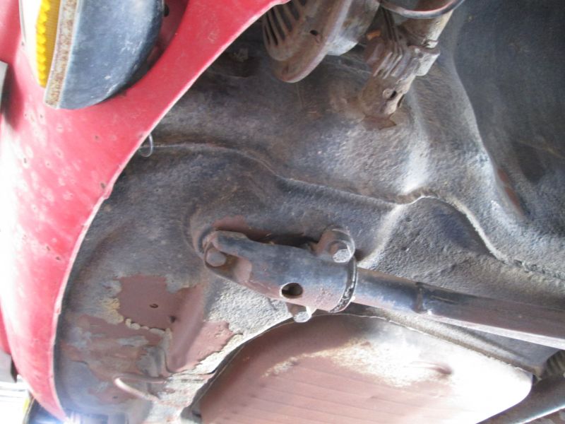

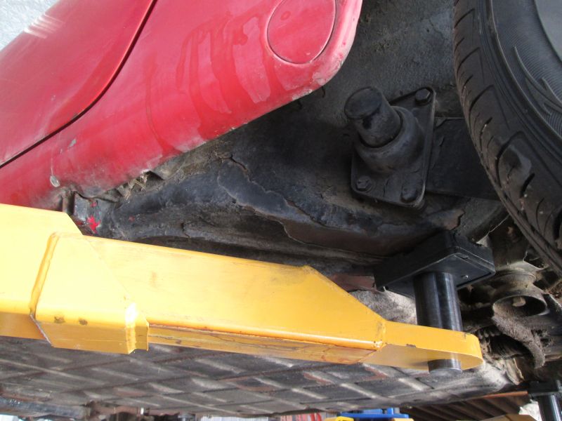

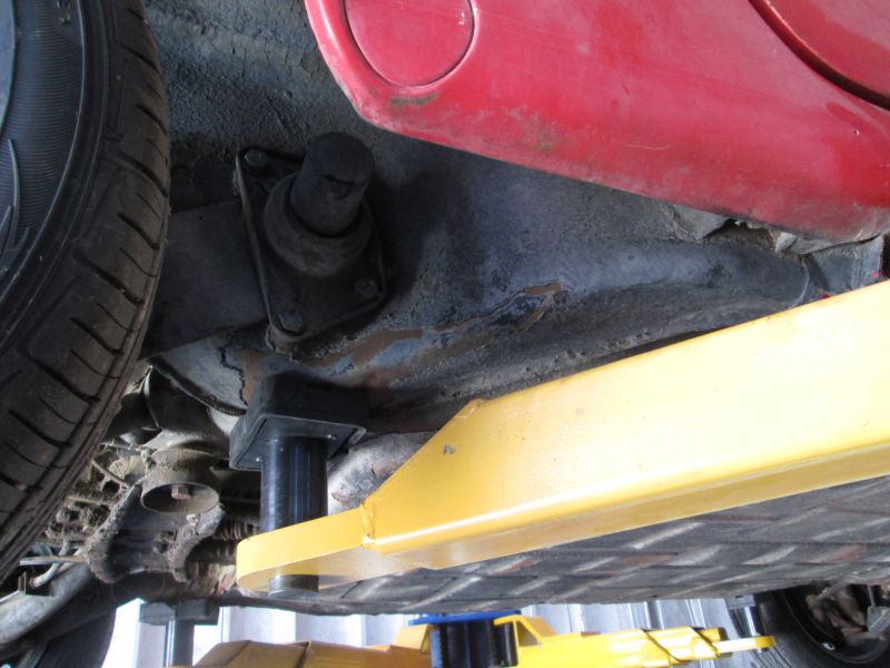

                Wasn't all bad news getting it up in the air. I was able to affirm definitvely of what I always knew. The pans are solid and cherry with 90% of the original undercoating intact.

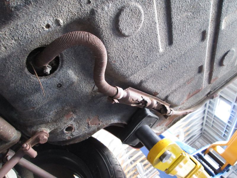

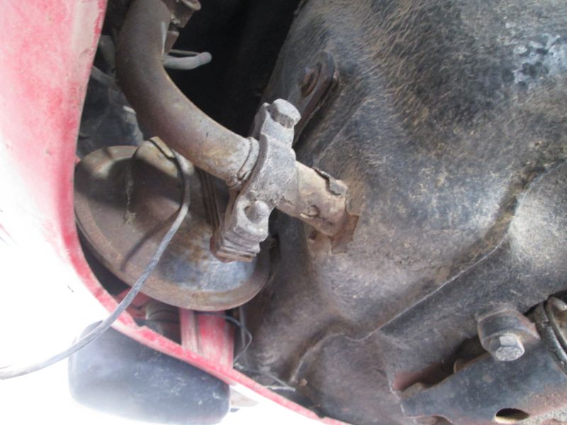

                Gas heater conduit didn't fare as well but there might be a replacemtn section offered? I just don't know 911's...
                Back section in the same condition as the rest.
                All solid around the rear torsion houings.
                Both sides..

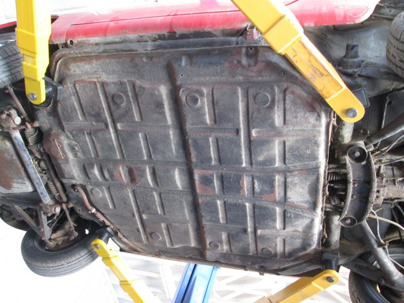

                Trunk floor also solid

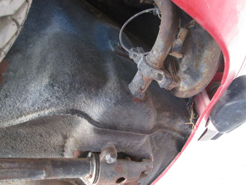

                no cancer in and around the front suspension points.

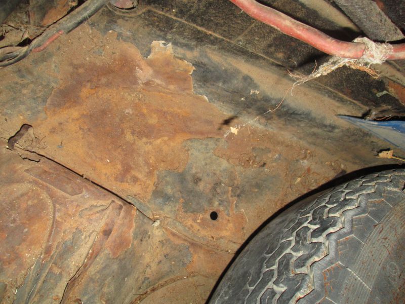

                Only mild surface rust where the coating flaked.

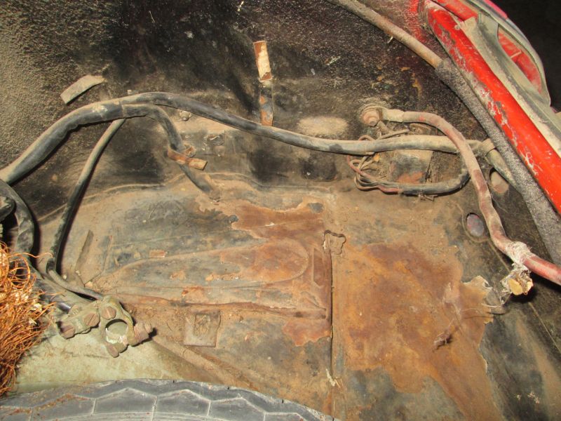

                flaking due to all those years of battery acid exposure. Battery box area remains in very good condition.
                A small hole started at the ledge where that metal clip is but otherwise its in amazingly good condition and will not warrant replacing; just some minor repair.
                Lateral light conduits solid.
                both sides.
                front splash pan area; no issues.

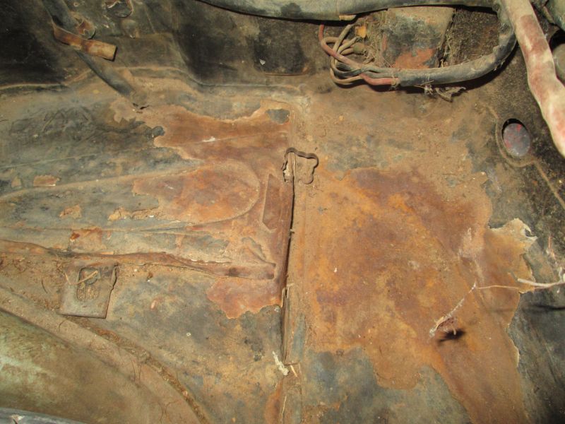

                As good as it is under here I did find some rot once we pulled the motor which I'll share later. Its a 50 year old Porsche so I wasn't too suprised but based on what I was finding under here I was shocked to find some rust.
                Pulling the drive train next.

                  WOW! Living in Nevada has its advantages.
                  My old '66 never looked that good underneath, and it was only 10 years old when I bought it. My old Webasto exhaust was long gone by then. I think the parts are still available, but pricey. When I got my Webasto running I just used Home Depot copper tubing.
                  The car is missing the cover plate that protects the transverse member, steering gear, master cylinder, steering damper, etc. They tend to get bashed up if you run over anything big. Pretty minor considering the car is over 50 years old!

                    Thanks for the education Steve. I completely missed that its a tiny little exhaust system for the heater; how cute. Have no idea what happened to the cover you described. Thats probably been MIA since the 70's. Thanks again for the help.

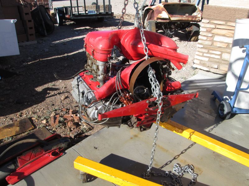

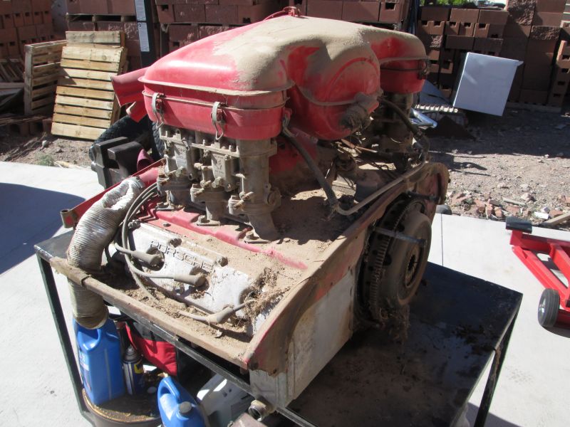

                    Pulling the drivetrain
                    Half-shafts and exhaust system dropped and just about ready to remove.
                    removal went relatively smoothly. Not having to lay on the ground made all the differrence.
                    20 years worth of blow sand accumulation to remove first.

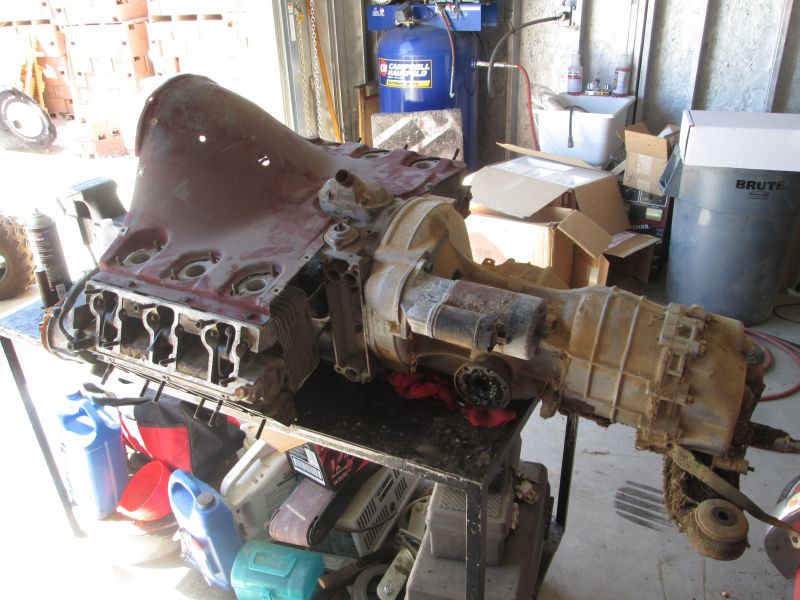

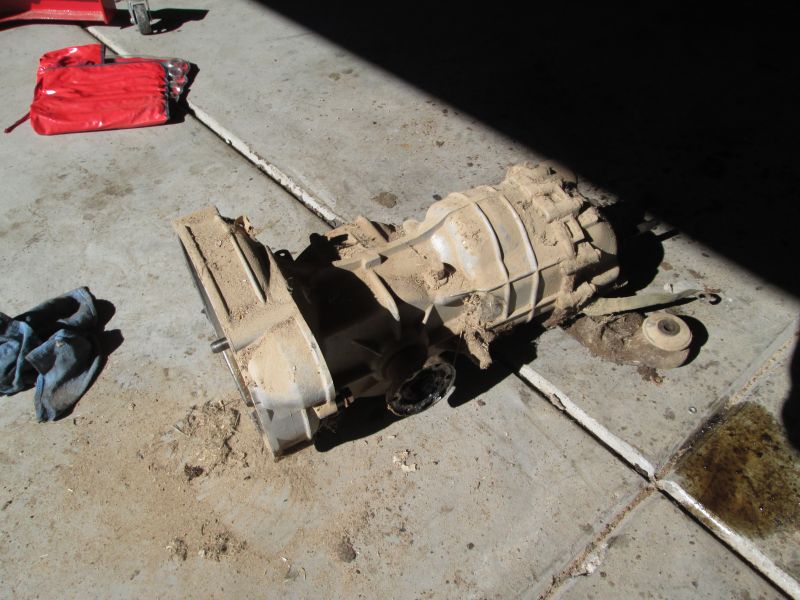

                    Getting this trans swapped out for the original was one of the main priorities.
                    Motor now cleaned off enough to open the chain boxes so they and the cam towers can be swapped for the original and correct center lube units.
                    That next, Thanks for looking!

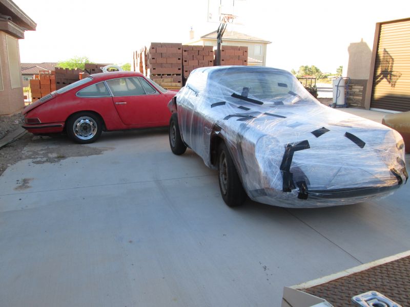

                        drivetrain installed for shipping. With the chassis so compromised I got concerned with the weight hanging off back here so the head assemblies where put up front.
                        The rest of the car was roughly assembled and packed with the all the original parts I could round up after being apart for 40 years.

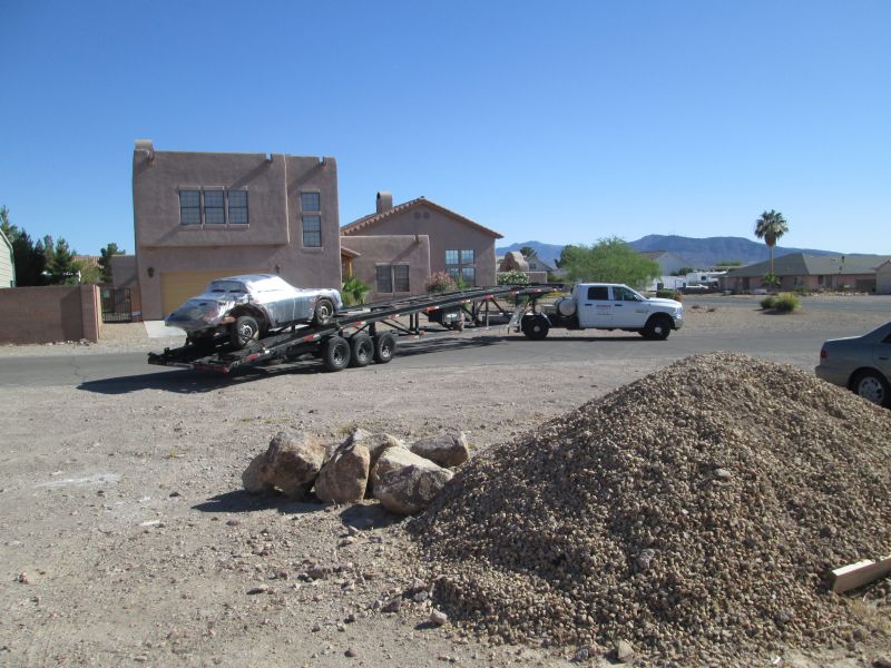

                        wrapped and ready
                        Loaded up
                        and on its way to the new owner. It was a bit sad to see it go after all these years but it requires a ton of work and I was never realistically going to ever get to it.
